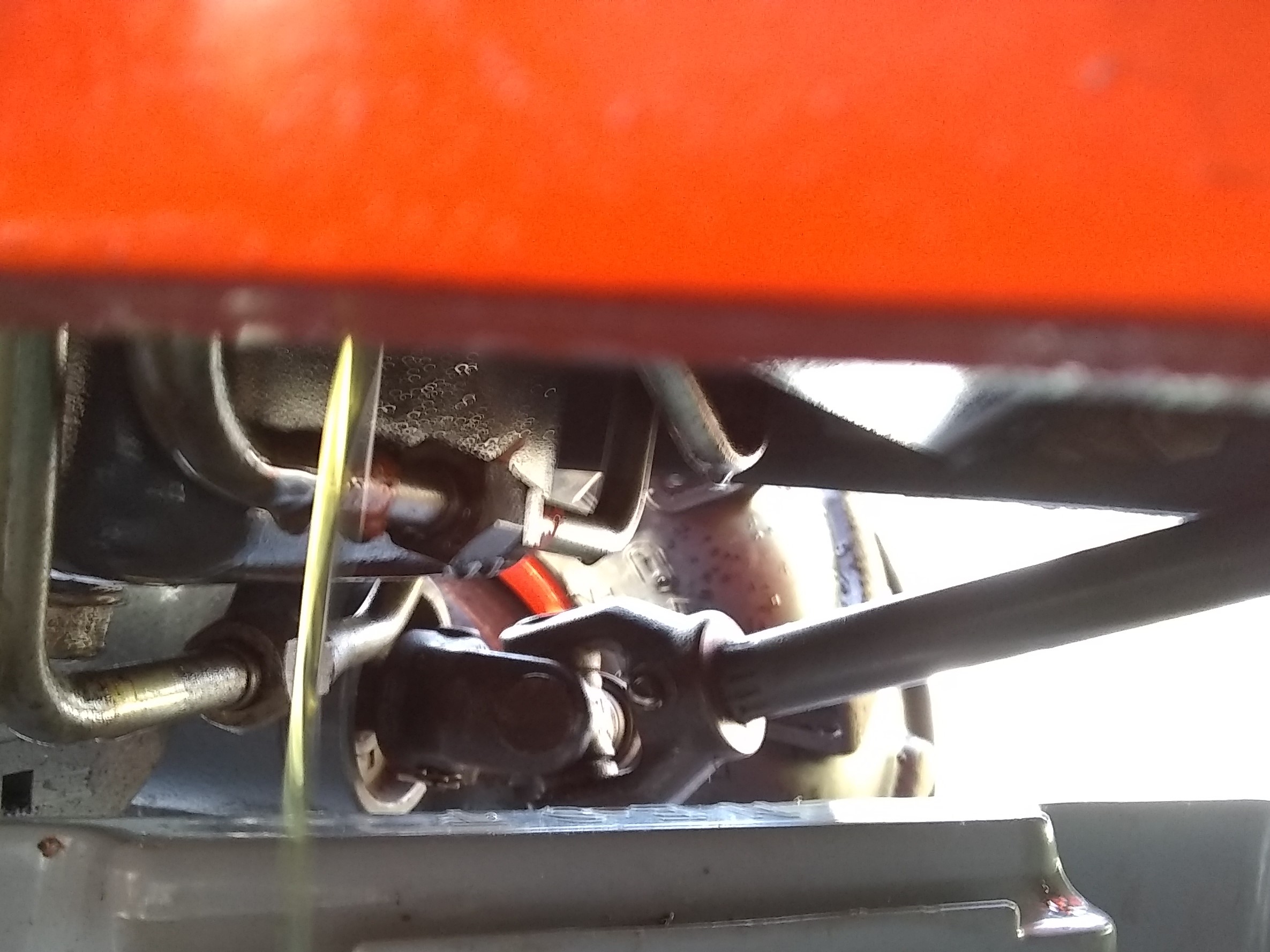

sorry for the delay. I refilled the Hydraulic fluid and it took several gal. I turned on the tractor and this is what happened. oil leak1.jpgoil leak2.jpg appreciate any guidance that you could provide. after the purchase I can't really afford a big repair bill. tomorrow I plan to take a better look and see if I can see more exactly where it's coming from. ty, John

for the amount of fluid coming out, you broke a hose or a line or something major, stop driving it, till a dealer looks at it, based on your questions your not prepared to handle this yourself
/ Kubota BX23 leak #8
Not be be an arse, but open the hood. Do some research. With a leak like that, it’s not going to be hard to find. Since you are pulling stumps, it doesn’t sound like you are the kind of guy who smells dinner burning and goes on line to ask what it could be, so roll up your sleeves. That’s ALOT of fluid to be a hidden leak.

LittleBill21: I stopped as soon as I noticed it. I'm actually quite handy and mechanical. just don't want to screw things up so I'm probably being overly cautious.
robertm: NP and I appreciate the response. ya, I don't mind getting my hands dirty.
here's my update. I pulled the hood and front shroud to expose everything. upon closer inspection it looks like one of the hydraulic lines are leaking. my biggest fear was that it was something that would require the tractor needing to be split. I had read something about that online. thank goodness it doesn't look that bad. breaking the line fittings was a challenge in that tight spot but got it done. and whoever put the bracket on under the floor put it in the wrong spot so it was a very tight fit for wrench. I'll take care of that when I reinstall. with line freed up I'm still having a problem getting in out with the bends. looking from under the front of the tractor it's the 3rd one back and is green on my tractor. it runs to the back and connects behind the wheel (which I removed for ease of access). you can see the line in the second pict I posted earlier. here are a couple more pictures . . . . IMG_20210206_113840660.jpgIMG_20210206_114357053.jpg

The First two pictures show possible damaged hard lines to me. They look out of place and the bends in the hard lines are flattening the hydro tube/line. Looks like someone replaced/moved the lines or an object has impacted the lines. Kubota usually have lines tucked away nice and neat along side each other. I would order new lines that are going to have the proper hydro flow GPM. I have seen them pinched and I even tightened a line clamp to tight and it crushed/pinched the line like that and you are loosing performance in PSI and flow. And you mentioned the floor pan was out of place, so i think someone was trying to fix something. Take the Pictures and show you local Kubota mechanic.

#14
toledoohio: I think these are nonKubota replacement lines so that is why they look different. as a matter of fact I think the way they placed them is why it failed. the line even broke at the leak as I was trying to work it out. hoping to try again tomorrow. I do have an oem line coming from Messicks. floor pan wasn't out of place but the tube clamp under the cab was. since I'm a new owner I'll have to research who my local shop is. thanks for your info, John
