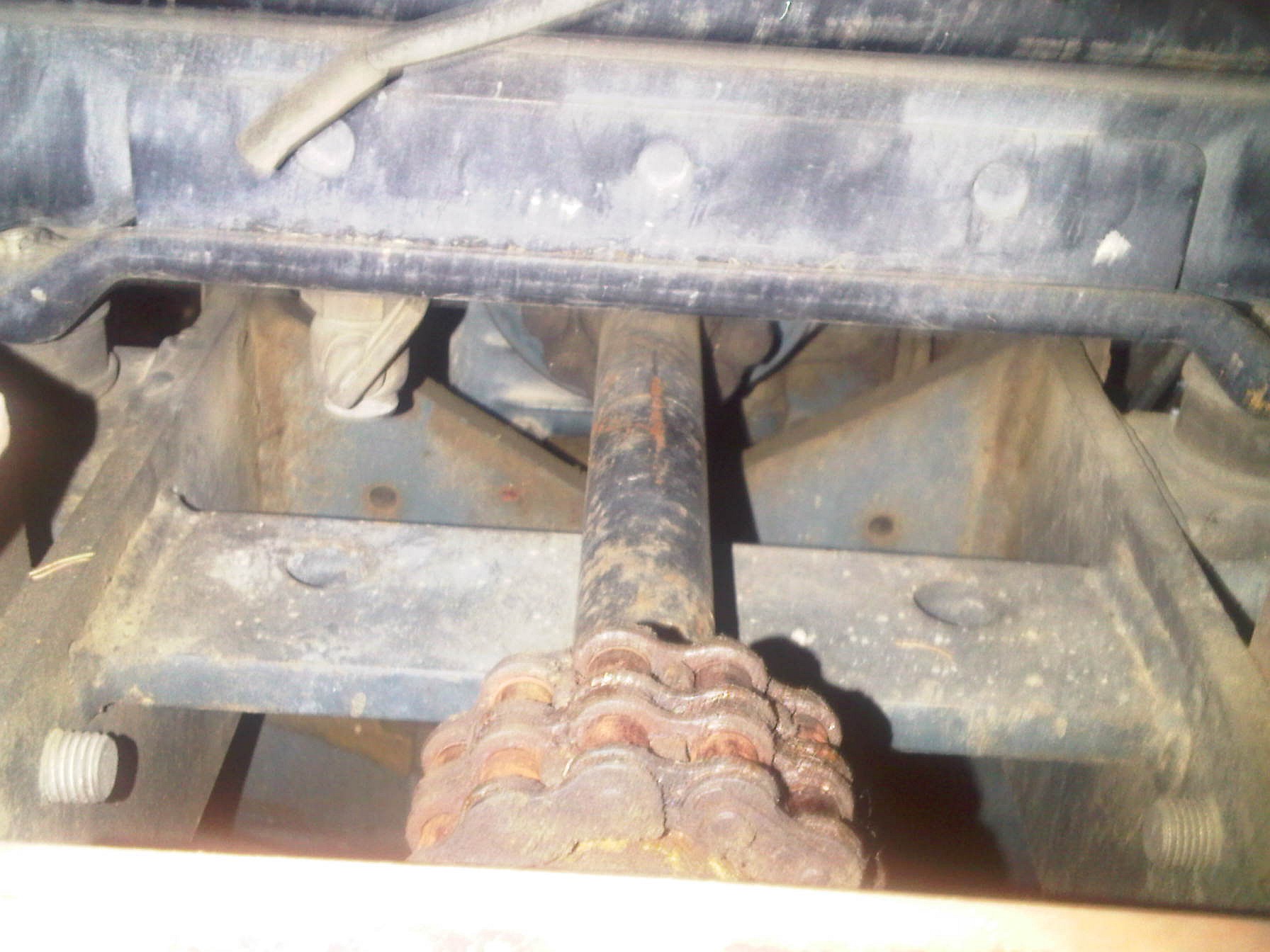

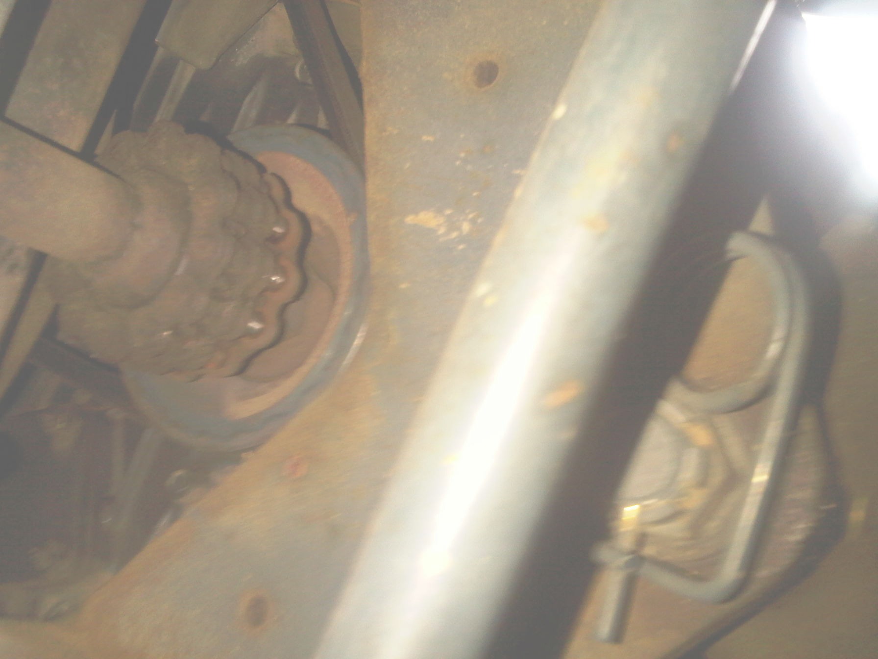

/ Kubota B6100D Front PTO ??? #8
Here are the pics of how the hyd pump for my FEL connects to the front PTO of the tractor.
There is a sprocket on the tractor PTO shaft
A double-chain connects/links that to the rear sprocket on the connecting shaft.
Another double-chain connects/links the front sprocket on the connecting shaft to the sprocket on the hydraulic pump.
All sprockets have the same number of teeth so there is no shaft speed change in the system.
The front and tractor-end sprockets are keyed to the pump and tractor shafts.
The function of the chain/sprockets method of connecting the drive shaft is not explained in the Owner's manual.
It's really weird, actually because the double roller chains don't actually roll. They're hard fixed in position on the sprockets. a one-for-one relation of the chain link to sprocket tooth.
#9
Hi WVBill. The pictures are pretty much as I expected them to be from your previous description. I wonder if the shaft could be elliminated, using just one roller chain coupling, making the whole thing a lot shorter.
Apparently the play in the components of the chain and the play between the chain and sprockets is enough to do the trick and allow for some minor misallignment of the two shafts. The chains aren't actually hard fixed to the sprockets, just wrapped around them and the chain ends connected together and that gives it enough play.
Thanks for the information and the pics. They give me new hope of finally getting something done. Now all I have to do is try to find the parts, using your part numbers, and the money to pay for it. Thanks again WVBill.

/ Kubota B6100D Front PTO ??? #10
For my B219 loader, the hydraulic pump is mounted on the front ("outside") of the front "bumper" frame member of the tractor. The only way I see to make that shaft shorter would be to mount the pump on the inside of that frame member but I'm not sure there's room for that - - at least not with the pump Kubota used for the B219.
Best of luck on your quest.
