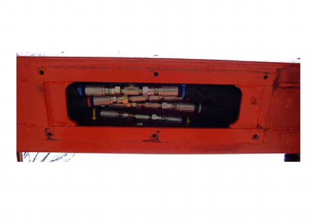

I think the problem with the Kioti loader design is that the access hole in the cross tube has created a stress riser in a structural member that was meant to evenly balance the stress between each of the loader arms. In an unbalanced condition the stress flows from one side to the other and concentrates at the corners of the cut out and causing it to crack. Usually during the design stage some kind of testing or simulation either manually or computer aided is done looking for this potential condition. When a product is designed certain assumptions are made as to how it will be used perhaps the Kioti engineers ignored the fact that these loaders are likely to be used in an unbalanced conditioned.
I remember when I was a young engineer just starting out in the design area my Supervisor told me it was just as important to imagine how a product will be "misused" as well as how it will be used.
