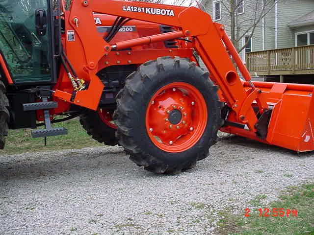

Not to be smart here, but wouldn't jacking the tractor up by pushing down on the corner of the bucket, like many of us have demonstrated in the last week, be considered abuse? /forums/images/graemlins/grin.gif Just trying to be funny here now. Don't rip my head off. Ok?

</font><font color="blue" class="small">( Not to be smart here, but wouldn't jacking the tractor up by pushing down on the corner of the bucket, like many of us have demonstrated in the last week, be considered abuse? /forums/images/graemlins/grin.gif Just trying to be funny here now. Don't rip my head off. Ok? )</font>
No. And I'm missing your point. /forums/images/graemlins/confused.gif How would doing so create a considerable more amount of bite than what a stock loader would?
I'm trying to say that I don't think that this is a "Kioti thing". I would like someone to prove me wrong. You know, show me a broken Kioti loader that didn't have a tooth bar installed.
