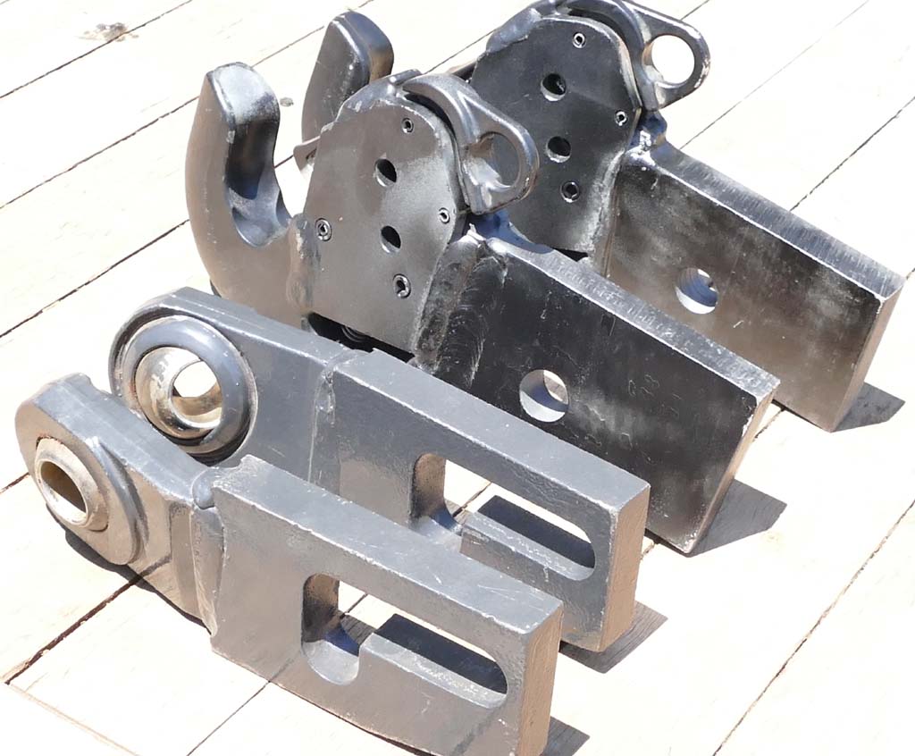

I have just taken delivery of a new Kioti RX8030 here in Australia. 76hp Daedong turbocharged engine, Daedong loader with 4-in-1.
The lower link ends are cassette-type balls. I'm looking to replace them with cassette-type quick hitch fittings, as shown.
Does anyone know where these are available from? I cannot find any in Australia.

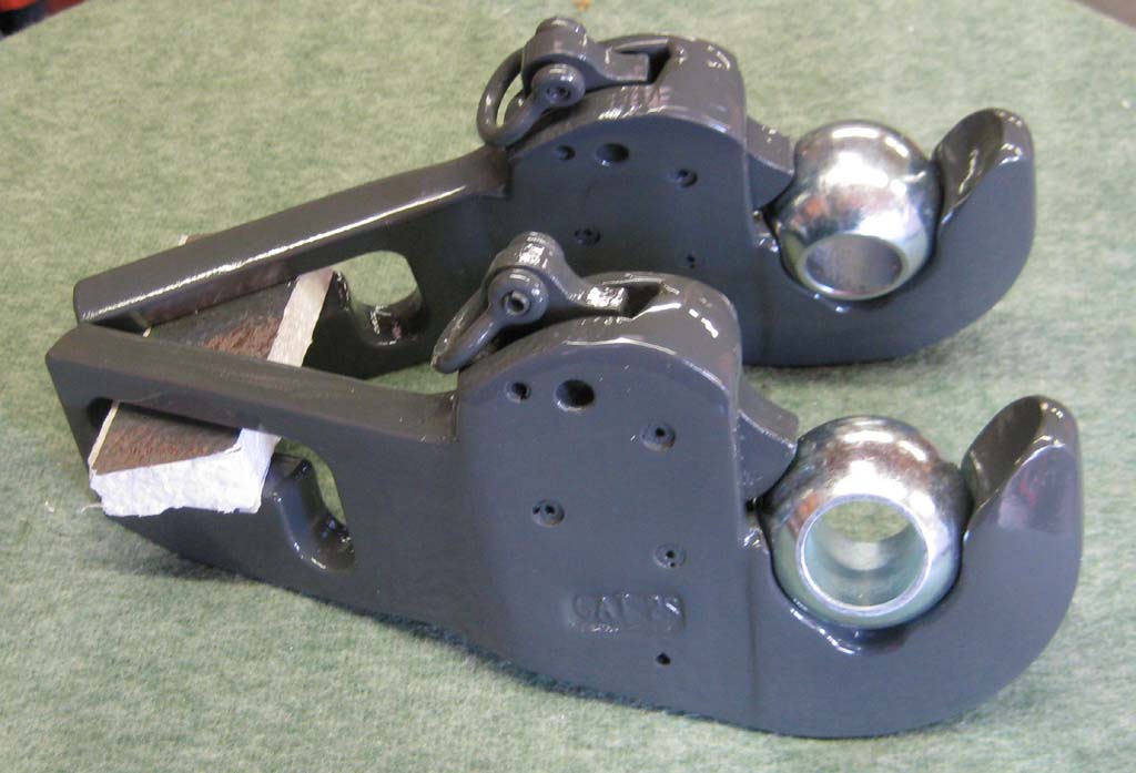

I sold the pair that you have pictured. Those are modified to have the extendable ends on them. They are available from AMA in the form as pictured.
I also sell them, have the parts in stock.
Top link end and draft link ends.
There was a time when Kioti offered these as an option. You might want to check with your dealer about them.

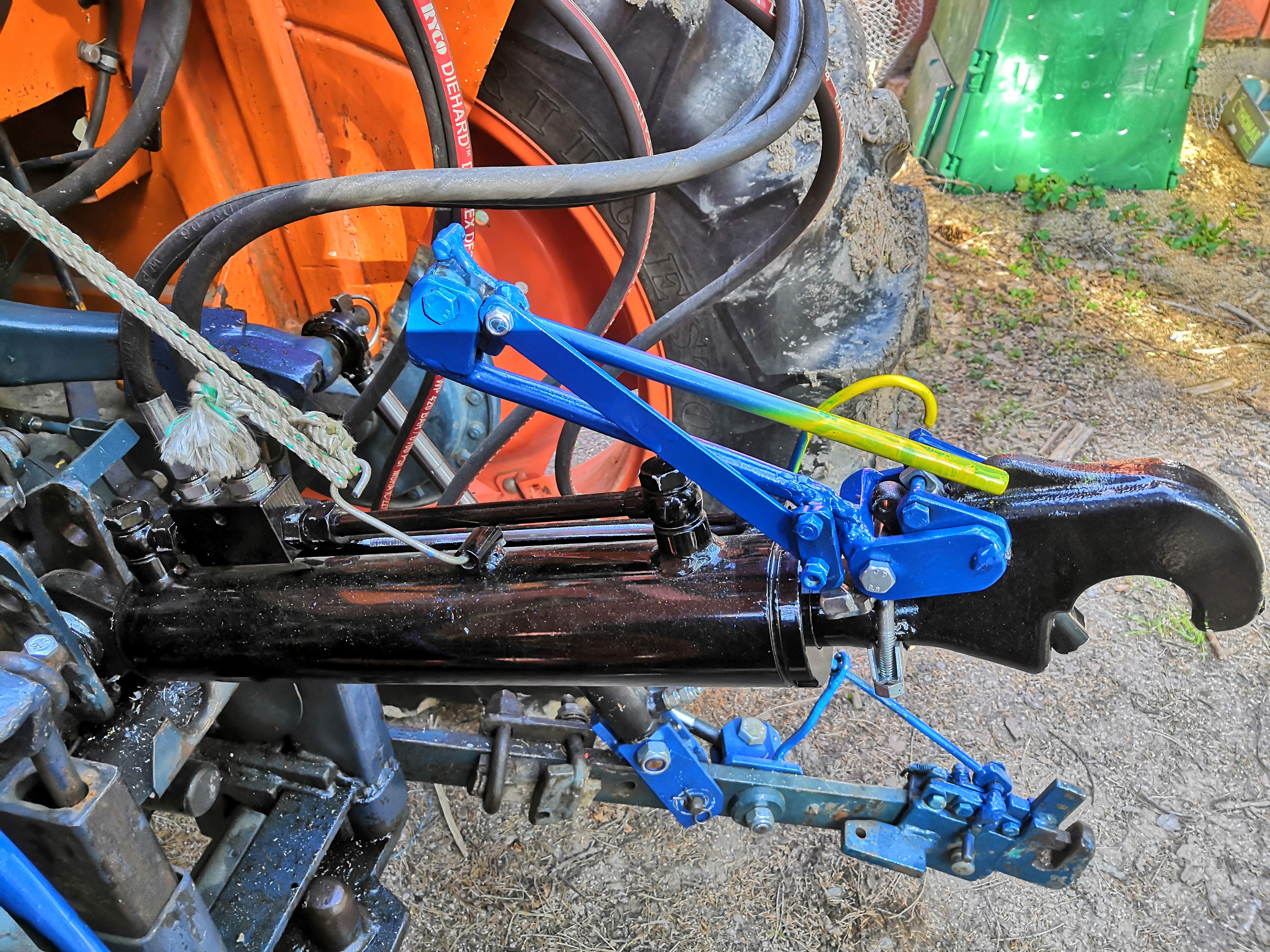

Hello LGvaltra / Australia!
If you want to use your quick hooks from the cabin, then you can make this
Look my post at same page as yours: My quick hitch is hydraulic
Weldable Hooks and Balls for Tractors - YouTube
I have 2 examples how to use top link from the cabin.
How to make mechanical or hydraulic stabilizer bars and use them from the cabin
Good luck to your work.

Actually there is no "good" reason to have the hooks extendable at all. Simply get the correct block size of steel that you would have if you were to cut the extendable ends off and weld them onto the hook ends. Mark for the pin location, drill and install the pin just as you would with the extendable ends, these pieces are then locked in and simply do not move.
Fairly simple, and leaves the OEM parts in OEM condition. :thumbsup:

You're absolutely right! I'll do just that - thanks. (saves cutting too)

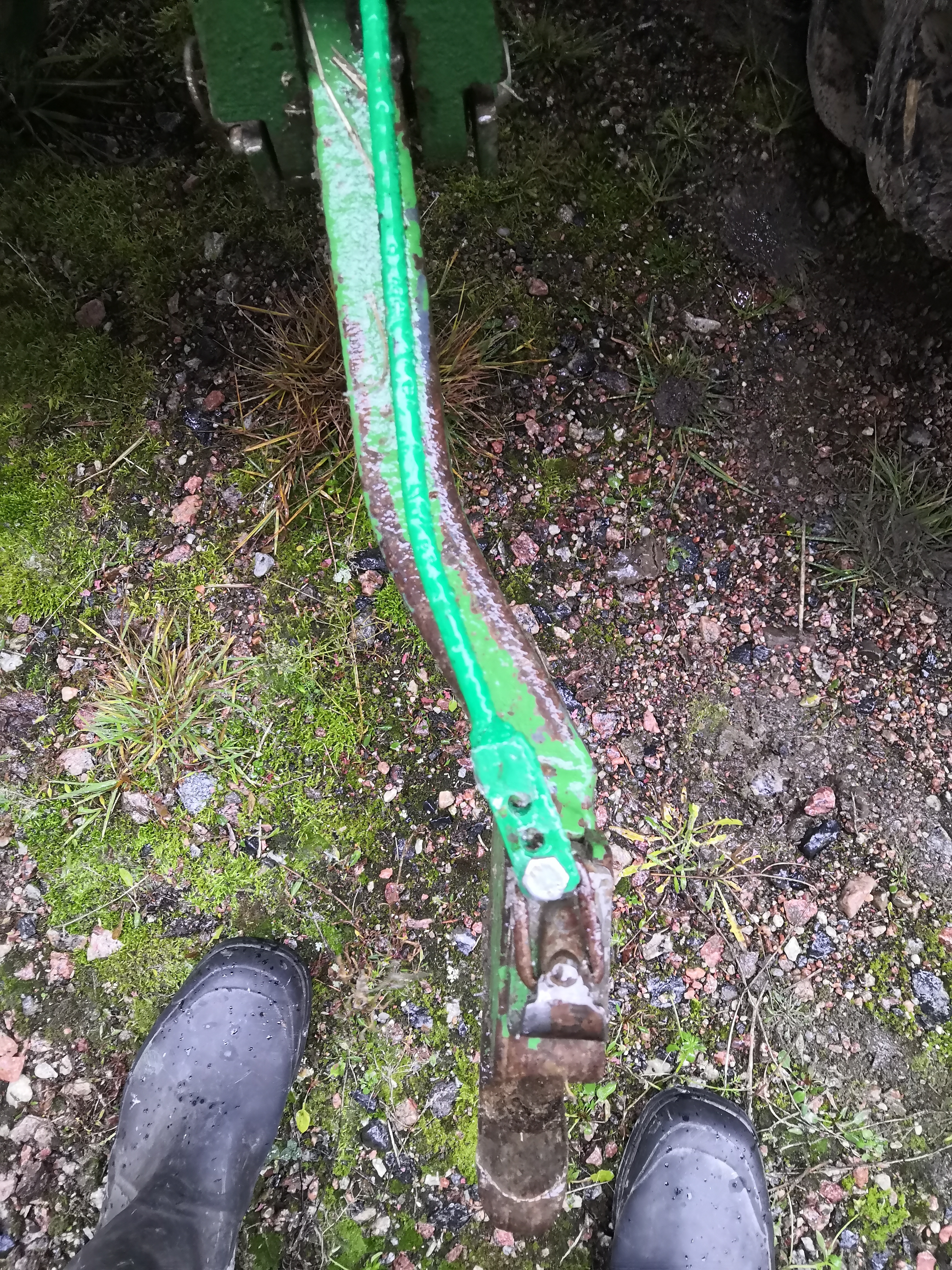

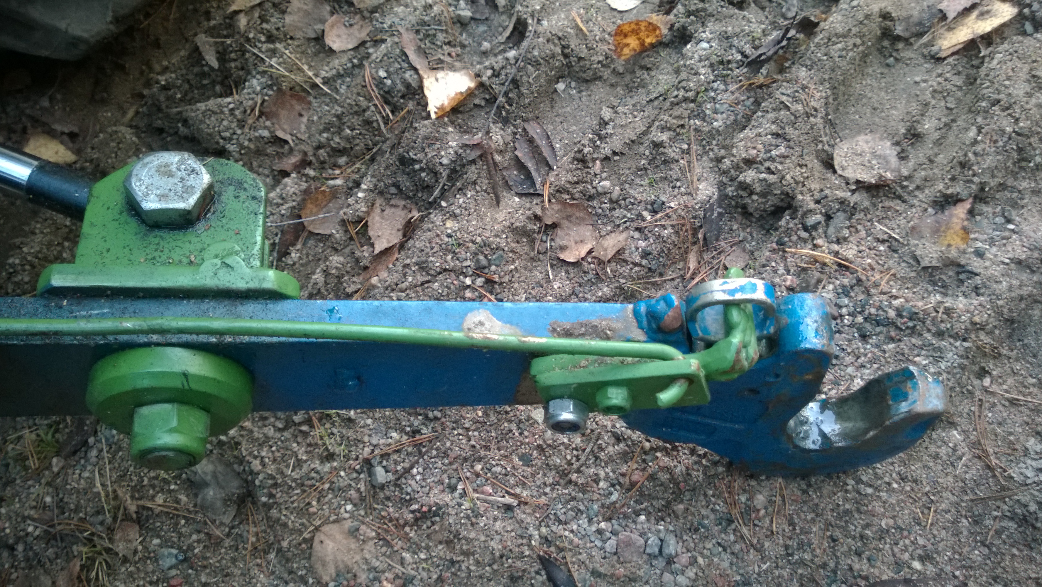

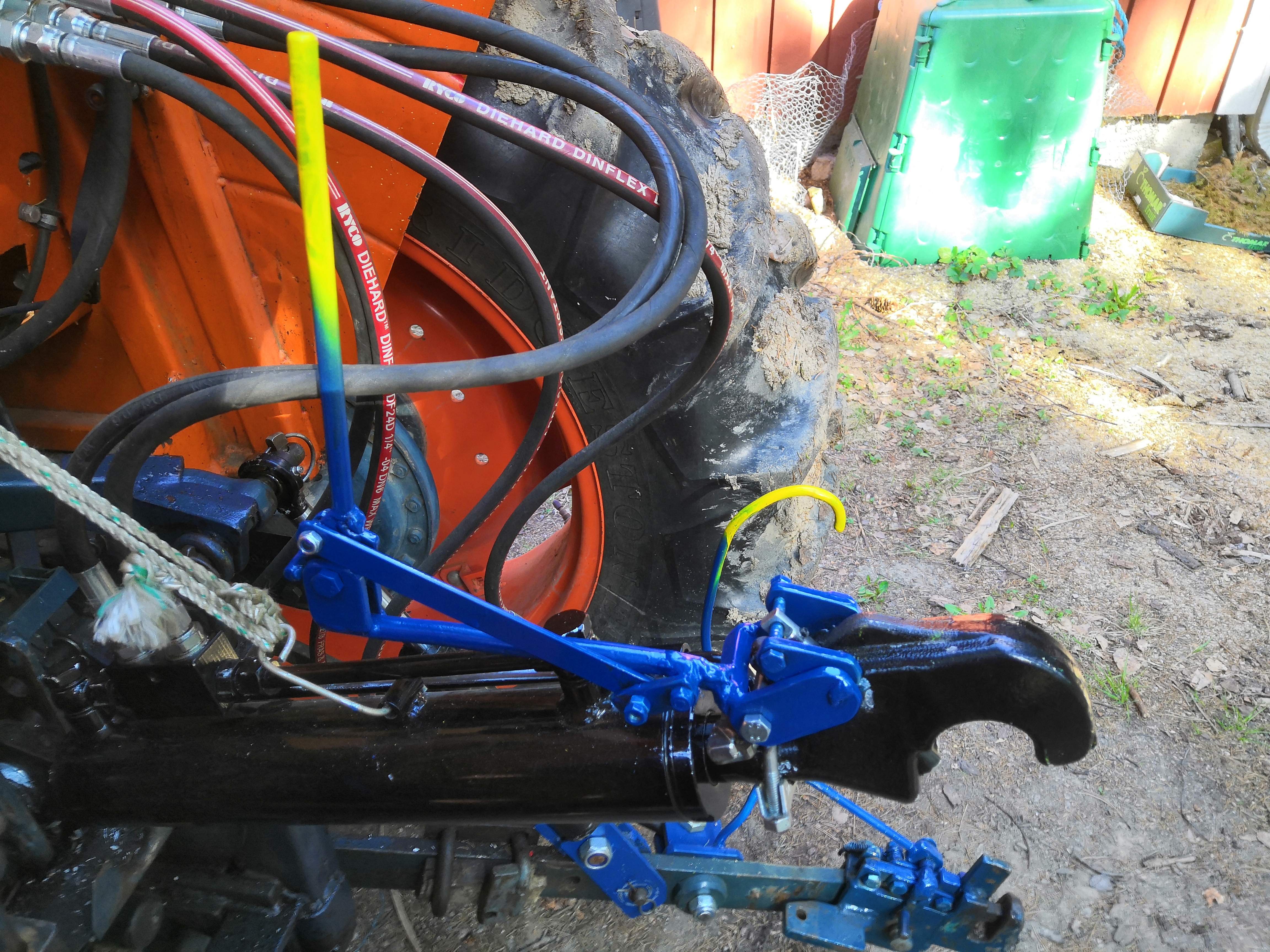

HelloLGvaltra!
If the operating lever on the hook ends had to be lifted and then pulled back to release the ball
then you can make this kind of lever.
There is fine degree too.
Walterscheid, CPM hooks do not need that end lever.
For top link of bigger tractor use this a rope to close and open. See the spring for lightening.
For small tractor you can use a rope or this self locking lever.
IMG_20190501_100045.jpg Closed
IMG_20190501_100057.jpg Opened
Markus

@PikaPika I like the ingenuity shown in that first photo - ie - first lifting, then pulling back.
I have a pair of Walterscheid Cat 2 hooks ordered, so will investigate options when they arrive.
Thanks for the photos.

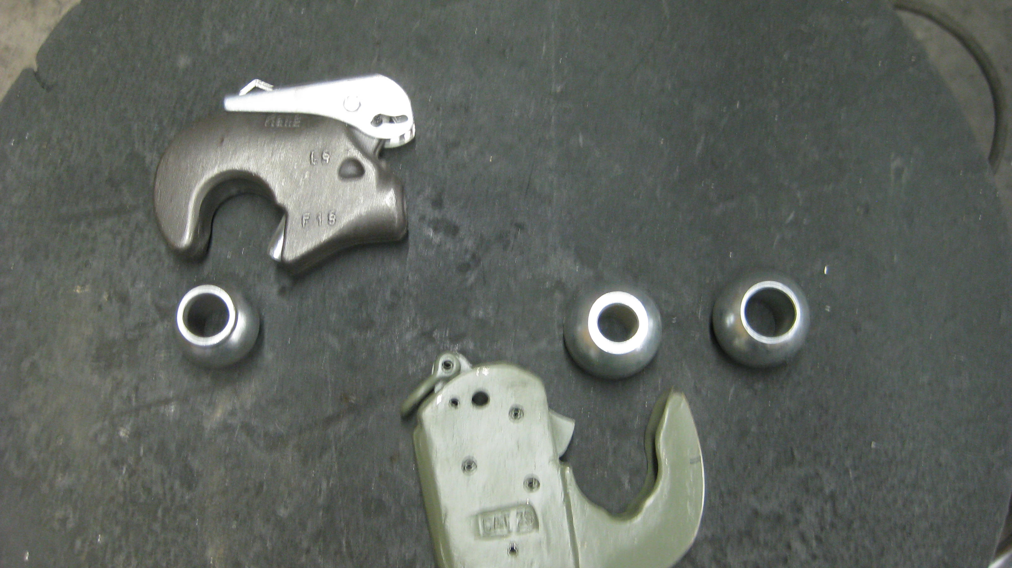

With thanks to MtnViewRanch, I now have a pair of hooks, while retaining the original eye-ball ends, should they be needed down the track. The "light-bulb" moment for me was that with hooks, I didn't need the telescopic action.
It took some care to get the angles correct prior to welding, but now, all good!
/ Kioti RX8030 lower link ends #13
Great job! Look very nice.
If you really want the telescopic action, you could find someone with a milling machine to machine some slots on in.
But then again, not needed with the hooks. My tractor also came with the Cat 1 hooks and never had the need for telescopic ones.
