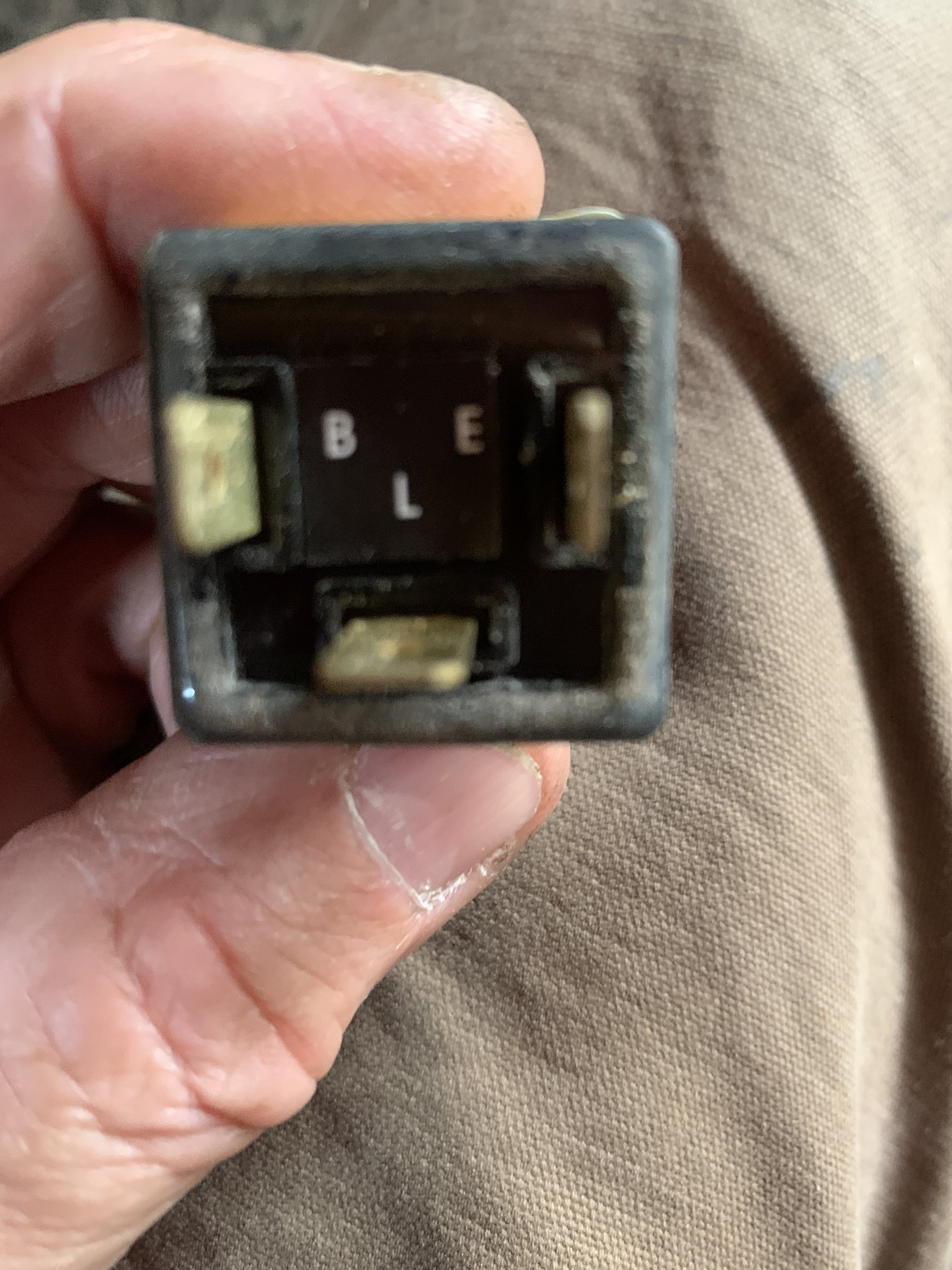

I’ll finish reading your post soon as I have time to sit down but what a spot they had the flasher buried in. Is this what you or is called an electronic flasher ??

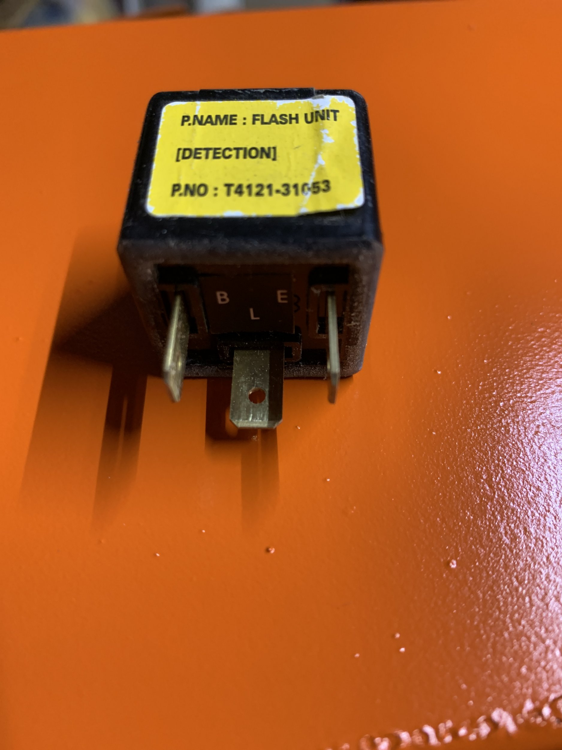

Not sure what the letters represent or why anything more than 2 pins are required for blinkers…hmmmm plus this OEM flasher has a metal lug where it bolts up underneath the dash
Yep. Replace that with an electronic one made for leds.
B is Pos+, E is Neg- and L is the output to the leds..
Well hopefully this will do the trick because I just ordered it. Has a potentiometer on it to adjust speed.

That should do. If the pinouts are different you can use the wire pigtails to solve that.

Well the LED flasher arrived and sure enough the positive and negative prongs coming off the flasher were opposite to the OEM but as you mentioned to use the supplied wires it worked like a charm.

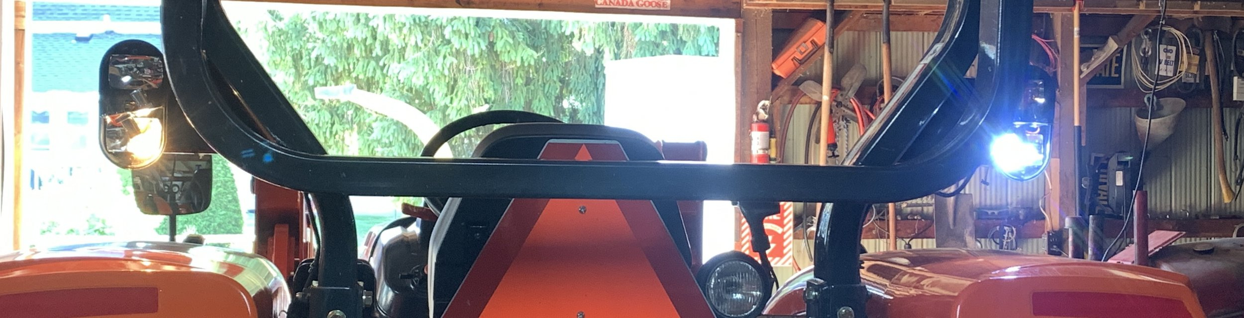

I also ordered a cell phone charger and installed it into the plastic dash and have 2 LED lights to face forward off the ROPS and one facing rearward which will be so handy. I see there’s a fuse block at the firewall on the right side with spare 15amp locations plus also another fuse panel to the left side of the seat. Not sure what the best location is or even how to go about running wires into fuse panels. I think I’ll use the OEM harness in behind the seat to run the LED lights.
