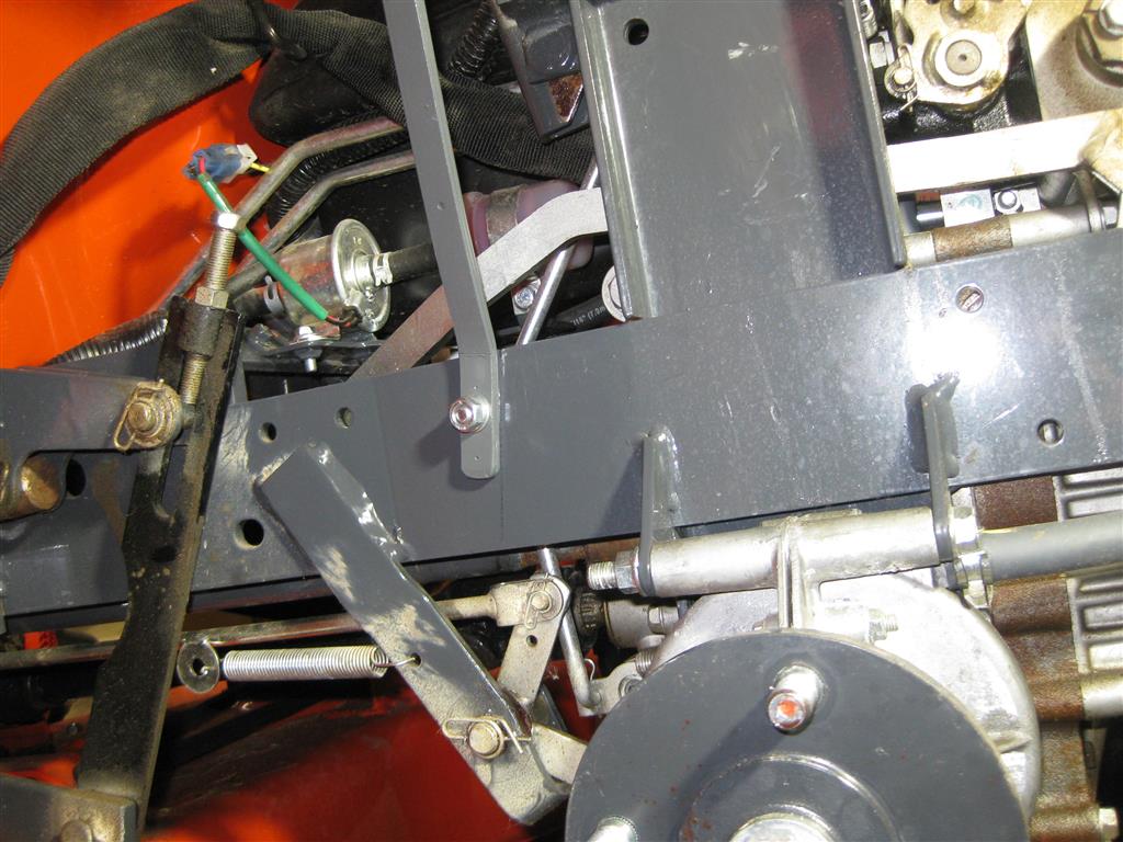

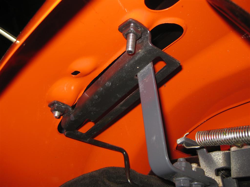

The other problem i noticed right away was When I get off the seat I put my left hand on the fender to get off the tractor . When I did this i felt the fender give a lot and I only weigh 155lbs.
I looked under the cub holder assembly and there is no support for the fender if you happen to put you left hand on to get off. its awkward for me to get off a tractor without supporting my self on something other than the steering wheel or rear tire. I than checked out a cheap craftsman ,cub cadet and husky and I will say they all had better support of the rear left fender when getting off.

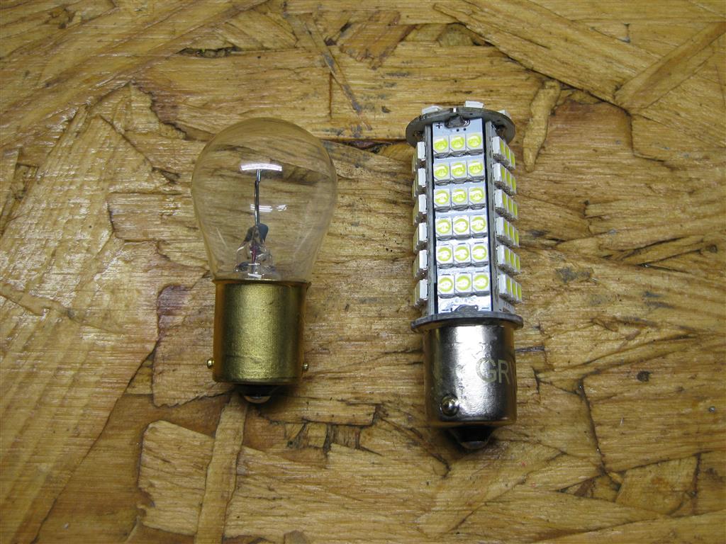

Another thing that was troubling was that the hood has no rubber bumper guards under the hood or on the black plastic instrument case and without rubber bumpers on either its wears gouges in the black instrument case where the hood touches in several spots . All other manufactures much cheaper units all have rubber guards on the hood to prevent this from causing these gouges to happen. Another point that seems 20 years behind the time is that the headlamps are the old Incandescent lamps #1156 and not leds. These lamps will operate on 12VAC or 12Vdc and At about 12.5 vdc they each draw a current of about 2.1 amps and get very hot .Now There is a exact replacement led ,socket being the same and at 12.5vdc draws about 240MA one tenth the current draw of the original 1156 lamp and don't get hot. With this amount of heat which the old incandescent produces it it likely after a period of time if used a lot that the clear plastic headlight housing will discolor and turn yellow after time. Also the output dc voltage charging the battery and to the headlamps varies with the throttle rpm . For a example at idle the dc voltage will be about 12.5 volts dc and at full throttle will be 14.5 vdc. You would think they would install a regulator to make sure the charging voltage is the same. forward speed is 62.mph any faster might throw you off the tractor on a rough surface. Only a snowblower and grass collection system avail.

Note: The exact replacement led lamps are Part: GRV Ba 15s 1156 1154 high power car led bulb 102-3528 SMD DC 12V super bright cool white pack of 2
Amazon $9.88

I make up my own support bracket mounted under the left fender and the bracket mounted to the frame.
If anyone wants some info on how to built the fender bracket email me rrwitt@verizon.net
