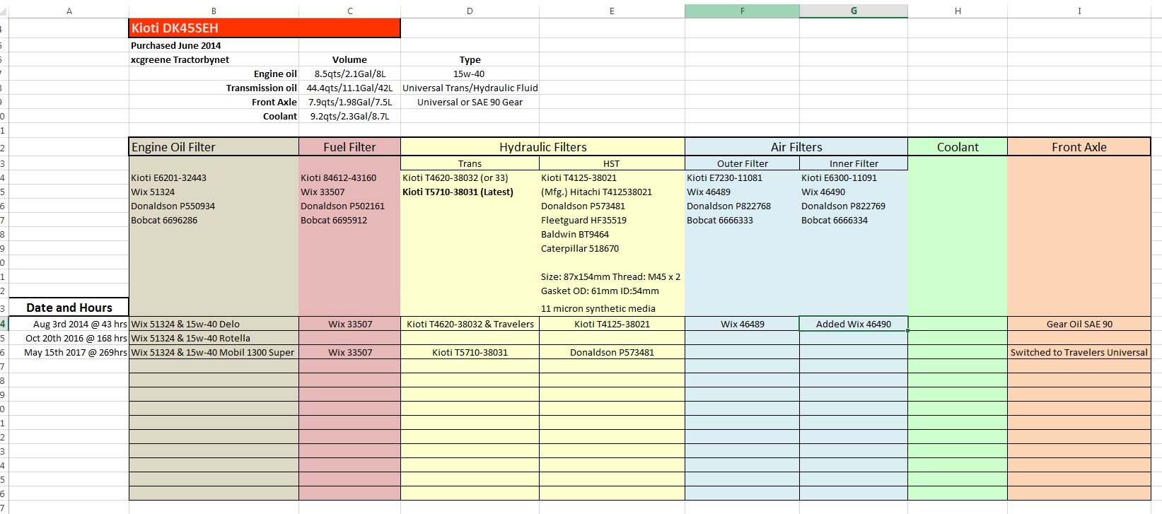

The Donaldson P573481 filter appears identical in shape to the T4125-38021. Both sealing surface diameters are the same. In particular the one I was questioning before I purchased the Donaldson filter was the internal O-ring that should seal over the protruding tube of the tractor filter housing, which is does. The only visual difference, other than color, is the internal metal mesh pattern. The T4125-38021 has many small round holes where oil passes through. The Donaldson has many rectangular slits that are laid out in a spiral where oil passes through. This tells us that the internal media is different. One thing to note, these two different filters I'm comparing were purchased 2 years apart from each other. (manufacturing may or may not have changed). According to Donaldsons website, this P573481 filter has an 11 micron synthetic media, which is on par for the application. I found no information about relief pressures. I'm not certain they even have an internal relief valve at all. They may not need one, as the tractors HST has its own. Something that could be worth looking into or debating to be sure of. But having said that, there is nothing magical about the daedong HST. The Donaldson P573481 is used widely in Caterpillar machinery within similar systems of equal pressures and fluids. And the filter fits my Kioti quite nicely. I Installed the P573481 in my 2014 DK45 12 running hours ago. No abnormalities thus far. Though I still think their is value in further research. Now If we could just cross reference that T5710-38031....

All all the hst cross referenced filters the same? Is the hitachi the same as the donaldson? I wonder who makes the T4125-38021 for kioti.
You said :" The Donaldson P573481 is used widely in Caterpillar machinery within similar systems of equal pressures and fluids. And the filter fits my Kioti quite nicely." One would think that substituting should be safe and the savings would be aprox 50.00 due to Kioti's high price.
   / Kioti filter cross reference number list (all models) #75
First place I confirmed the Kioti T4125-38021 HST filter had a cross reference was through cummins/fleetguard crossreference website here
Cummins Filtration - Catalog - Part Search
Just plug in the kioti number, and it will tell you that Hitachi is the manufacturer of the filter along with Hitachi's cross reference #T412538021 and fleetguard #HF35519. With those two numbers you can cross reference to the others I've listed on the spreadsheet through their respective websites. The Donaldson filter seems to be the easiest to find and purchase, and they are a reputable company.
If I had to shoot from the hip, I'd say that Daedong/Kioti gets them through donaldson, as they already deal with them for their air filter assemblies, and Donaldson gets them made by Hitachi. But I dont really know this, and is pure speculation.
Some say, well why not just buy the $110 HST filter for the $25,000~ machine you just purchased, 60 more dollars is a small price to pay for piece of mind and certainty, and I understand that. Another might sarcastically say, good for you, buy the snake oil Gold lined magic daedong filter that prevents rust in the daedongs one of a kind ultra tight toleranced supermega galactic HST. But for me, personally, I try to ride in the middle somewhere. Question everything. Question why Daedong charges so much for the filter, where it comes from, Question the dealership if something they say sounds strange, they can make mistakes too, Question this very post and the information I've provided, question it all and share your findings.
:drink:
Its the best way for all of us to be as accurate as possible.
   / Kioti filter cross reference number list (all models) #76
I have called Donaldson's customer service. They said that the Donaldson P573481 is made by Hitachi, and is a good cross-reference to the kioti T4125-38021 HST filter. That's a $60.00 savings.

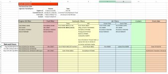

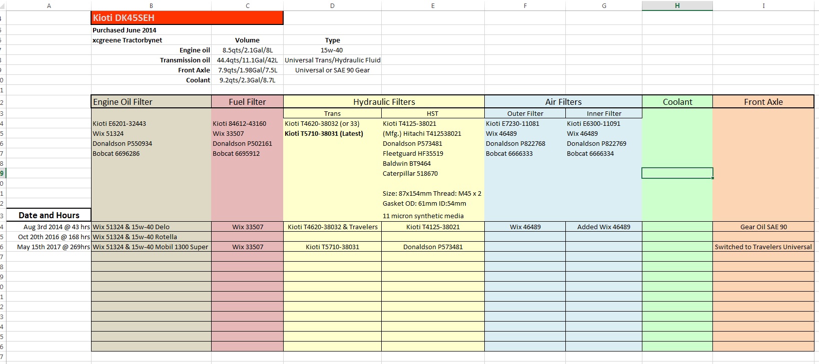

Also, Here is a Spreadsheet I have made of all my cross-referenced filters for my 2014 DK45SEH. I also have volumes, Types, and my own change history on there. Maybe others could find the format useful. I'm not sure if I can put the excel document on here, but this is a screenshot.
Why are the wix air filters for inner and outer use the same #s?
   / Kioti filter cross reference number list (all models) #79
Oops :ashamed: the inner air filter is supposed to be Wix 46490 (as a note, this inner filter did not come with either of my 2 DK45SEH's)
Updated
