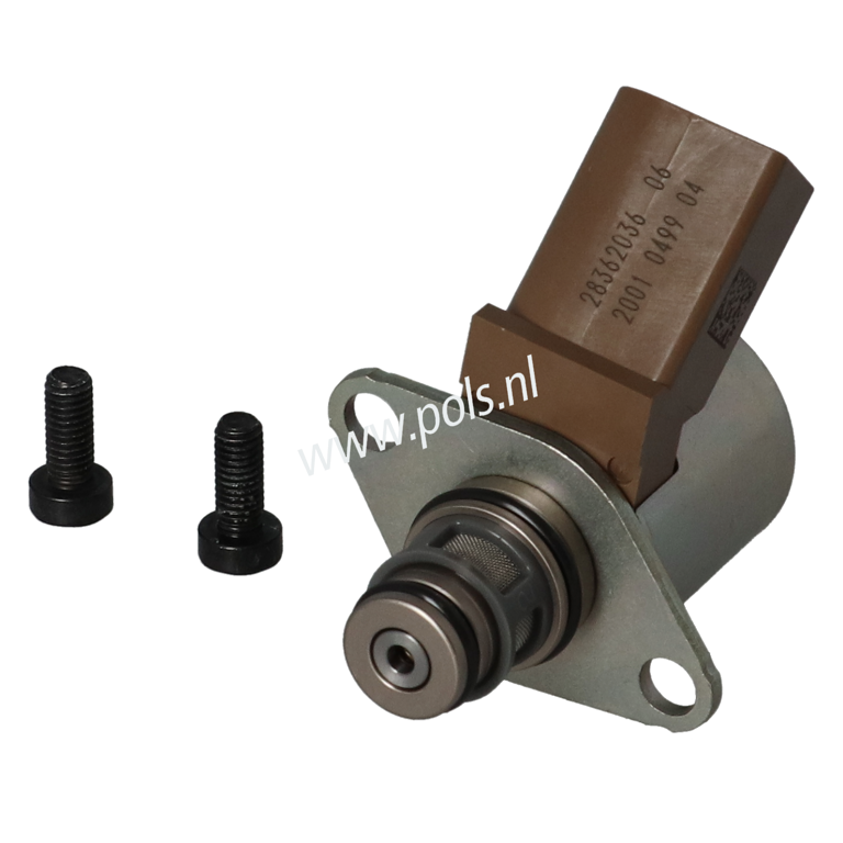

My 2017 Kioti CK3510 would not start. A dealer diagnosed the problem as a bad IMV Valve. The OEM valve (EH15-0016A) was quoted at over $800, and that was only for the part. Online research verified that that was indeed the case. My question is, with so many IMV valves available for well under $100 dollars, is there an aftermarket IMV valve that will work on a CK3510?

Check the numbers on YOUR valve. I think it may be a 28362036 , at least the ones I looked up for per your Part # were. NO promises and YMMV.
Image from a Dutch Kioti dealer

Thanks. How did you find what I am assuming is an aftermarket IMV that would work on a CK3510?
/ Kioti CK3510 IMV Valve Replacement #4
I just looked at the number on the pictured valve. I do NOT know if yours is the same. There is almost always some sort of interchange number on all the parts. Every OEM buys most of their parts from someone.
Look at YOUR valve for numbers and then see what you come up with.
