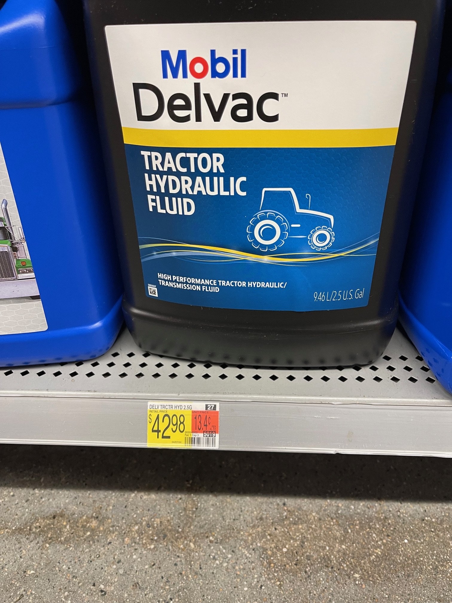

Poked around a bit today looking for HST oil, and that 424 was available at several places.
No luck around here. 2 auto zones and a Napa. Maybe those aren’t the best places to look?
/ KIOTI CK2610 fluid advice #29
The Delvac can be found at Walmart in 2.5 gallon jugs. $42.98.

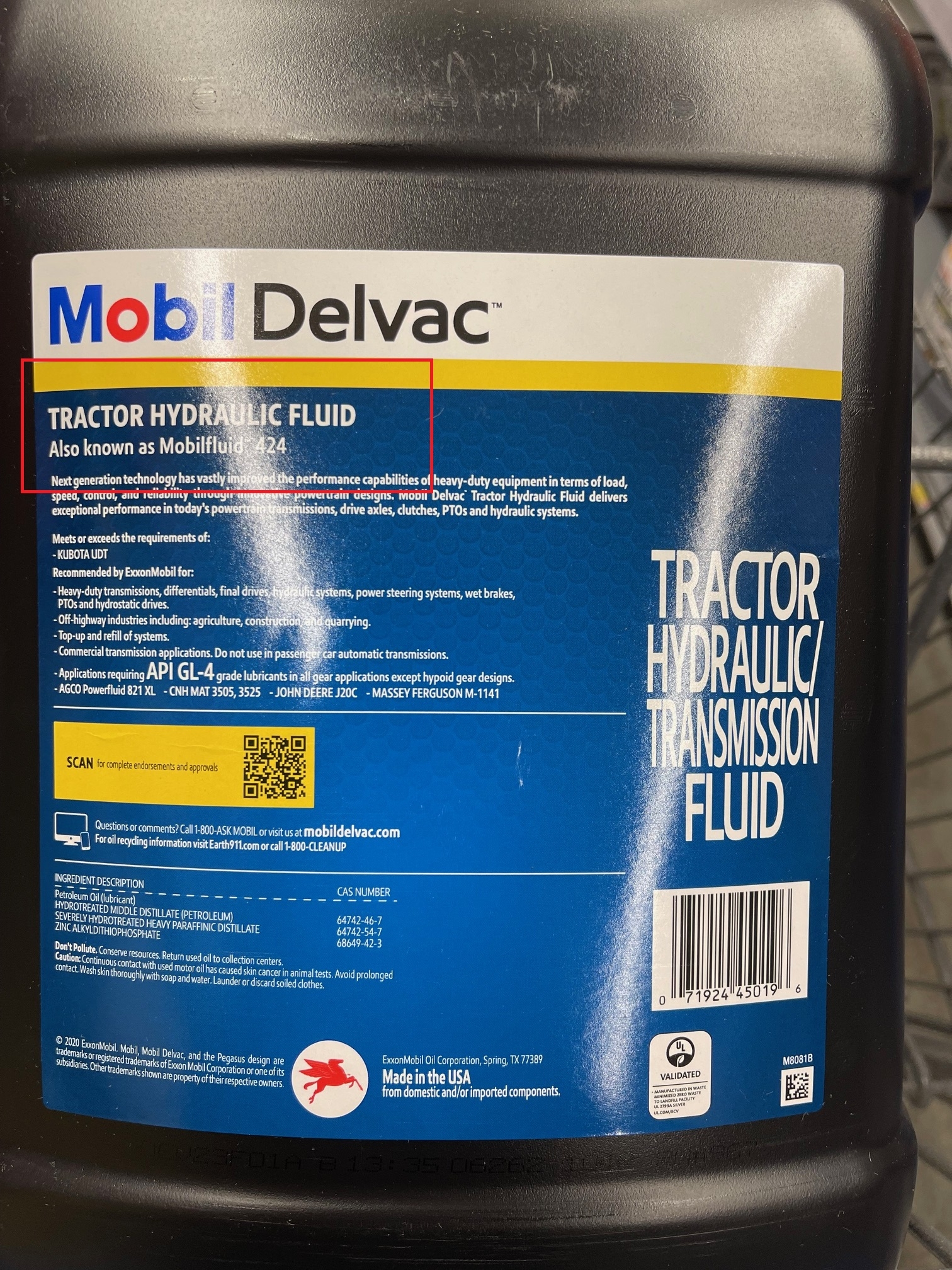

/ KIOTI CK2610 fluid advice #39
Well, saying it's suitable isn't quite the same as actually meeting spec in many cases. Amsoil is probably the most common example of that debate.
All of the approved Kioti fluids listed are also listed as JD20C compatible; not a 100% proof, but if your fluid you picked up meets JD20C, you're fine. Unless you believe that Daedong uses something so proprietary in the hydraulic system that only the 4 specific fluids are the only thing that will work.
/ KIOTI CK2610 fluid advice #40
I use delvec in my tractor. Like yours it calls for 424. If you read the delvec label it states it’s the same as Mobil 424. It’s works well in mine. No whine and strong loader functions.
