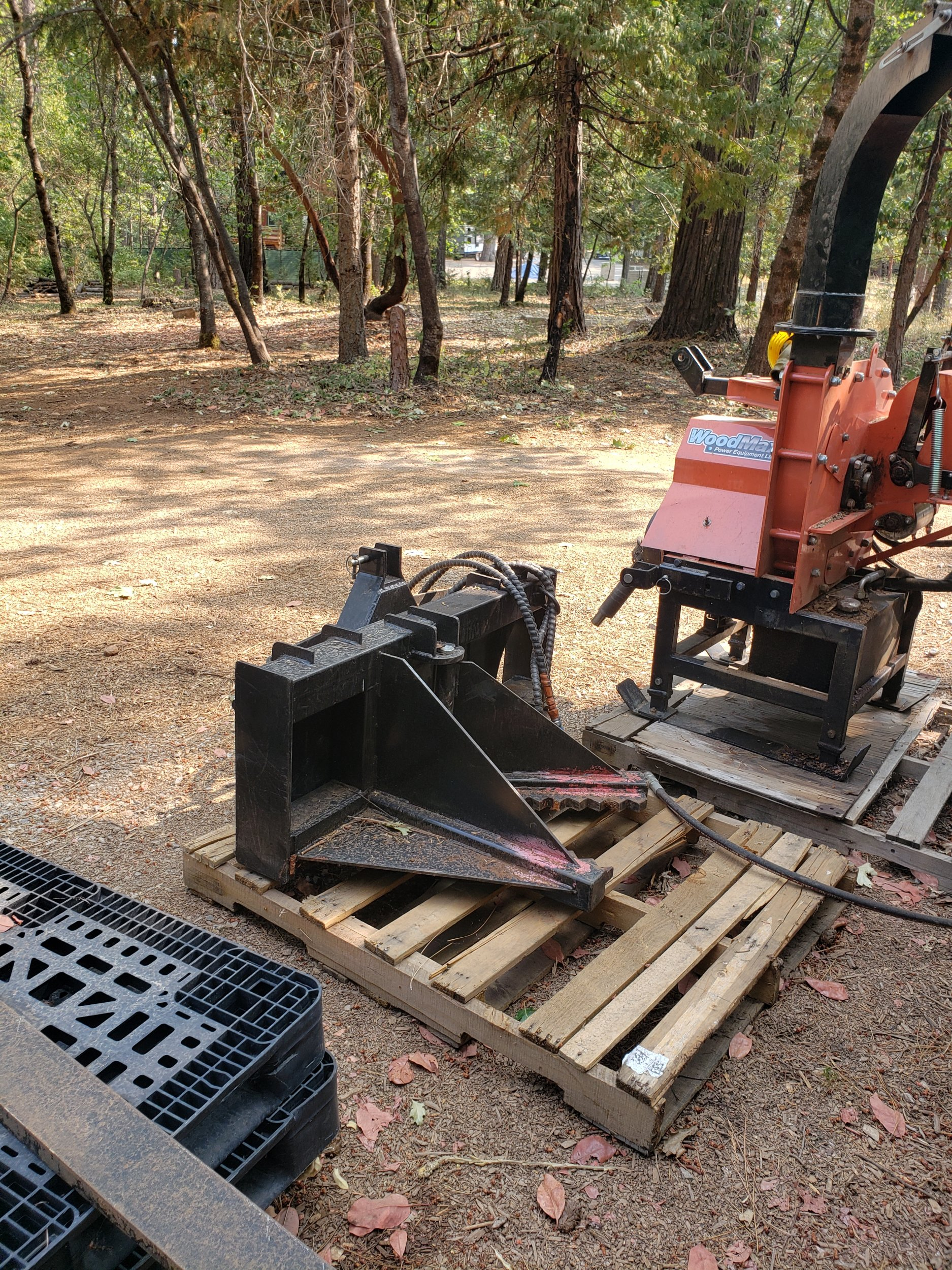

I was trying to pull a 6" diameter oak tree out of the ground with a fel mounted post puller. Push, pull and lift. It was probably the 100th tree I pulled. It just caught up with me and the tractor. Its pictured with a 3 point adaptor attached
Wow, I would not have thought that would have broken your tractor. I would have thought the relief valve would have just opened and that would have been that. I have done a lot worse.

I was trying to pull a 6" diameter oak tree out of the ground with a FEL mounted post puller. Push, pull and lift. It was probably the 100th tree I pulled. It just caught up with me and the tractor.
"You scarin' me." :oops: I'm gettin' ballasted and loaded rears off the ground often with a similar grapple doing the 'push-pull' on my T1520 w/110TL and on 3-4" trees in light soil. While I'm adding SSQA to the TC33DA's more powerful 14LA not sure anymore I couldn't bust the tractor. Elms have 'side' roots/runners and might rip a lot of sod coming out, but oaks have tap roots. They're no joke and why I bought the DR stump grinder.

I bought the tractor used with 1800 hours. I have no idea what it was used for before I got it. The fel it came with was the wrong one for the tractor. I had to do some reinforcing of the mounts to get it to hold. Thats probably one of the reasons why it broke. I broke it with about 2100 hours. I freely admit I abused the poor thing. To complete the tasks I had, I made the decision to replace it with a Kubota M6060 and have the property professionally masticated. Now I wont have the need to abuse the tractor and, I have enough tractor to the jobs I'll need it for.
