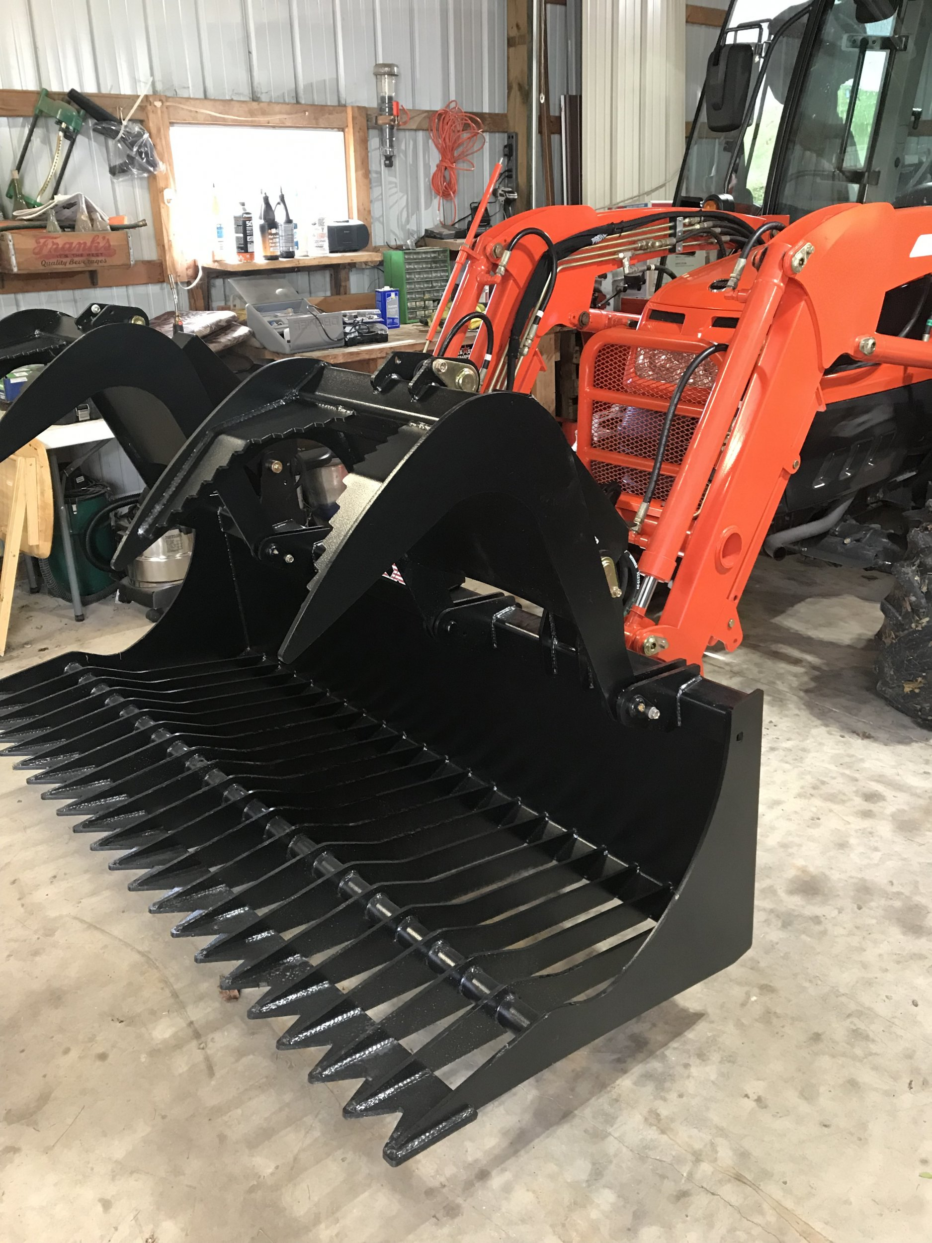

I think I might take off my grapple. I don't want to break my junky tractor in half. Maybe I can get a smaller bucket for my loader.
