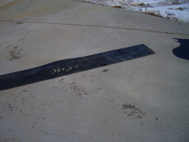

I've used reinforced rubber mat, like conveyor belt material or an old truck bed mat, sandwiched between the blade frame and the removable blade. Works like a squeegee over the dirt and limits the damage.
TomK, this idea is new to me but I think I understand what you mean. How much material did you leave extending beyond/below the bottom edge of the cutting blade?
Sorry it took so long to get back to this. I just leave about 1" to 2" below the blade so it supports the weight of the blade and holds it just above the surface, but allows the metal blade to scrap the high icey spots. I got his idea from an old TractorByNet thread.
