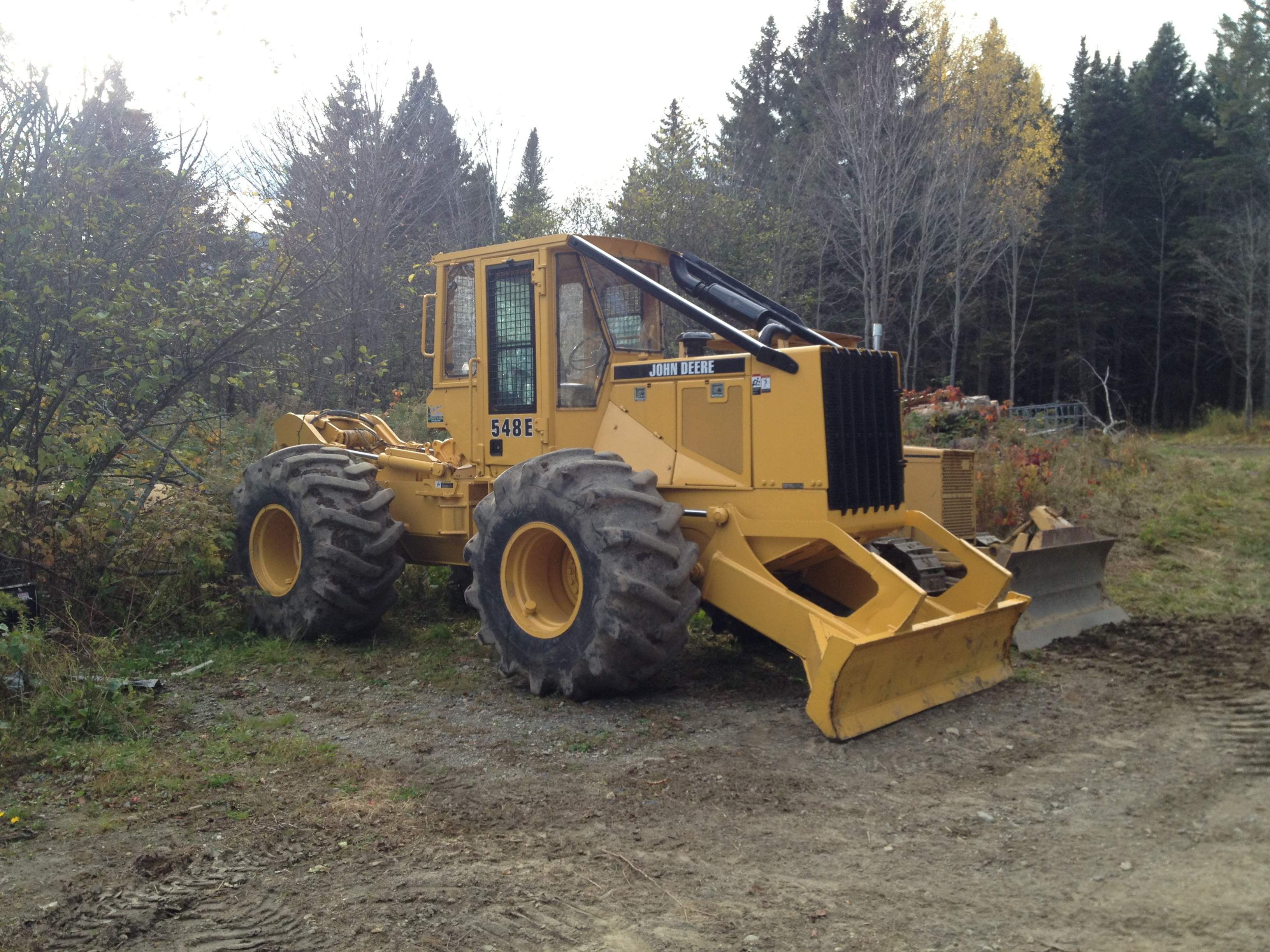

1994 JD 548E grapple skidder
121 hp 6 cyl turbo. 20 ft long. 9.8 ft wide. 22801 lbs. 6 ft grapple opening. 200 ft of 1/2 cable on an 38000lb winch.
Overkill........ Maybe. This is my old but still good logging tractor

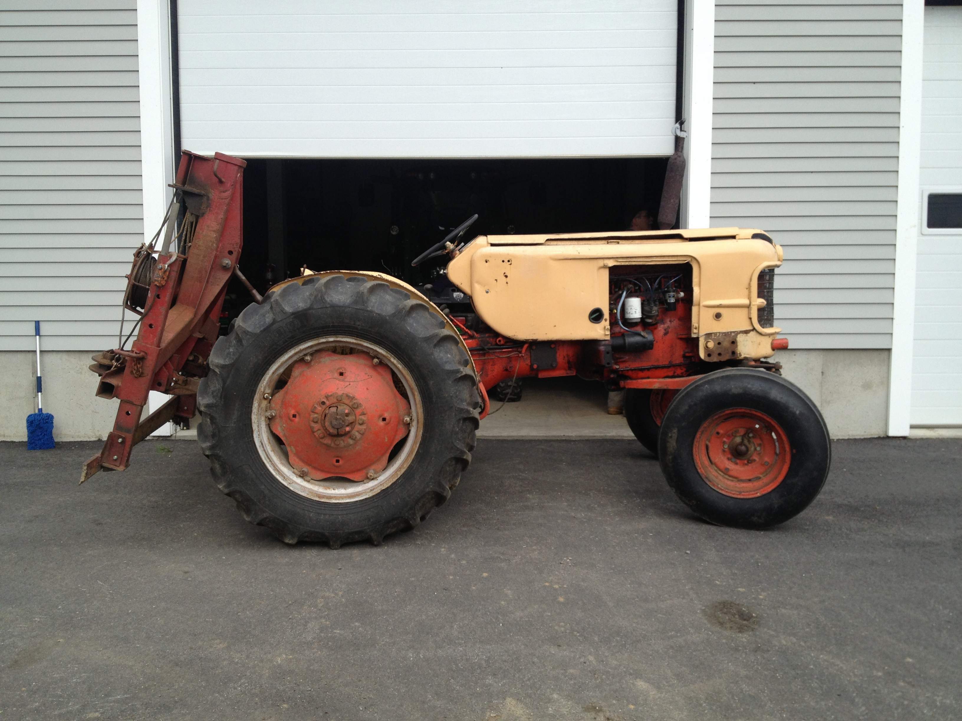

Case 300 no clue what the winch is.

I'm gonna go out on a limb here and assume that skidder was quite a bit more than the $1500-3,000 you can buy a grapple for?
For my low impact hobby logging needs, I'd take the Case 300 over the skidder anyday. :thumbsup: Nice looking skidder though.
/ Kena 3pt log grapple #58
Yeah it cost more than just a grapple, A lot of my land is hillside and is to steep for a tractor, the long distance of tractor roads for the amount of wood you can pull in one hitch just wasn't worth it. The skidder doubles a tractor. Me and my dad own a small construction company and it does work better than a tractor would have. I stripped a gravel pit back with the excavator and the skidder was able to haul off the brush with all the stumps still on the trees, it is quicker to clear house lots to.
Ground impact is not to bad for what the machine weighs, not running chains helps. not saying everyone needs a skidder I just didn't think a tractor would have done what I wanted it to. The skidder did cost less than my 5095M JD though.
