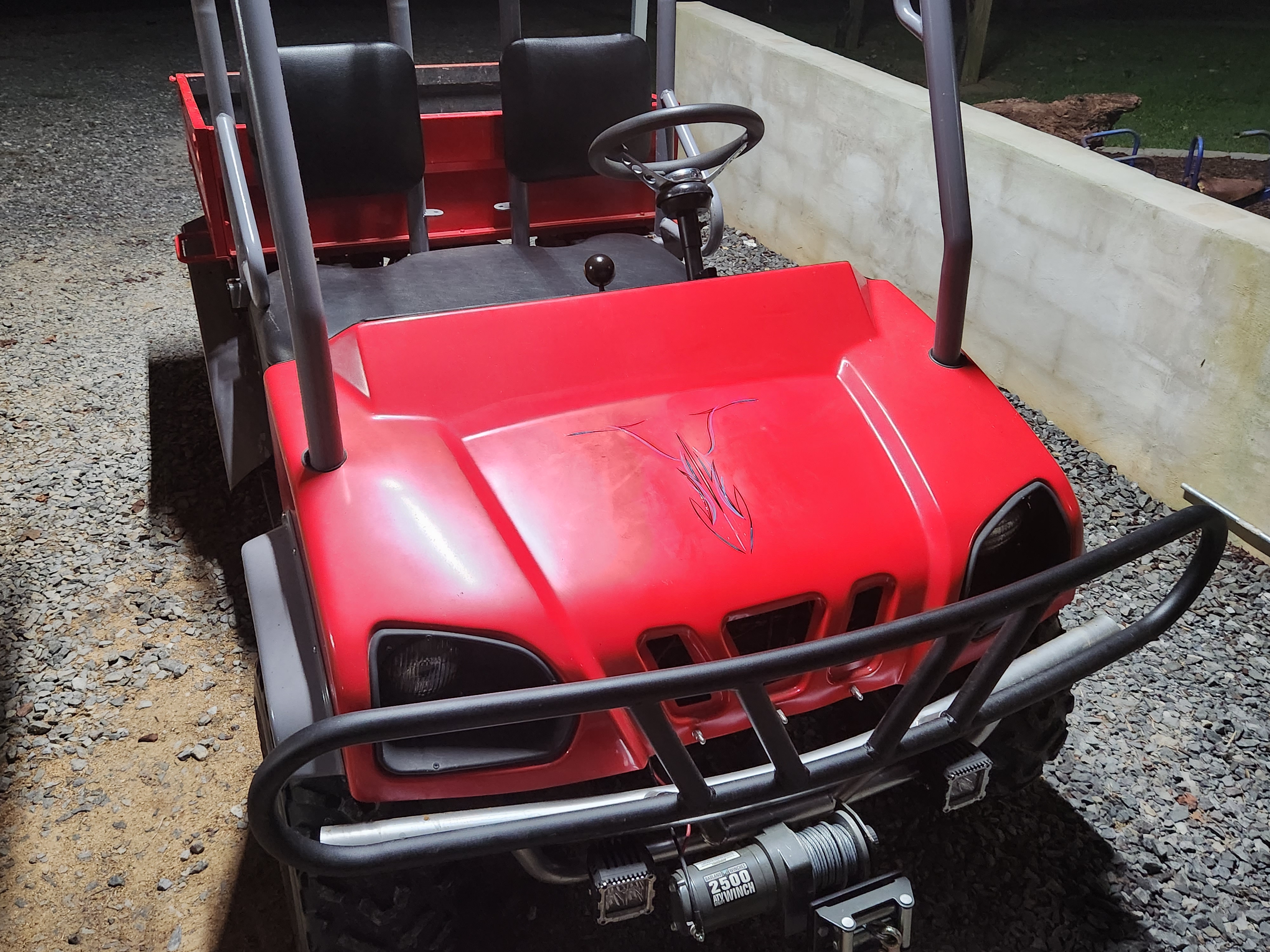

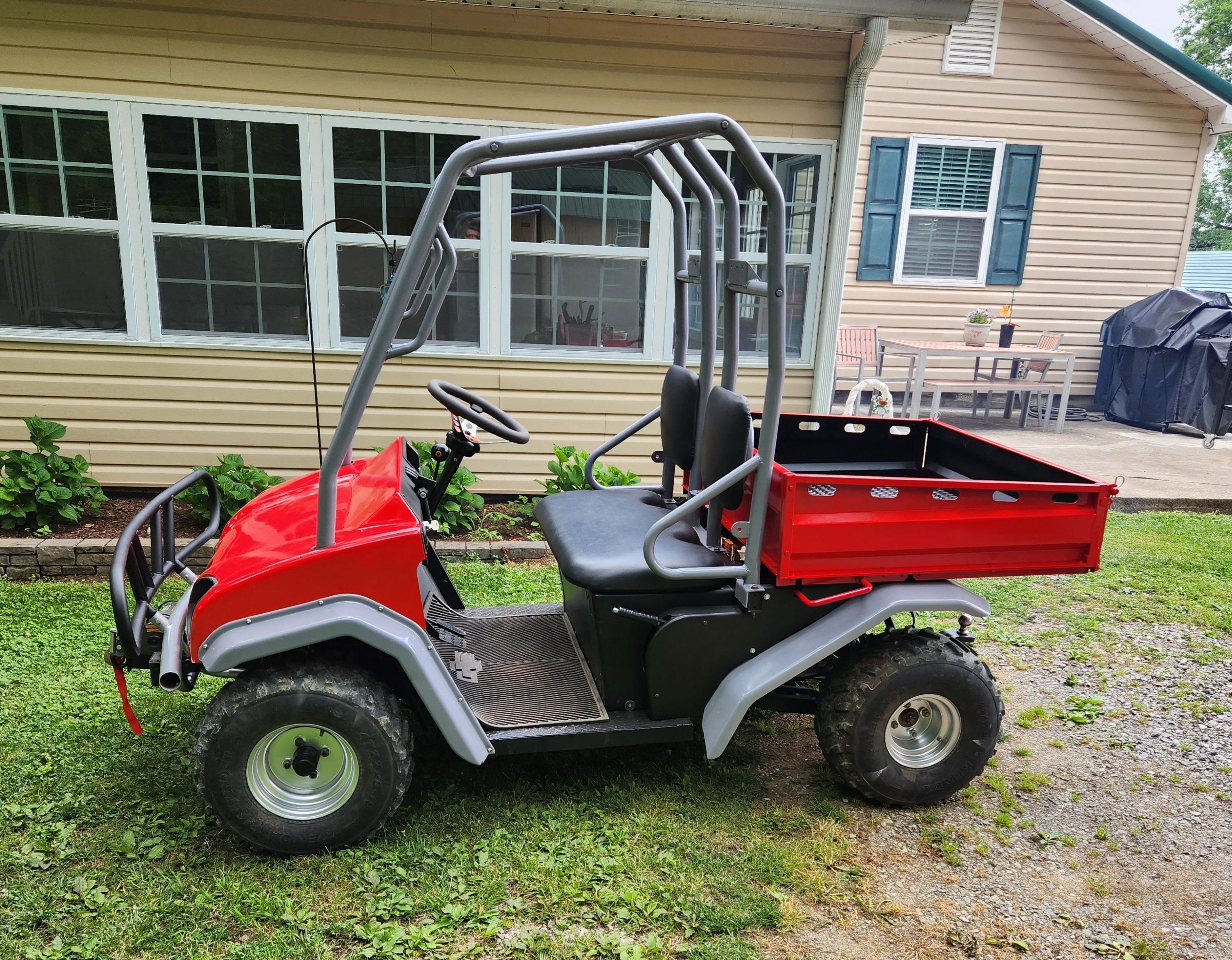

Hello everyone,
I'm Jim, this is my first post.
I am restoring a 2004 kawasaki mule 550, and I want to add a linear actuator to make the box a dump bed, dose anyone know what the stroke length of the factory unit is. I have several here I can retro fit and not spend the $1,200 for an oem part. Thank you, Jim.

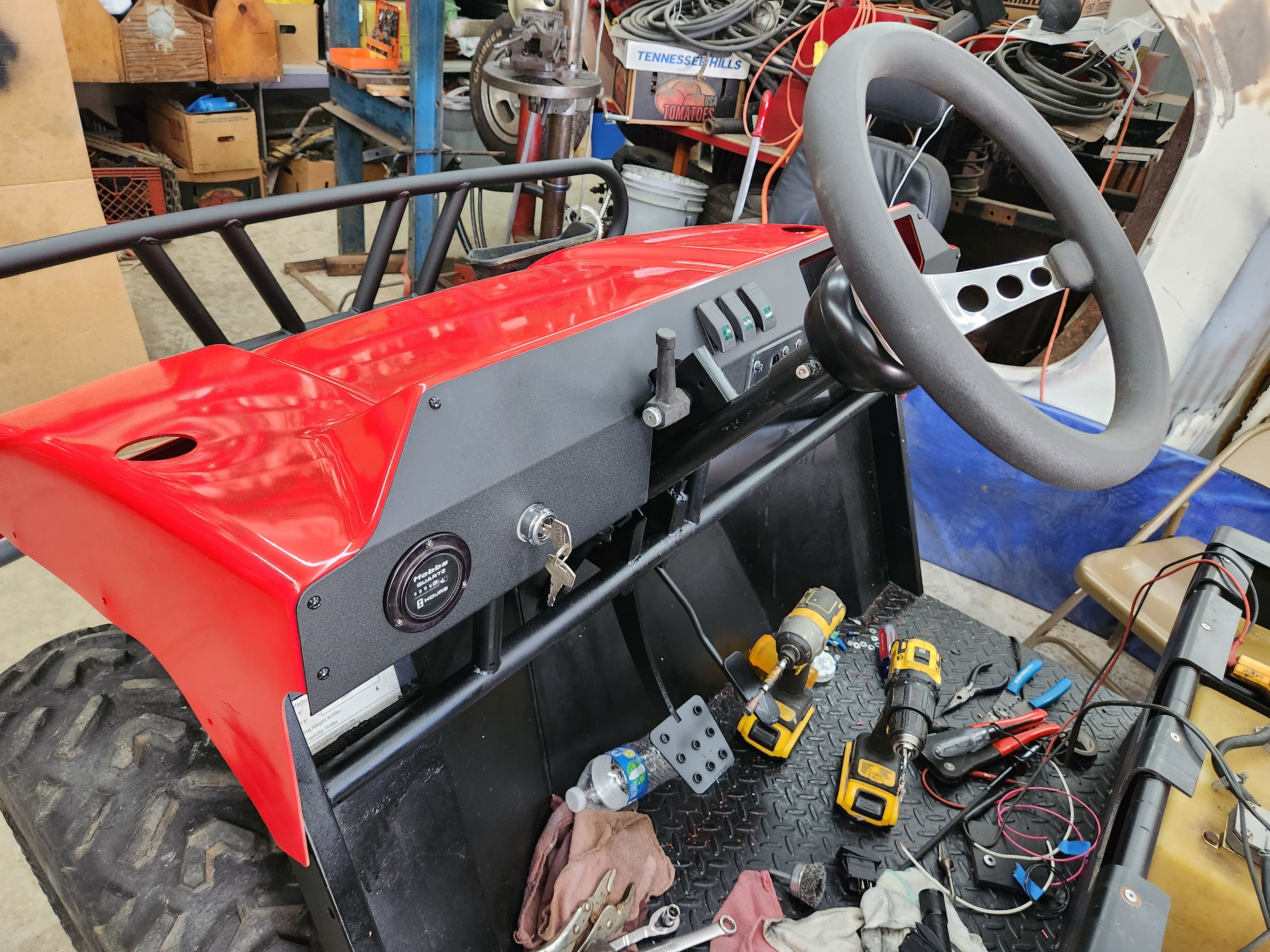

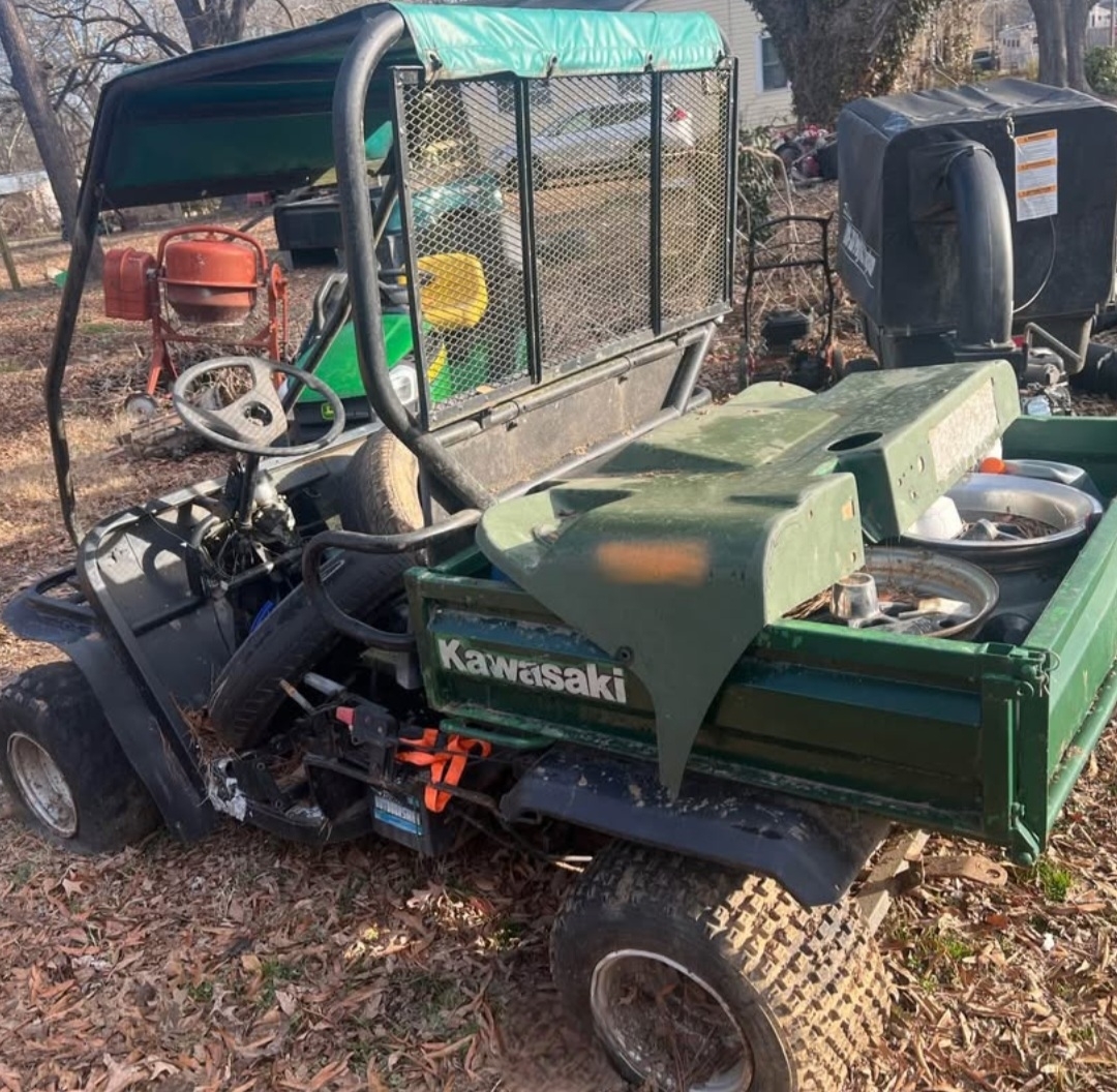

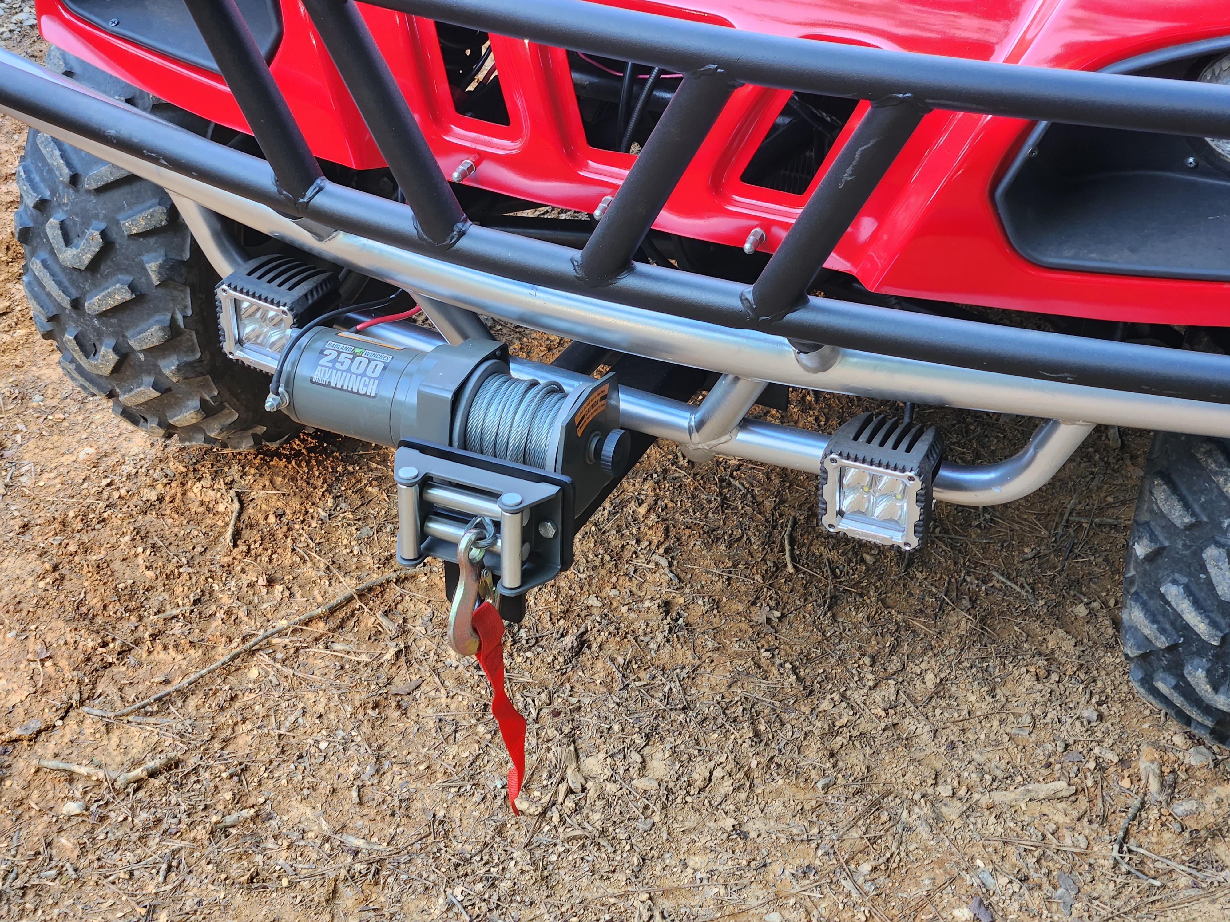

It's a bit rough now, but I have done a couple of them.
My last project, it was rougher than the Mule.
Thank you.

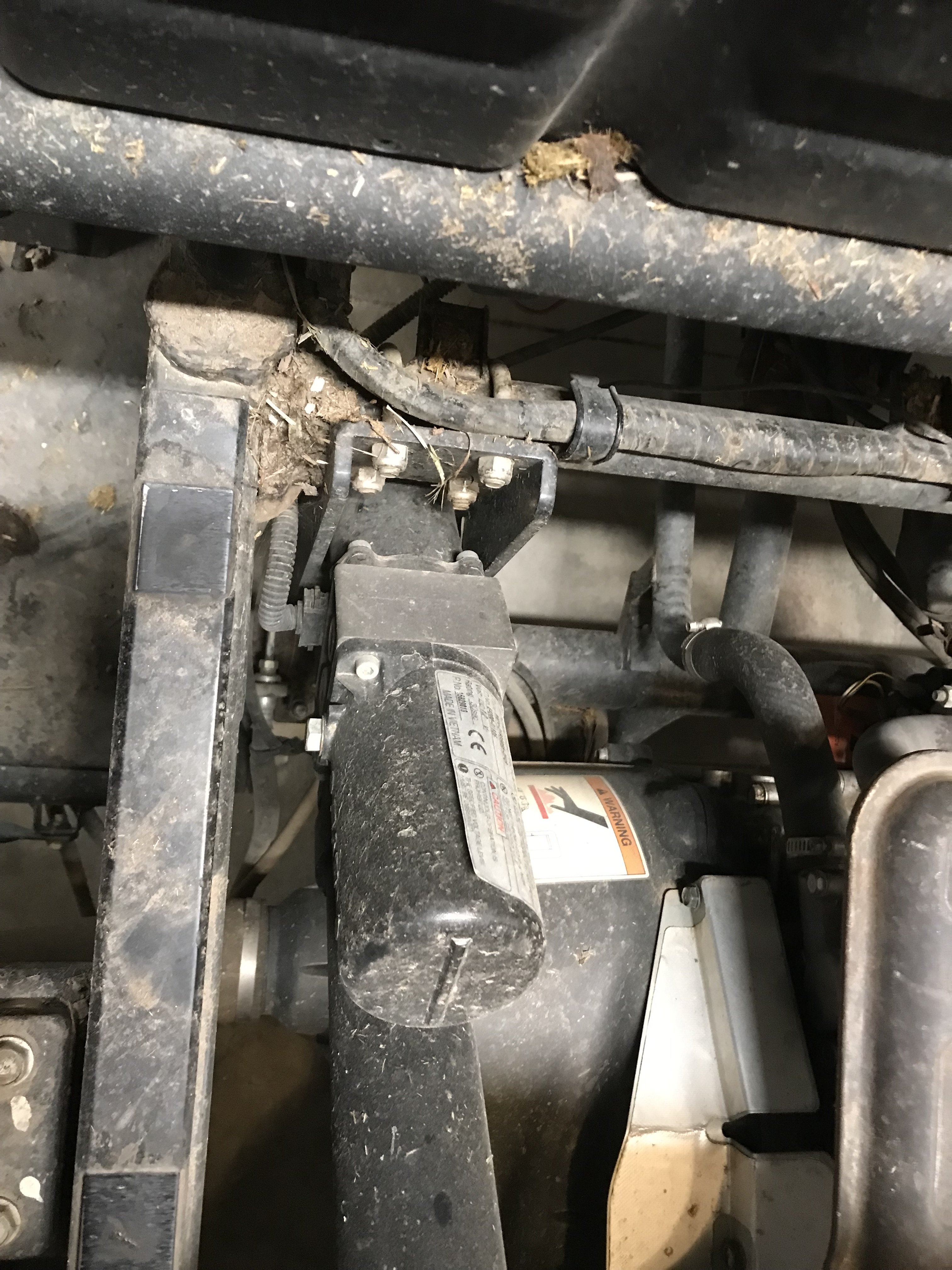

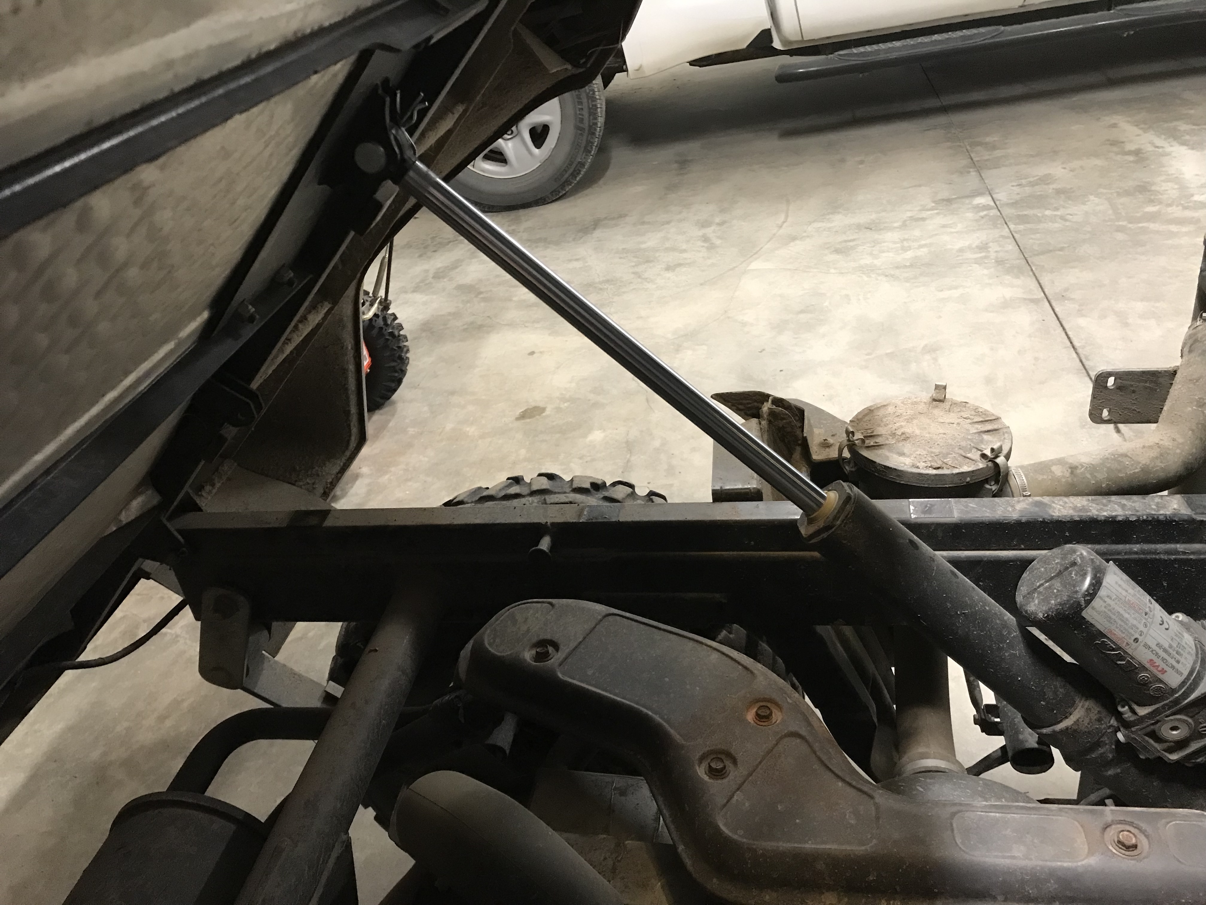

See if you can source a parts diagram. Then call Kawasaki with the part number and ask them about the cylinder specifications.

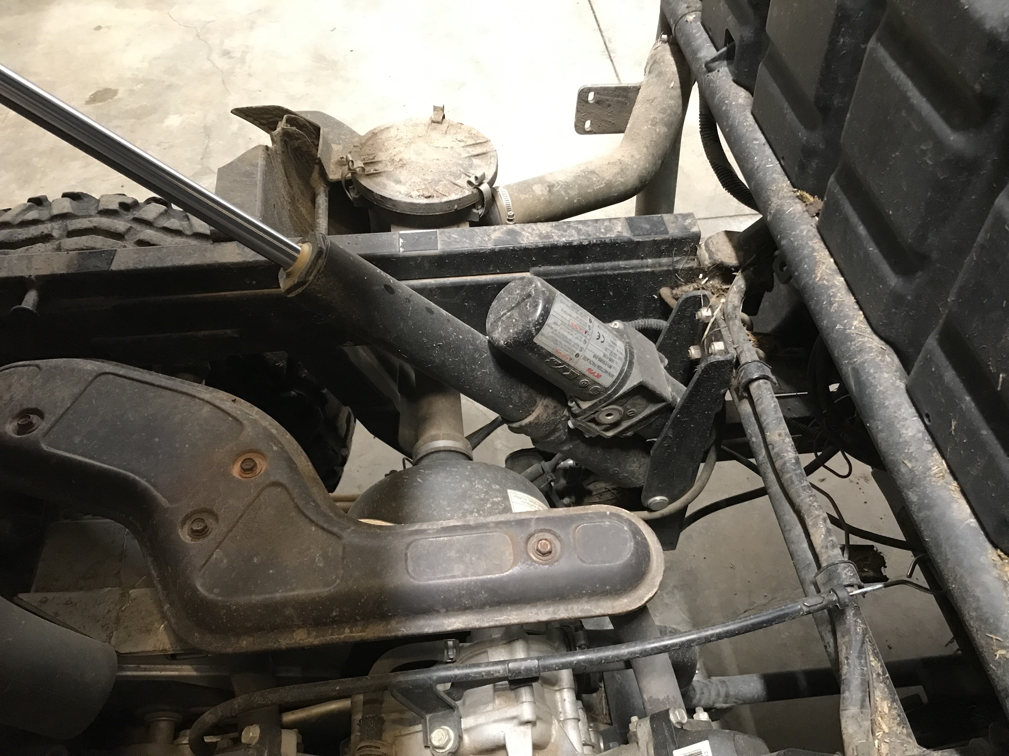

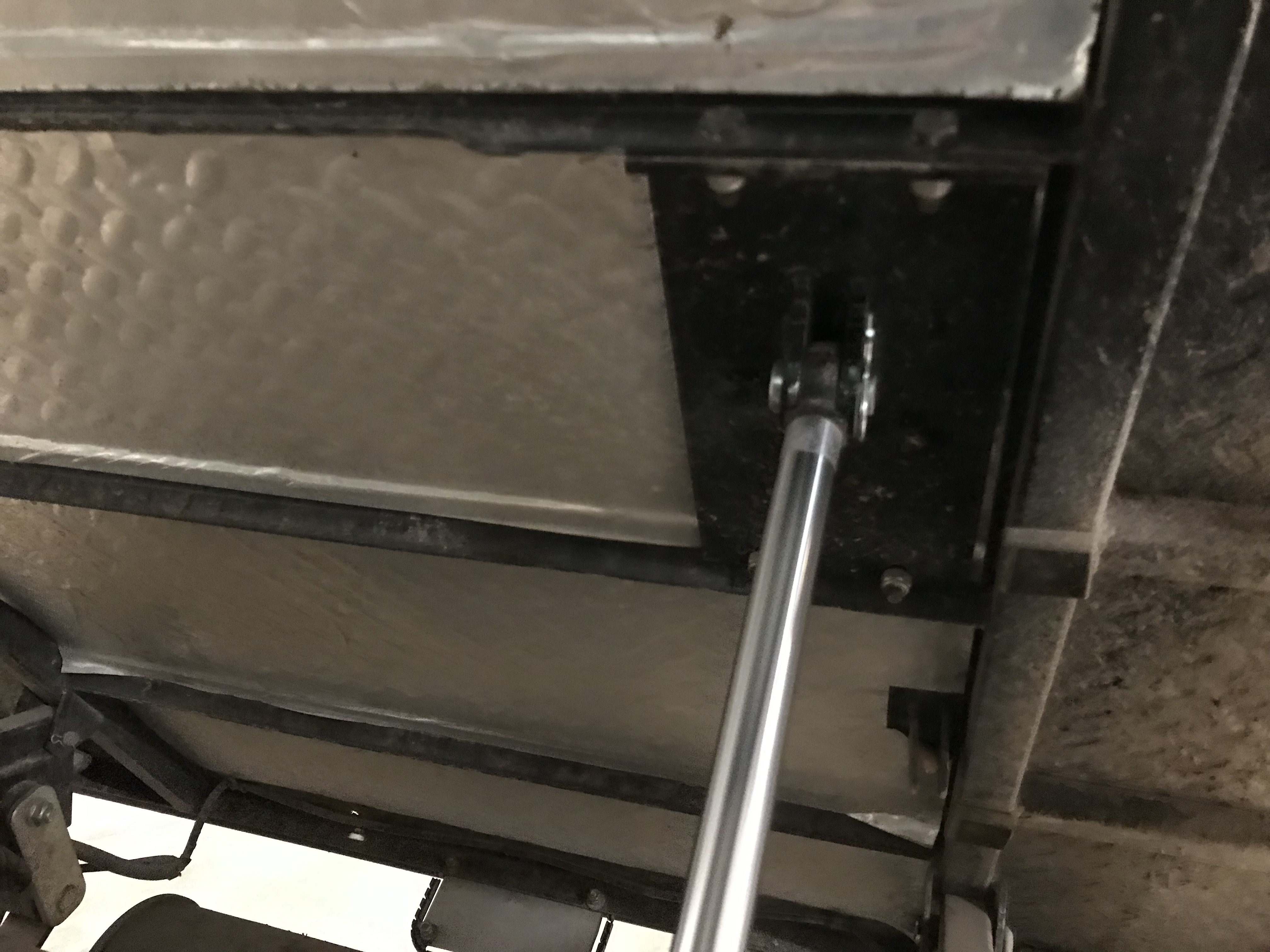

   / Kawasaki mule, dump bed question #4
Ok, shaft is 14” long
Heres some pics
   / Kawasaki mule, dump bed question #5
This is on a 2012 mule 4040
