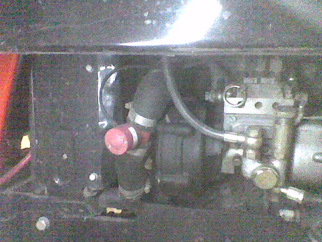

Sounds like you just got a dud. I have also heard of these getting moisture in the end cap where the electrical wire goes in. This causes corrosion and shorting. We talked about this on the phone so I know this is not the issue with yours but like I mentioned I suggest to anyone installing one to put a dab of RTV or silicon on it to prevent water getting in and also take some care in mounting it so its less likely to get wet or be able to drain any that may creep in the electrical input end of the heater.
This is what the lower radiator heater looks like. It simply goes in the lower rad hose by cutting out a 1.5" section and using the supplied clamps to secure. They have many sizes but the 146000 is a 1.5" diameter unit and is what the Jinma 200 series tractors use.
Good luck Steve.
Chris

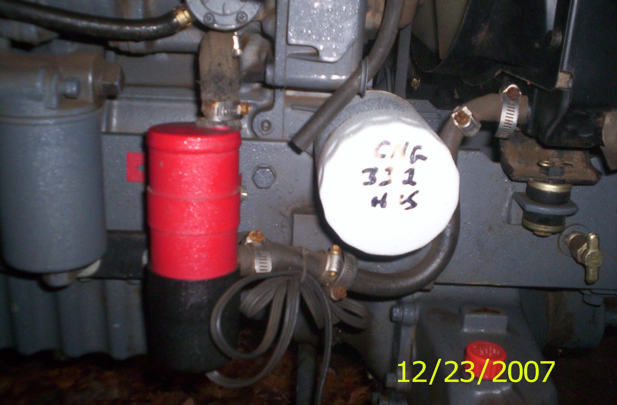

Here is my heater. Been in for 4 or so years with no problems. Pic taken with cell so sorry about the quality.
Chris
