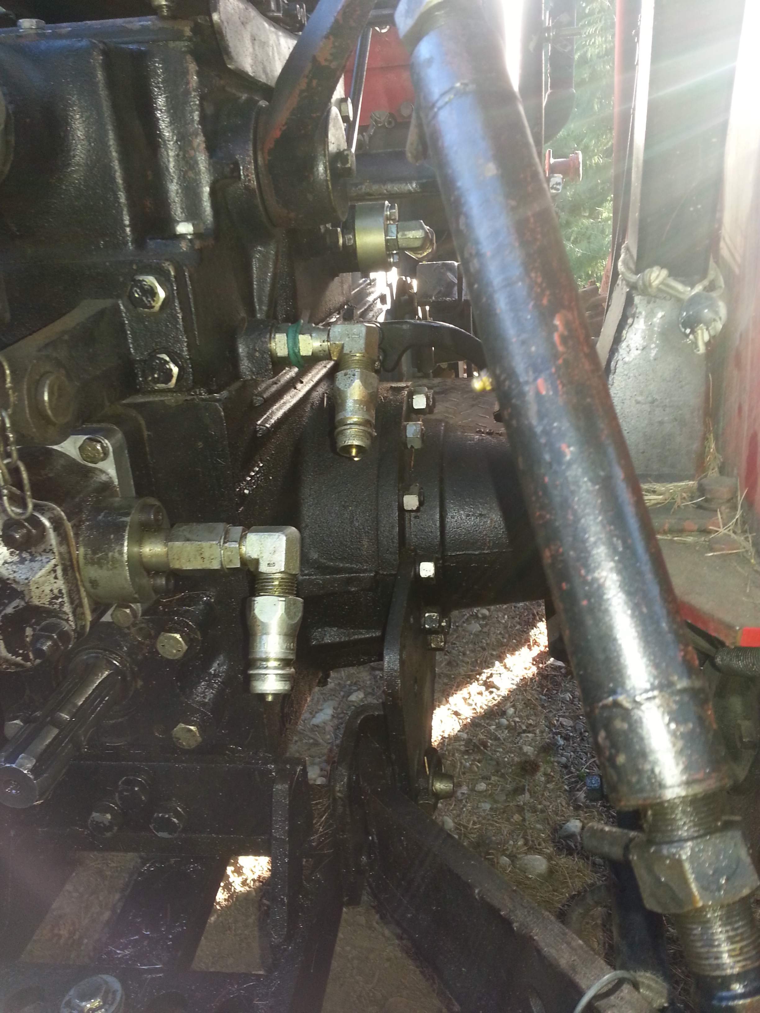

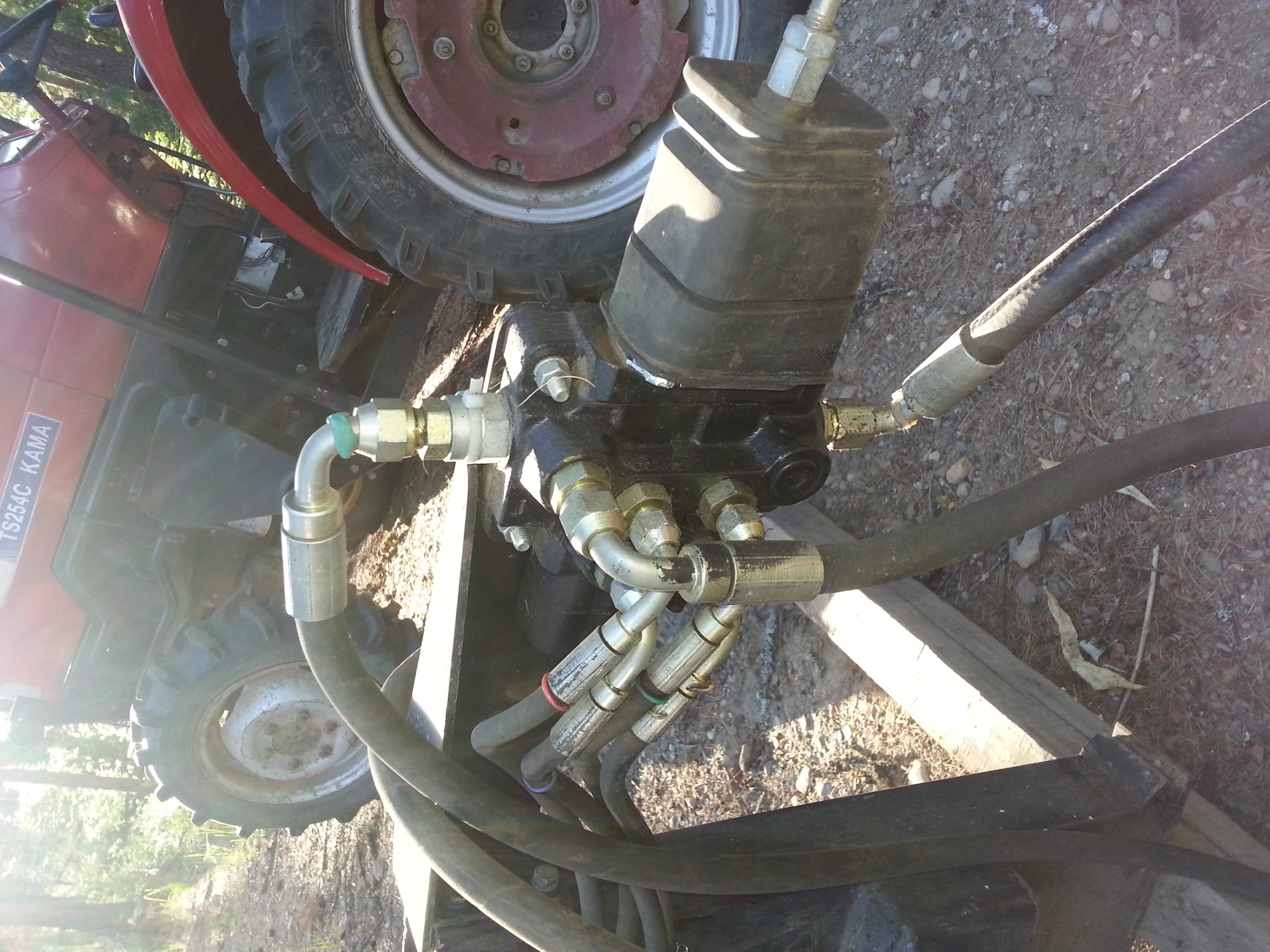

Can someone please tell me which hose goes to the appropriate connector on tractor?

I see 7 hoses, so you have an open center valve with PB.
The pump hose goes to the IN port of the loader valve. That is the hose coming into the valve from the right side of the second pic.
The PB hose is the hose connected to the left side of valve with green markings.
The OUT hose goes to a return line.
The PB hose goes to the mid or back for a remote valve or the 3pt.
You then have two work port hoses for one set of cylinders, and another two work ports for the other set of cylinders.

I'm surprised you can't figure out the connections based upon the length of hose and type of connector. I used to have photos of the hydraulic hose routing on my TS354C, but I lost them when a hard drive crashed. So best guess - on the tractor - from rear to front - it appears you have you have pressure/PB/return. On the controller, the four grouped together are connected to the loader cylinders. The hose coming out of the bottom of the controller connects to the pump. The hose with the green band should be Power Beyond, would seem logical to connect it to the tractor fitting with the other green band. The last one then - just above the 4 cylinder hoses - should be the return.

In your picture of the tractor, second pic, the quick-connect closest to the camera coming out of the pump goes to the "in" port on bottom of the valve (right in pic). The quick-connect farthest from the camera supplies the 3-point and gets connected to the Power Beyond port on the valve which is coming out of the top (left in pic). The quick-connect in the middle in the tractor pic is the return line which connects to the Out port on the left side of the valve (closest to camera in valve pic). The return line connection on the tank is also the tank drain.
I don't have your exact tractor but it's similar and we are going by what is typical in terms of the valve connections. Look at page 30 here: http://www.koykermfg.com/images/koyker-manuals/155.pdf and the power beyond setup is about what you have.
Those connections should be color-coded and it is confusing that you have a green band on the power beyond port of the valve and the return line on the tractor which does not make sense. I recommend you get some colored electrical tape and code the connections.
Per JJ's warning, you should not start the tractor in the condition shown in your second picture (and you will have to start it to connect the loader). A hose with 2 female ends should be connected from the pump outlet quick-connect to the 3ph inlet quick connect. Otherwise the fluid from the pump will be dead-headed which will severely damage the pump. EDIT: While you have the jumper hose connected, make sure the 3-point operates. If it does not, try the other quick-connect in case I was wrong about which is which. Nothing will be damaged if you connect the pump outlet to the return line but the 3-point will not operate.

Look at your tractor picture. Can you identify P? That's the pump line. It's the QC closest to you in the picture.
If you take that middle QC off, the one with the green band, I think you will drain your sump. So let's call that T for Tank.
The front most of the three in the picture must the the lift...a "load beyond" the loader valve, so that would be a great place to use "power beyond."
If you just want to start the tractor, connect pump to either of the remaining connections, but I'd suggest the front QC so you can try the lift.
Don't be fooled by a lift that is up, but won't come down under gravity. I have to stand on my upper arms to get them to go down, and yours could be doing a bit of that. My lower lift links are removed for the digger, so it could just be mine that needs additional weight to go down.
I could be wrong, I suppose, but there is wrong and then there is CRACK wrong. I believe if you hook the pump to either place, you can start the tractor without ruining a pump, but if that were my ultimate goal, not testing, I'd hook pump to that closest port, the one I am calling T.

Did you ever get it hooked up? hose coming out of top of valve is Power Beyond and goes to the front most connector on the tractor, on most valves the hose going into the bottom of the valve is the pressure port, it will go to the pump. the one that is left is teh return line and it goes to the fitting in between. THis is where the drain plug was and is the location to drain your hydraulic oil also. Once hooked up if all works OK you might switch some ends so not all ends on the loader are female, it will simplify hooking up. If your 3 point does not have pressure I suspect you may have sent the return line to the lift box instead of the Power beyond line.
