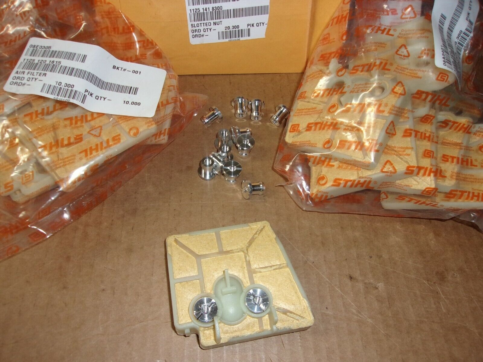

#1,632
Found a gold nugget. If you know you know. ;)
NOS set. 1988-?
