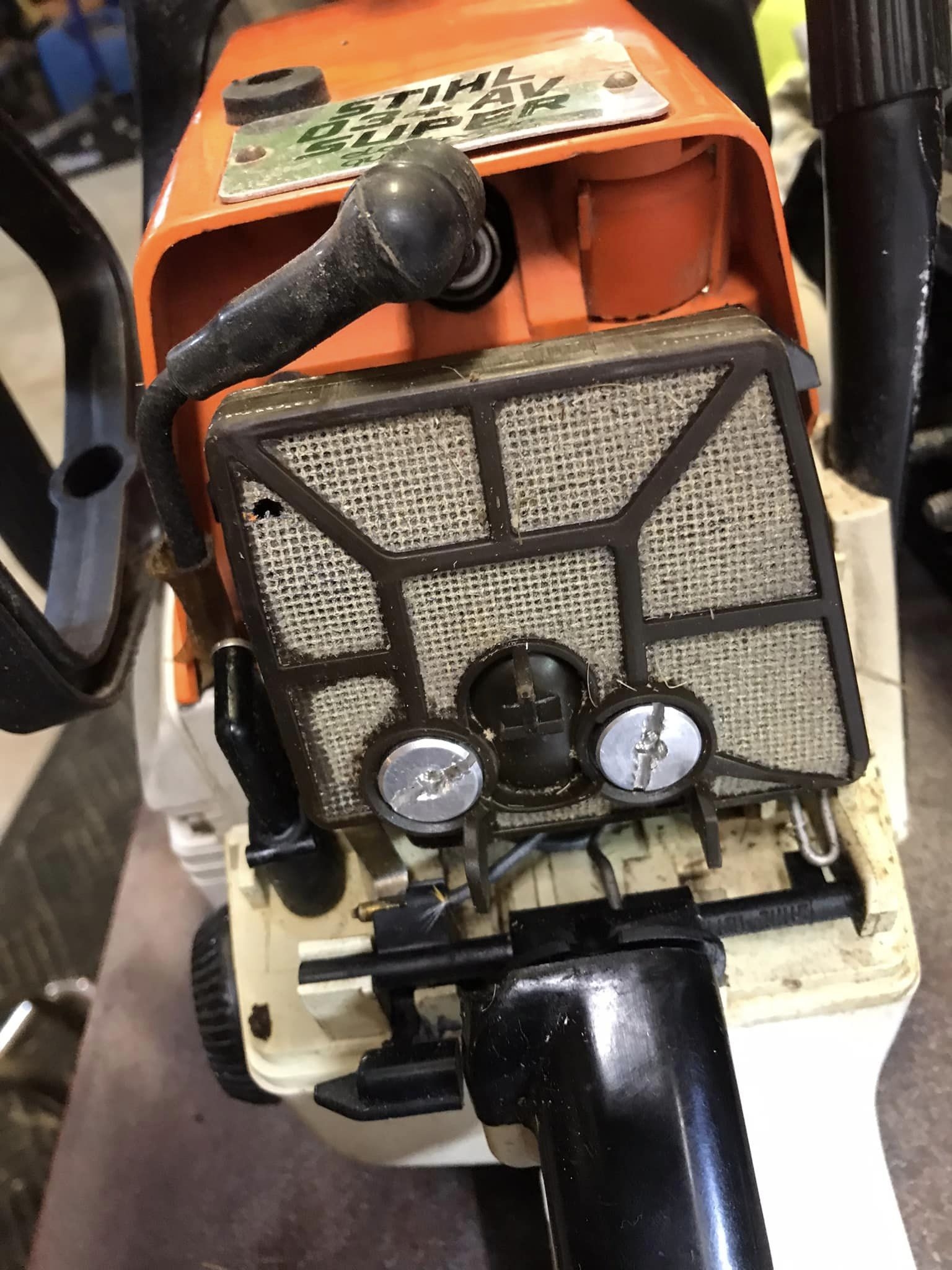

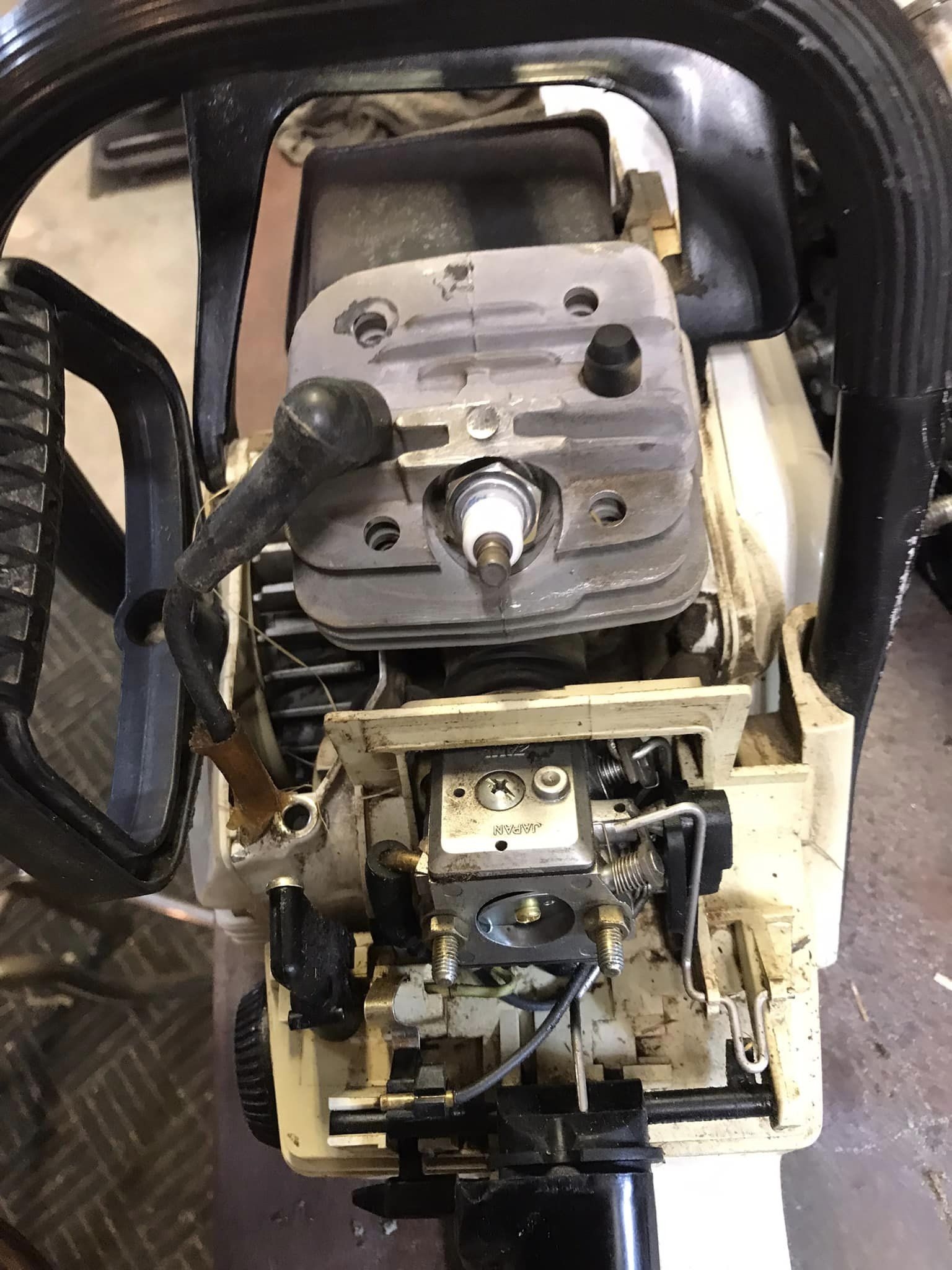

Hated seeing this one come in hurt. Stihl 034 super.
I'm only one that has serviced it since new. Think he said bought it new in 90-91.
Owner older and saw fell out of tree trimming some limbs. Now he wears duct tape bandage on air filter done by owner.
I ordered him a new oem air filter. Besides the hole that got poked through. He took a brush to the flocking. Which isnt good to do. Lot missing now.

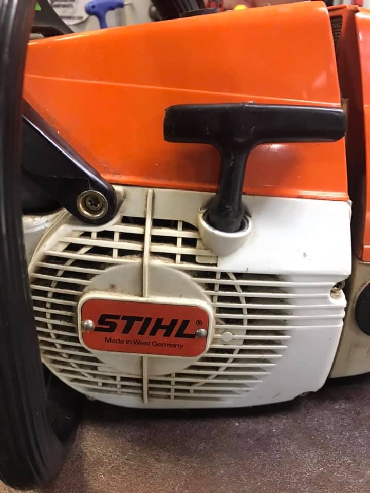

Old pic showing West Germany on recoil.
It wears a 460 rescue handle now. This thing is strong and great psi. Getting older suks for him with no decomp.
Also updated it to 2 pawls instead of 1 like came when put new pulley in in past.
