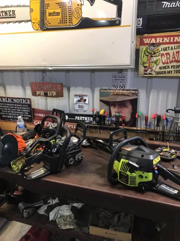

Talking to local about his Farmertec G372xp pro yesterday. He has 4 tank through it so far with zero issues.
Told him he gets to 10 or so bring her in for a retune to let her really eat. I set her little rich from new.
Then can see if all else is well too.
He is happy with his saw is all that matters. First clone for him.
Also tuned a PR5020 for him for his back up smaller saw 50cc.

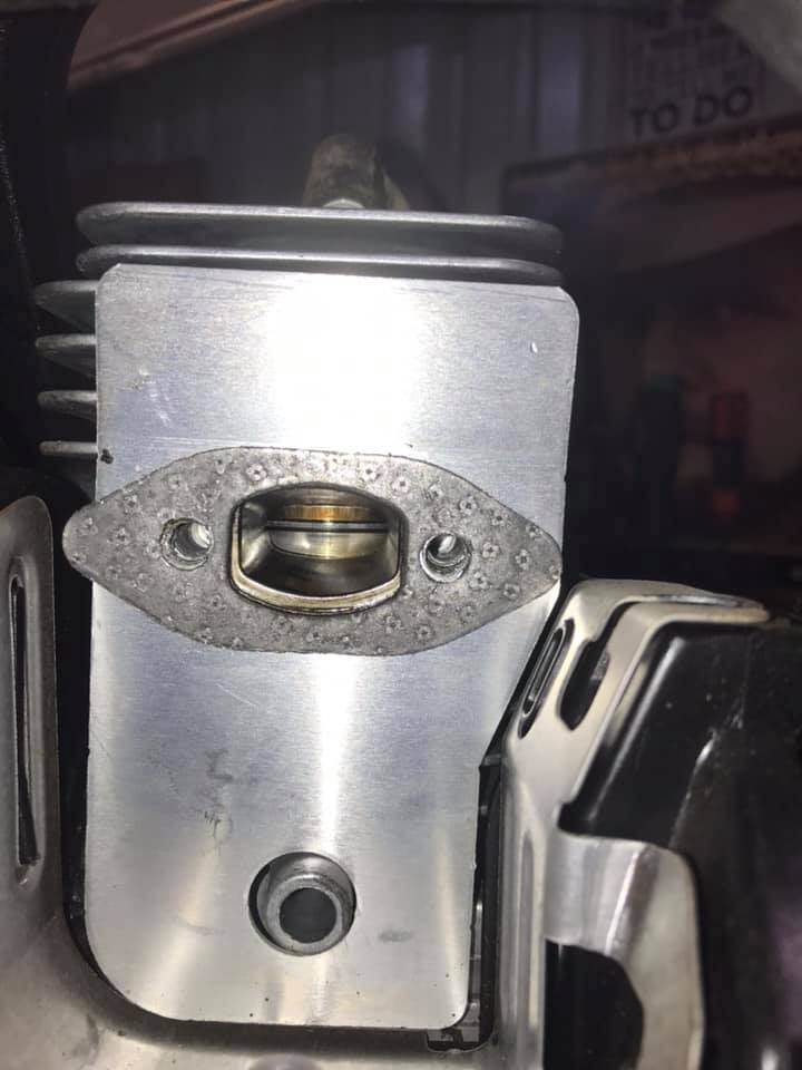

46cc
Like the 2 piece muffler on the 99 2750 better then the newer 1 piece ones. So going on this 2005 295.
Funny how the newer did away with support bolt. Well she is thread and back in this one now.

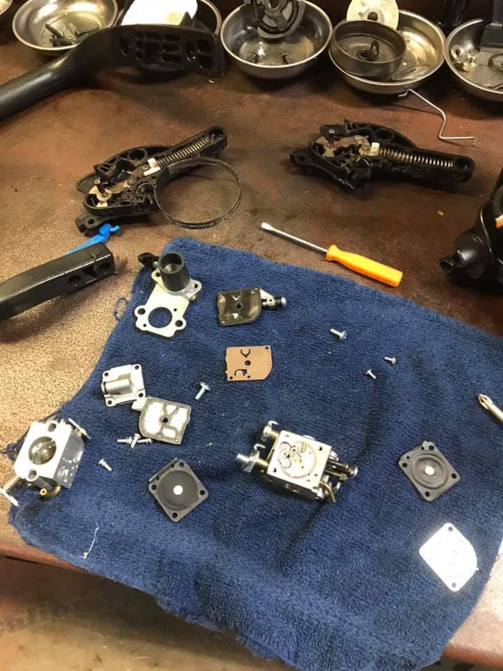

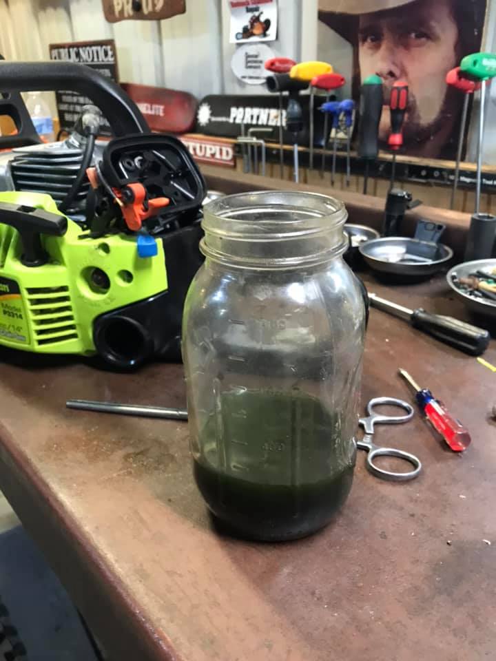

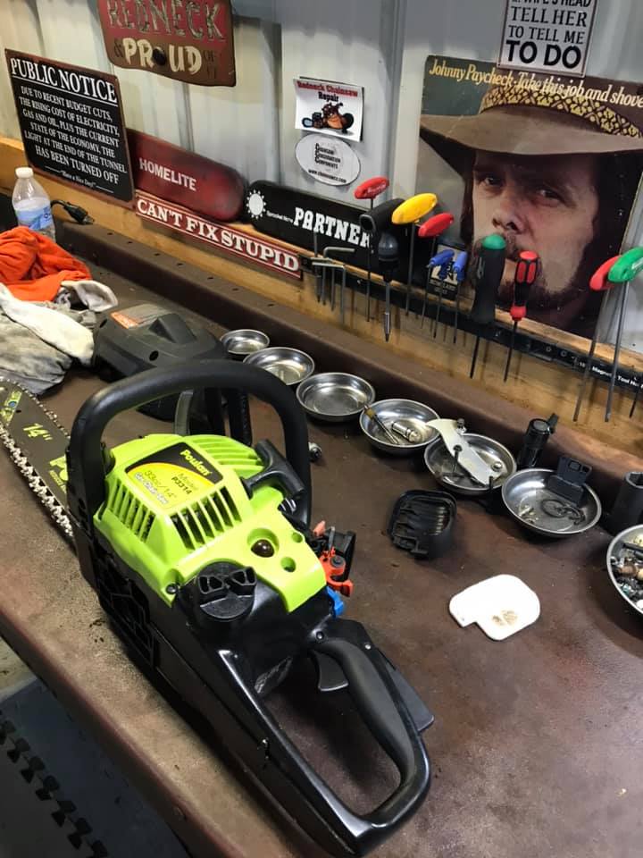

Drill hole run regular 3x5 echo fuel line. Runs after carb rebuild.
When my long curved forceps cant reach the angle cut line at top. I do this.

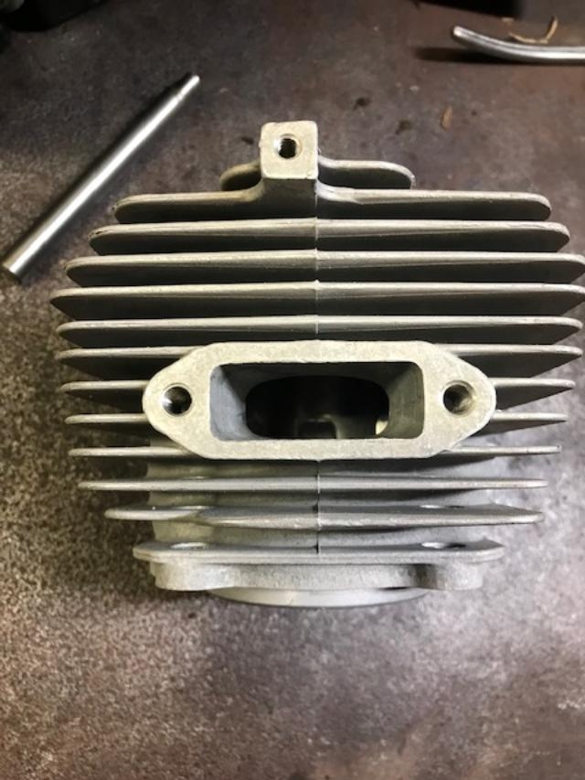

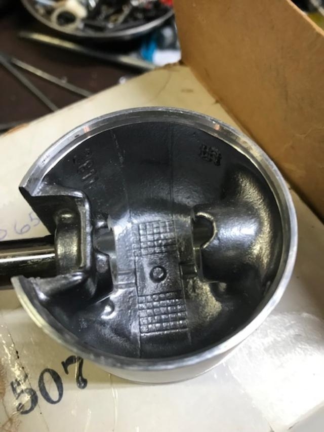

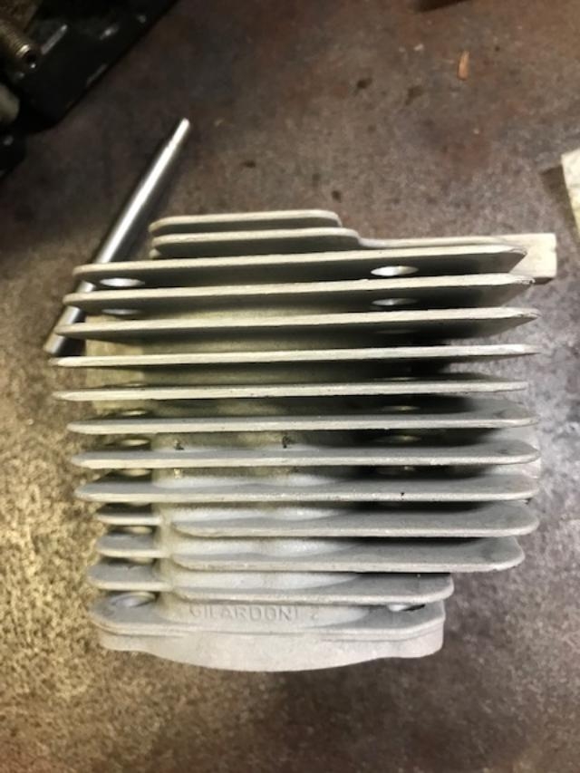

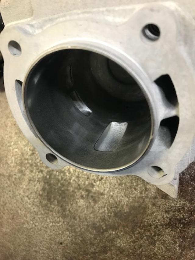

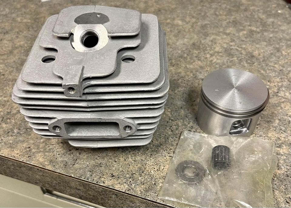

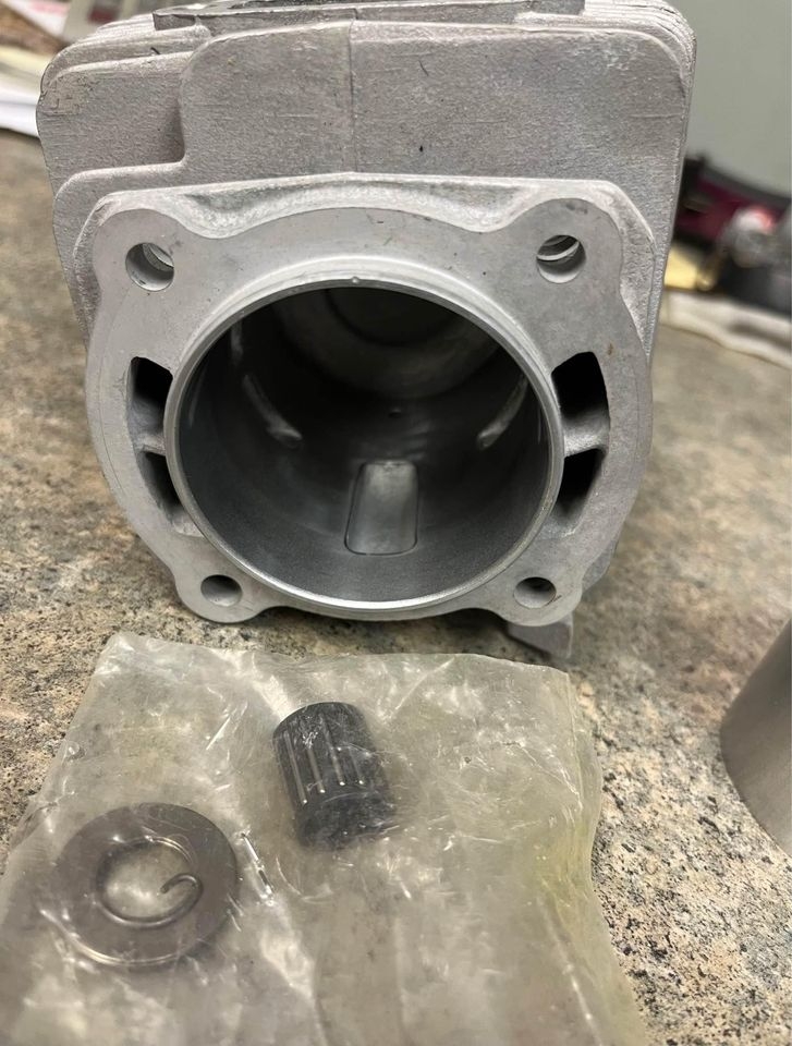

Found a gold nugget. If you know you know. ;)
NOS set. 1988-?
/ Just another junk chainsaw
#1,633

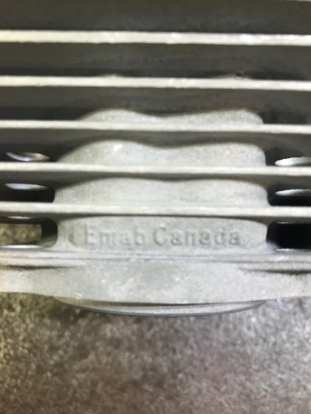

Poulan 655 BP NOS set. BP = Boost Port
Gil cylinder K&S piston
Pioneer made some this size.
Later run better quality after merger with Partner I learned.

So what do you do with that if you don't own a 655BP?
Sold it to a guy needing one for a full out restore job and build of one he is doing.
It's what I do find things I know folks need that are NLA.
Plus work on others saws as I feel like.
Sent this NOS set to a guy needing it for a Partner 7700 in UK.
Weird getting phone calls from all over the world.

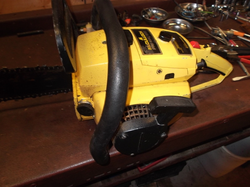

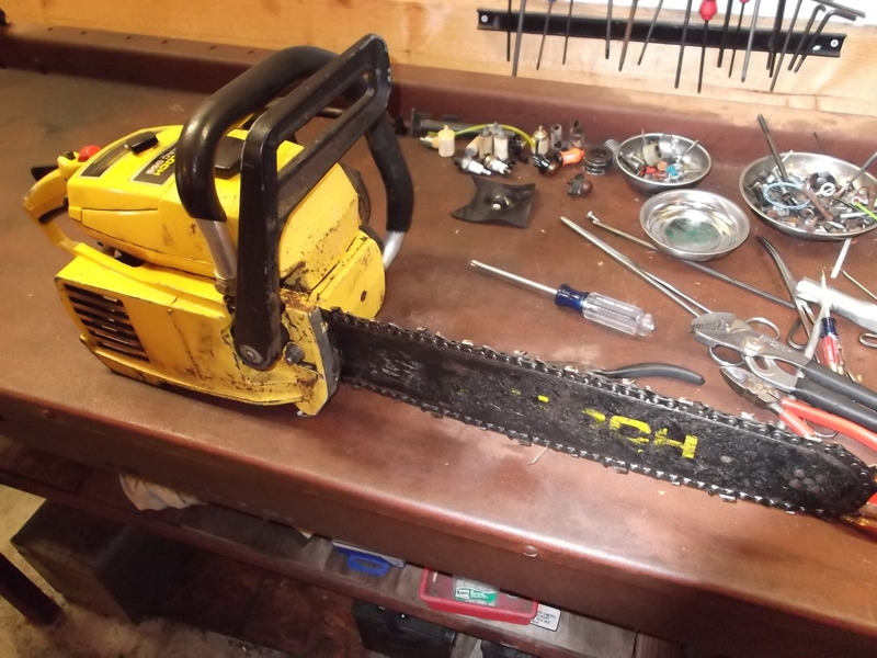

I see on facebook market place an old mac 1010 chainsaw for sale in New Jersey. I cannot imagine using one of them with that weird bar
#1,639
I sold a 1 owner friend bought new in 555 last gen of those ear bleeders. For 75 ready to cut to local. Begged him to take a like new TH mac with case for 20 too.
Not a mac fan myself. But he was took them all.
