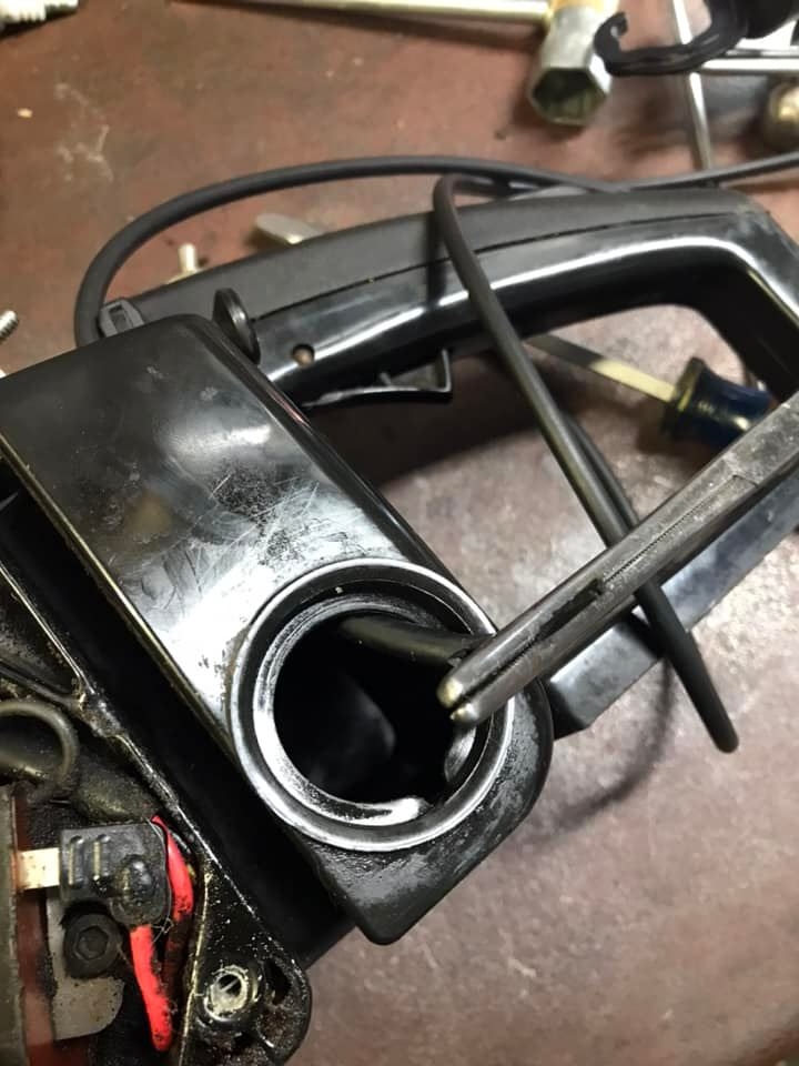

Wow! Is that some sort of a liner inside that yellow tube?
Yep, to try and make last longer against ethanol users. They come rated good for 20% etc etc etc. But IMHO the epa lines are a fail.
I like using OEM echo lines when I can.
I even use it in place of oem molded lines. Saves time and money for owners if that dont mind the switching.
