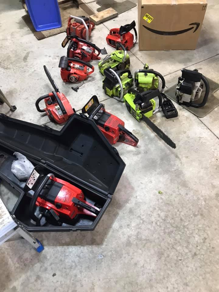

Picked up 2 61cc and a 38cc TH. Folks always asking for parts. But I already got 1 61cc running good.
Original homeowner saws that wasnt used anymore.

:cry: 12 dropped off. Get as many going right as can. :cry:
