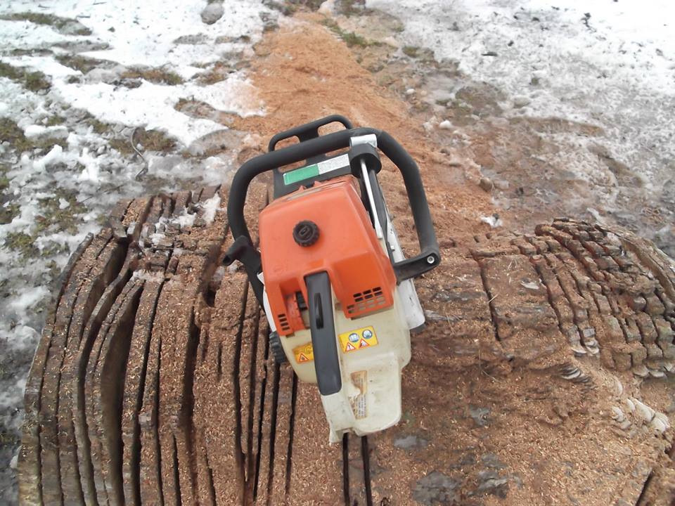

That 034 AV looks like it would cut to the right with that monster pull handle weighing down the left. :cool:

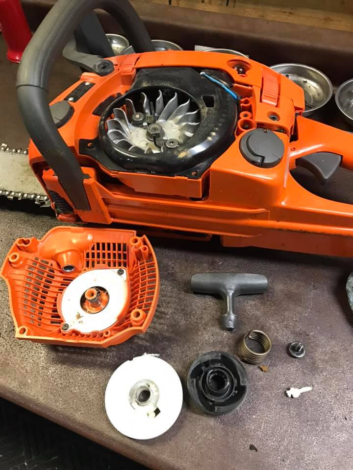

I personally dislike spring assist starters aka a weak link. This body builder owner had no clue it was even on his saw. He sure dont need it.
Going to talk to him about going to standard recoil cover and pulley. About the same dang cost of replacing the spring assist parts.

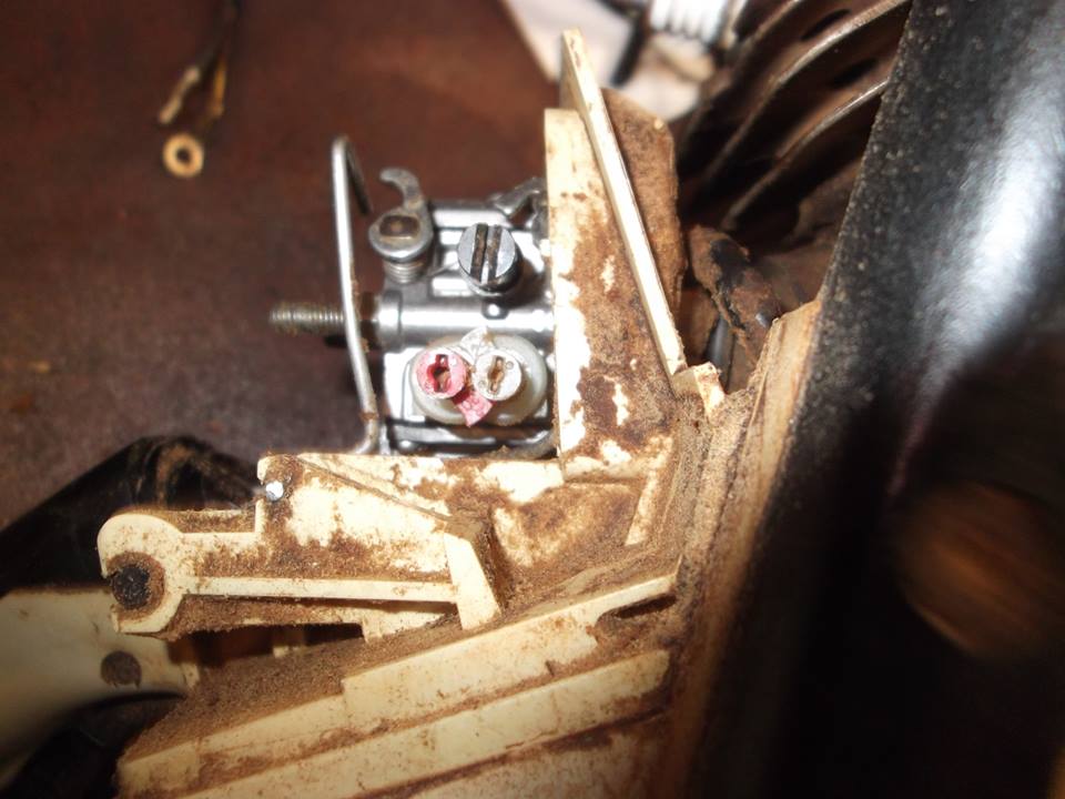

Crank seals installed and started. Then acted like starving for mix. :LOL:
Was thinking carb kit. But dias was still fine. Needed fines cleaned out.
