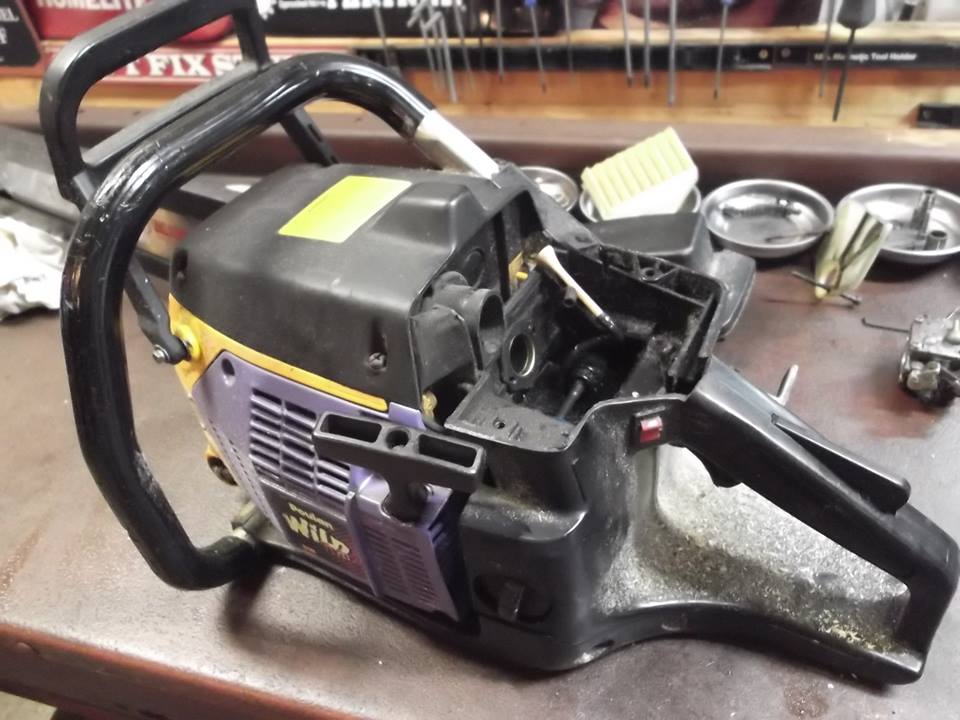

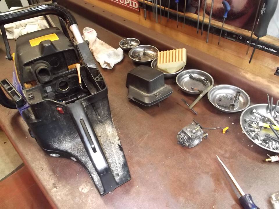

My eye sight is pretty poor, but i'll take a stab at it, as it looks like the fuel filter hose has a screw in the end. If so, how could that happen??
Thats a redneck tank vent some use. But he put the fuel filter on tank vent line too.
Early on stihl used grub screws for tank vent. Same idea.
Where folks screw up they are suppose to be pushed in notscrewed in. Then it cuts into the line and seals off sometimes.

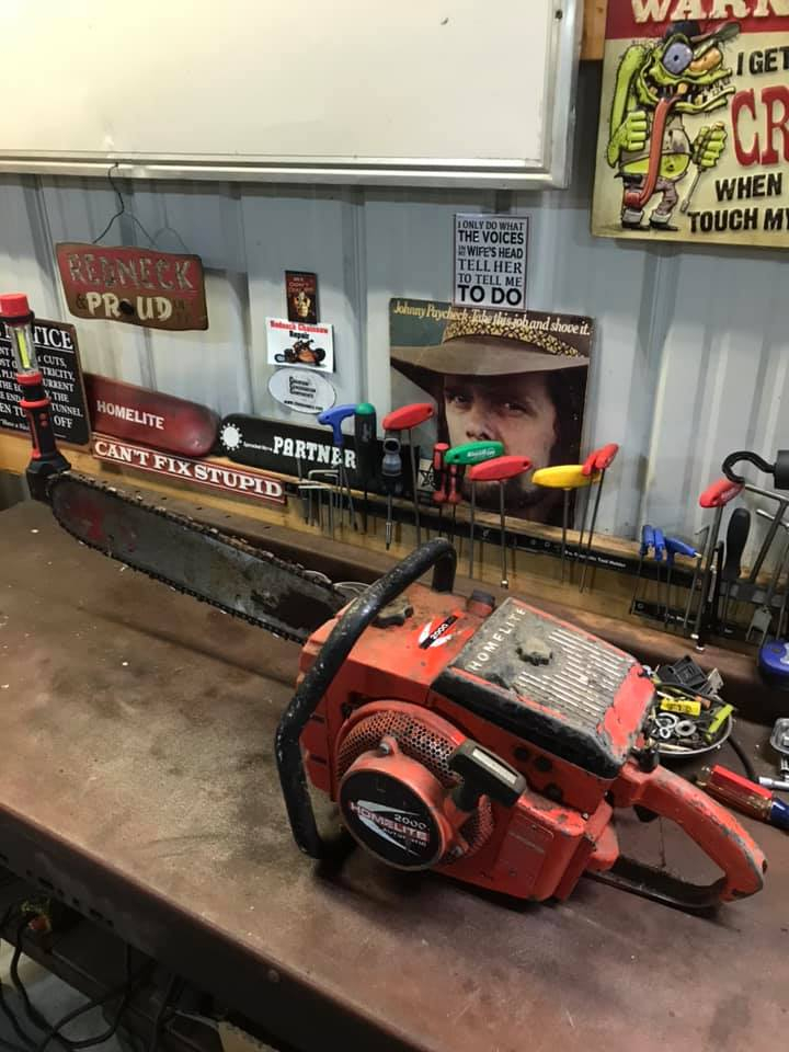

Old school saw. Tuning and checking over for local.
/ Just another junk chainsaw #1,065

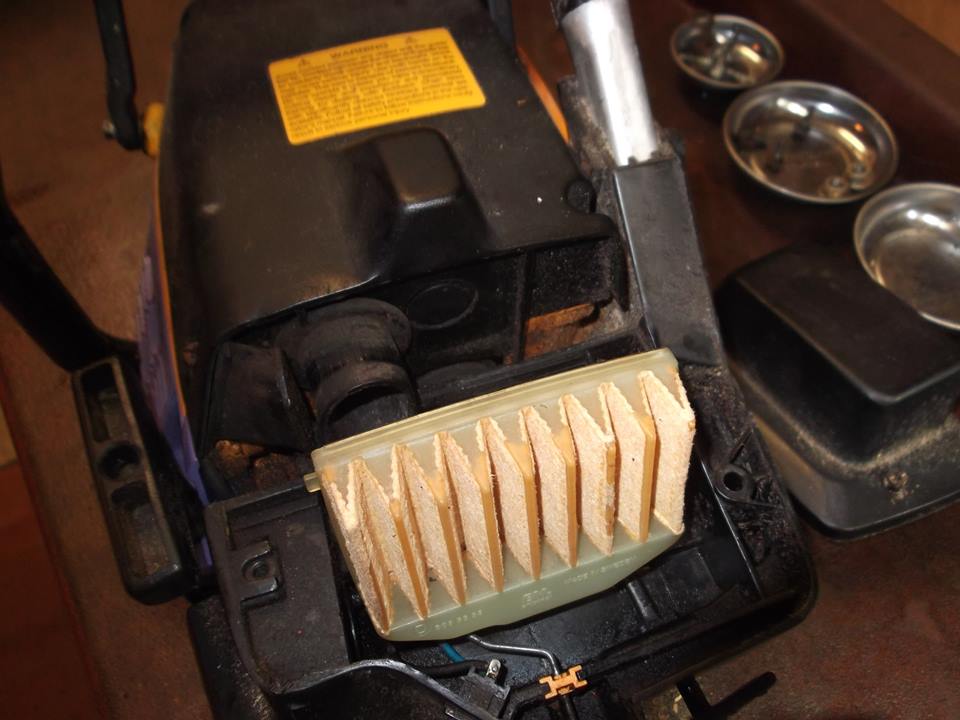

Wow, that air filter is huge.

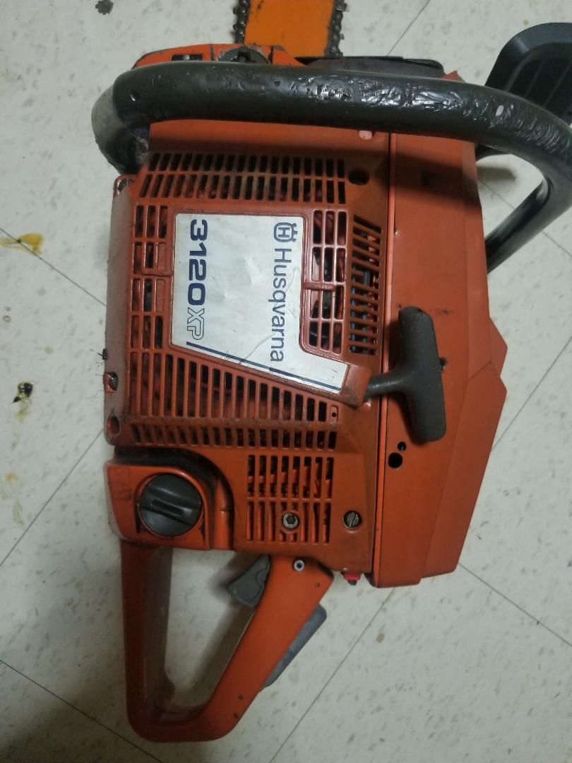

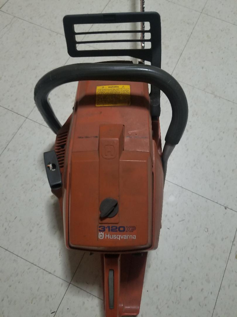

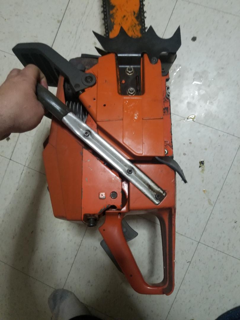

One he ran on his woods ported 3120 with H side carb and unlimited coil.
I enjoy working on and testing this locals saws out.

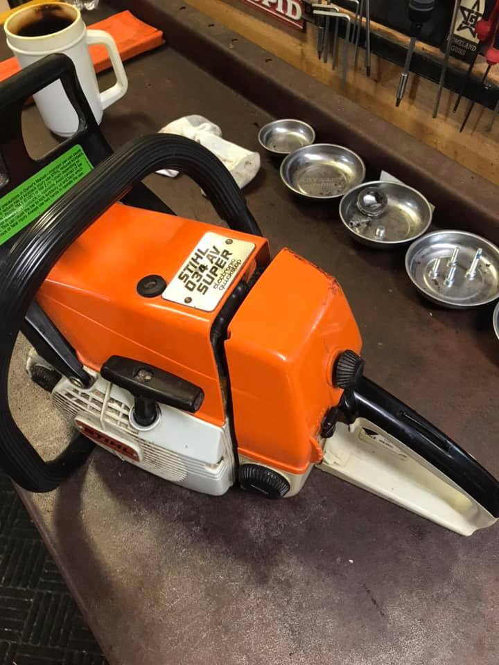

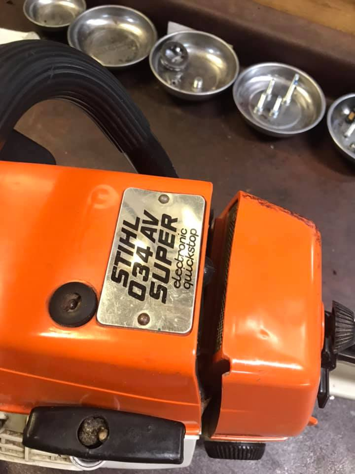

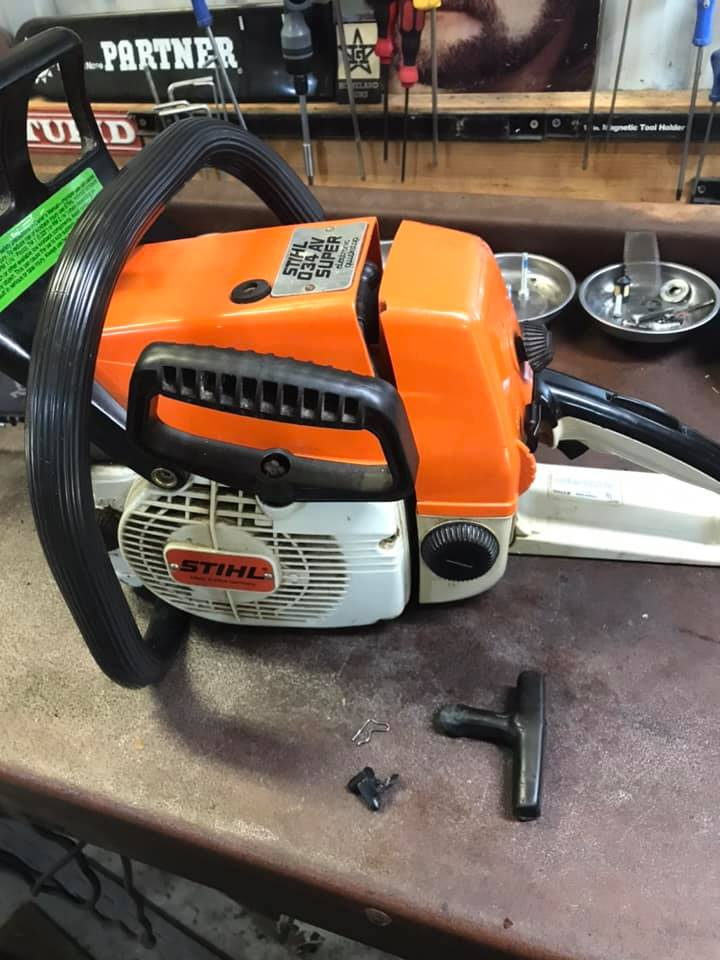

I personally dislike spring assist starters aka a weak link. This body builder owner had no clue it was even on his saw. He sure dont need it.
Going to talk to him about going to standard recoil cover and pulley. About the same dang cost of replacing the spring assist parts.
