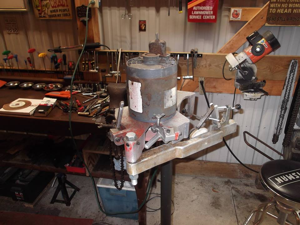

I had silvey for square. The early version that they sold to simington.
USG for round.
I still file by hand for my own stuff. Unless there is a ton of chains lined up.
Can see both in this one pic. I only had $700 in both bought used separately.

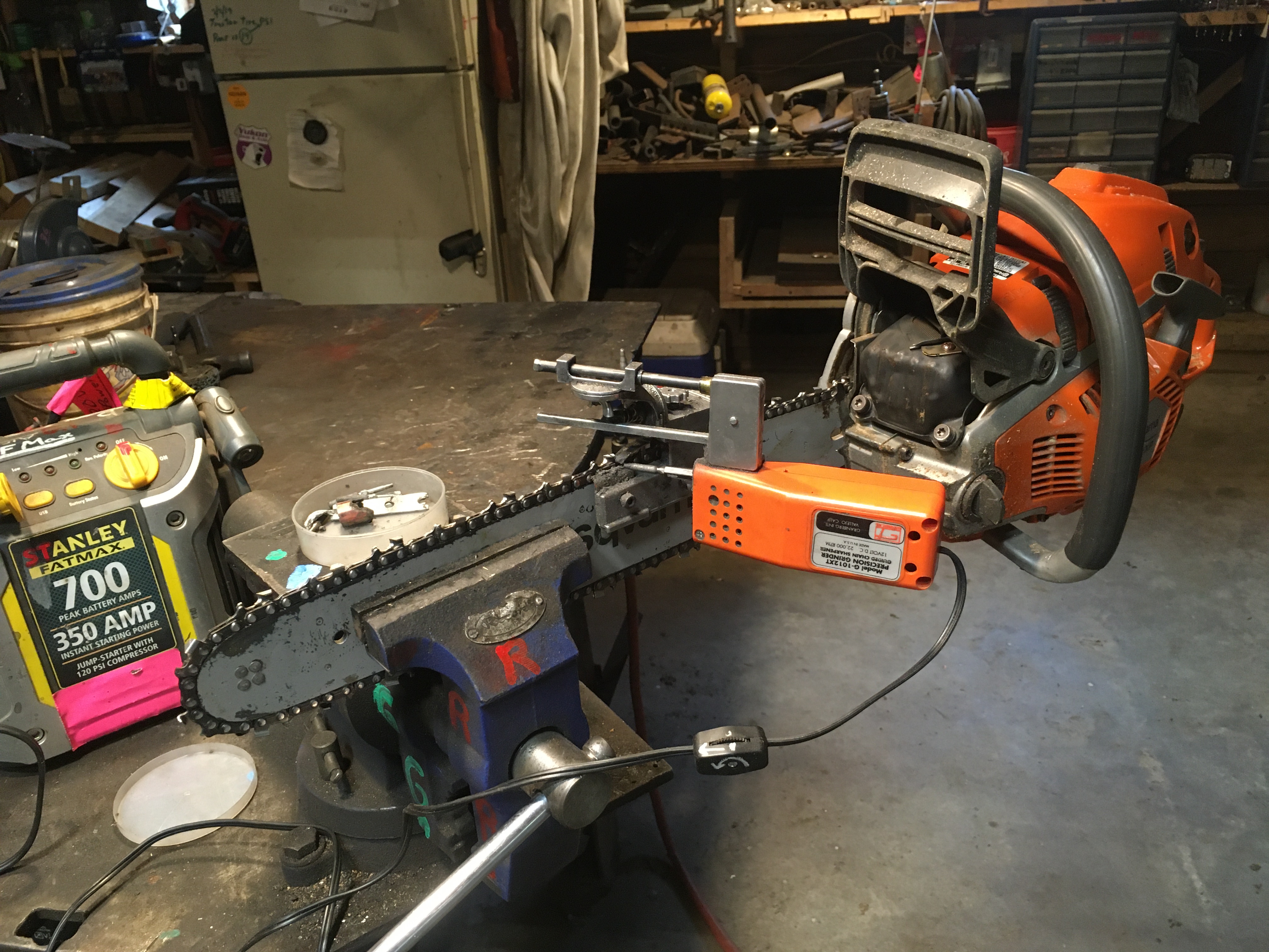

I hardly ever file anymore, I need something with a motor on it. I tried a cheap Timber Tuff bar mount but had poor results, might be ok on a chain thats been rocked. I tried the more pricey Timber line and not happy with that either, the chain link holder is not high enough so chain rivets tend to ride on top of holder, resulting in chain link movement and carbide binding but only on teeth points facing me, the teth pointing away the carbide wont jamb

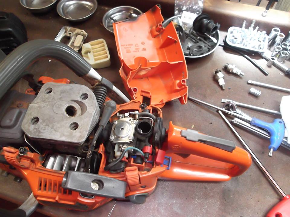

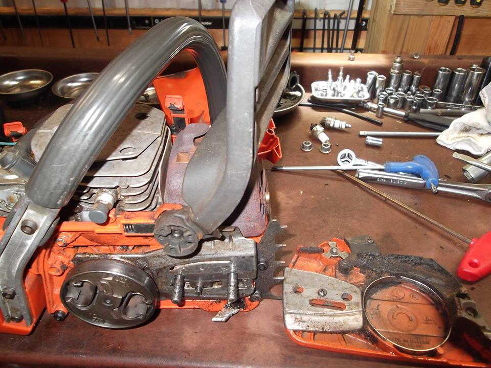

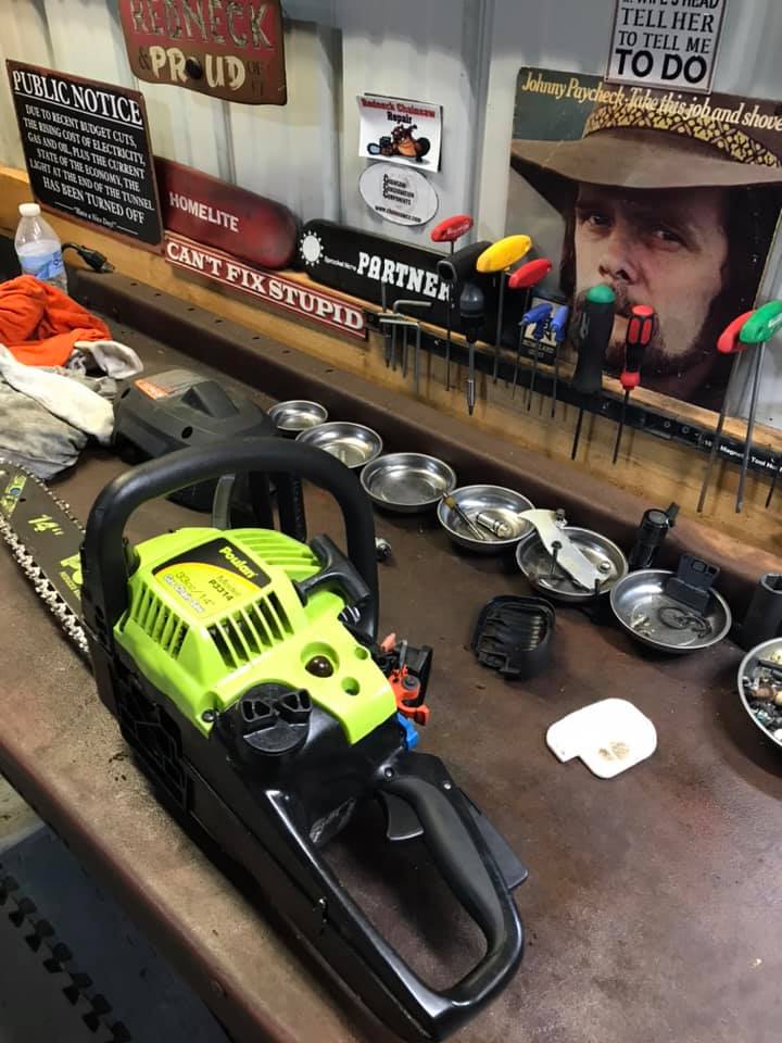

Love easy money :D. Said locked up. Everything was checking out. Found fastener from inside pulley area came out and lodged behind flywheel. Now to finish putting back and test and tune.
Whew nasty
LOL found the idle screw missing and down by the lower tank vent area. smh

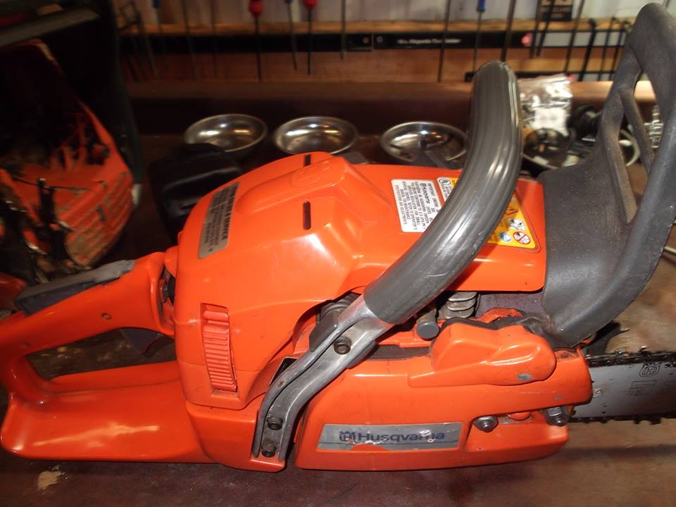

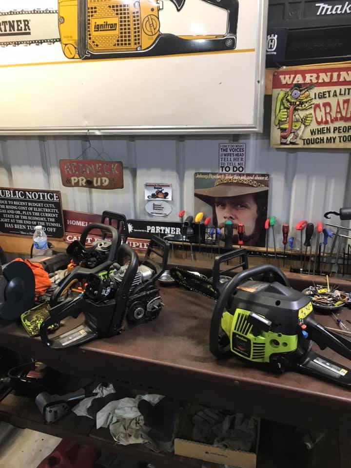

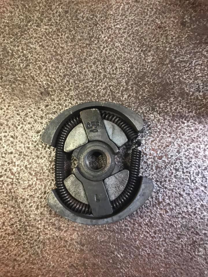

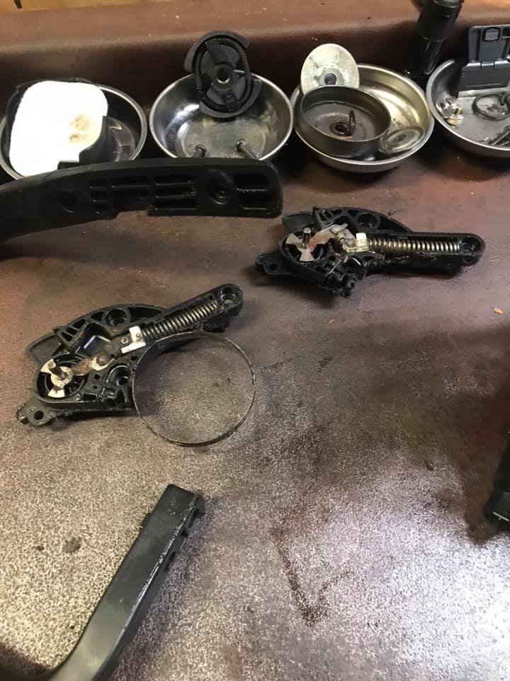

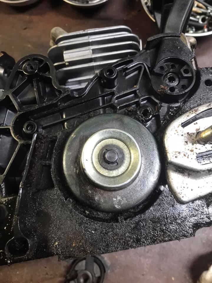

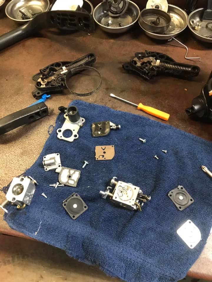

This why I keep even the cheap saws around. To grab parts from when needed to do stuff on the cheap for occasional use homeowner.
Ran with chain brake on and clutch spring lost its temper. Broke through the brake band too.

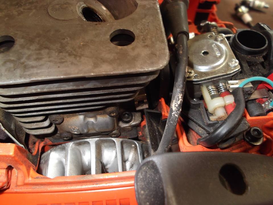

Was out of the poulan zama carb kits to try to make sure this saw needed a new carb or not. Cost for new carb is so close. But being I am curious. I remembered a new stihl 180 carb that has been in a bin for 2 years now. Guessed right both use same kit.

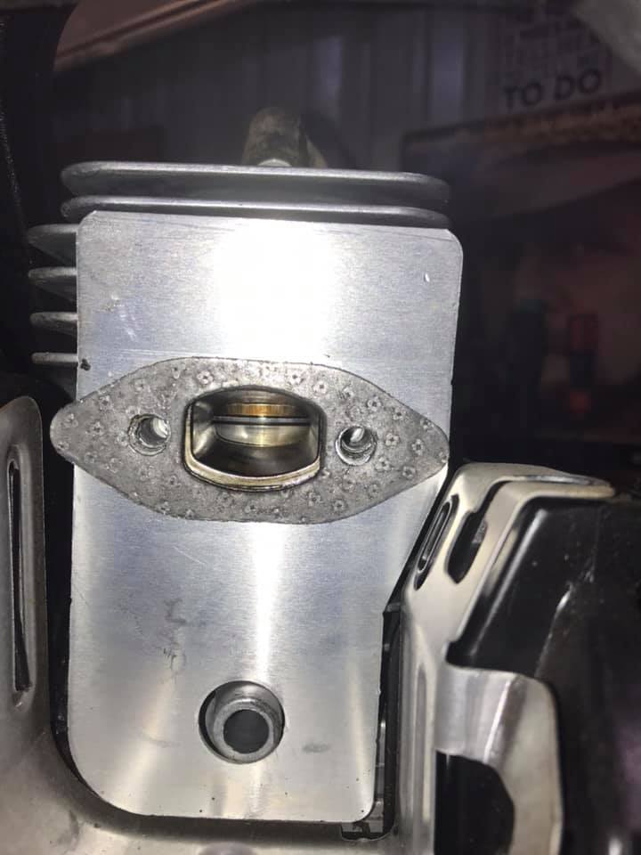

Using PP4018 might be a 4218 for part instead of rebuilding it. Just had a slight score and had good used p+c already. Long as newer strato seems most swap.
Also needs a carb kit or a new carb. Being almost same prices.
Sold the little woodshark one yesterday too.
Nice piston still in the little saw

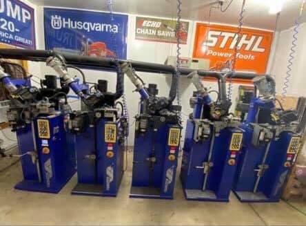

He just has me intrigued to see what a half million dollar sharpen looks like. I know my buddy has 5 sharpeners and that any good stihl dealer have too and are 15,000 new and around 10,000 used. I just think somebody is blowing smoke up someones ;)
===== ((((Originally Posted by happysawer View Post
Now i have a new STHIL chain on it but now nothing to cut. My dealer has two 1/2 million dollar chainsaw chain sharping systems, charges $8 dollars a chain takes about a minuet to do sharping.))))))
I knew someone was blowing smoke. 15K new, 10K used. = https://www.tractorbynet.com/forums...n-chain-sharpping-machine-my.html#post5856125
