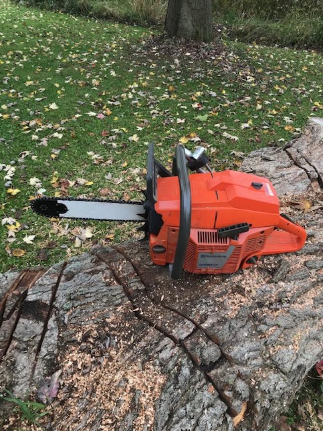

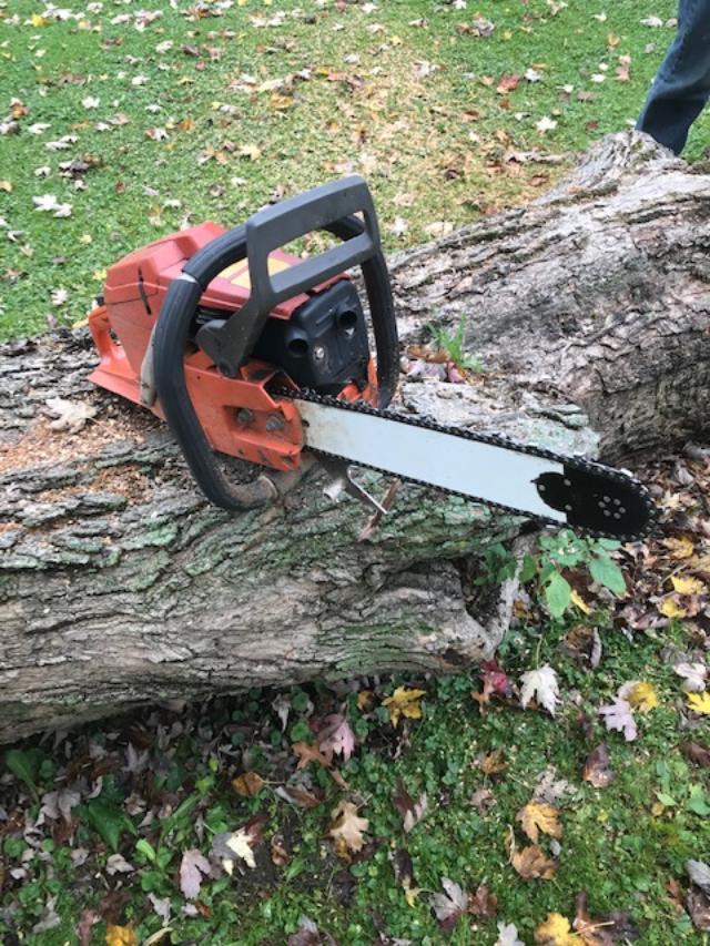

Getting paid to play ;) :thumbsup:.
394 muffler mod and a woods ported 3120 with new muffler modded muffler. Did some tuning then put on a short bar to play.
h394166.jpgh39416.jpgh394mm.jpgh3120394mmm.jpgh3120166.jpgh312016.jpgforester72.jpgcannon42.jpg
