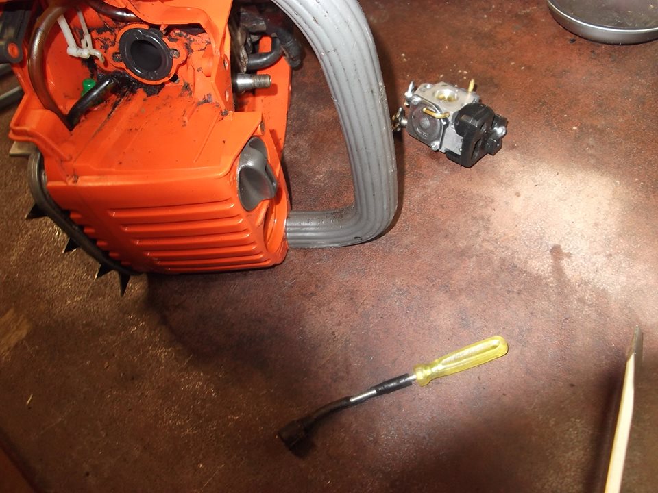

Can the MS180's carb be tuned? Maybe by removing limiters or buying the set of "tamper resistant" carb tools for $10 on ebay?
I have an Echo MS352 which would be a good limbing saw. It starts super easy. It came with the carb set really lean so I removed the limiters, cut off the tabs and put them back in (looks stock and they help the screwdriver find the slot). I also bought a used muffler and gutted the cat con from it. Don't need the extra heat from that right next to the cylinder. The idea being that I can put it back to stock(ish) should I ever take it back to the dealer. I use it for brush cutting where I'm constantly stopping the saw to pull out and pile the stuff I just cut. I hate leaving a saw idling on the ground.
