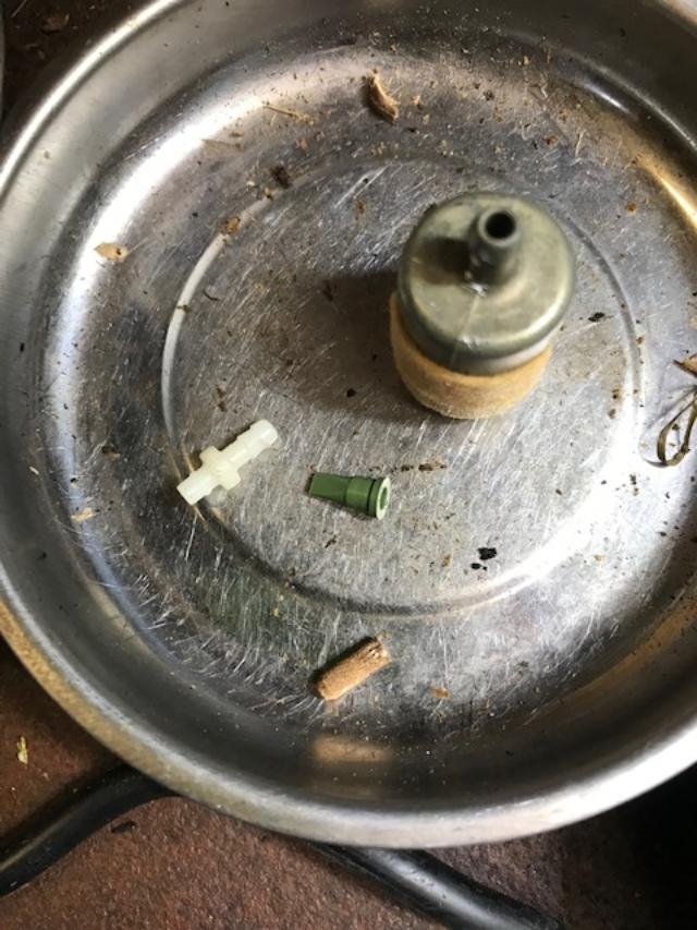

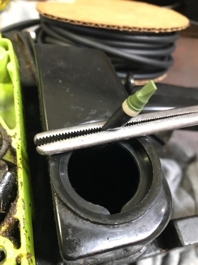

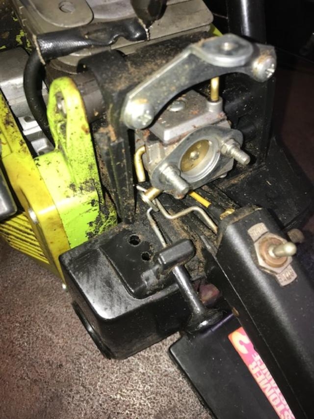

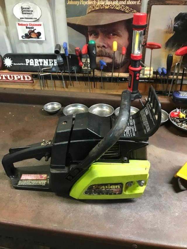

Just went through dads bought new in 1994 54cc poulan. Rode hard and put up wet from farm land use over the years.
I cleaned it and shelved it awhile back.
Last I went through it was in 2014 for him. Intake boot, lines, af, av's and bufflers.
Topend bare bore chromed piston still like new.
Still had my favorite plug in it. Bosch German made.
This time around all new lines with echo oem 3x5 and 3x6.

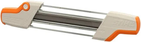

I had a hard time keeping the angle consistent espicially on my weak side so I bought this thing, it has the line for the angle to guide you and you can't screw the depth ether.
I show folks that cant get it those too. Keeps height right on file and angles right there to see.
/ Just another junk chainsaw #1,679
I've become a fan of these. The knock offs are cheap and work well IMHO. You can change files as need or just have a spare.
