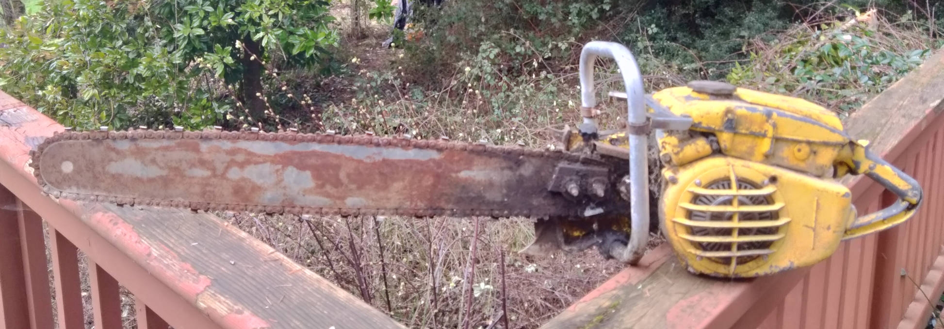

Nonetheless, I actually HAVE the old McCulloch. I don't have the FarmerTec.
mcculloch-jpg.849709
I'm pretty sure the McCulloch was "Running when Parked". :)
However I rescued it from the edge of a shed, not well protected from the rain. It didn't cost me anything.
So, I need to clean up the chain. Then tear it down somewhat, inspect, oil, reattach the handle, then try to fire it up.
I have no doubt it was made for very heavy duty use over 50 years ago.
The chain is a pretty large pitch chain.
It might be a fun project to see how a 50 year old saw stacks up against an Amazon saw.

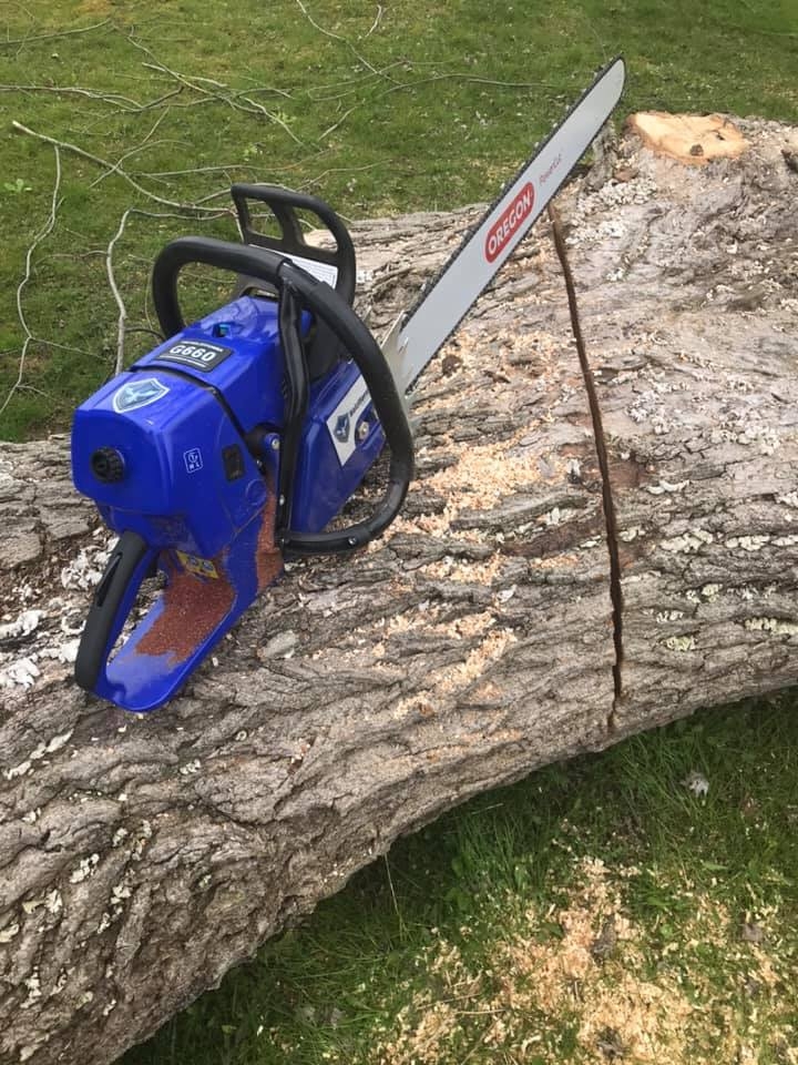

I had the Farmertec G660 and it cut just like some of the 660 and 066 5-6 of them I owned over the years. Some of them it would out cut IMO.
IMO run them with what is there, but tune the darn things from get go. Only replace as needed.
Stock port timing was all over the place on them over the years. The later run 660's were the worst.
Same can be said for the clone 660 cylinders too. Mine pulled 210psi and later newer pulled 160psi.
I don't hesitate one bit buying a clone saw or suggesting them to locals anymore.
Guy in video bet didnt tune for crap either. They come super fat out of box.
Have a locals 660 oem here and you couldnt tell the difference in them in cuts.
Under 300 shipped to door v/s 1200 or more

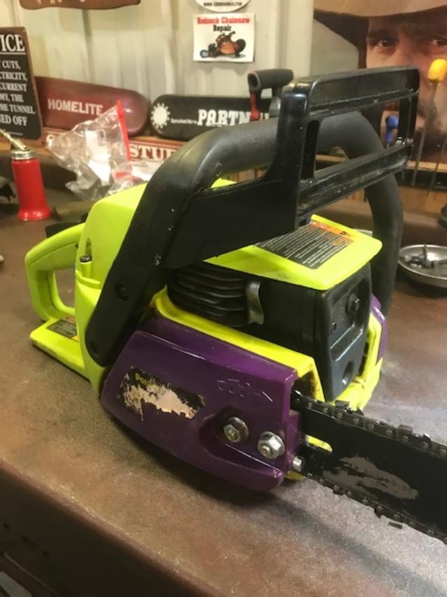

As I set here cussing this 36cc wild thing I am working on at bench 1 yesterday. I look up and could almost hear them laughing.
Poulan gang above bench.

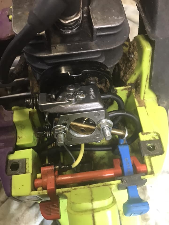

She lives shortly after. I picked up last year as non runner for 5.
I was curious if it was 36cc for real and did bore stroke back then. This one was 36cc 1-5 are.
Got more in carb kit and echo oem lines.
Drilled the tank for 3x5 too.
   / Just another junk chainsaw
#1,666

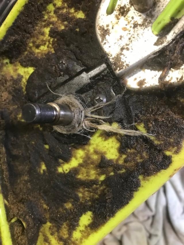

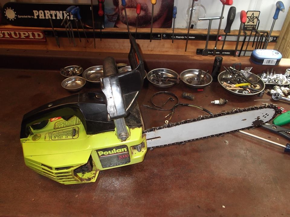

Last check overs before buttoning up. Then to clean it up.
Glad I did. While going through things had some kind of nylon plastic crap all wrapped at oil pump area. Glad noticed that as it will bind pump and take out gear when gets in bind.
Poulan 2175 36cc. 1999 type 2.
Stihl 63PS on it for test cutting later.
Lines and carb kit too.
Loaner saw, root cutter, or sell to local for trimming someday.
Still the wild thing bar and crap chain but set that chain aside.
