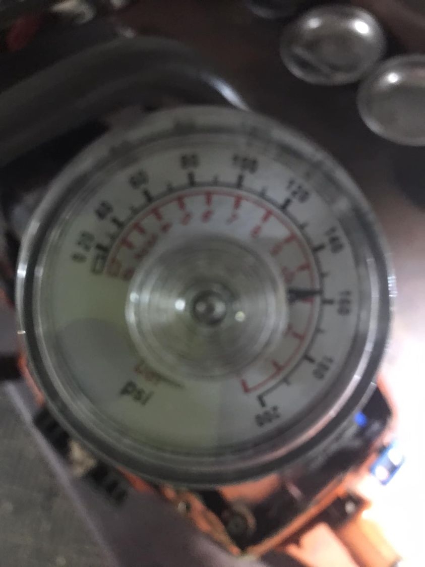

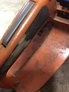

In all my years I have never saw a saw with the side grip rear handle covers be worn like that.
Amazing and still pulls close to 160psi.

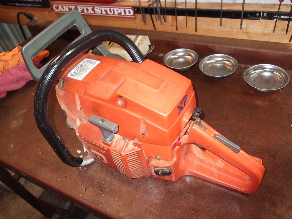

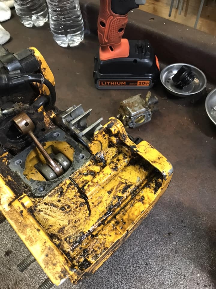

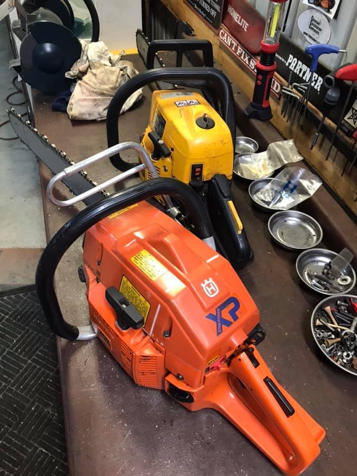

Since some of us have a open mind and do gas and battery stuff.
This 60cc came in on trade on some parts another guy needed for a 65cc.
Trying to decide if I should part it to help others or split the cases do bearings and seals and try to save it.
   / Just another junk chainsaw
#1,693
NLA parts the guy was needing.
#1,694

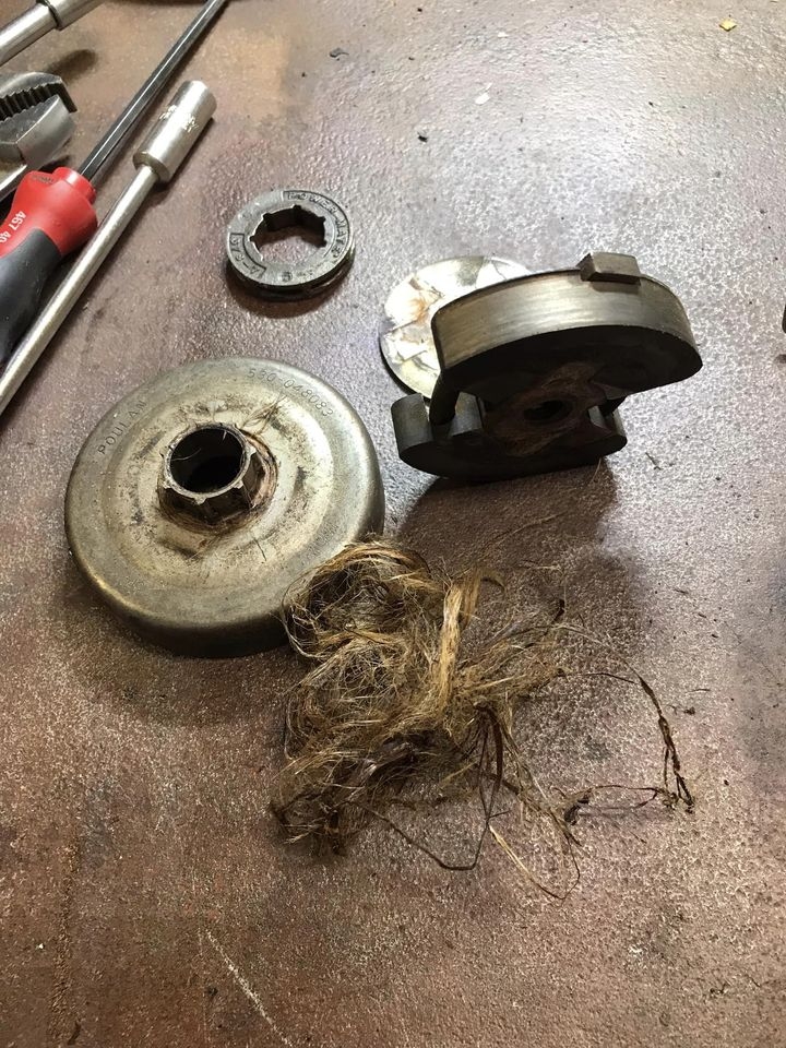

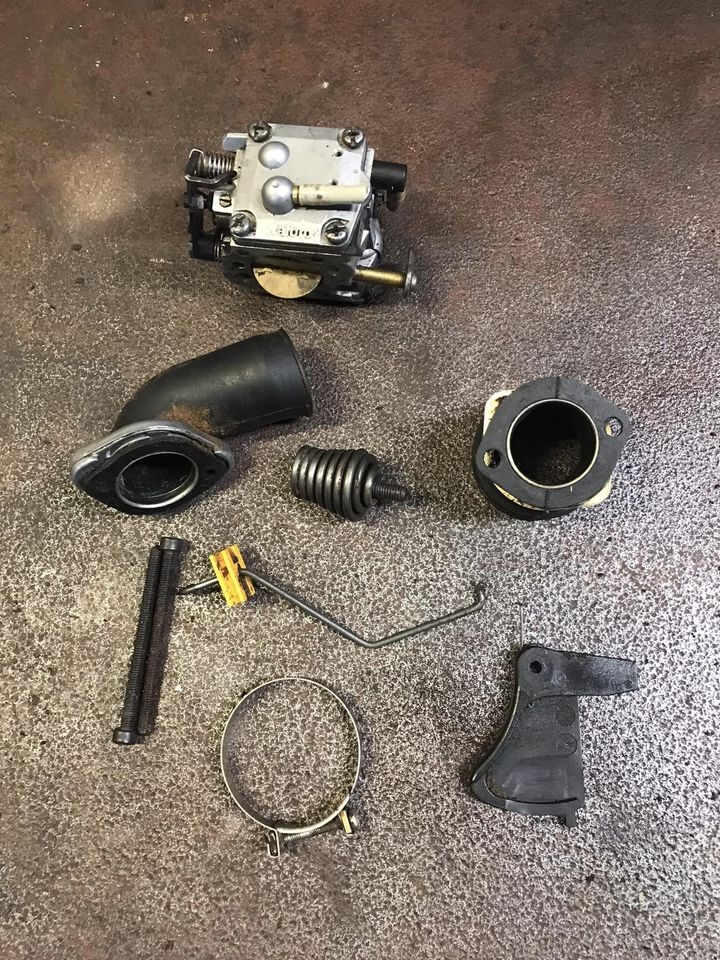

Was like I thought. Bearings has had moisture from setting over the years.
So this PP365 will get parted.
Clutch shows more wear then piston in my eyes.
Nasty uncared for saw over the years.

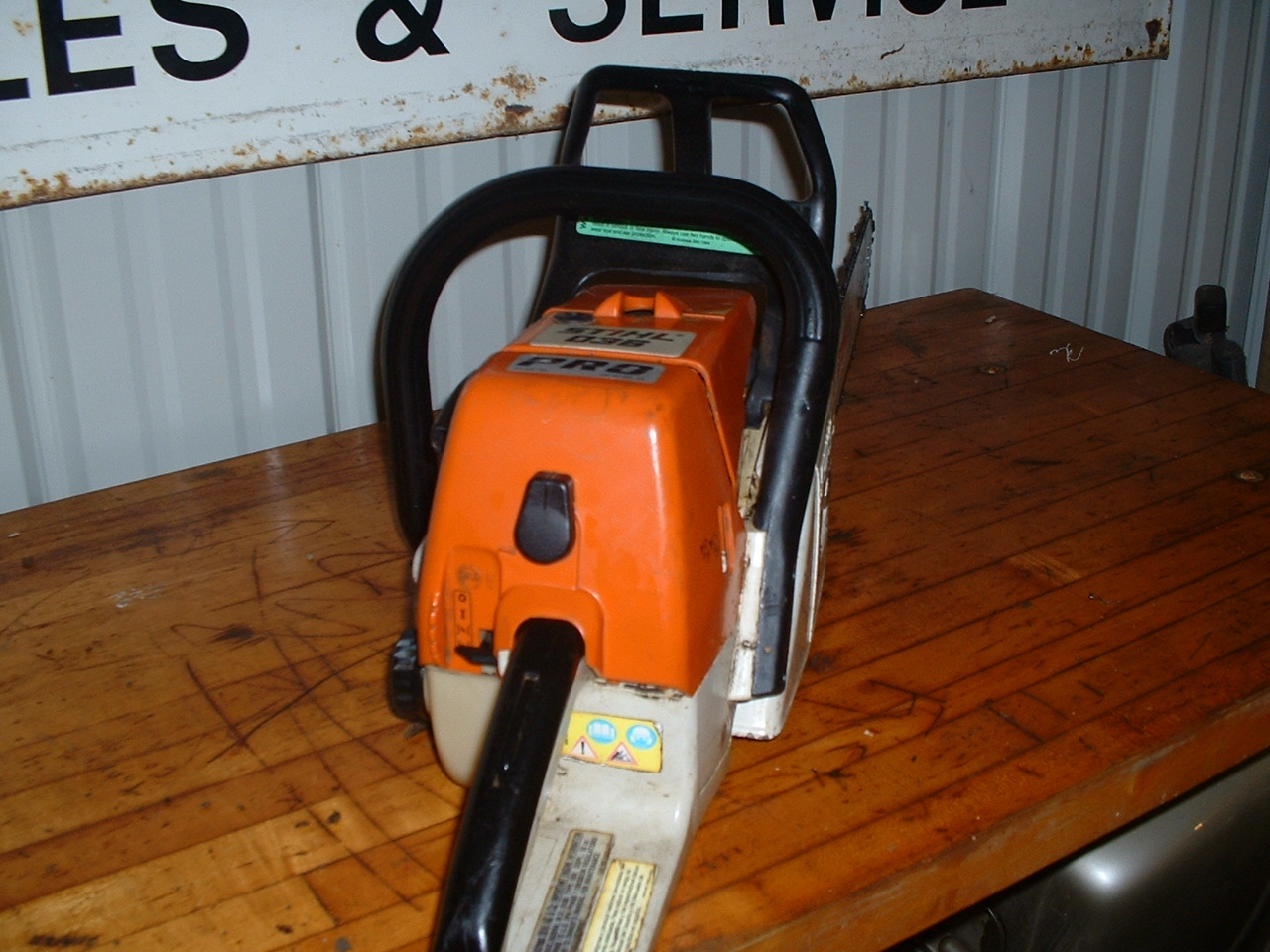

   / Just another junk chainsaw #1,698
Hated seeing this one come in hurt. Stihl 034 super.
I'm only one that has serviced it since new. Think he said bought it new in 90-91.
Owner older and saw fell out of tree trimming some limbs. Now he wears duct tape bandage on air filter done by owner.
I ordered him a new oem air filter. Besides the hole that got poked through. He took a brush to the flocking. Which isnt good to do. Lot missing now.
Old pic showing West Germany on recoil.
It wears a 460 rescue handle now. This thing is strong and great psi. Getting older suks for him with no decomp.
Also updated it to 2 pawls instead of 1 like came when put new pulley in in past.
