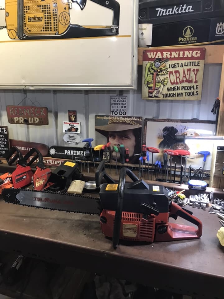

Nonetheless, I actually HAVE the old McCulloch. I don't have the FarmerTec.
mcculloch-jpg.849709
I'm pretty sure the McCulloch was "Running when Parked". :)
However I rescued it from the edge of a shed, not well protected from the rain. It didn't cost me anything.
So, I need to clean up the chain. Then tear it down somewhat, inspect, oil, reattach the handle, then try to fire it up.
I have no doubt it was made for very heavy duty use over 50 years ago.
The chain is a pretty large pitch chain.
It might be a fun project to see how a 50 year old saw stacks up against an Amazon saw.

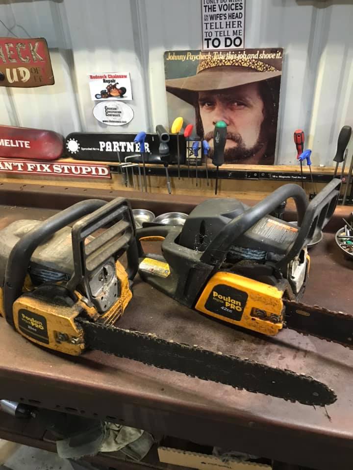

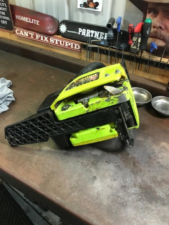

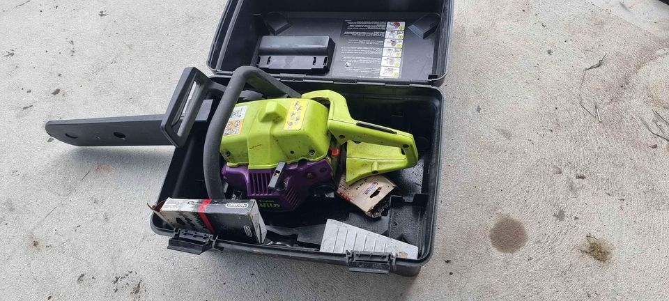

As I set here cussing this 36cc wild thing I am working on at bench 1 yesterday. I look up and could almost hear them laughing.
Poulan gang above bench.
/ Just another junk chainsaw
#1,665

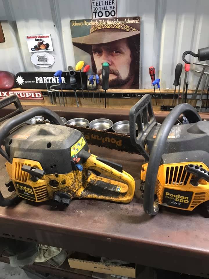

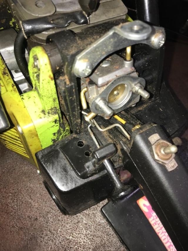

She lives shortly after. I picked up last year as non runner for 5.
I was curious if it was 36cc for real and did bore stroke back then. This one was 36cc 1-5 are.
Got more in carb kit and echo oem lines.
Drilled the tank for 3x5 too.

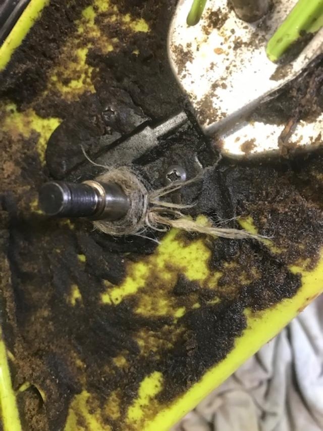

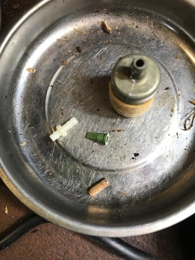

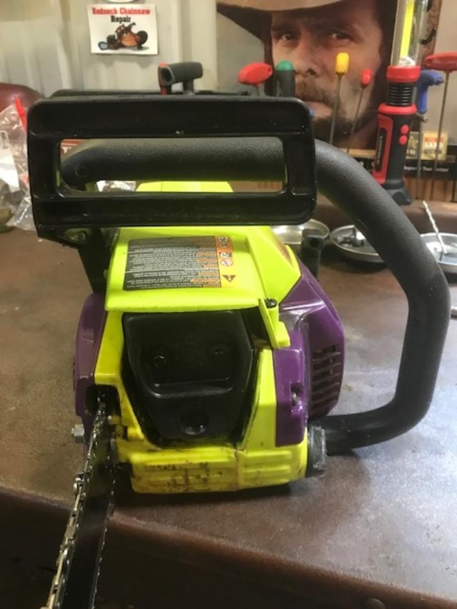

Last check overs before buttoning up. Then to clean it up.
Glad I did. While going through things had some kind of nylon plastic crap all wrapped at oil pump area. Glad noticed that as it will bind pump and take out gear when gets in bind.
Poulan 2175 36cc. 1999 type 2.
Stihl 63PS on it for test cutting later.
Lines and carb kit too.
Loaner saw, root cutter, or sell to local for trimming someday.
Still the wild thing bar and crap chain but set that chain aside.
/ Just another junk chainsaw #1,669
I swear that was material from chaps in there.

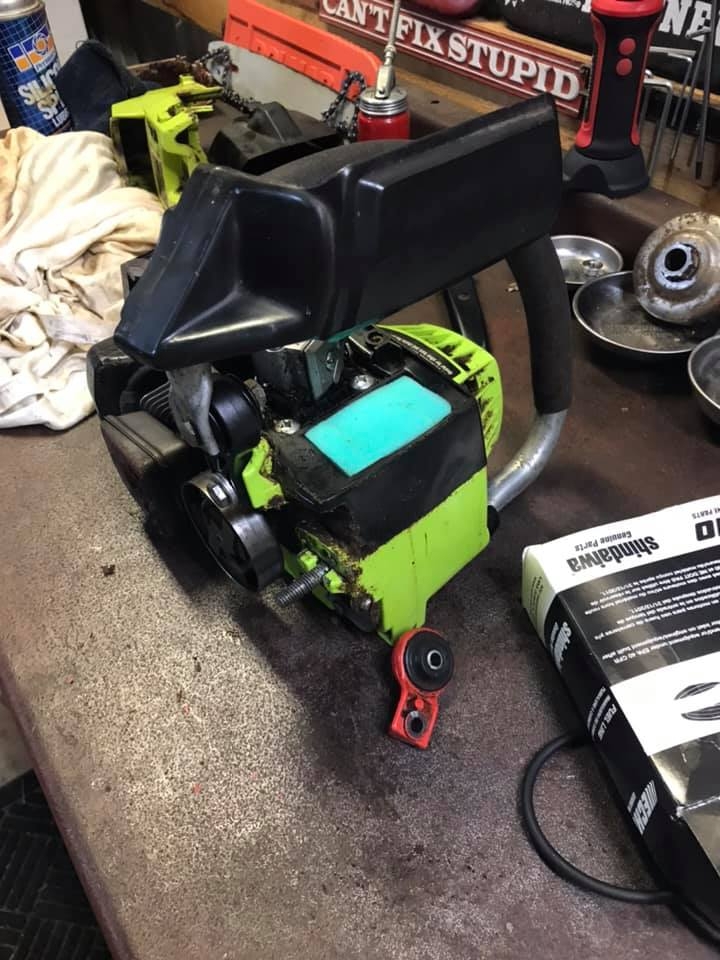

Yep first thing you notice on the saws with no anti-vibe. Rattle your teeth.
My 2000 I bought new in 94 was like that. Later on as I learned way more on saws. I swapped in a anti-vibe front handle set up.
Not that I care about the plastic saws that use clammys build. But I found awhile back that there was a wild thing built with anti-vibe overseas. Looks like my PP260 but in green with thing colors.
Before and after on 2000. Can see the back av on and a red av for back ups. Since harder to find.
WT AV pic too.

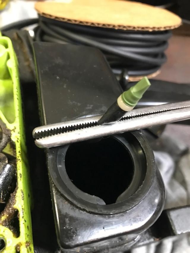

Just went through dads bought new in 1994 54cc poulan. Rode hard and put up wet from farm land use over the years.
I cleaned it and shelved it awhile back.
Last I went through it was in 2014 for him. Intake boot, lines, af, av's and bufflers.
Topend bare bore chromed piston still like new.
Still had my favorite plug in it. Bosch German made.
This time around all new lines with echo oem 3x5 and 3x6.

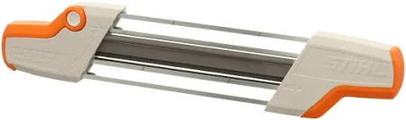

I had a hard time keeping the angle consistent espicially on my weak side so I bought this thing, it has the line for the angle to guide you and you can't screw the depth ether.
I show folks that cant get it those too. Keeps height right on file and angles right there to see.
/ Just another junk chainsaw #1,679
I've become a fan of these. The knock offs are cheap and work well IMHO. You can change files as need or just have a spare.
