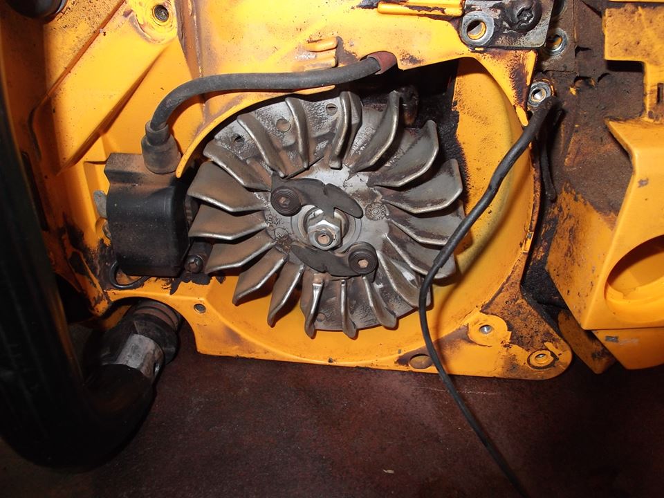

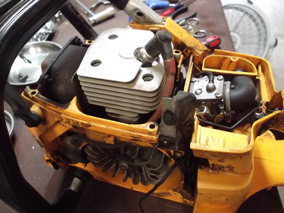

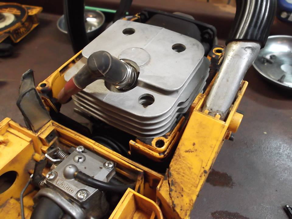

A 1 owner I am going through right now. Going to update the tank and air filter to the 505 set up. 1991 and appears to be low hurs on it.
Trying to decide to leave it 65cc or go to 71cc or 77cc before putting back together.

View attachment 506007View attachment 506008View attachment 506009View attachment 506010View attachment 506011
fuel lines seem to be in good shape. I did some adjustments on the carb and finally got it to running pretty good. Chain is sharp. No problems with it

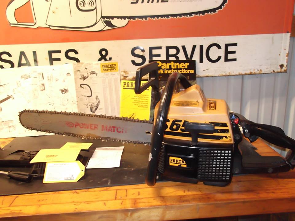

Done pics with updated 505 tank and air filter set up. If anyone need the old style air filter etc just holler. They are for sale.

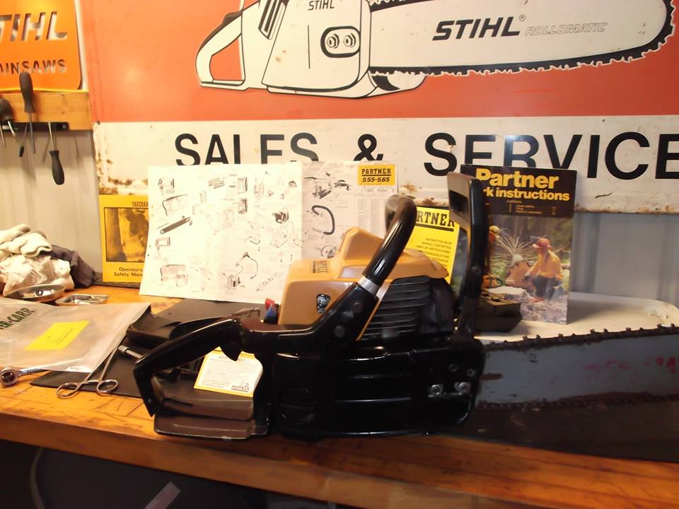

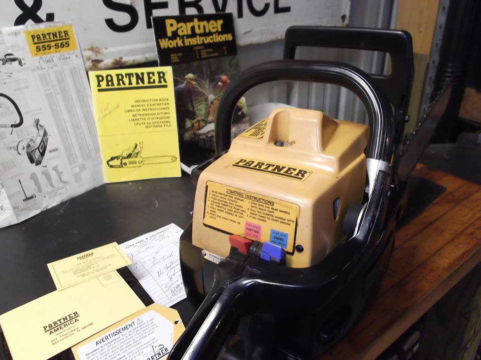

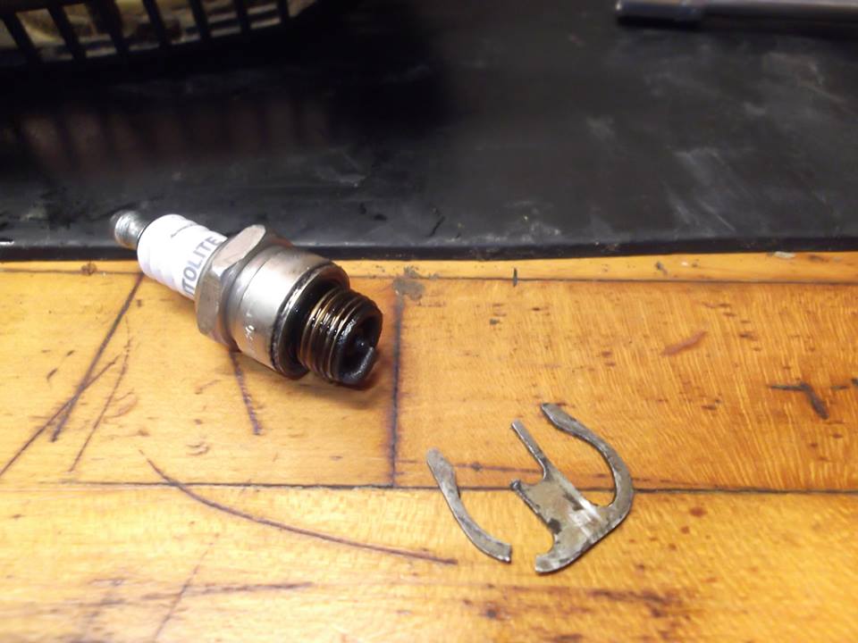

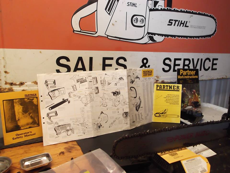

Anyone need or want a 1 owner ole school 65cc bought new in 1985 with all paperwork and manuals. :2cents::2cents:
Just finished going through checking it and replacing pulley e-clip, plug, recoil bolt. Was all I could find to make it right again. :thumbsup:
View attachment 510455View attachment 510456View attachment 510457View attachment 510458View attachment 510459View attachment 510460View attachment 510461View attachment 510462View attachment 510463
SOLD it local

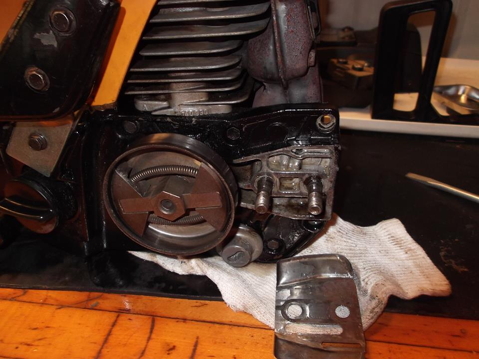

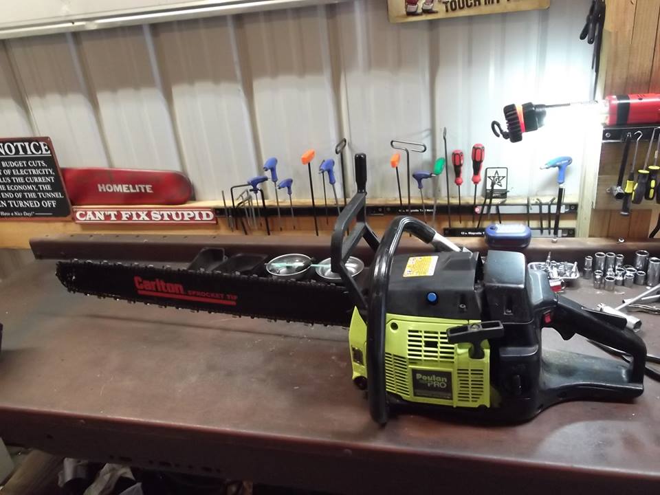

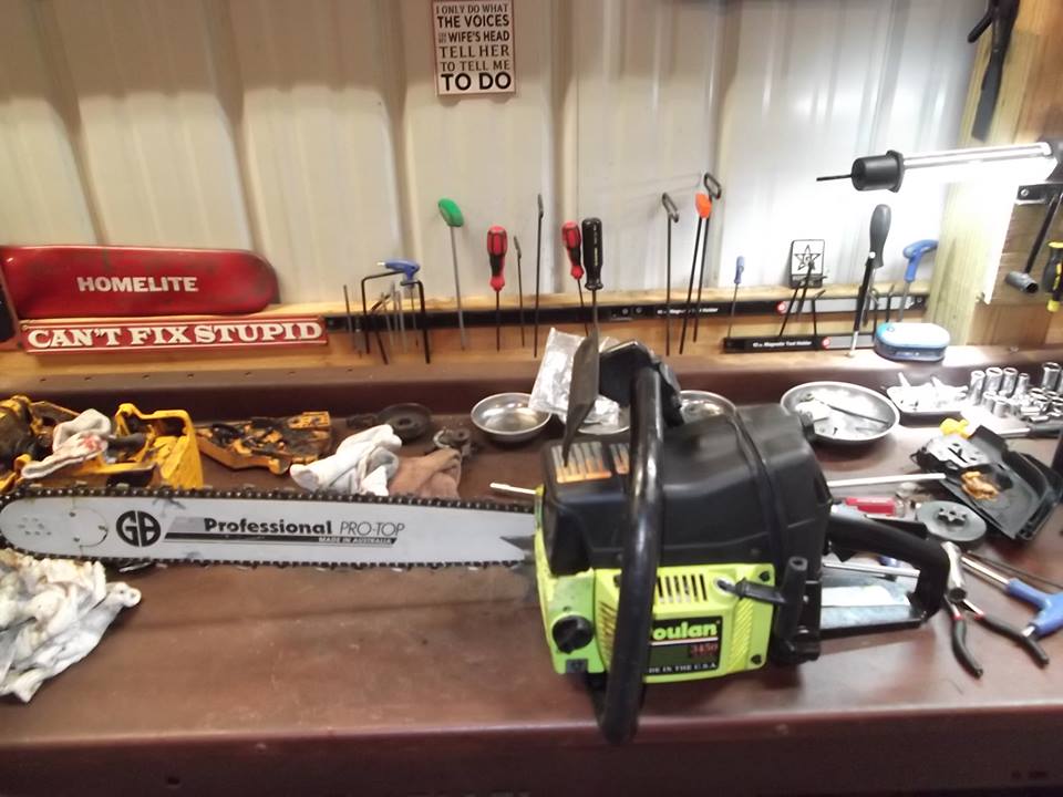

Bringing a few more 60cc saws x2 and 1 62cc back to life. :drink:

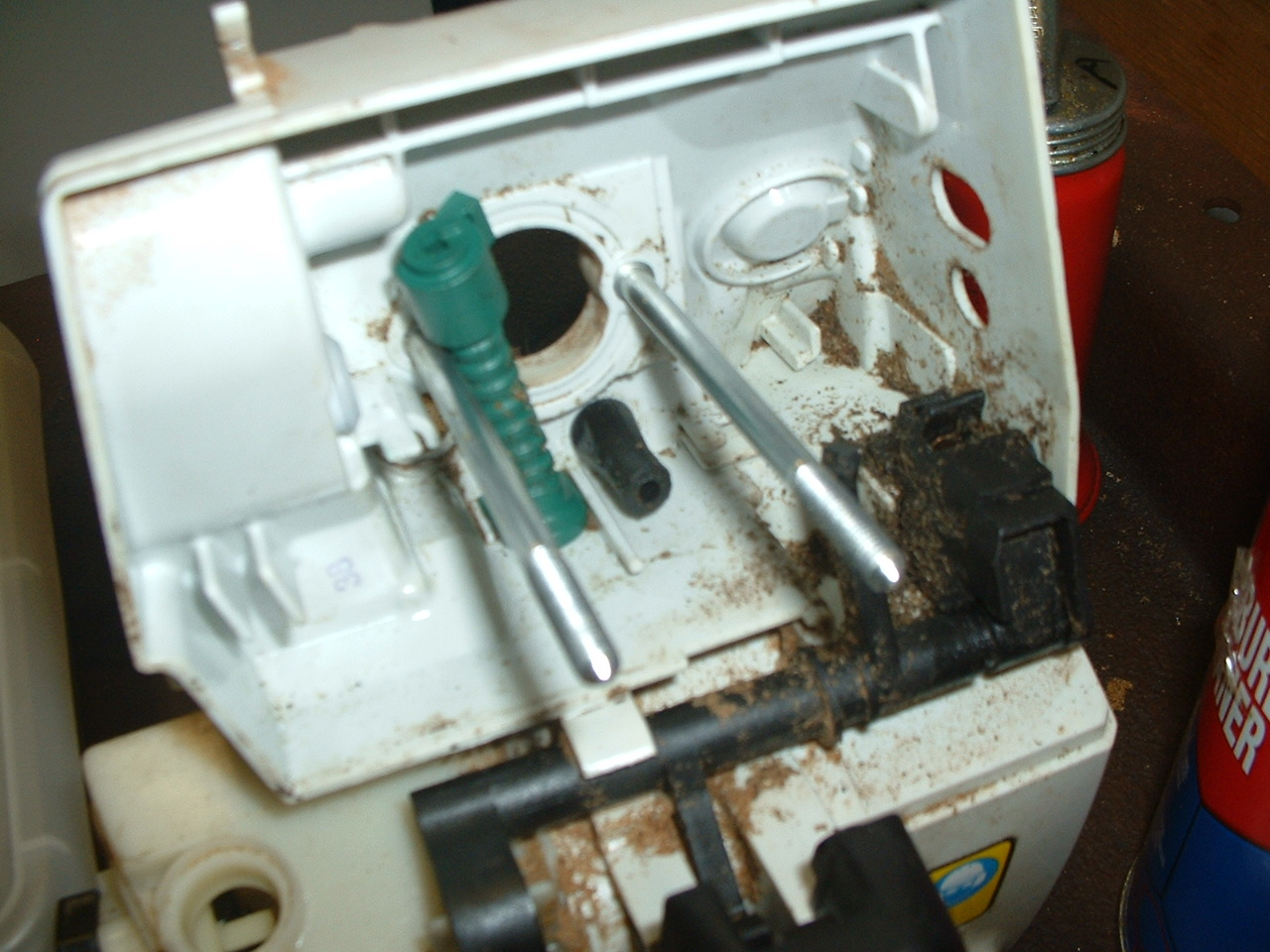

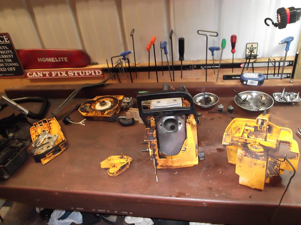

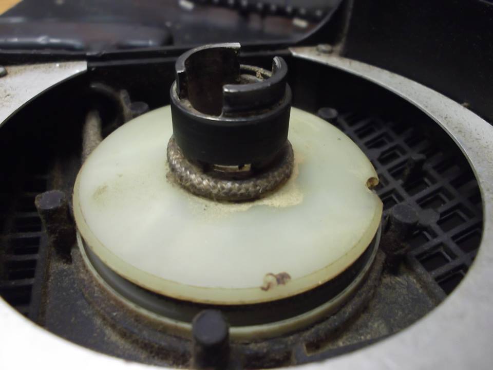

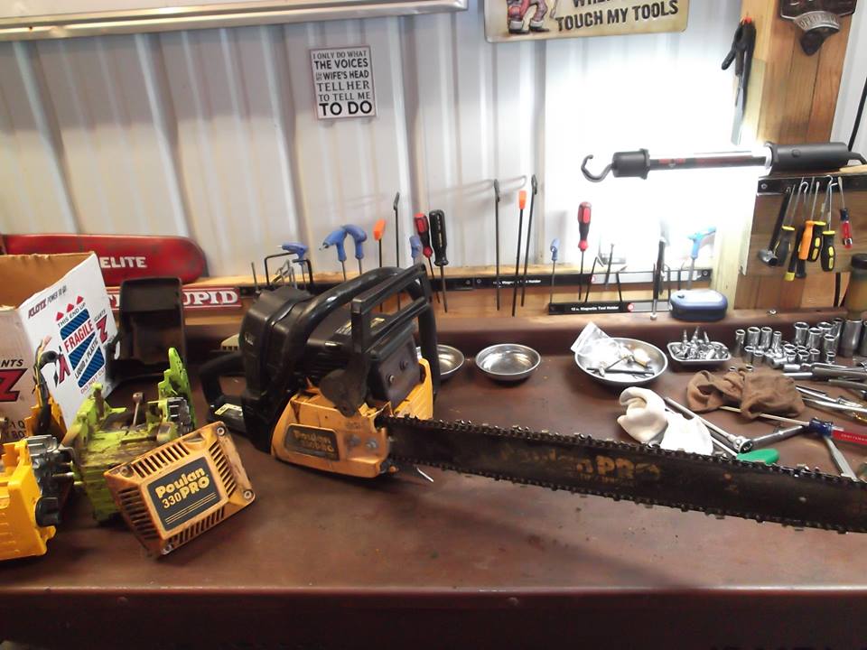

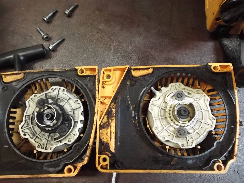

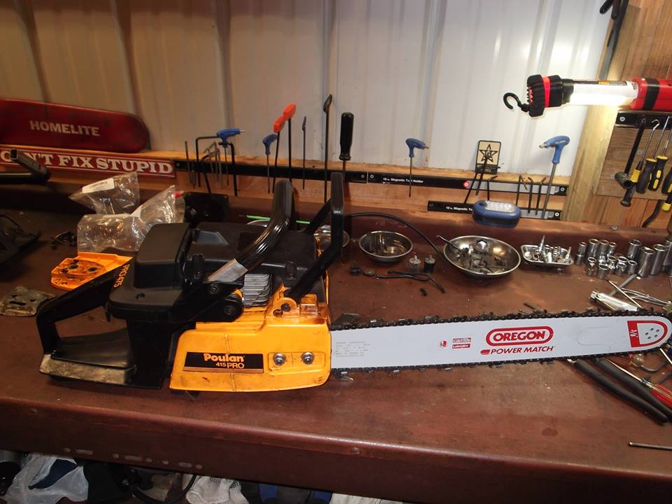

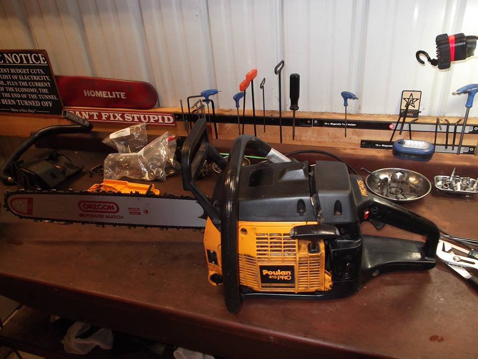

54cc I bought for parts. But after checking over seen it wouldnt take much to put back out there. 2 rubber av's, tensioner, clutch bearing, clutch cover, recoil rope, impulse line, fuel line and filter. Off the top of my head.
Done and tested out good.
Before pic in these pics somewhere as arrived. Also pic showing how the rope goes on these.
p330rope3.jpgp330rope2.jpgp330ropedone.jpgp330last.jpgp330lastb.jpgpp330.jpg_thumb.png
/ Just another junk chainsaw
#318
meant for this pic to be in there so you could see rope.

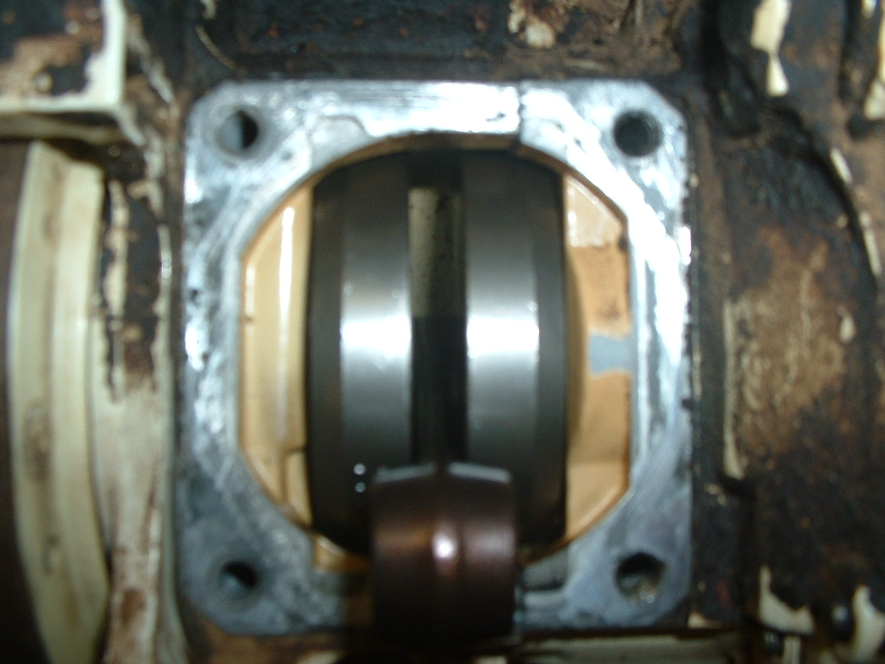

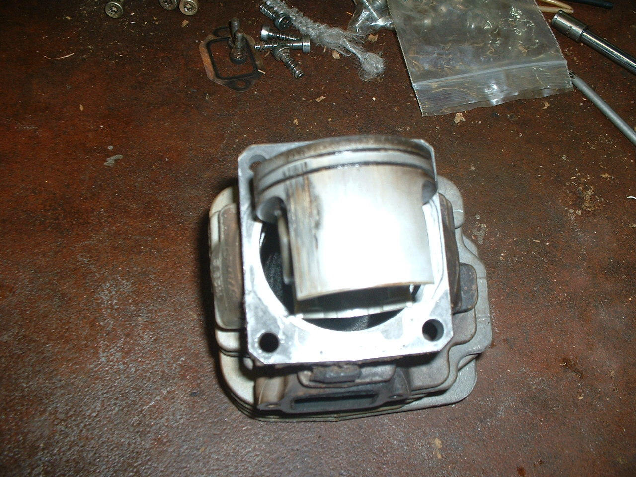

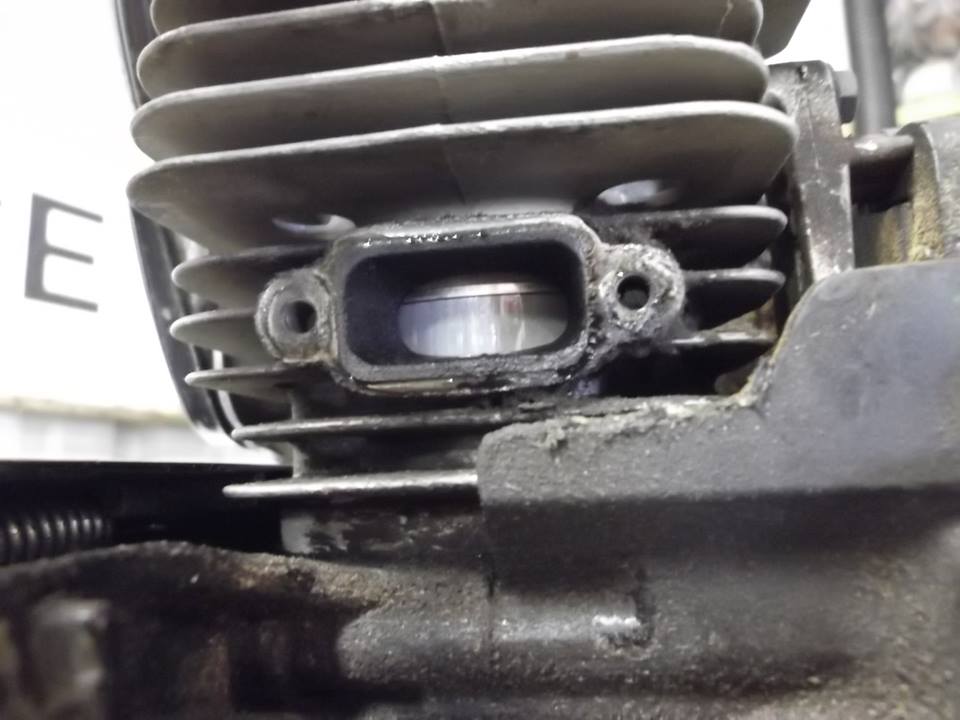

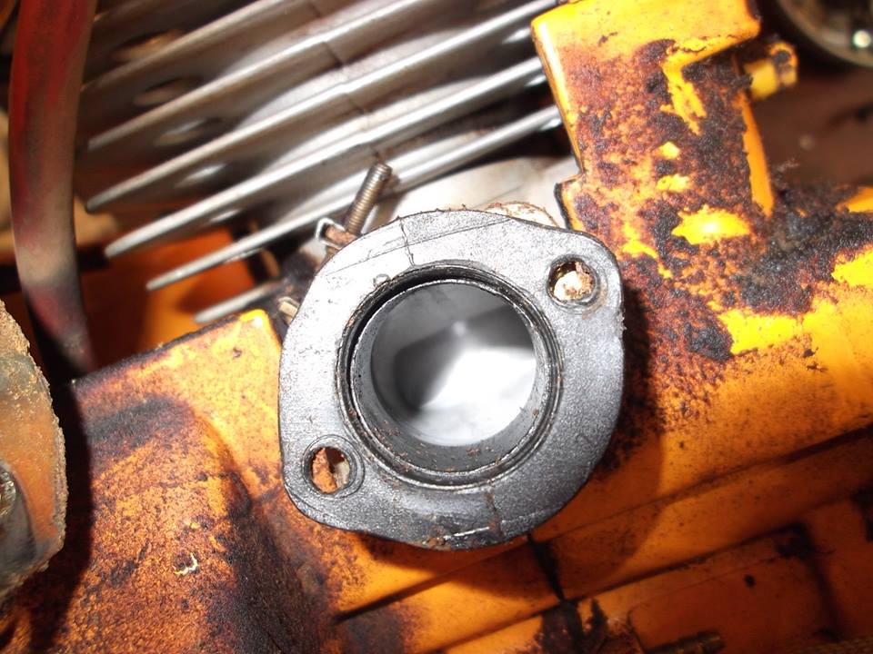

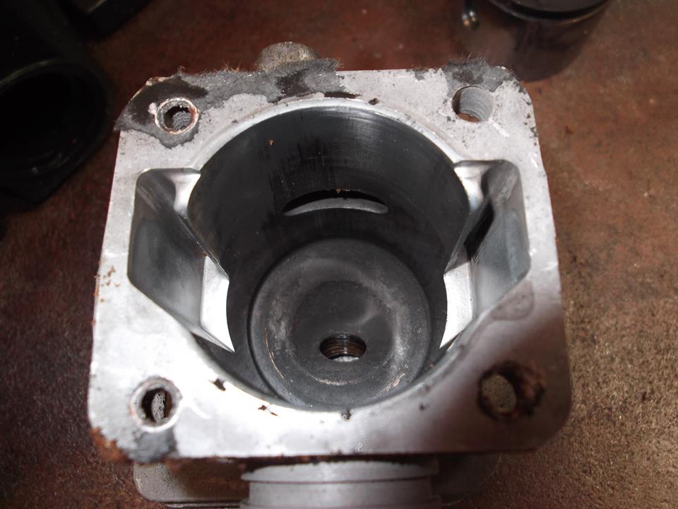

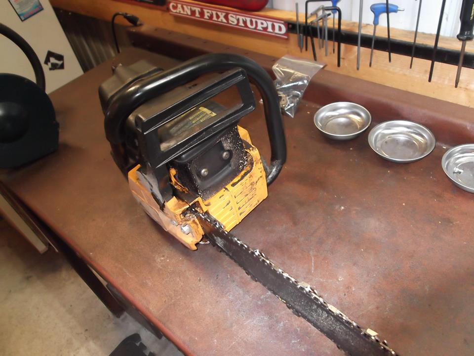

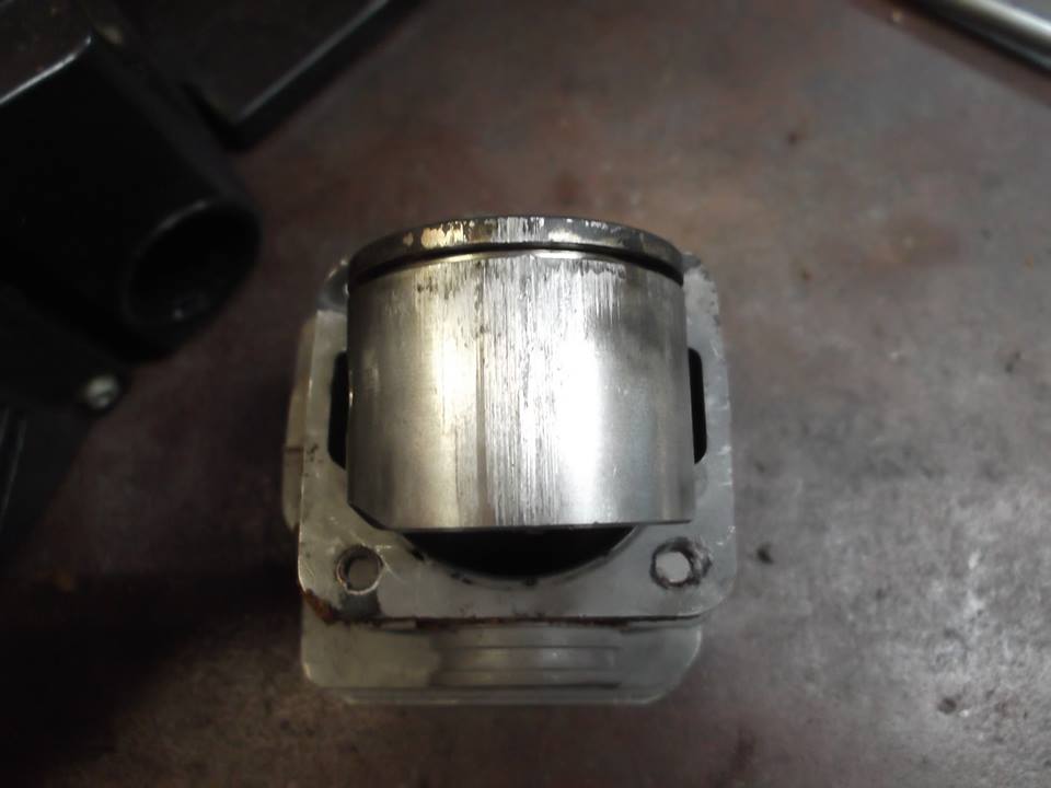

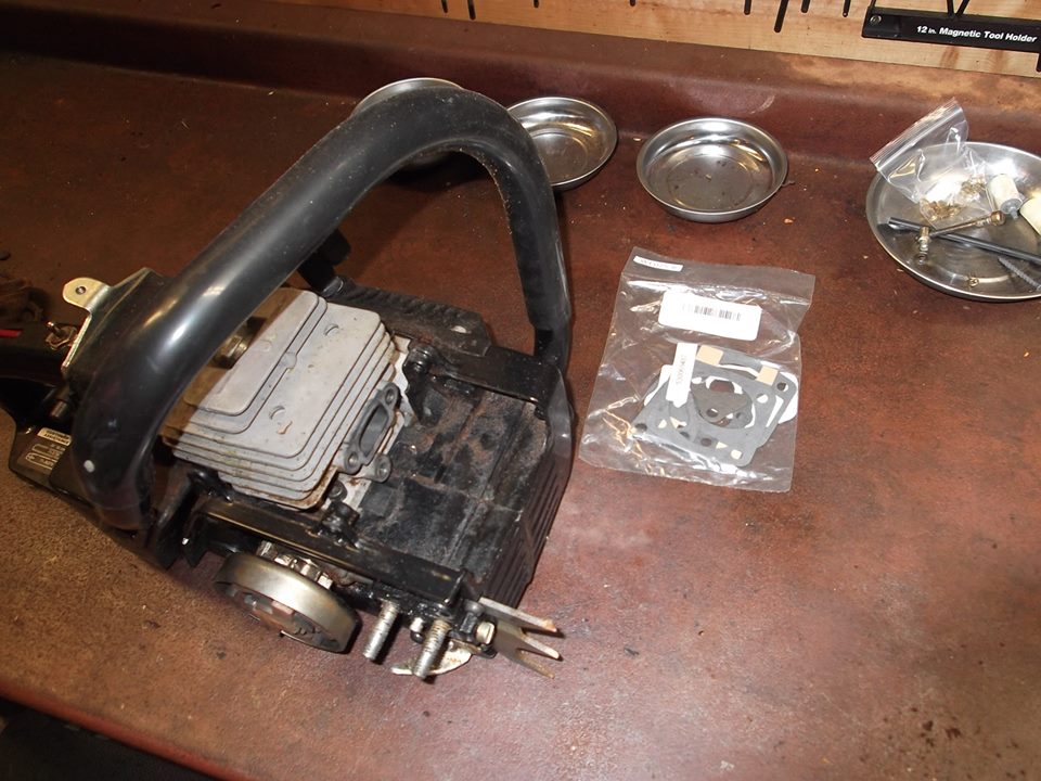

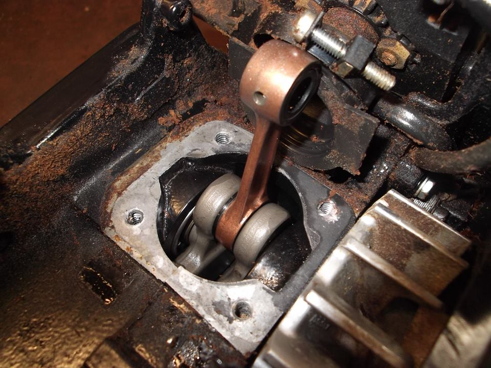

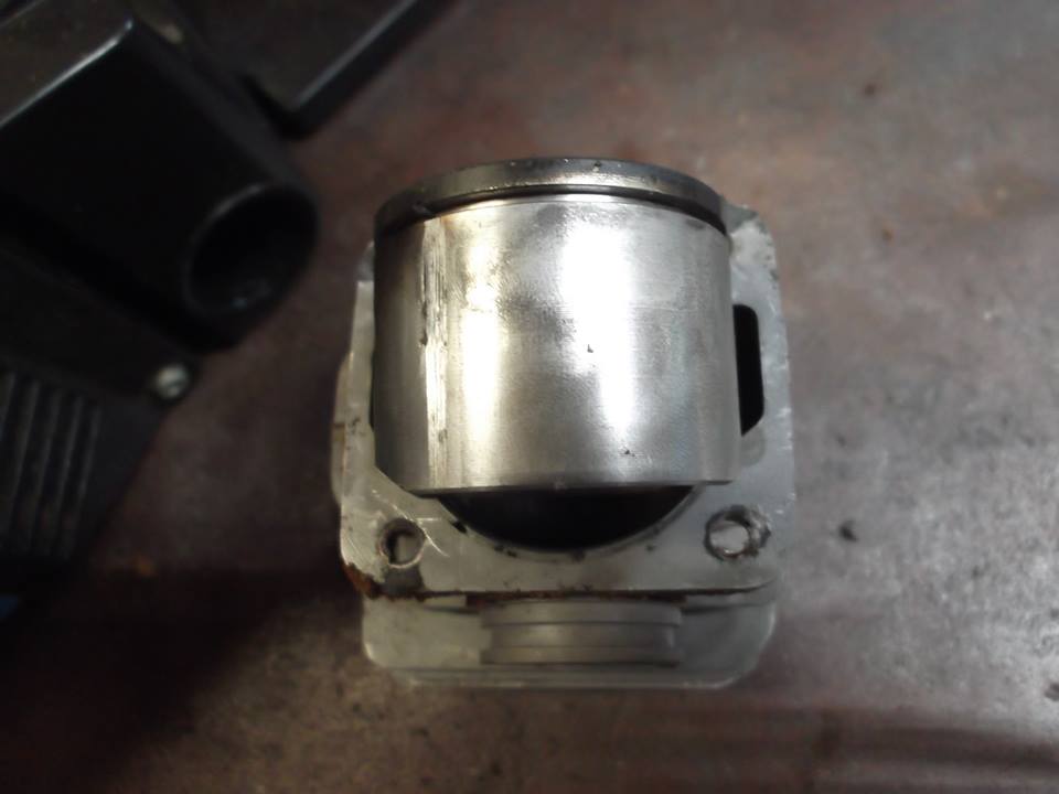

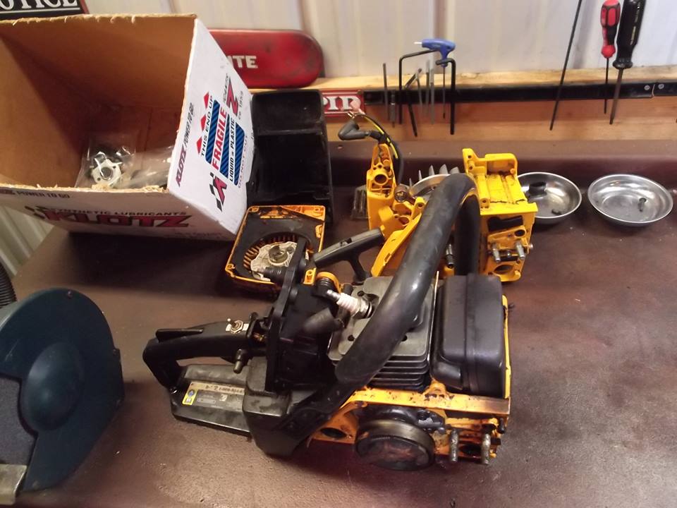

54cc on bench. Have 3 of these now and the #1 is such a ripper. 3 cube size in 54cc
Ordered new piston kit, even though I could clean this piston up and reuse. Cylinder I will clean up.
3.3 LEFT side. Comparing to 330 set up on right.
#320

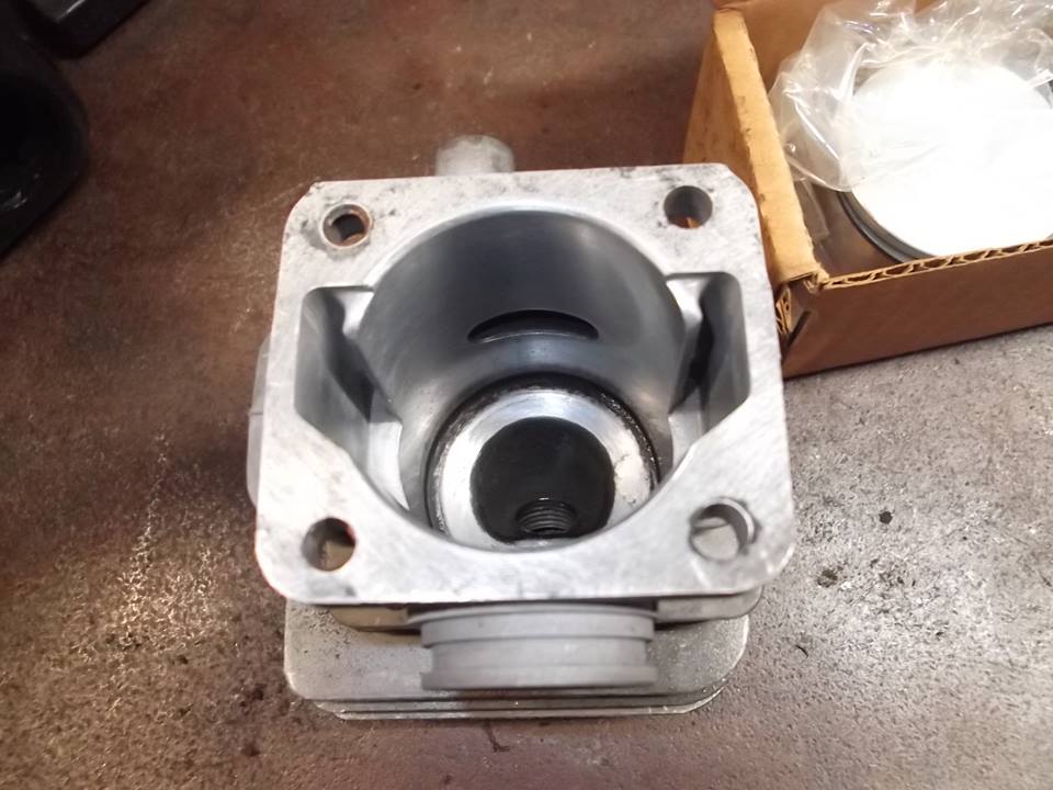

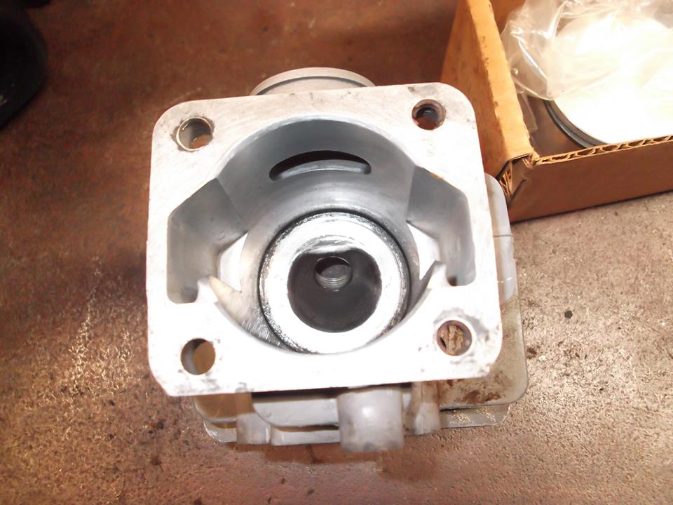

Before and after. Cant find before int side but was long 1/4 wide full length at pin area.
Cleaned by hand. then crosshatch with ball hone going right then left.
