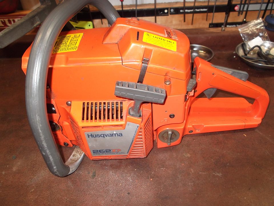

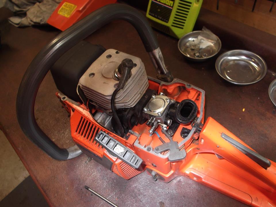

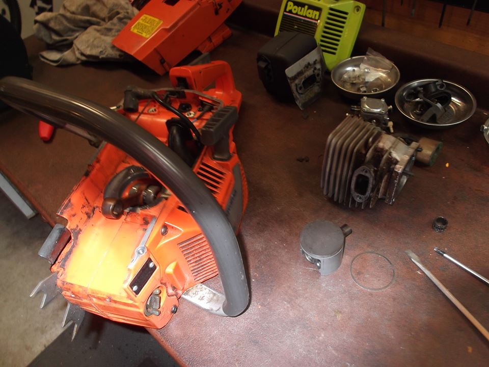

Another junk saw on and off the bench ripping again 1990 first year 262 with the big carb 87 and the good cylinder K&S
