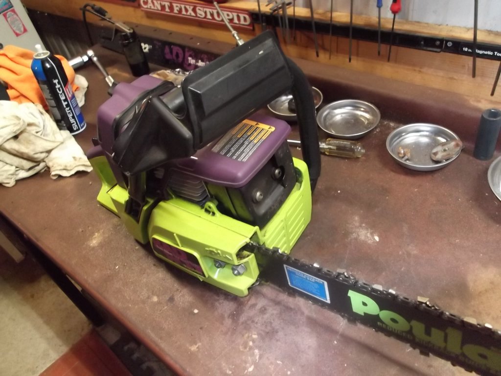

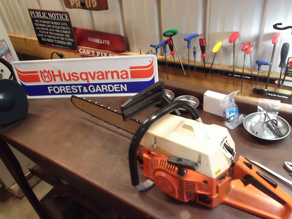

#382
Getting this 60cc ready for a collectors collection.
/ Just another junk chainsaw
#383
another running and ready for a collector. As soon as $$$ arrives.
Thinking first one I seen in BB with 3 shoe, front exit muffler and 137 carb. All the best options IMHO.

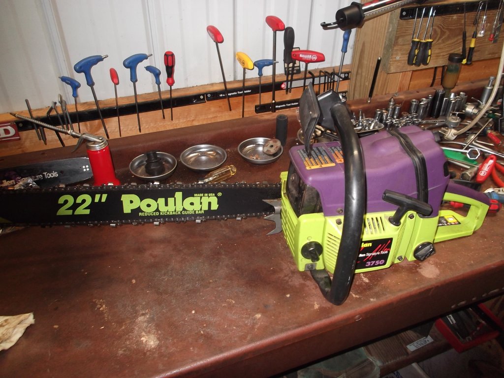

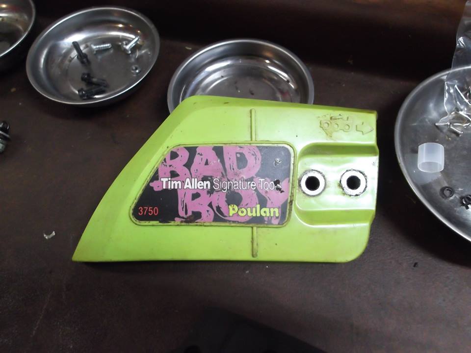

/ Just another junk chainsaw #384
What was wrong with it?
I didn't know there was a Tim Allen chainsaw... Ho ho ho

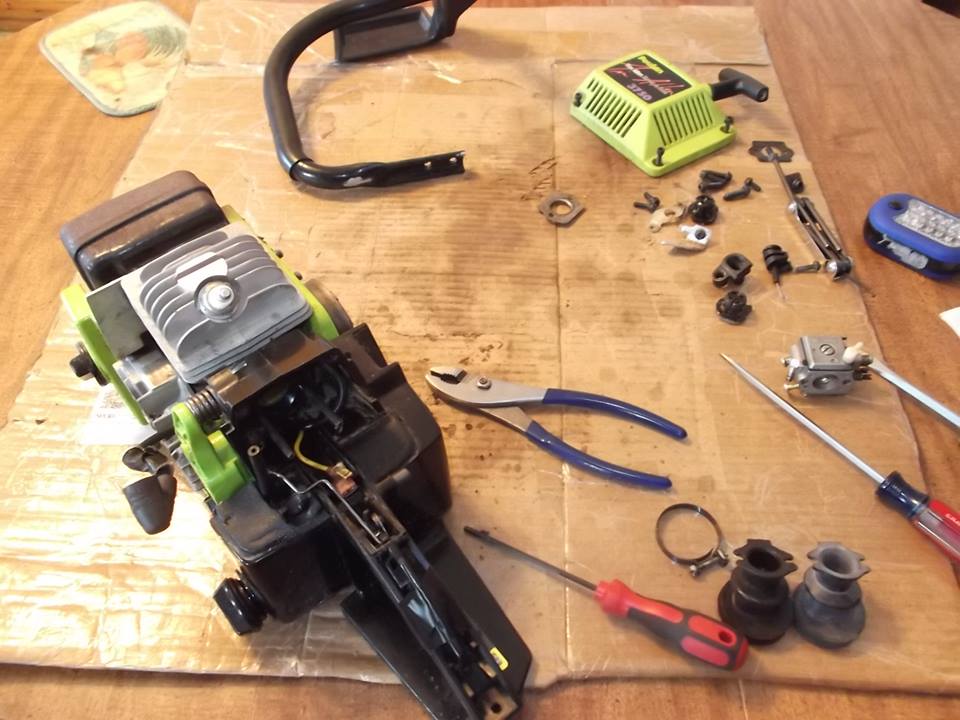

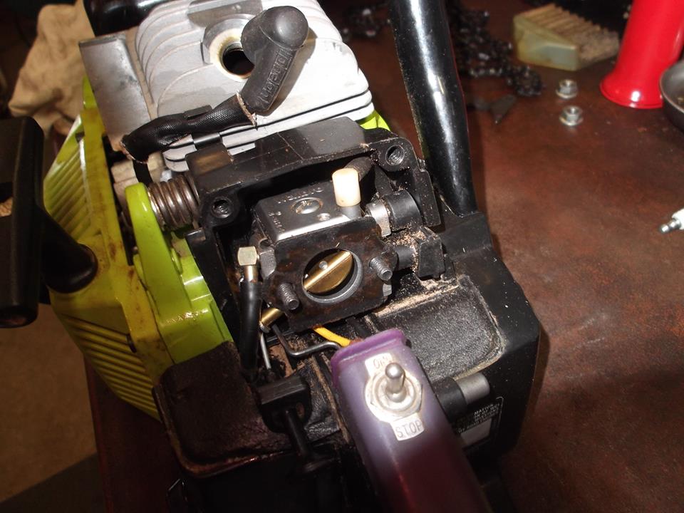

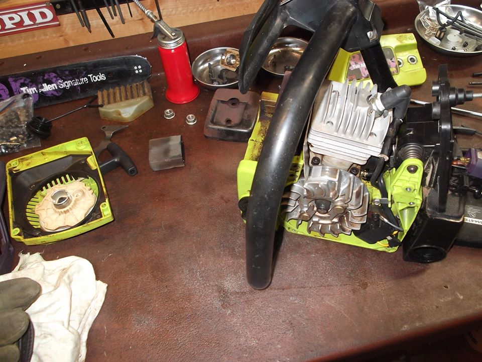

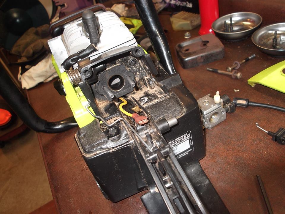

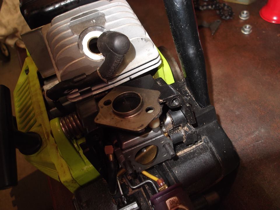

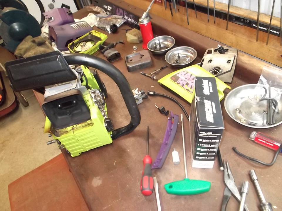

#385
Look at pics posted yesterday. Was missing a part in intake boot and a gasket on the wrong side of carb. Past owner did it. ;)
Plus missing 3 other small parts I had on hand too. coarse av bolt and 2 rubber cover bumpers. Plus put new echo oem impulse and fuel lines and the correct poulan fuel filter being someone had put a small stihl weed eater filter in it . :eek::laughing:
Just needs a carb kit now after testing it today IMO. Stiff diaphragm is a tell tell in the cut.
Post here again.

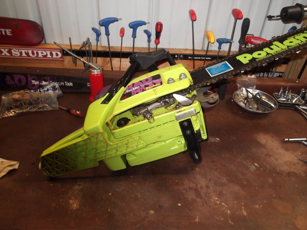

#399

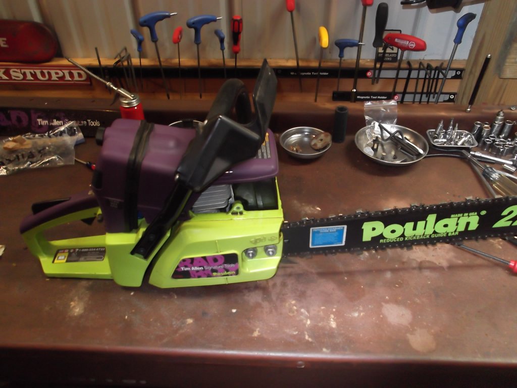

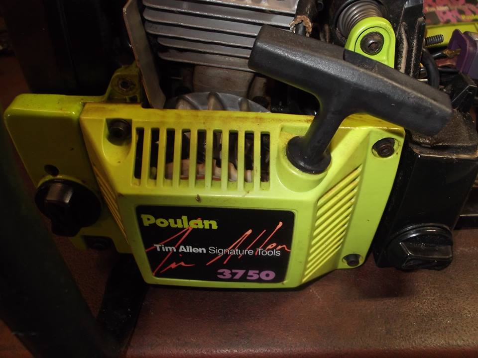

and another 60cc shows up. One of the nicest over the years. Low low time on it IMO.
/ Just another junk chainsaw #400
...and it even has an adjustable chain oiler. And metal chain-catcher. Nice.
Any idea as to DOM? I am guessing mid-to-late 90s. Maybe there are date stamps inside?
I have never seen a Tim Allen special first-hand. I suspect it is the same as the Poulan 3750 Timbermaster.
