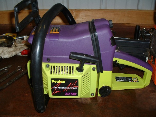

...and it even has an adjustable chain oiler. And metal chain-catcher. Nice.
Any idea as to DOM? I am guessing mid-to-late 90s. Maybe there are date stamps inside?
I have never seen a Tim Allen special first-hand. I suspect it is the same as the Poulan 3750 Timbermaster.
1998 on this one. Had 10-12 of these in in TA BB so far. Yep same as 3750 and 380 in different colors.

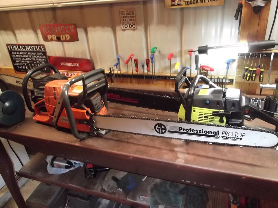

385 505 ready and 3.3 for limbing

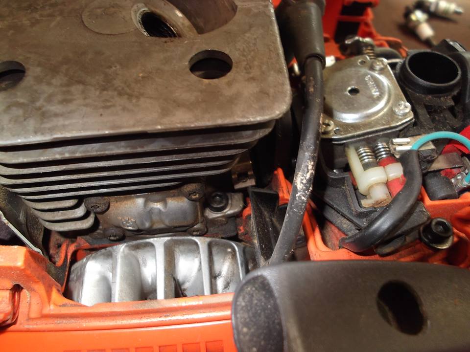

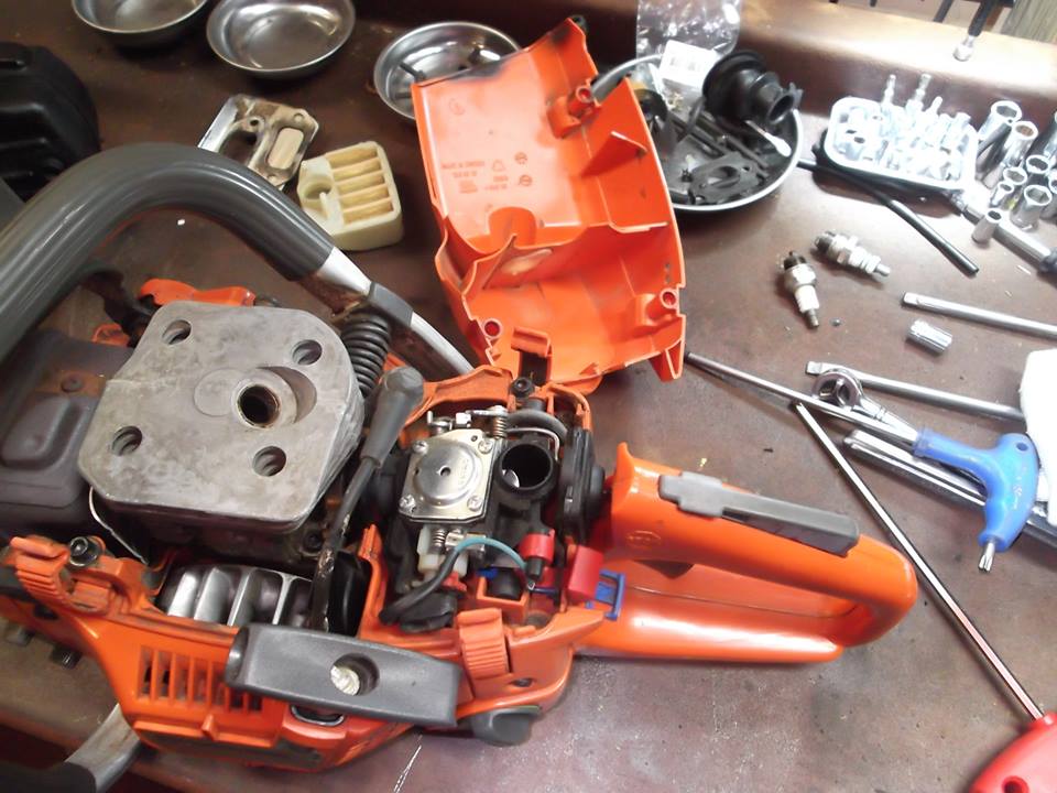

Just to share. Sort of pisses me off one of the local dealers treated him like this. aka took advantage of IMHO.
Took his 3120 to dealer. Told him pulling 130psi so put a new topend on it. Bet was just needing reringed.
Coil wire had been chaffed cut and told him needed new coil. So they put a coil in it. Dont these the plug wire screws out to replace.
New carb installed too instead of rebuild.
Then to beat all they put the wrong coil and he couldnt pull it over to get started. He sent it to Rich Dougan to fix it. Said ran 3 months and back to original issue.
I got saw today and fixed in little over hour. SMH Was Sunday

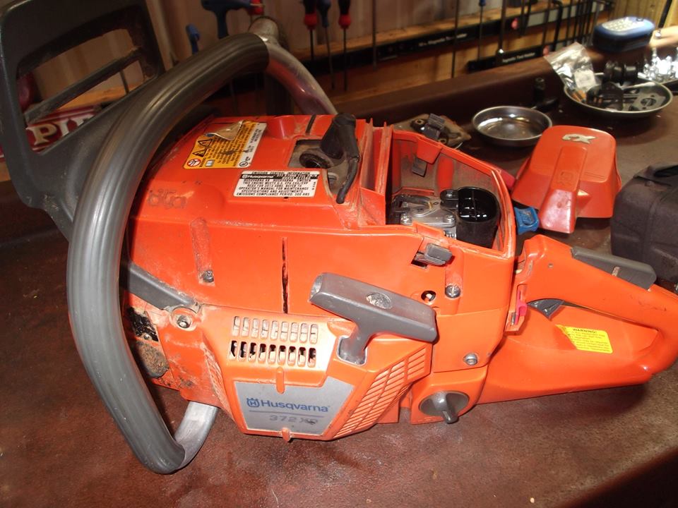

372xp NE and 576xp dropped off.

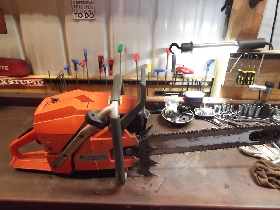

A ported OE Bobby Walker 372 came in today. Skidder op owns it.
