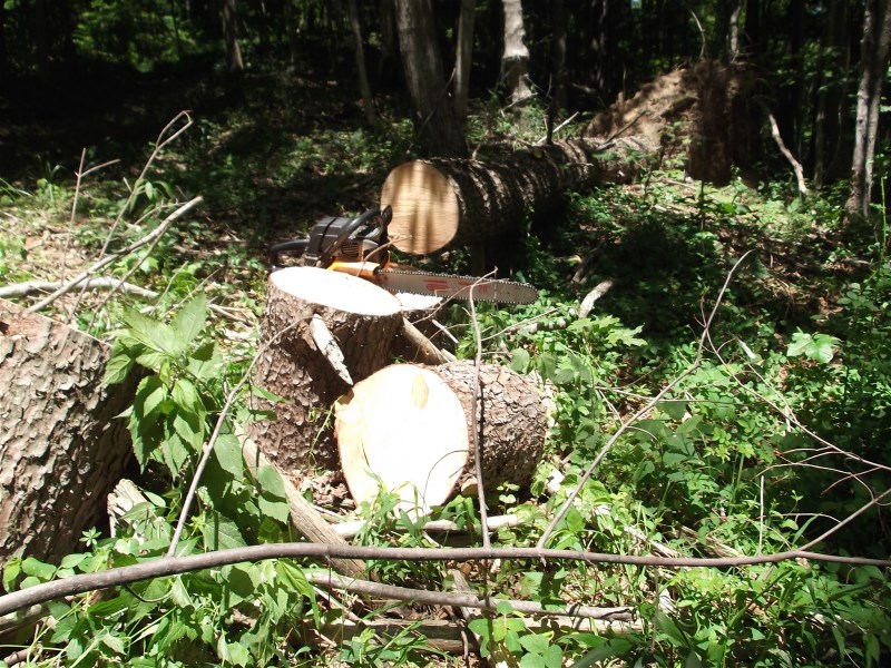

New piston kit for this PP365 and all new AV's, impulse line and intake boot for my dad 21 years of cutting on 3300. The I took the 365 out to break in and the 445 to cut some seasoned oak.
dads3300andapp365 008.JPGdads3300andapp365 002.JPGdads3300andapp365 013.JPGdads3300andapp365 009.JPG
/ Just another junk chainsaw
#267
More pics being can only upload 4 at a time.
The 70.7cc quad port PP will out cut the MS440 with dual port muffler and 372xp in bucking cuts with 20" buried. I had all 3 to test. The PP just dont handle as nice being close to 1lb heavier PHO.
I grab this saw before I grab the 77cc and 83cc bigger brothers with single transfers.
dads3300andapp365 001.JPGpineoakland 005.JPGpineoakland 028.JPGpineoakland 029.JPG

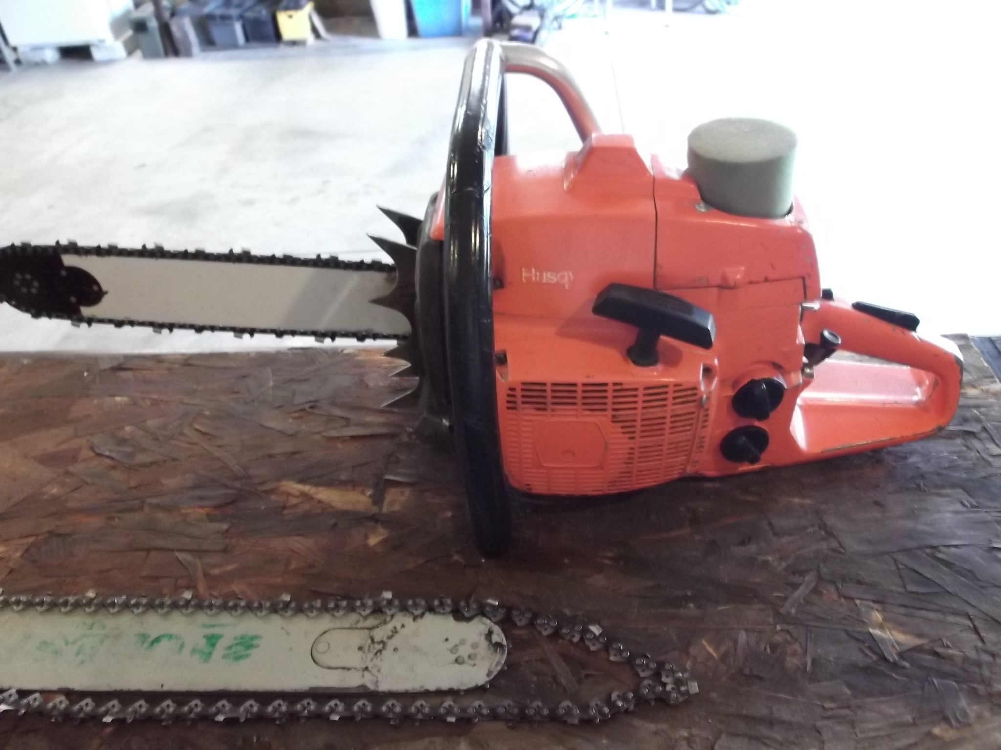

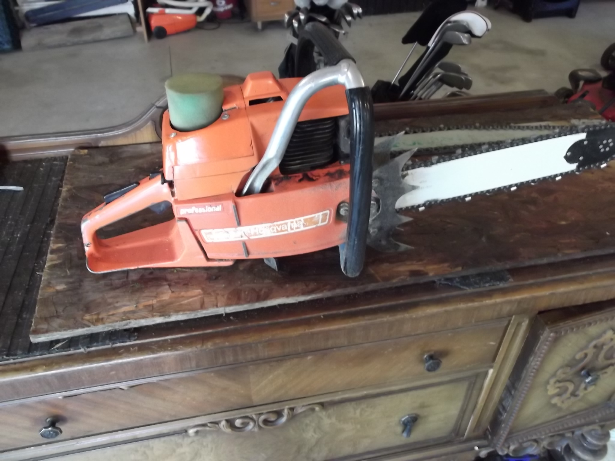

#269
Owner battled it for a month and I battled this thing for 2 days. Finally fixed with help from members at Chainsaw Repair site. Owner runs a 42" on it. I was testing with 16" and 24"
#271
so what was wrong with it?
Several different things. Air leak and bent fulcrum one arm part of Y around needle etc. Wrong gasket being used for intake too. Which is the one supplied in the kits now days too.
/ Just another junk chainsaw #272
Wrong gasket with no hole for pulse line? or just not a good fit-up and seal.
Glad you got it going again. What model is that BTW?
#273
Hole was right on. Just not enough gasket to cover the whole impulse area on the intake block. You cant see that when putting together, trying to hold gasket, carb, air filter intake altogether and line bolts through at same time installing.
I caught it by using carb cleaner looking for leak.
Then took old intake block that was off and 4 intake gaskets from his 2 rebuild kits and they did not fit perfect to seal off completely. So I went looking at my carb stash and found a oem gasket on a HS carb and trial fit. Then installed and tested today again and she is purrrfect.
