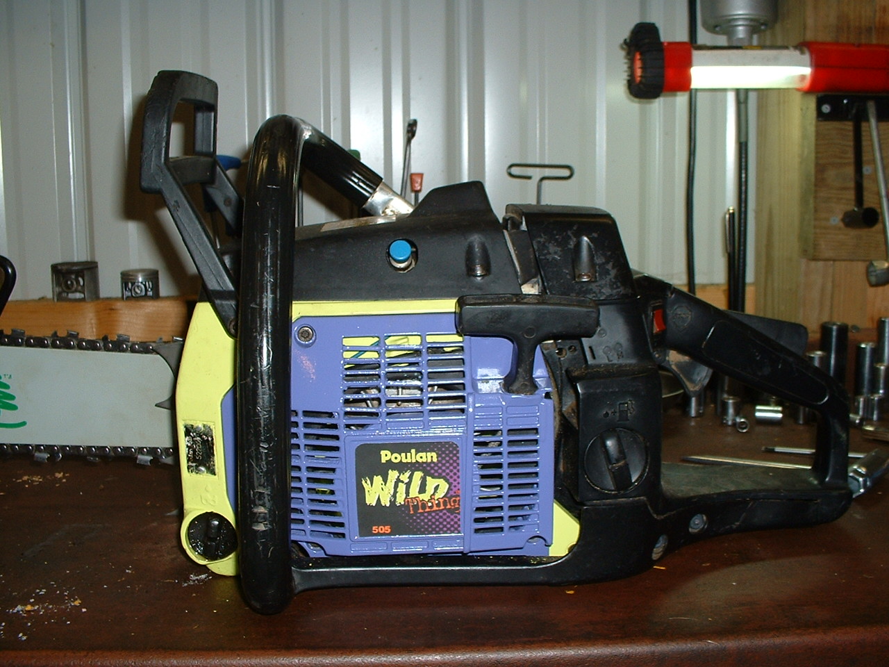

Was working on a couple of orange saws the other day for a guy and after test cutting I ask him if he wanted to run a Wild Thing. I went and got my WT 505 83cc and handed to him. I thought for a minute I wasnt going to get it back after test cuts with only 24" b+c and as big as a grin he had on his face walking away.
