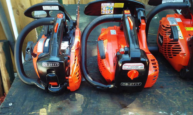

Using the $99 shipped clone G2511 yesterday trimming monster pine tree. With the nano set up.
Made short order of it all with the nano and smooth cutting.
Clone of the echo 2511 that is over $500.
I did notice the cap plastic retainers twist up like that one guy was complaining about (that said he cut them off).
I just filled up leaving cap hanging like normal. Then right back in no issues.
Old pic but the set up.

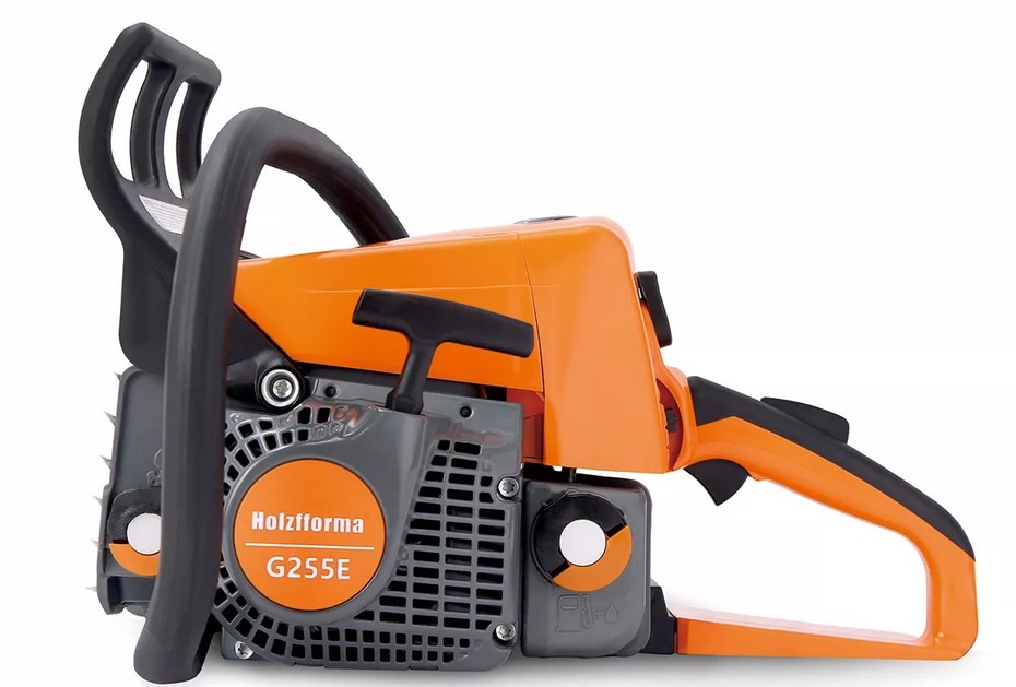

The Farmertec G255E easy start version does not work like the OEM 250 one.
It works just like the one on the 180 easy start etc.
Had a owner of one check for me.
It dont catch with short pulls and wind up like MS250 ES one. Has to be one long pull like 180 ES etc.
They had them on black Friday sale for $118 shipped from their NJ warehouse. He bought one to try out.

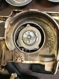

The 2 type systems.
echo spring assist and stihl easy start.

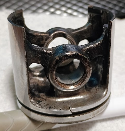

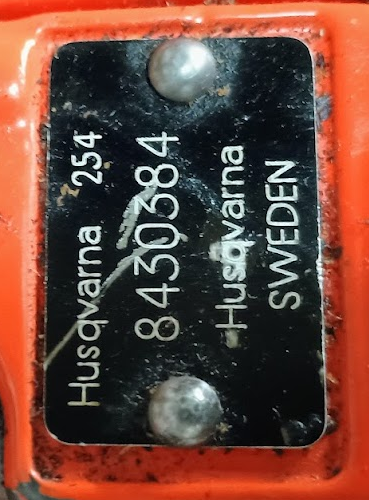

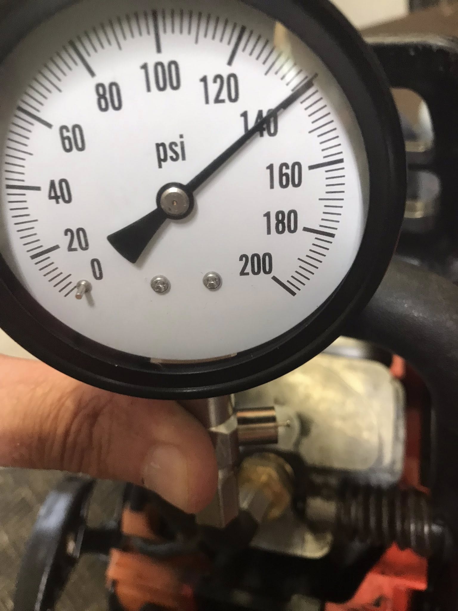

SIL bought a non running Husq. 254 that 'ran when parked' for $100 with a never used 20" bar and chain. It apparently sat for a couple years so figured the carb was gummed up. He couldn't start it so got me to have a gander, zero compression, nothing so figured the cylinder/piston would be scored to death, nope lot of regular engine oil was in the cylinder tho so some one was trying to up compression. I figured the piston would have an access hole in the top when I took it apart, nope, busted ring land. Dunno how you'd ever bust that unless it did a good backfire on the wrong stroke or bad casting maybe.
The cylinder doesn't have a scratch in it, looks like brand new so I don't think it was used much for a 41 year old saw. Piston, ring, two circlips and base gasket $50 which was a lot cheaper than I thought
/ Just another junk chainsaw
#2,700

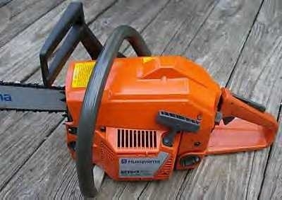

I had a nice 254xp the same time I owned a Poulan 325. Both same cc range. Just different bore stroke arrangements.
Both great firewood saws etc. But guy in great white north liked the 254 way more then me. So off it went.
What I have saved from back in 2008 comparing. -
254xp I owned in 2008 and traded off up to NS
I tested this saw against my Poulan pro 325.
What I took out of owning it and comparing.
What a saw 254xp 45mm 34mm. Runs like the Poulan 325 46mm 32mm, but feels more balanced and nimble in my hands.
Husqvarna 254, Poulan 325 = Partner 5500
