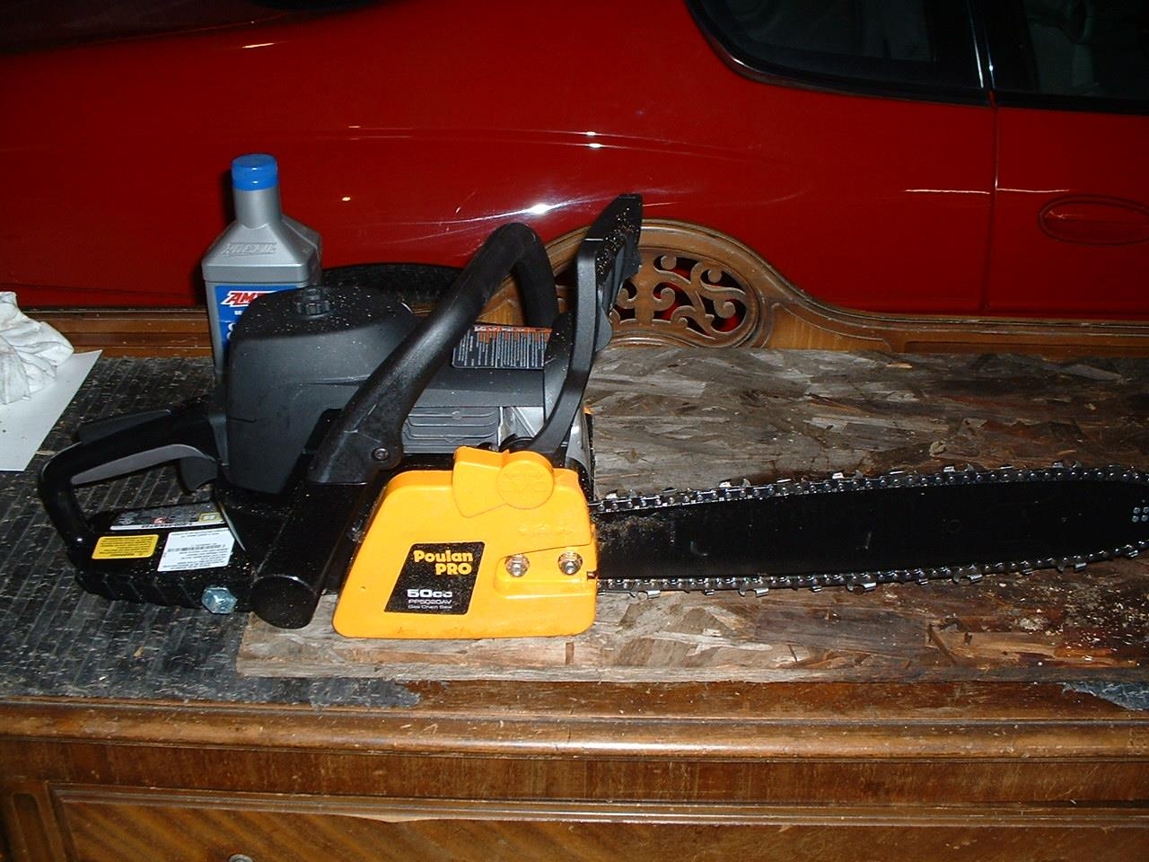

Newer 50cc poulan PR5020 was on the bench trouble shooting that got dropped off for a look. Needed carb kit to start and keep running.
Needs crankseals too once warmed up.
IMO not worth the $10 in seals for the plastic clamshell saws.
But some guys may do them just to learn on. If doing for yourself so labor is free.
I owned the older version in all yellow from new to test out to see 12 years ago. Was fine for cheap price point saw that ran 3/8" 20". Liked it better with 16".
IMO should have come with .325 like the version they sell overseas.
They did ad side tensioner to the newer one so thats nice.
Just going to part this one out and put on shelf.

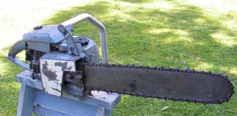

Kind of reminds me of my Dad's old Lombard chainsaw...talk about an ear bleeder! What muffler?? At least all components of the saw were easy to get to! Photo taken probably 60 years ago.

I don't recall seeing this in previous 266 pages.
What is the red car in the background?
That was just a 2004 Monte Carlo I bought for wife one year for valentines day way back.
She was still driving it till a 16 year old idiot hit her out front of our place and totaled it.

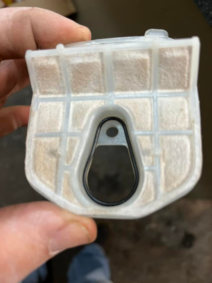

Guy in my group we all have known for many years there and forums.
He said that new carb version of the new 400.1 but is the Stihl MS363. He said = Paveen Stihl ms 363 is usd 850 delivered if anyone is looking for one.
