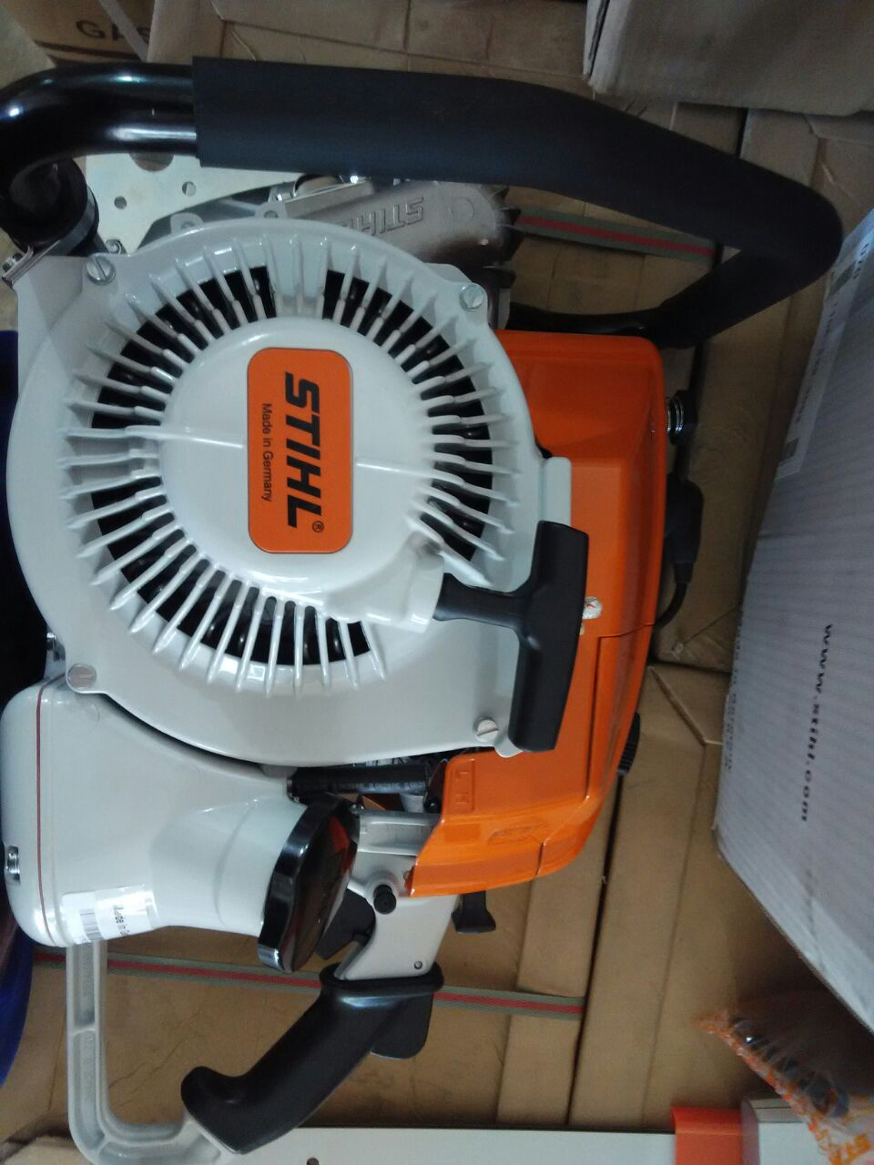

Someone put my little echo inside a stihl box so it wouldn’t get stolen on way here.
All in jest guys. 😂 ✌️

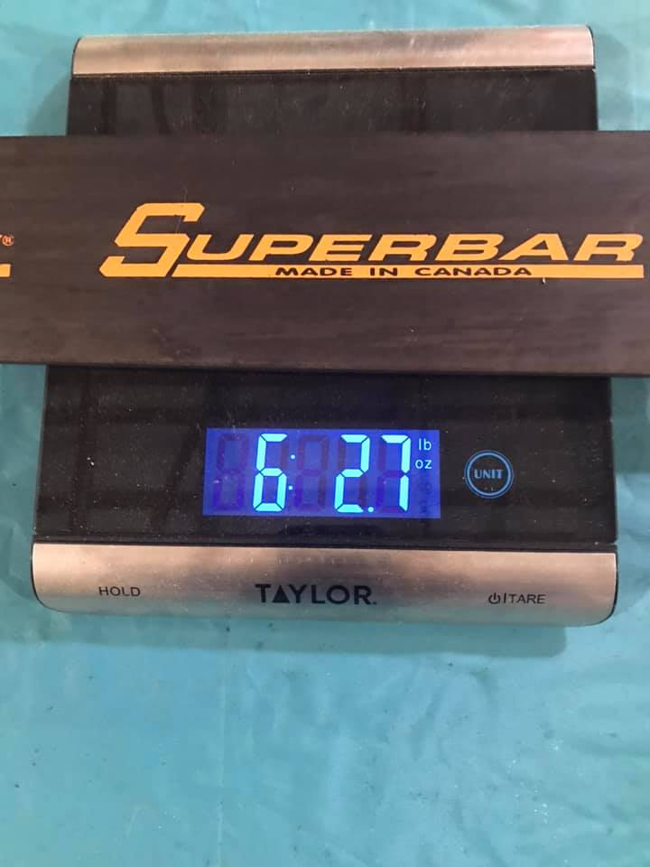

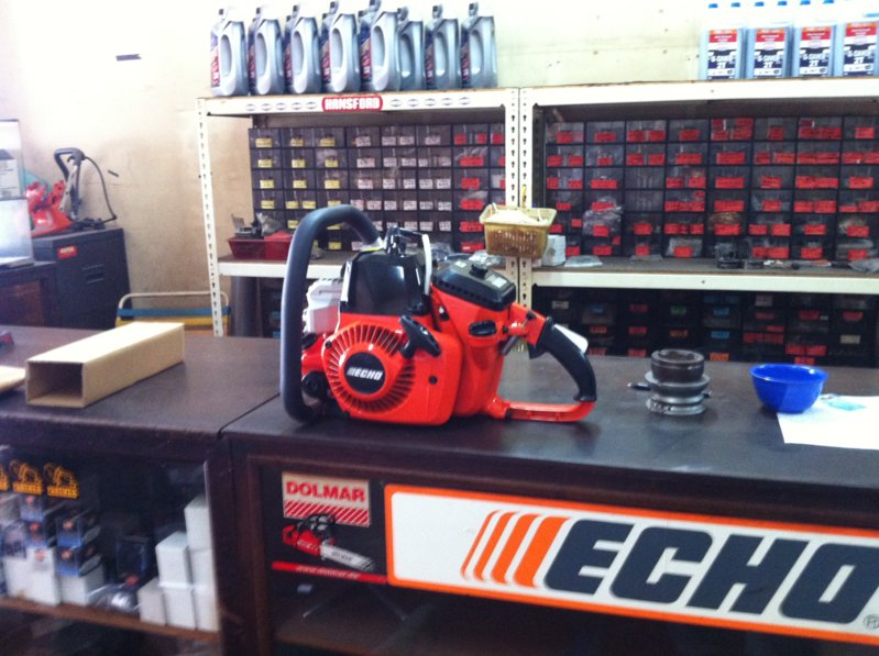

Echo 2511 rear handle PHO weight dry 2511PN
Echo 2511 rear handle PHO weight both tanks full
Echo 2511 rear handle both tanks full. 12" 325 043 narrow kerf chain weight as used
Egan pipe was already installed for these weights.

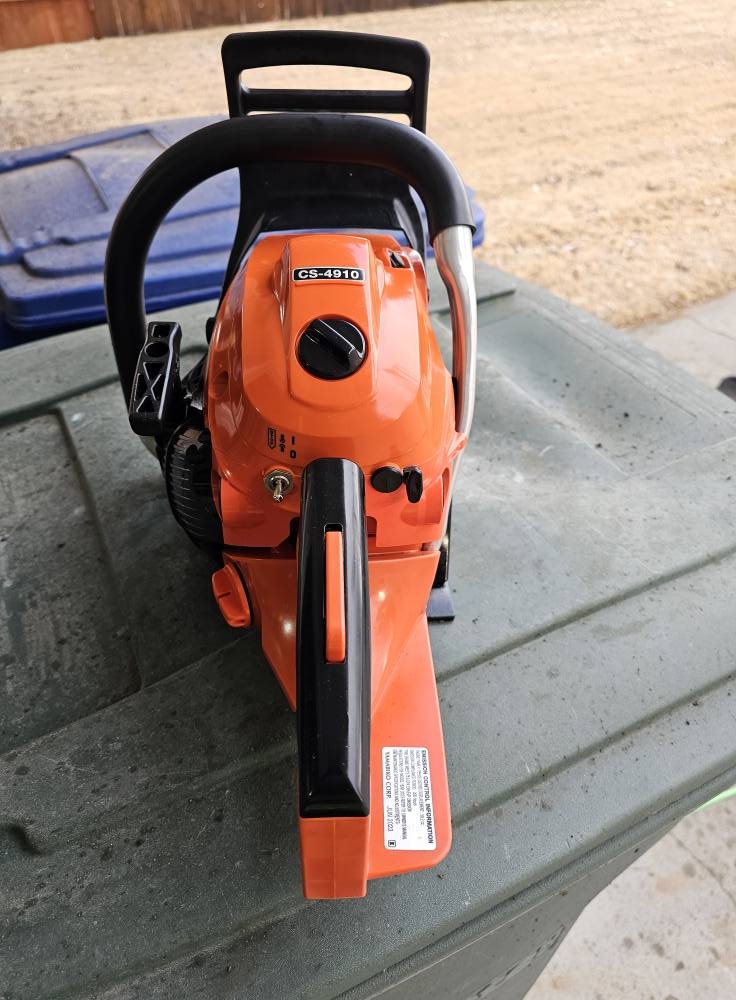

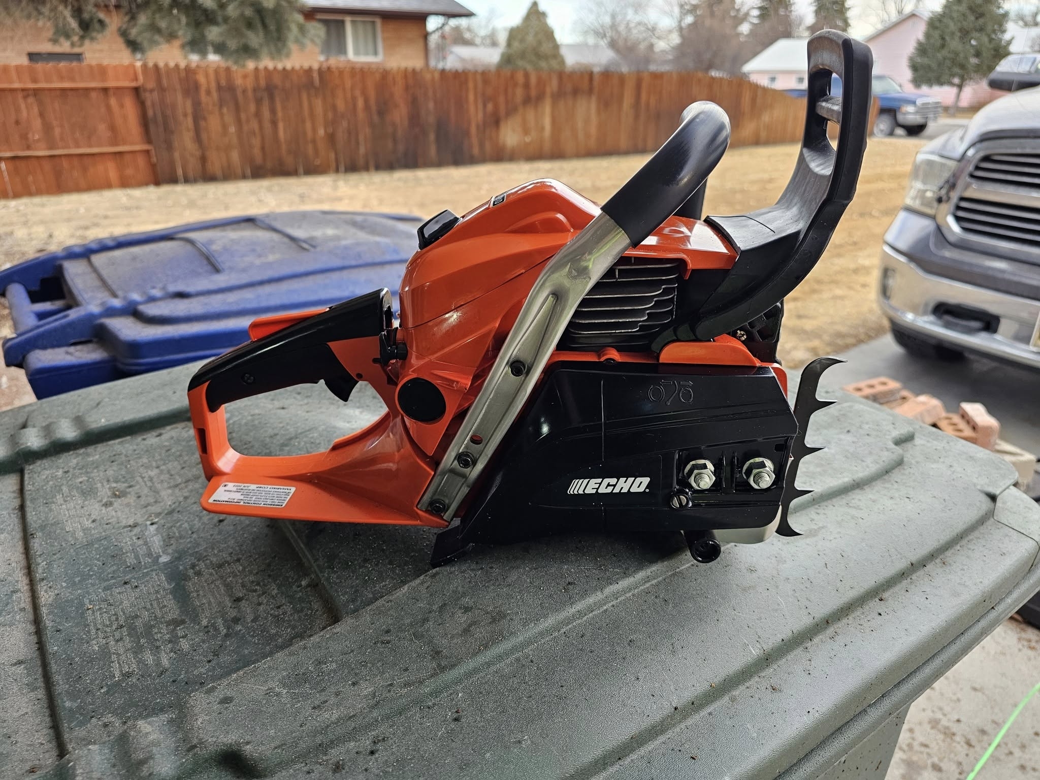

Finally got rid of the cheap plastic feeling vibrating handle. Went ahead and put the rubber coated rear piece too.
That echo 490 used.
Put new 501 set on.
On 490 all fasteners needed to be cut shorter.
Plastic fasteners longer due to plastic.

Guy I traded 4910 to said 4910 fastener same length as 501 used for handle.
So didn’t need shorten like 490 did.

Thanks! I will probably order one of these soon.
The black rear grip on 4910 is black plastic like on all saws I have ever known.
But the 501 offers rubber coated over metal there if you notice any vibrations there too.

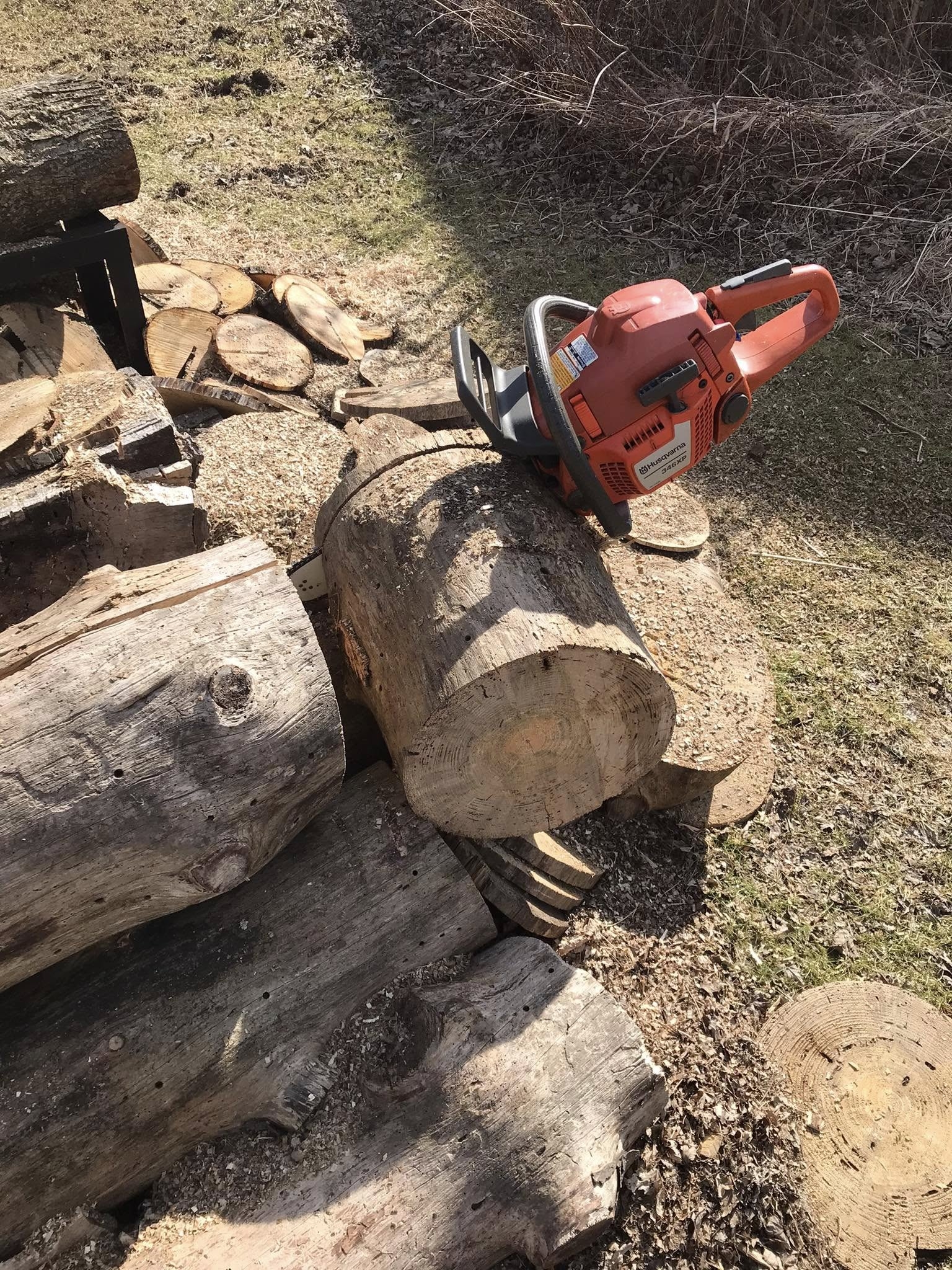

Project packrat 346 tester for aftermarket topends. Just for kicks.
I decided not to clean up the ports or beveling. As I wanted to se what joe homeowner would try by him self.
44.3 warhawk that also looks just like Dukes one he offers.
She lives. Thats a start anyways.

Packrat.
There must be differences in brake handles. Going to have to open the slot on left side in different area.
Oh forgot to get a air filter. 🤦‍♂️🤣😎✌️
Made around 10 cuts and impressed with stock 44.3 aftermarket cylinder.
Pulled carb for a rebuild kit afterwards.
Wish had done it while saw was apart or it's tank vent acting up. :rolleyes:

4910 I traded to guy. Told him about better 501 set up handles. = Was out giving my 4910 a bit of a workout in the wood pile today.
Swapped back to the plastic handle to see if there really was a big difference in felt vibration between it and the alloy grab handle.
Running them back to back I'll tell you there's easily less vibration with the alloy handle! Great little saw for sure!
