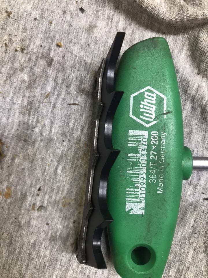

Dont care for the echo 2511 caps. They want you to use the T handle. I call BS.
577878603 T435 caps in normal ending on 1 and flip caps work ending in 3.

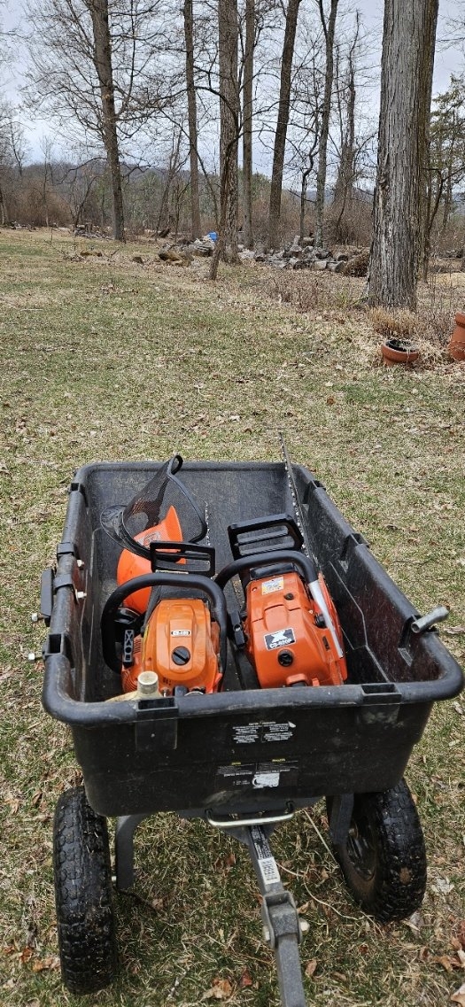

Both saws got a good workout today, on their way back to get cleaned and the chains sharpened.
The dead Ash is rough on chains when it turns from solid to powder in the trunk.
More work to go, lots of firewood to make.

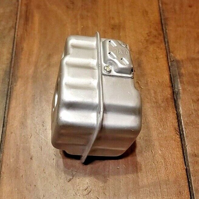

490 do fine?
Have you muffler modded that 490 at least? Echo is so bad and detuning them using mufflers.
Stock 490 muffler is even worse then 4910 501 stock.

I have a new exhaust cover ready to go, just need to find the time to get the old exhaust off.
It is pretty well stuck on from the factory.
Will let you know when done, need to clean the screen too, sure that's not helping the HP.

Toss that blame restriction pipe they put inside too.
Open the front of stock deflector and it's all free for nice gains too.

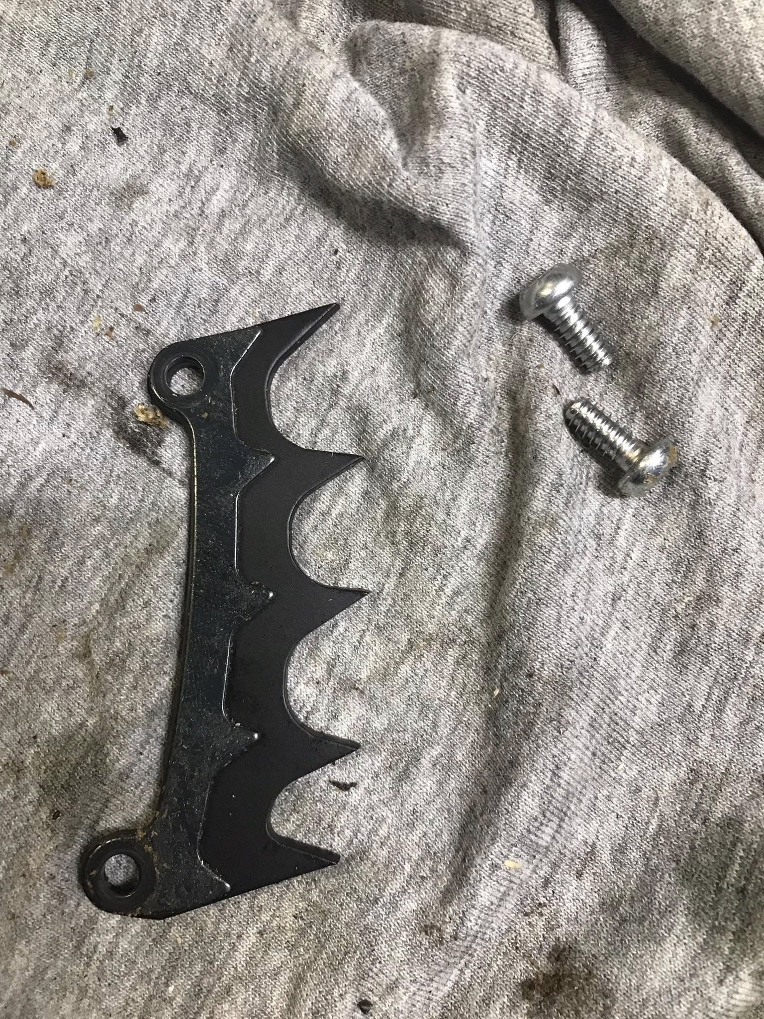

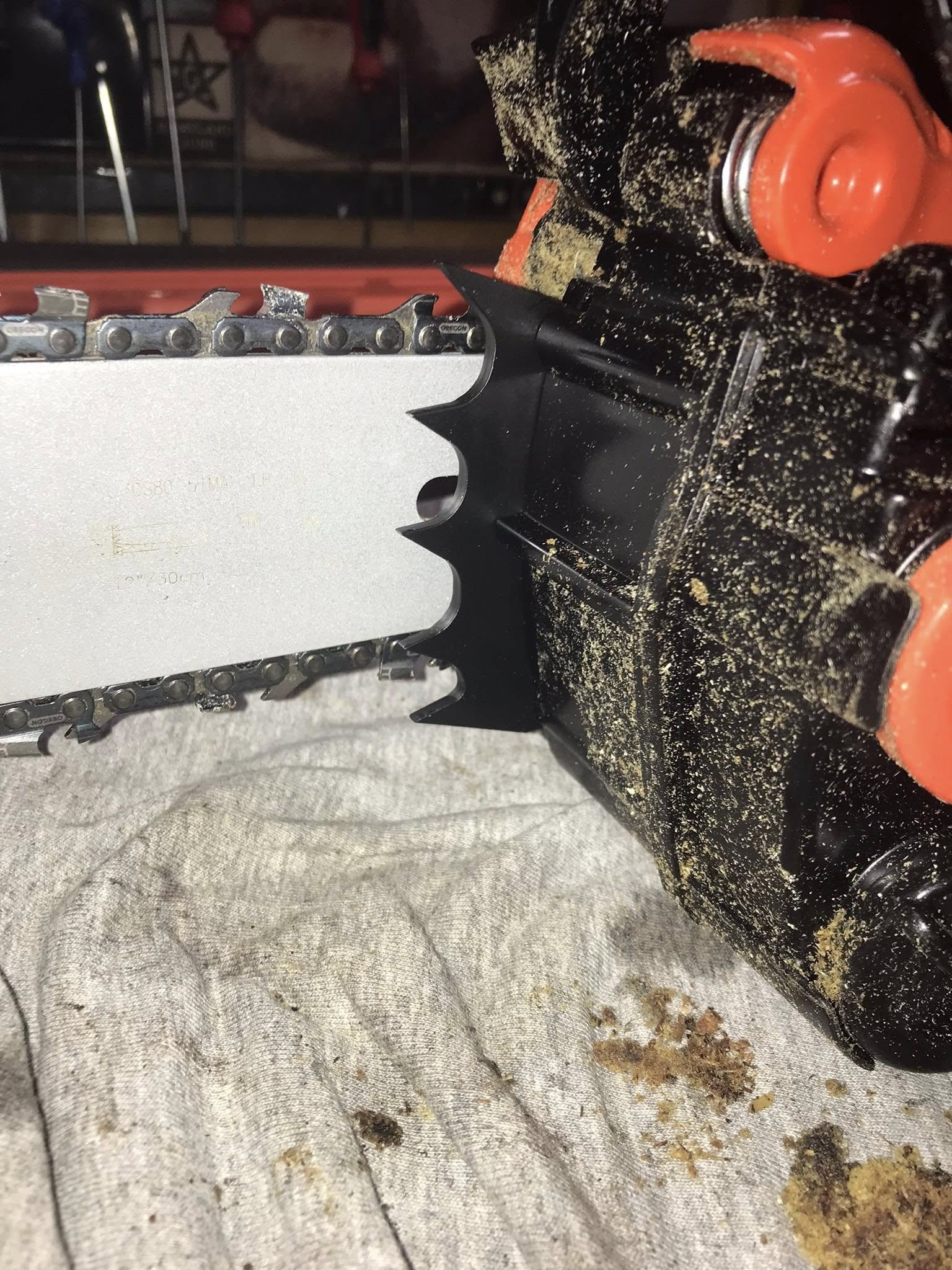

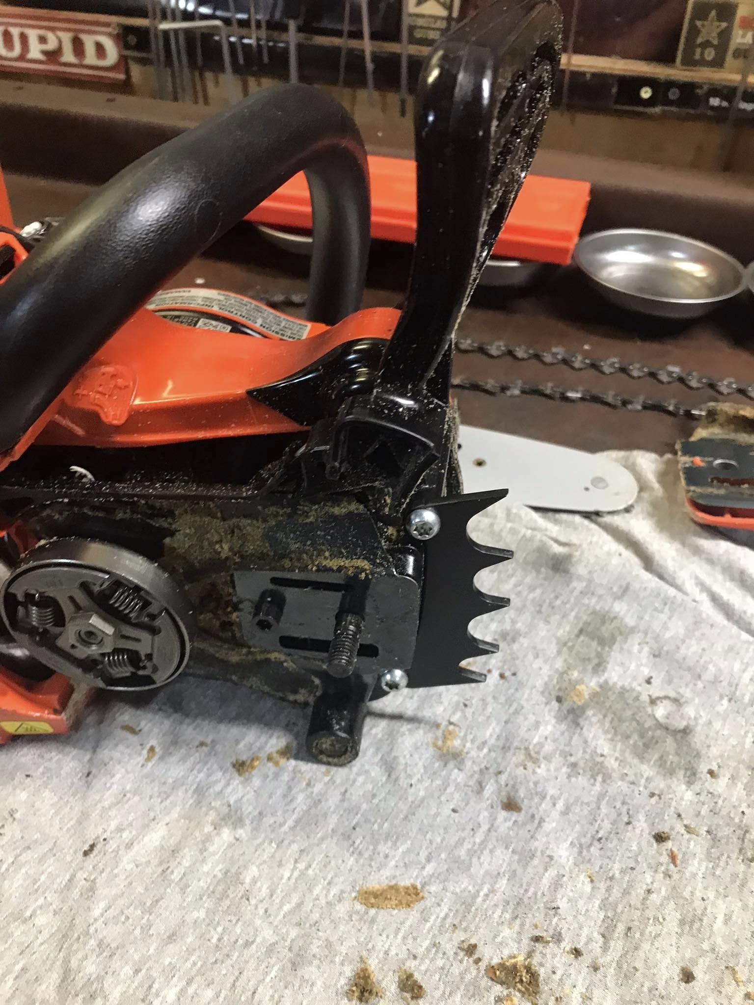

I changed directions on my thinking after some run time on the echo 2511 rear handle PN. For spike I wanted for my uses.
So I went with a 5 point bigger spike over the 3 point I was going to get.
Pics show how much longer and thicker over small oem one. With same spike angle design.
10 bucks shipped.
OEM one basically worthless. Look how tiny.
10 bucks shipped.
View attachment 3168988View attachment 3168989View attachment 3168991View attachment 3168992
Where did ya get this at?
/ Just another junk chainsaw
#2,076
My wife was making a order on amazon actually and saw it there. Same one that cost double the price on ebay. 10 shipped.
I figured worth the try to see before going to a 3 point Jason Egan spike I was going to get.
