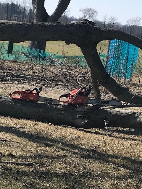

Going to test this packrat 346 44.3 afm mm against my 501 mm. Will be using same C33 325 chain on both saws.
It's the one that somehow out cut the last OEM cylinder 44.3 NE 346 I rebuilt and sold. Couldn't tell it till timed the cuts. Surprised a bunch of us.
That should tell me how close this afm 44.3mm is out of the box.
/ Just another junk chainsaw
#2,042
Echo 501
Even took the trufuel 40:1 out of the 501 I was testing it with. Never a issue and never changed tune.
So same batch of Efree 89 40:1 VPracing oil mix in both saws.
Same C33 325 will be on both.
#2,043
Frozen maple 9x8 3/4. The 346 only started 2nd tank on aftermarket 44.3mm set.
Out of the box untouched.
Echo 501 is one that out cut my last oem 346 NE.
I have not timed anything yet. But going to say 501 on this match felt ahead. When ran the OEM cylinder saw last match I didn’t think that. But 501 was quicker then too

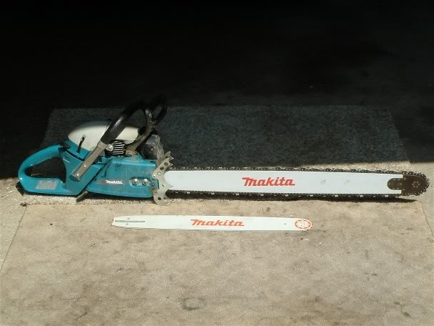

Do you ever come across any Makita/Dolmer 6401/6421/6400? Preferably with a worn out P&C? I've had a oem 7900 P&C for my 6401 sitting on the shelf, but the saw just keeps on going! Would like to build one up.
Seems all the cheap used makitas have disappeared in my area.

Guy south of me just sold a nice looking ported 6401 for 400. Another guy south of me about 30mins has a stock 6401 FS in my chainsaw repair group in 300-400 range.
Another on FB market place for 350.
Just watch FB MP. 64 73 79 all the time being sold. Some 79's now.
I just dont do the dolmars or makita myself for many years now.
Heck parts were hard enough and I had dealers around me back then.

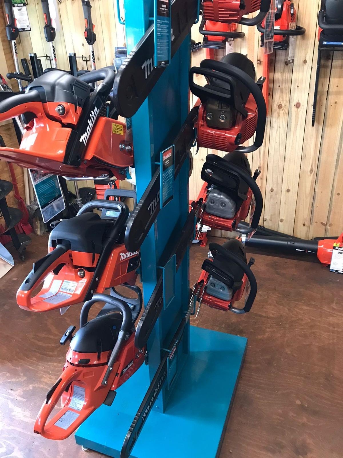

View attachment 2978975View attachment 2978997View attachment 2979015
Been looking for a while, only one not a couple hundred miles away the guy won't respond. Wish I had bought another one before Home Depot switched to the 6100.

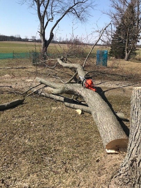

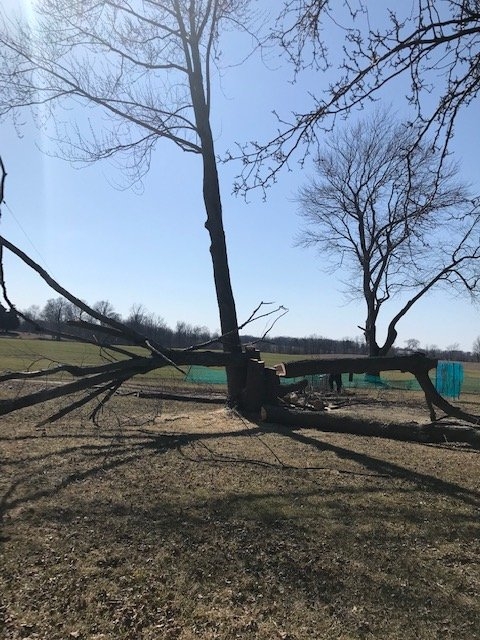

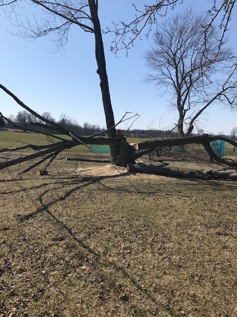

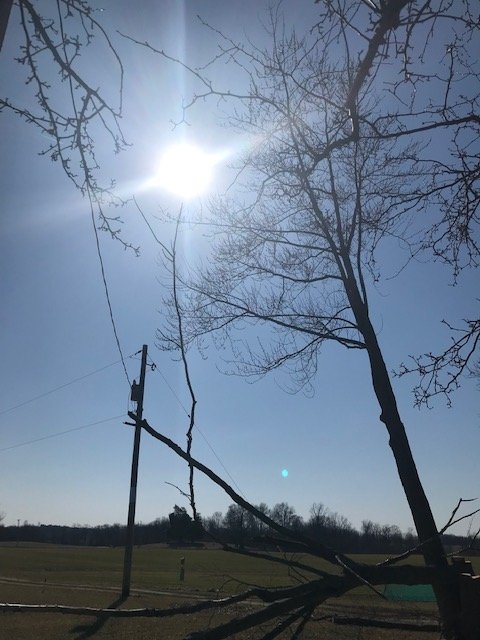

I should have took this maple out 25-30 years ago. Now it has become a worry with the power wire, transformer pole and guide wire.
4 of 5 down. Need to top the 5th one as it is bad leaner and will easily catch power wire. I'm not skilled enough to swing it other way.
Heck the 4th one dropped got me on that and got lucky.

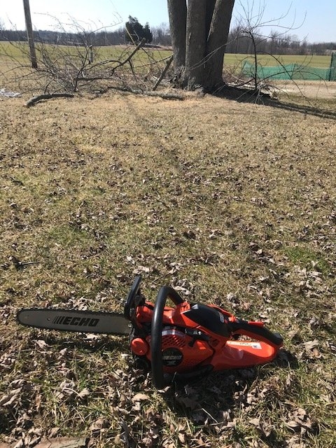

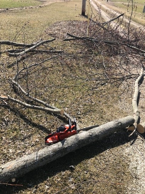

So impressed with the new member of my tag team. That echo 2511 rear handle with nano 325 043 nk set up throws some dang chips as a limber.
Used for 12" under there was no stopping it on the multiple truck maple 5.
Used the hack ported 490 with front and rear 501 handles. No vibrations felt like the plastic crap did.
Running the stock 18" with 23RS the new stuff.
View attachment 3025093View attachment 3025094View attachment 3025095View attachment 3025096View attachment 3025099
The 2511's are just unreal! I have been hearing many tree companies are moving to them now.
Have you ran one next to your 2511 clone? If so, thoughts?
Not same set ups though. 325 043 nano is fast and smooth. 1/4" mini micro isnt fast but is super smooth.
The 2511 clone is open port and stock little pipe on open muffler. The oem 2511 closed port has that Egan pipe for like 28% gain alone beside chain.
But if clone was set up same it would be real close.
Heck was close enough as I use clone for pruning right now.
Clones are just not refined and $130 compared to $500 too.
I will be buying a rear handle clone when released. They said still coming.
Watch yourself, you seldom get a 2nd chance. You just used #1.
