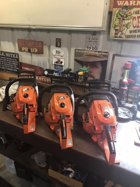

I have 2 501 muffler modded and a echo 490 ported already and a clone 2511 TH.
I am sort of leaning toward the rear handle 2511.

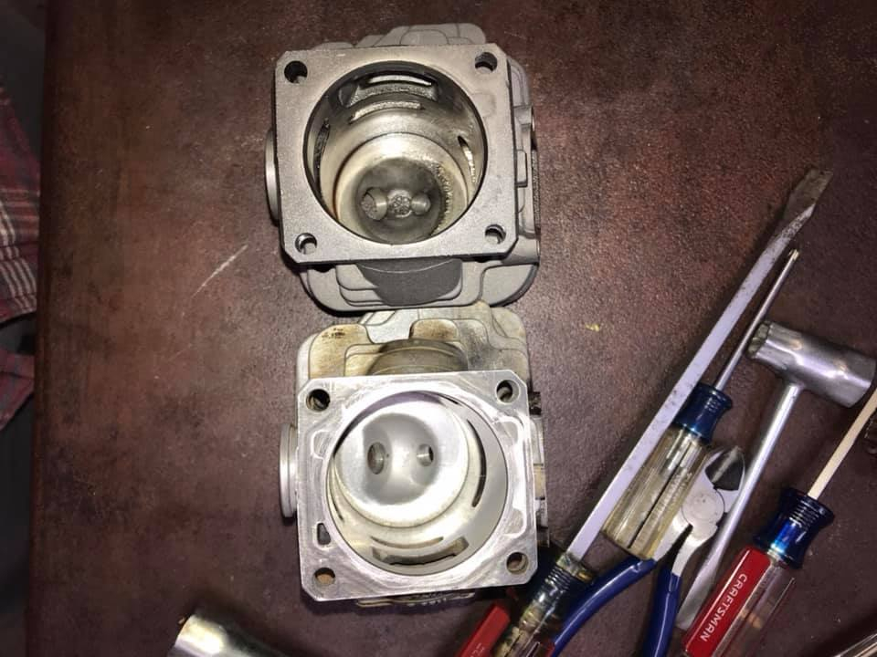

I've been meaning to check the squish on my 2511T but haven't gotten around to it yet. May do that this weekend.

@JeepHead I ask some of the porters in my group. 2511 stock squish
About .032” or so. A gasket delete works on them but the cylinder extension bottoms out on some of them

Guy that did my one 359 -
2511 Last one I ported was .024 with the gasket but all the others where in the .030-.032 range .

I was considering porting my 2511 but not sure if I will or not. Doesn't sound like it's worth it. I very well may do a delete on it this weekend if I have time. Me and the twins have a lot of wood to cut this weekend and they're both grounded right now so that means extra hours as punishment... Although, not sure if that punishes them, or me! :ROFLMAO:

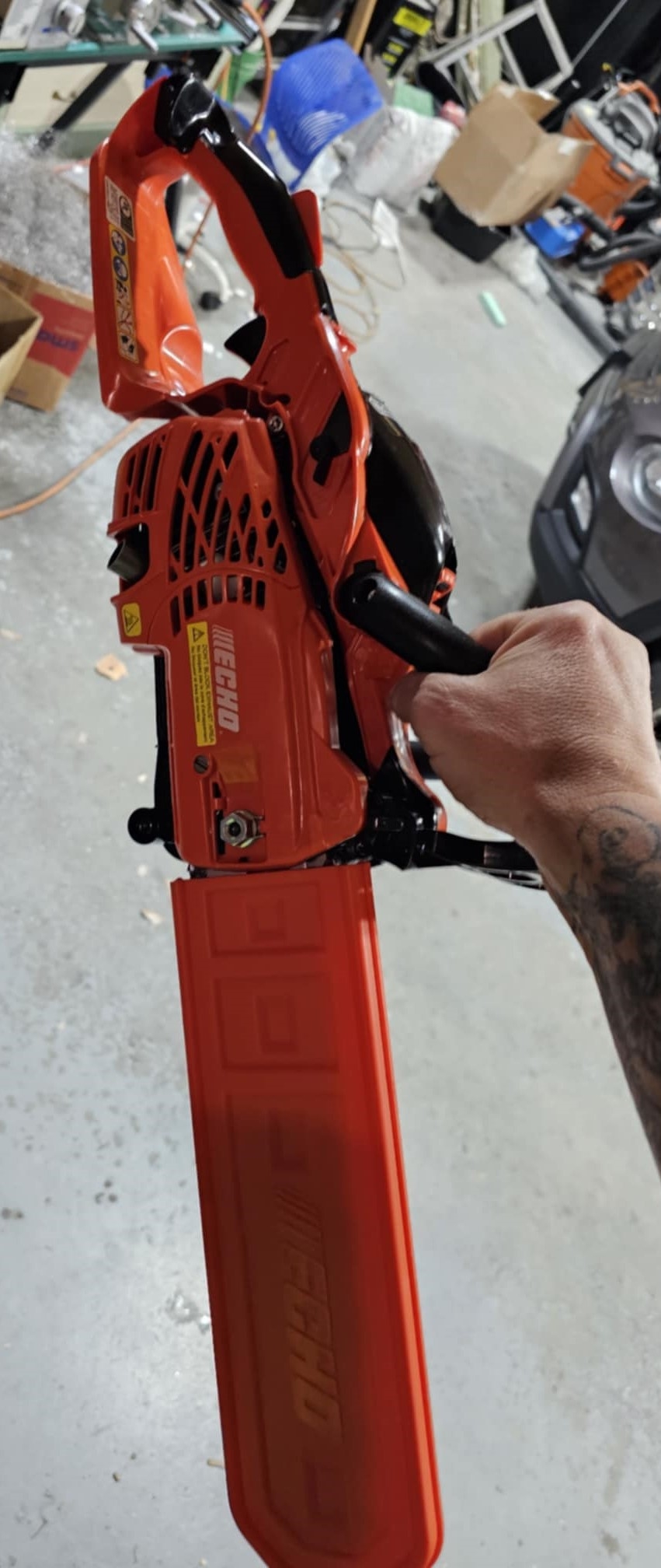

#2,014
4910 I took on trade to go with the 2 501’s and hack ported 490.
Swear never even made a cut before.

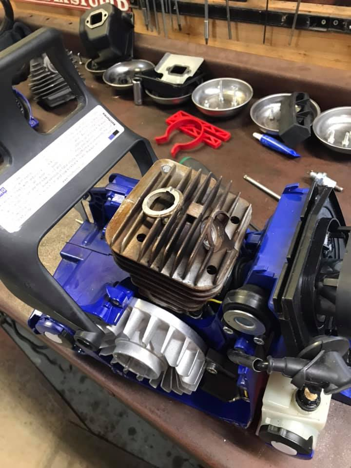

/ Just another junk chainsaw
#2,015
All they need to keep fines out is this nickle o-ring. You can add grease to base of af mount too but didnt see a reason to to date. Been doing this on these since 2022.
So one going in right away too.

#2,016

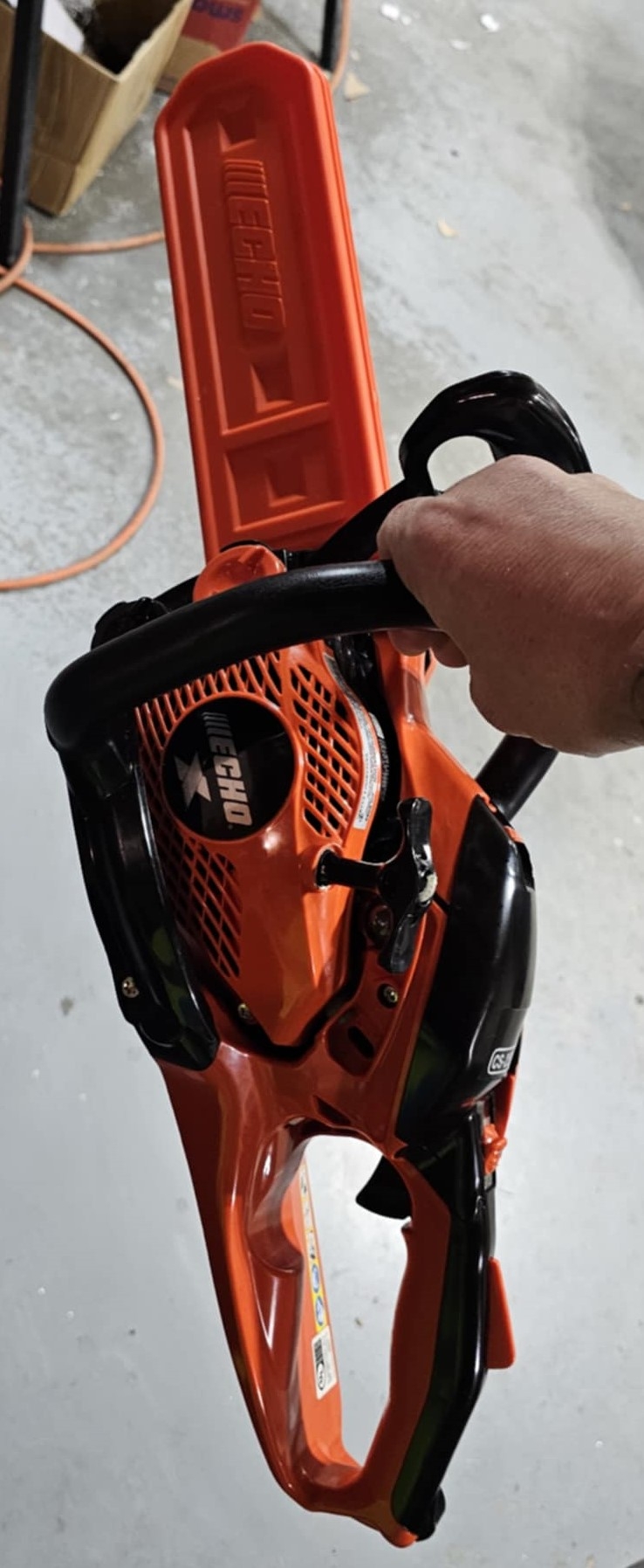

Echo 4910 PHO weight dry and like new clean.
The both tanks filled up PHO
Then both tanks filled up and 16" oregon versacut 325 050 C33 chain.

4910
Tune was so off from factory again. Idle 4400, lazy bogging L Side to lean. H to fat in Mid 11’s again.
So a real Turd if someone bought it to use. As is. Smh.
I’ve had 2 now I would throw if tried to use the way they came. Horrible not usable at all.
#2,018
Others with limiters still on I could tune right. This one wasnt happening the L was so off.
Pulled the plastic stop to get enough L for tuning. The muffler mod and tuned to 13.5K with H.

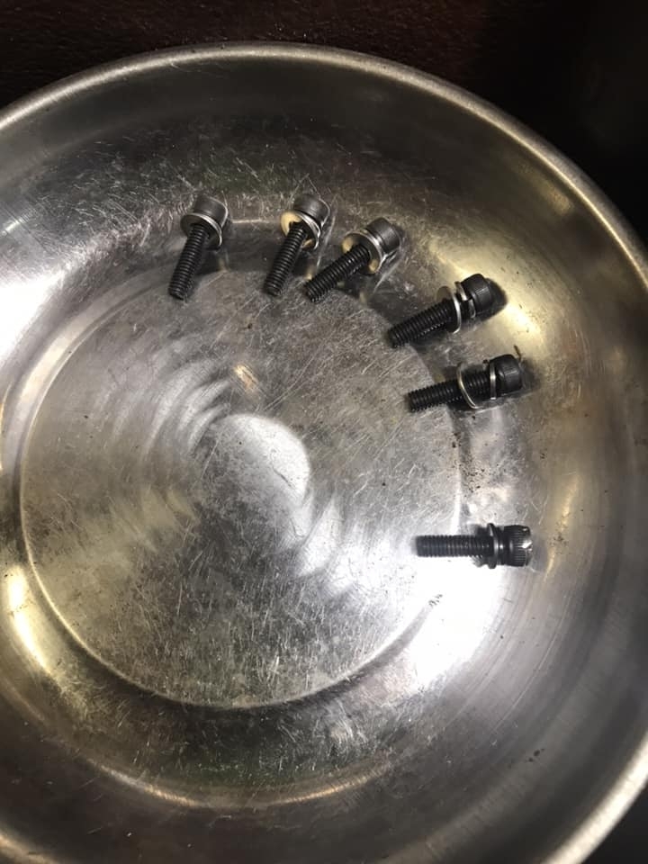

/ Just another junk chainsaw #2,019
Went and picked me 5 extra fasteners for the top av’s on these things.
They keep getting impossible to get out. 2 out of 3 now.
I've stripped hex 2 out of 3 now. 🤦‍♂️
Try putting a dab of lapping compound on the tip of your hex driver. Works for Phillips head screws too.
Patrick
#2,020
Patrick
Worth a try but dont know if it will stop the tiny hex fastener from giving out.
4mm
