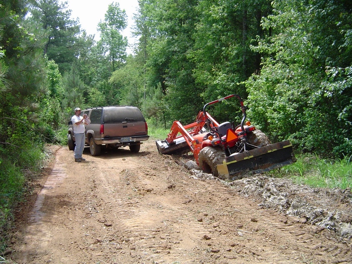

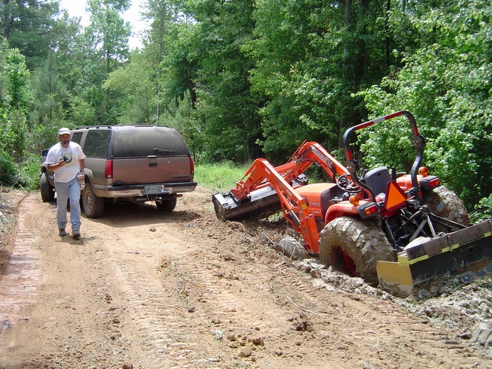

On Memorial Day, I was working on building up a road bed and adding a crown, but got too close to the mucky edge with deep ruts, and she slid in. This time, I could not walk the tractor out by curling the bucket. It was in too deep, and the box blade was dragging. So...we had to walk back (about a mile?), and get the Surburban. Moral of the story...don't park too far away from your project and it's easier than you think to get stuck.

Oh for a set of R-1's Ha Ha

I believe your road bed needs some rock. Crowning mud and dirt merely double the numbers of directions the mud will slide.

Ohhh Lordy Hugh...I don't think R1's would have worked much either...I suspect it would have just dug itself deeper since it was so soft already, R1's are narrower...and the lugs would have filled up no matter what kind of tire you had on. Those ruts were probably near 3 1/2 to 4 feet in places where people had wallowed and used a winch to pull out. I had used the loader to fill most of the other wallows in the road and added more height in the middle for rain to run off.
I think if you just fill in a wallow it will reform in a roadbed unless you have some place for the water to drain to. That is why a crown and the ditch are so important in a road.
I used the box blade to pull material up from the sides of the road to the middle. Then tilted the BB and made passes down the road create slope.
I am in a learning curve here, is that the way you all do it? With a BB and loader how do you all create the ditch part?

I'll bet you could have gotten out if you dropped the boxblade and used the loader to pull yourself out. You might have even made it out with boxblade attached.

Hi AndyMA...and the gang...I probably could have gotten out if I had unhooked the boxblade. It was hanging up in the goo and helping to hold the tractor back. But...it was easier to just go and get the surburban instead...unhooking the BB, dragging it out and getting muddy hooking it up again seemed like more hassle than it was worth. If I were alone, I may have done that, though.
I plan to finish filling in that wallow later this week.

Use the curl and open the jaws of the 4 in 1 which will give you another 10-12" which may get you out. In real suppy mud you may need to push the jaws against a 3-4" vertical log.
