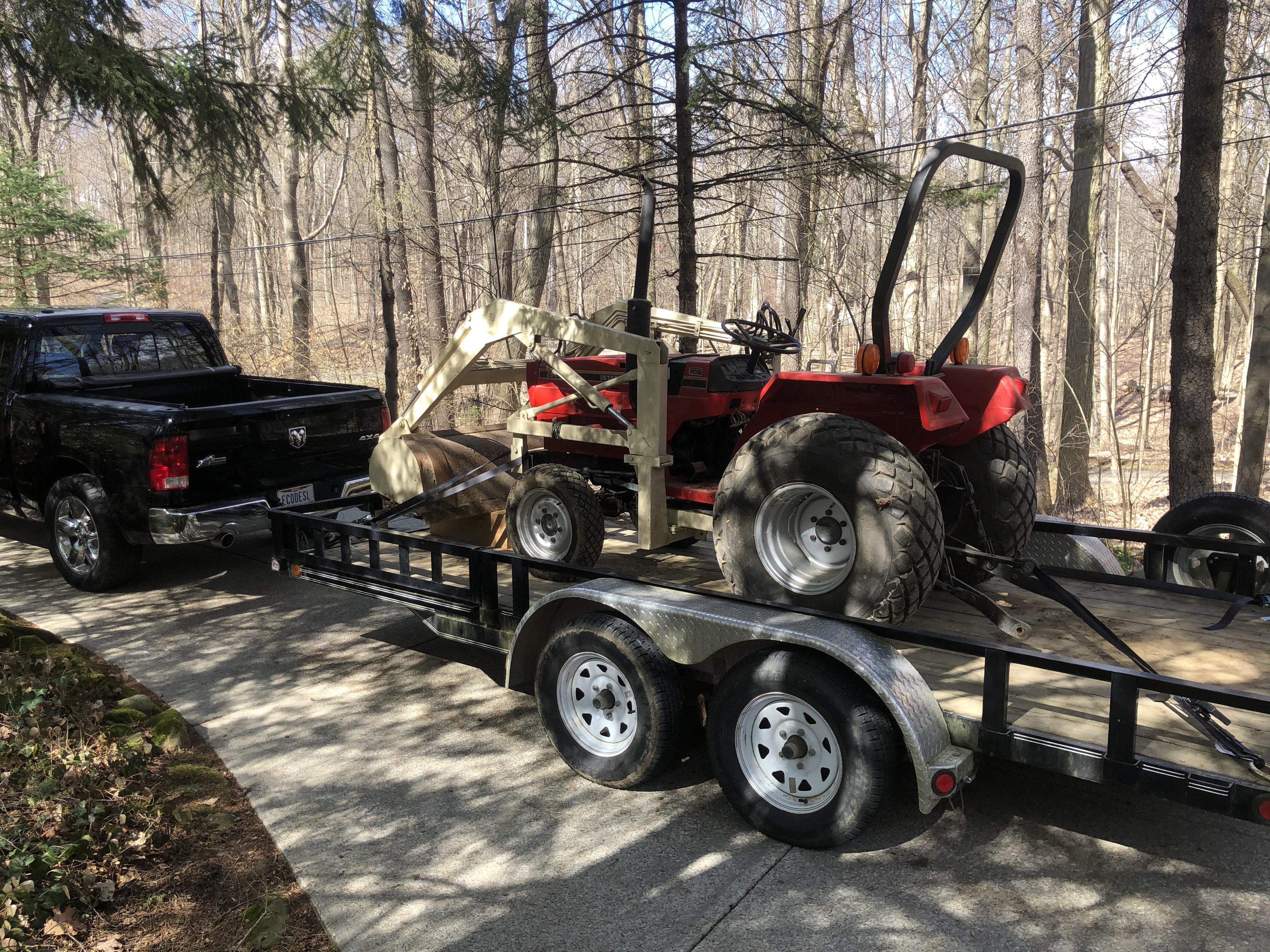

My wife's sister acquired an International 254 with her home purchase 5 years ago. It has sat in the barn since then, untouched. Wishful thinking was that it would fire right up. No luck. And with no light or power down there, getting it running in place was not going to happen, especially with my limited skill set. So I wiggled it out of the barn (thank goodness for it being gravel floor), dragged it up the hill with my truck, and loaded it up for the 140 mile trek home.

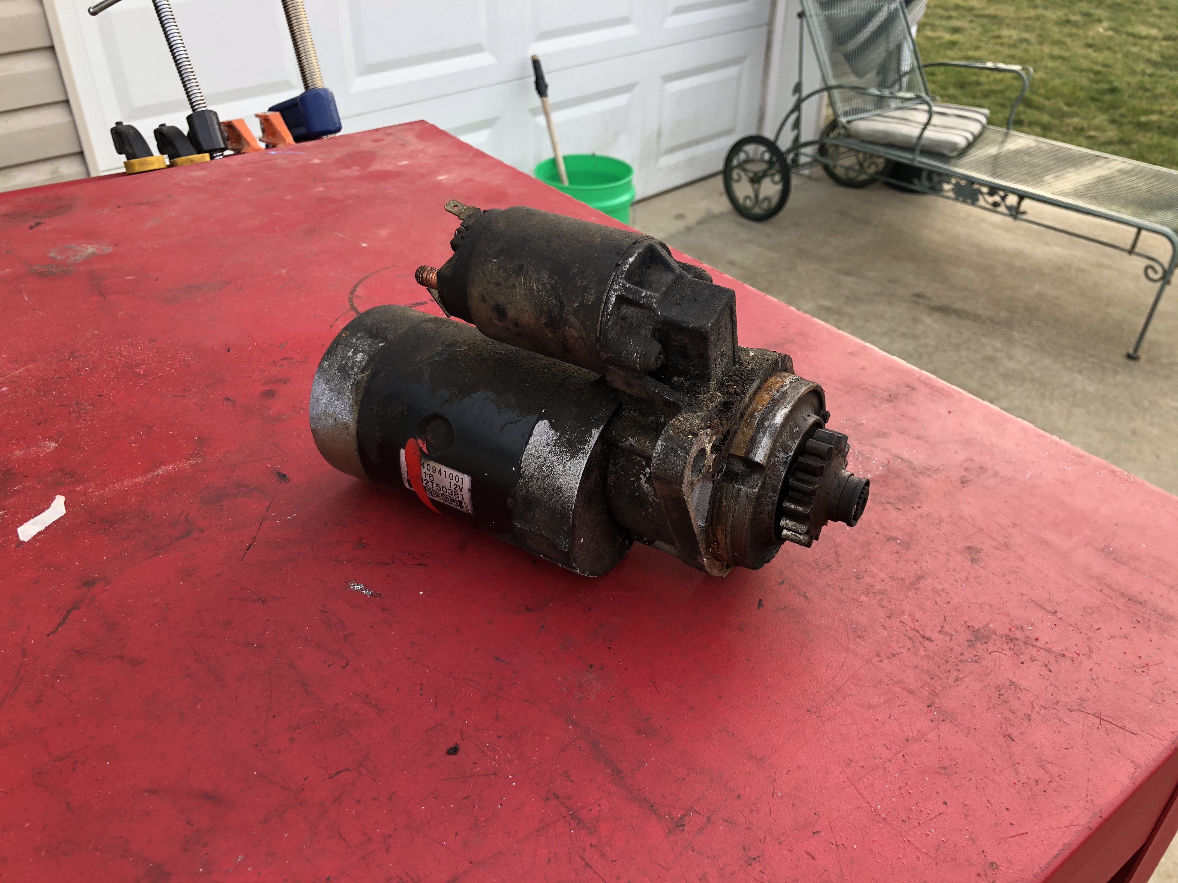

After I got it home, I tested both the battery and starter. Each came out looking good. But there is still an electrical problem as I can't get any power to the key. Cannot seem to track it down.
At this point I am doing no good, so I took the tractor to an ol timer down the road. His business is tractors, and he has been in it for 50 years. I told him I had the starter out and it's good, along with the battery, and all I needed was power to the key to see if it fires up. Didn't take him long to figure out the electrical problem, but the engine won't turnover. I heard the dreaded words, "engine is seized up." Dam, what luck.

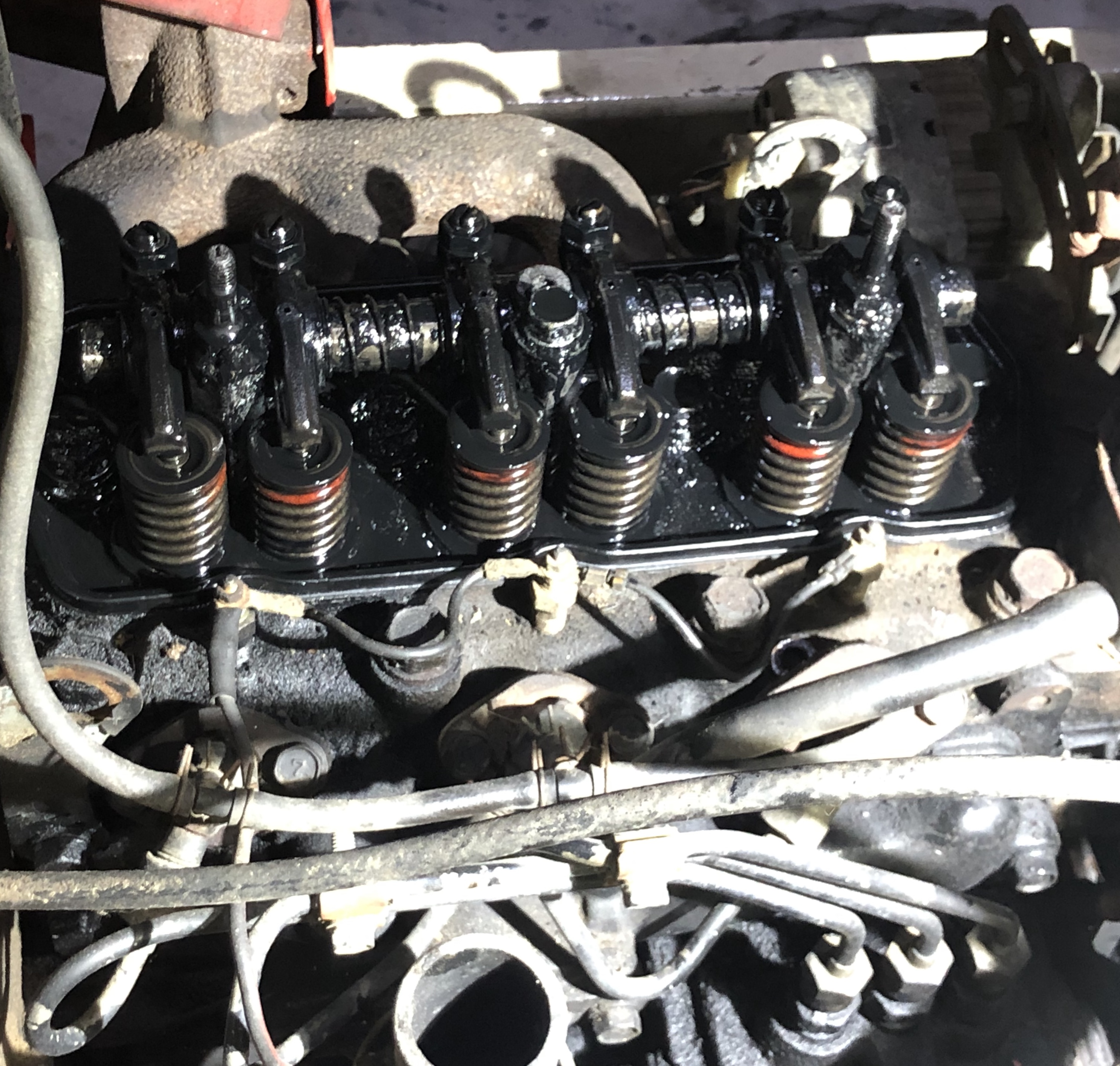

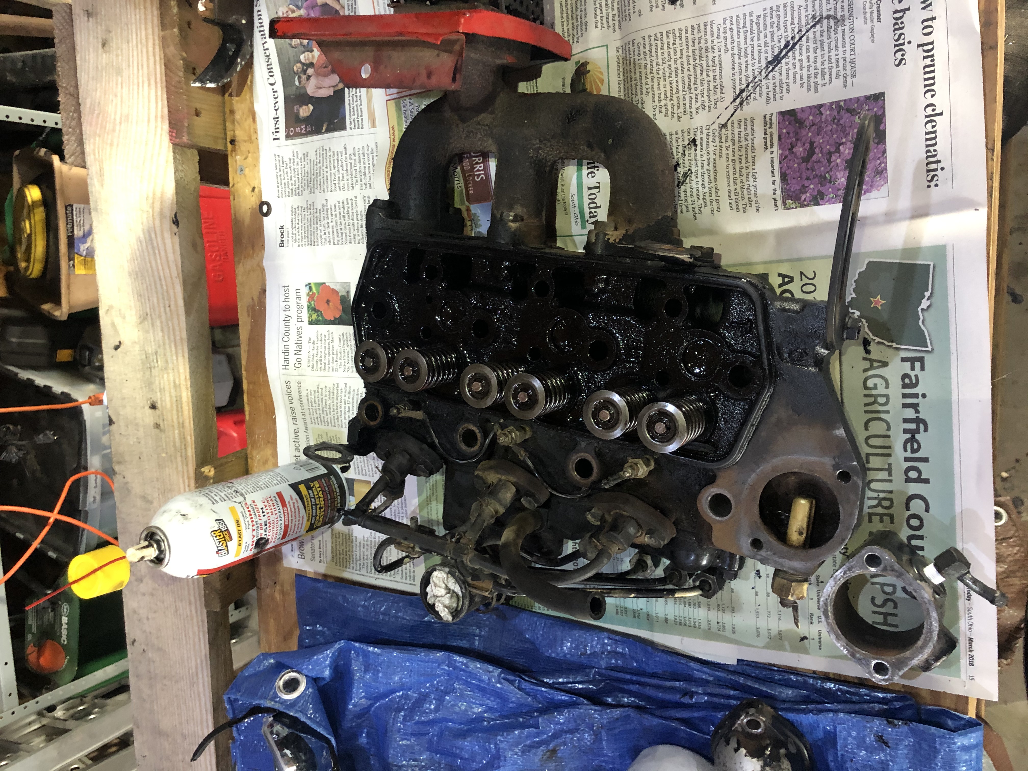

Now the valvetrain needed to come out to get to the head bolts.

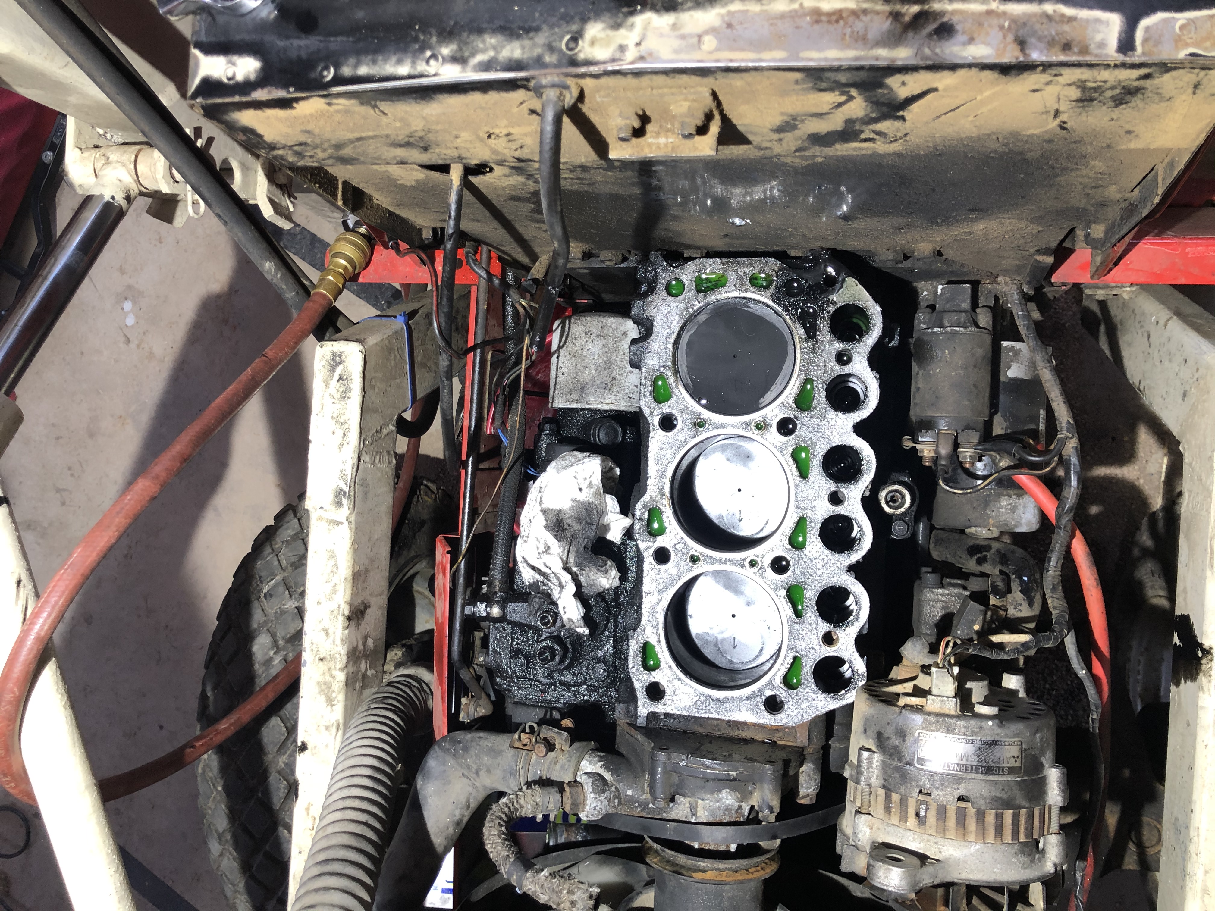

There are 11 headbolts, and once out, I am looking at this:
Piston 3 (?) looks deceiving. That is nearest exhaust so a bit more carbon built up and I had rubbed my finger around the edges so that explains the marks. It is also close to TDC so it presents itself in a different light. In person, I see no reason any of these pistons are stuck. Everything looks good to my untrained eye. The underside of the head looks good too- gasket in good shape, carbon is pretty evenly distributed, I see no gouges, cracks, burnt looking spots...

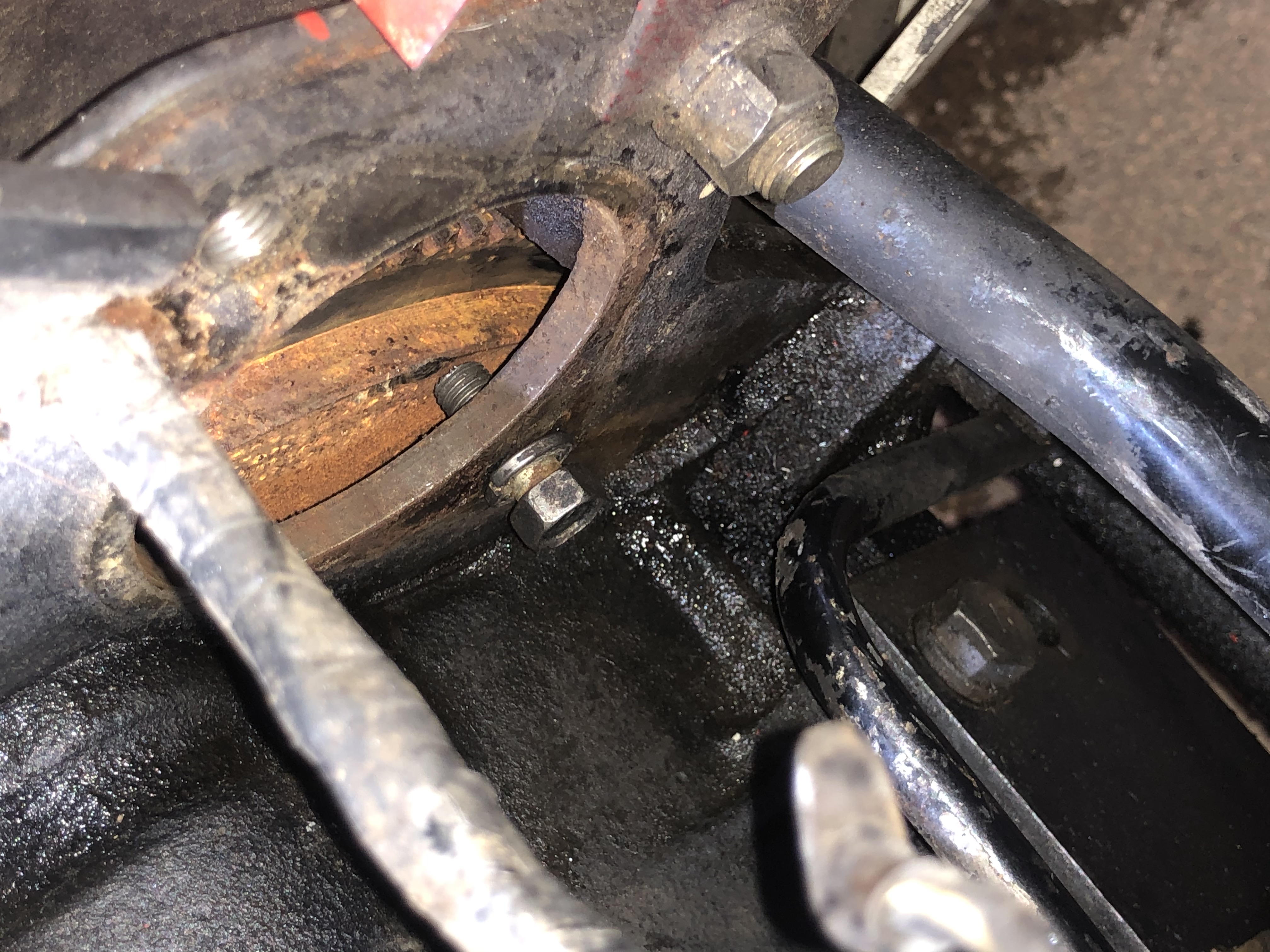

So now my thought moves to the crankshaft and underbelly of this beast. But first let me soak the pistons in a little bit of penetrating oil and some 30W overnight. The next morning, I try and rock the crankshaft one more time and nothing happens. I figure might as well remove the starter and put a pry bar on the flywheel to double check. Low and behold, the flywheel moves easily. What the crap?!?!?!
Unbeknownst to me, the two bolts that hold the starter in place are different lengths. The bottom bolt is supposed to be the shorter one as the longer one will bottom out, ON THE FLYWHEEL. This picture shows the correct bolt in place but if you look at the flywheel, you'll see the mark the longer bolt made. This has to be the reason the engine did not turnover.
I take full responsibility for this as I am the one that removed the starter early in the game. Only thing I can do now is accept my blunder and put things back together. If I ever come across a 'seized' engine again, you can be sure I check the crankshaft AND flywheel.

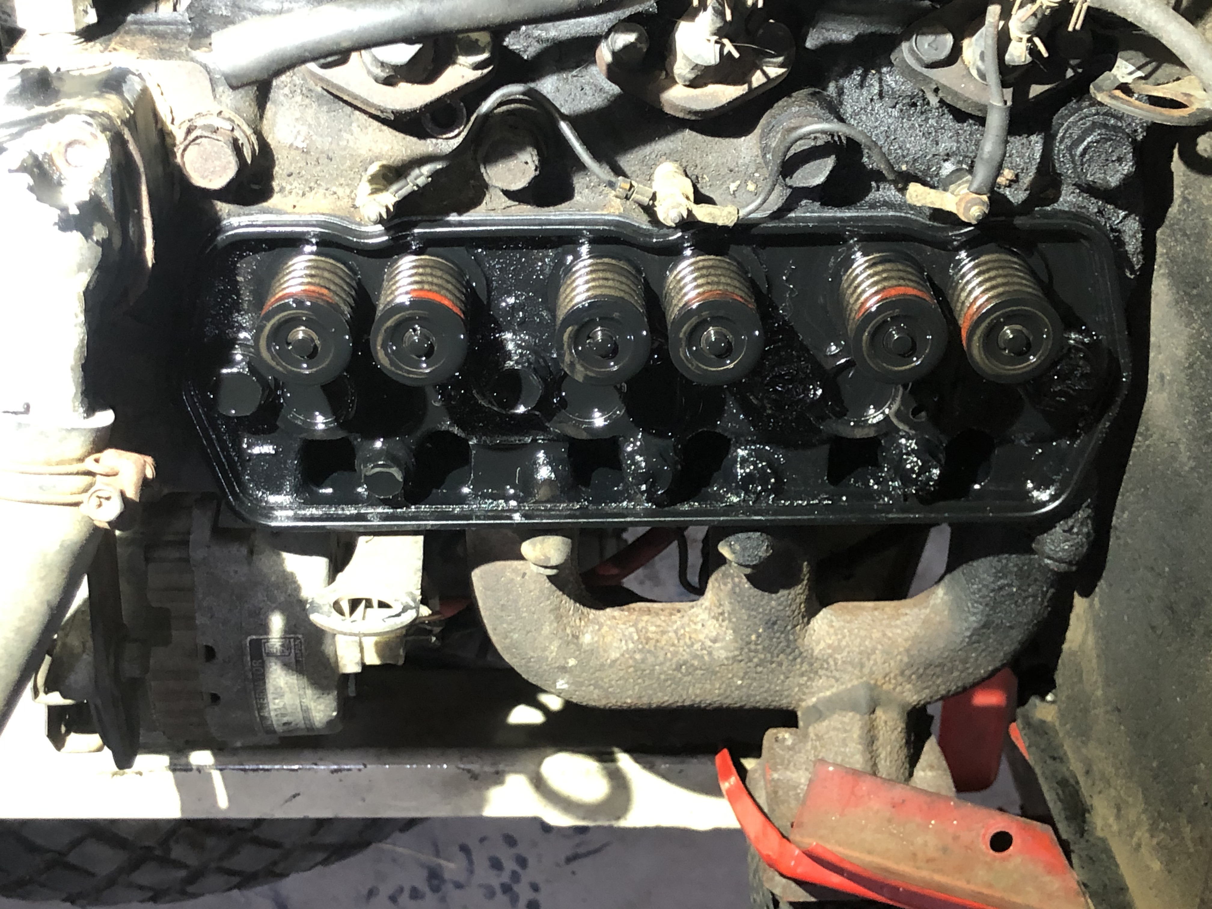

As of this morning the head is cleaned up a bit, oil is drained and new filter awaits installation, and old diesel is drained. Now just waiting on gaskets and I can get this thing up and running hopefully.

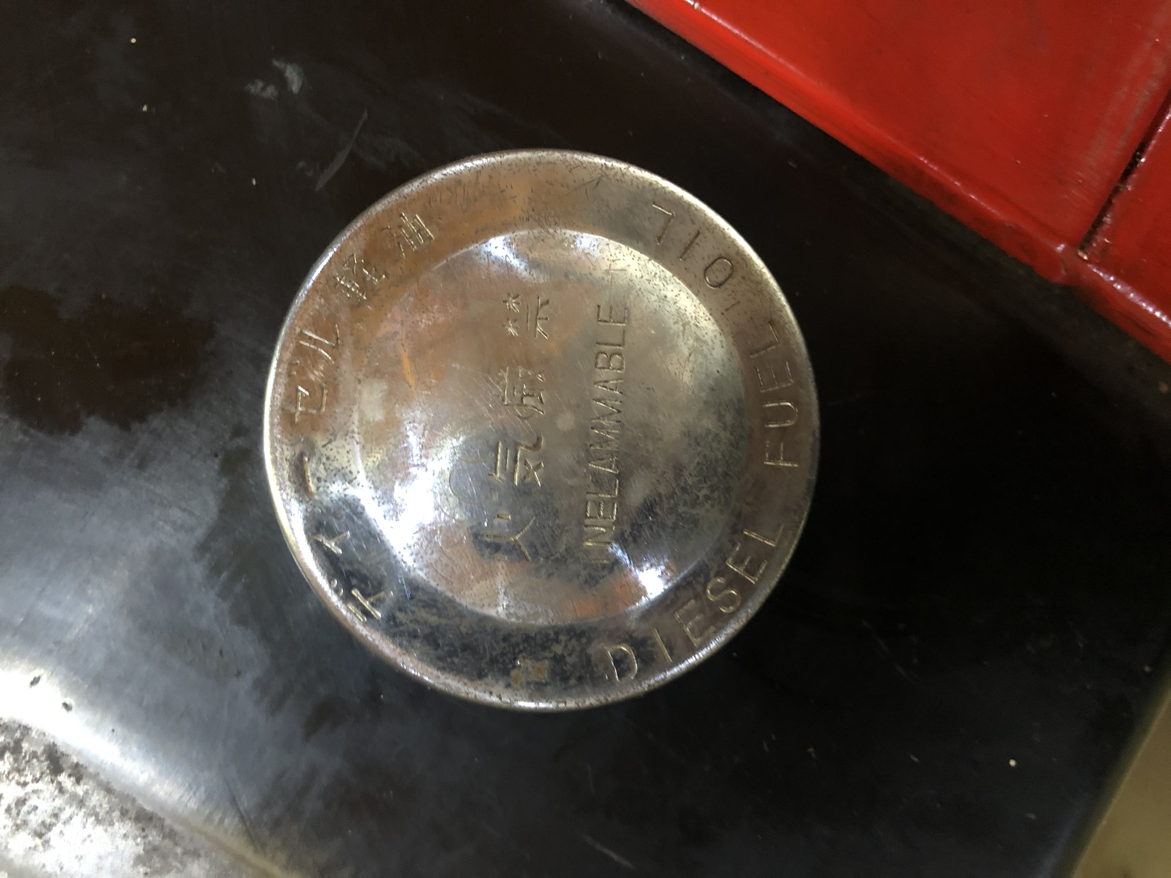

Here's a picture of the fuel cap I think is interesting and also the 2 newest additions to our herd have found a spot to relax under the bucket...

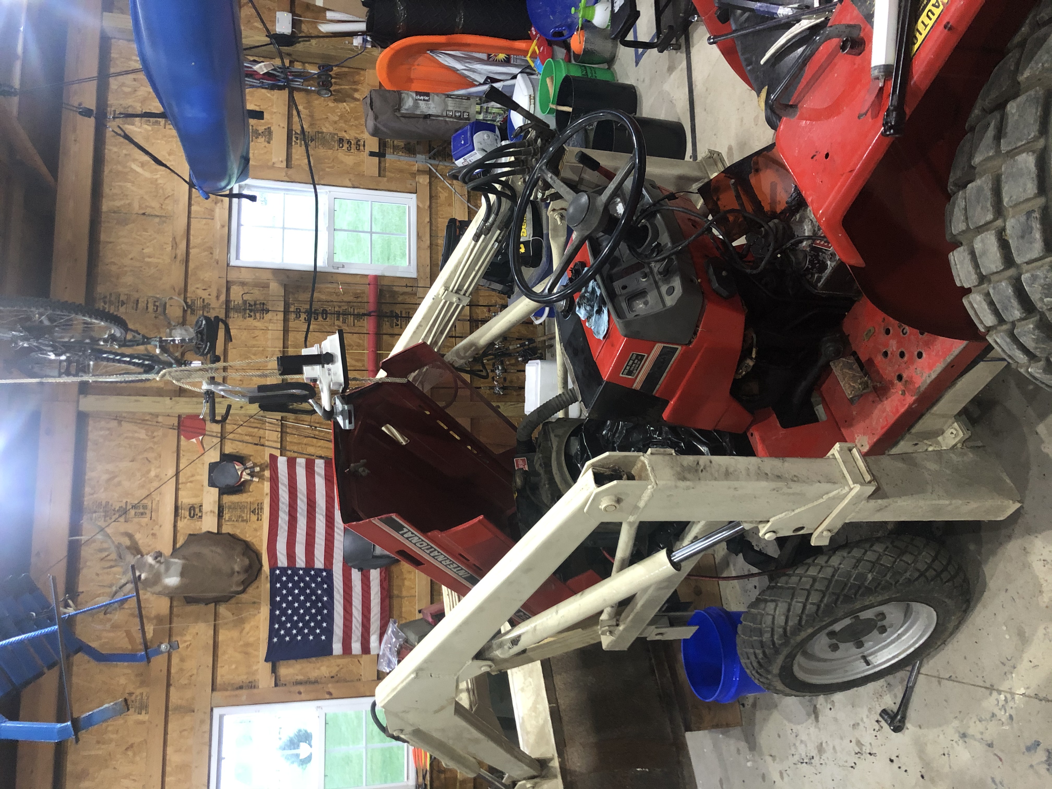

Well I got it wired up, and put back together. She runs. FEL works as should. Just need to top off hydraulic fluid, flush out radiator and a couple other small things but it痴 working.
