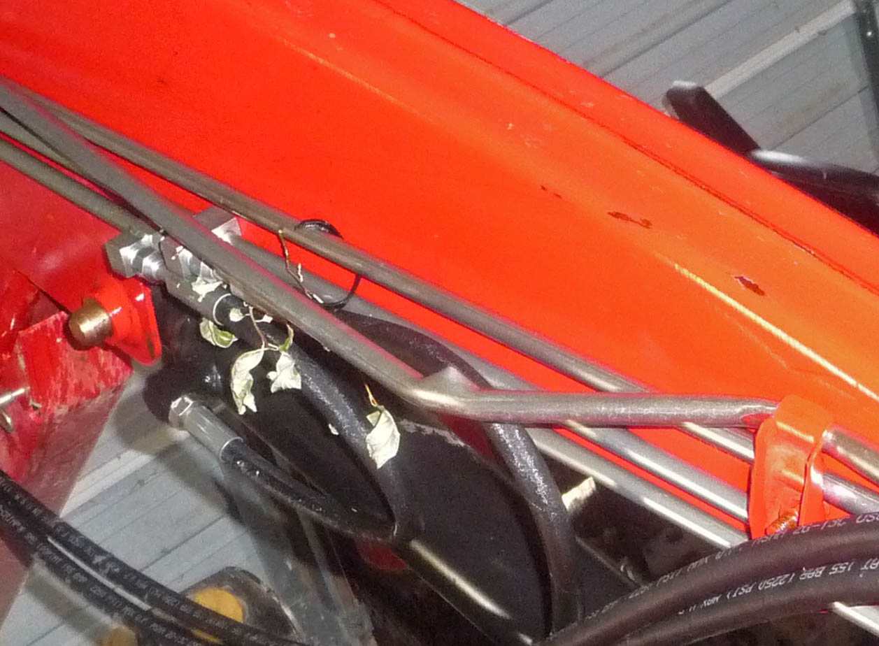

There are a variety of reasons the mfrs tell you not to do backdragging. Almost all those reasons are covering their butts as the easy answer. The truth is "just watch what you are doing and realize there are risks." Many think backdragging is just an angled downward bucket smoothing out rough soil while in reverse. To others it means pointing the bucket tip back toward the tractor and using it to dig while in reverse. If you do that in hard clay and have plenty of tractor power and plenty of traction ... see attached photo ... yes, you can wreak some havoc. This steel line you see kinked away from the loader arm used to be straight. Here it has exploded. I was leveling a building lot in hard clay and back cutting with the bucket which was the WRONG tool. Laziness -- failing to go put on the scraper box. Since it was just a section of hydraulic line ( and the dealer had it in stock) I was very lucky for a do-it-myself fix. Lesson learned.

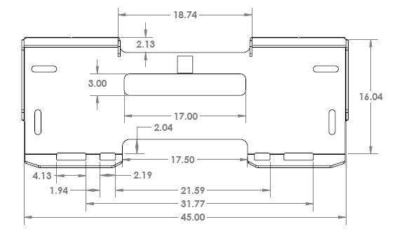

Is this what you are looking for?
Titan 5/16 Quick Attach Attachment Mount Plate Skid steer bobcat kubota 516MP | eBay
That's the part you buy, the you start adding metal, time and a lot more dollars.
Amazon.com: Skid Steer Loader Quick Attach Mount Plate to Category 1 3 Point Adapter Attachment: Patio, Lawn & Garden
On second thought. Harbor Freight
3-Point Quick Hitch for Tractors - 27-3/16" Clearance
and some cut plate to add extra roll back angle should not be to bad to Fab up.
Thanks

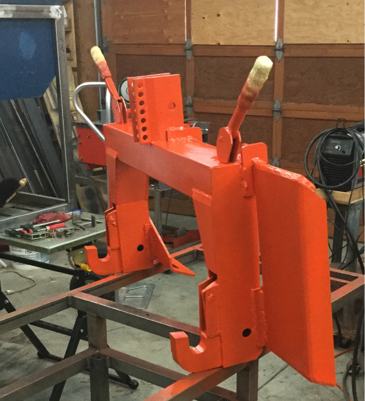

Several TBN folk have welded a Titan plate to the back of a HF quick hitch.
And later, some of them said that they should have put more rollback into it.
