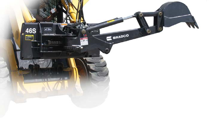

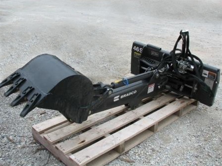

A lot of these were sold for skidsteers, tho I do not think most got used a lot. Most required
that you get off the SS seat and move to the hoe seat. Not easy in-and-out of a SS.
I have seen the ones you can operate from your SS seat (Caterpillar), and they are much
better.
There are 2 types I've seen. A full SSQA mounted hoe & SSQA mounted dipper & bucket. Dipper & bucket setup can be run from the seat, not sure if it has any side to side pivot. I'd almost think about trying one if I could get it for the right price, but I suspect the curl cylinders on the loader wouldn't be up to the task. I blew a fork off my pallet forks luckily when doing back dragging with a bucket spade before I knew better. Luckily it was only some hammering & grinding to fix the fork frame & not a bent curl cylinder.

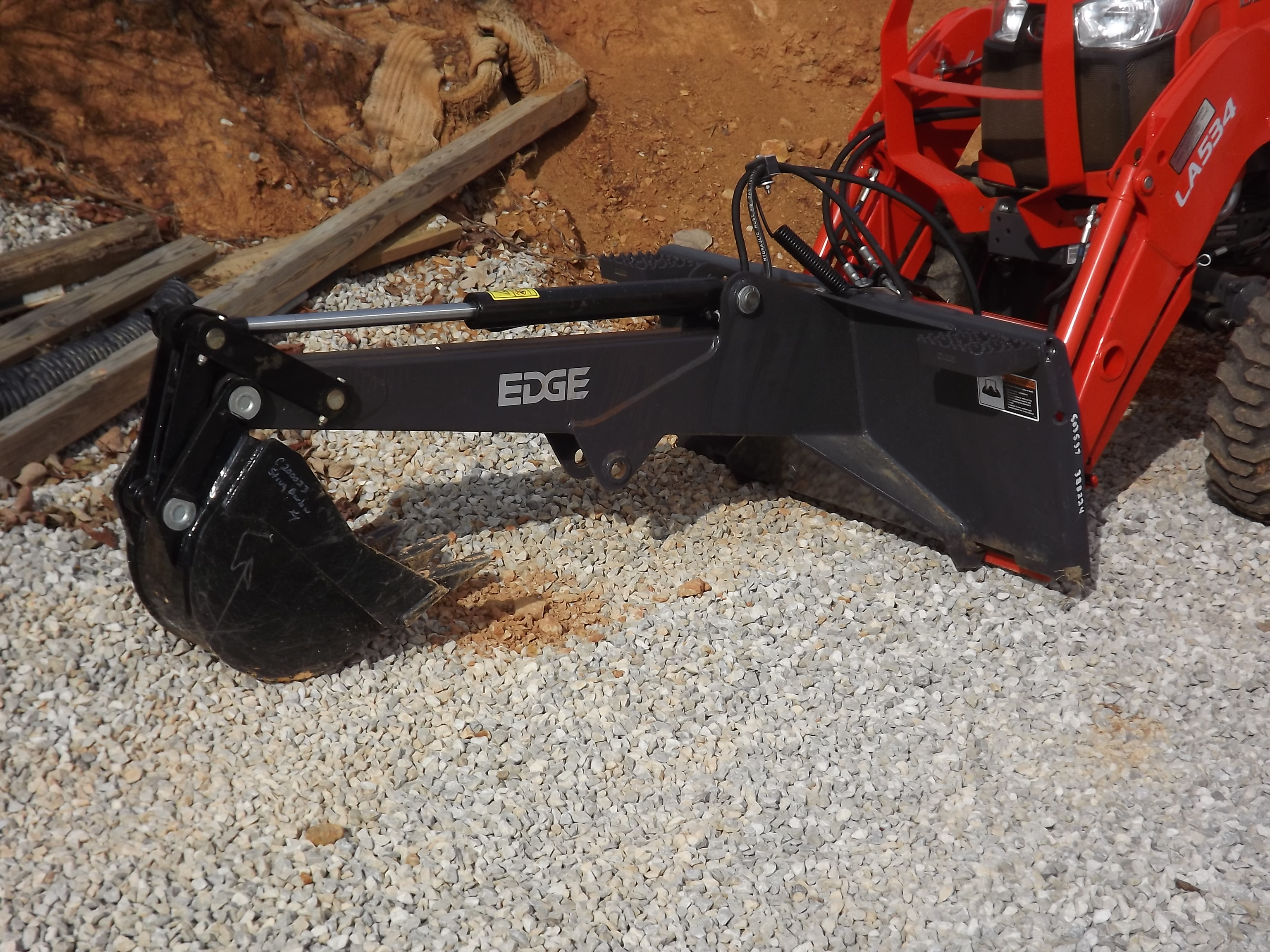

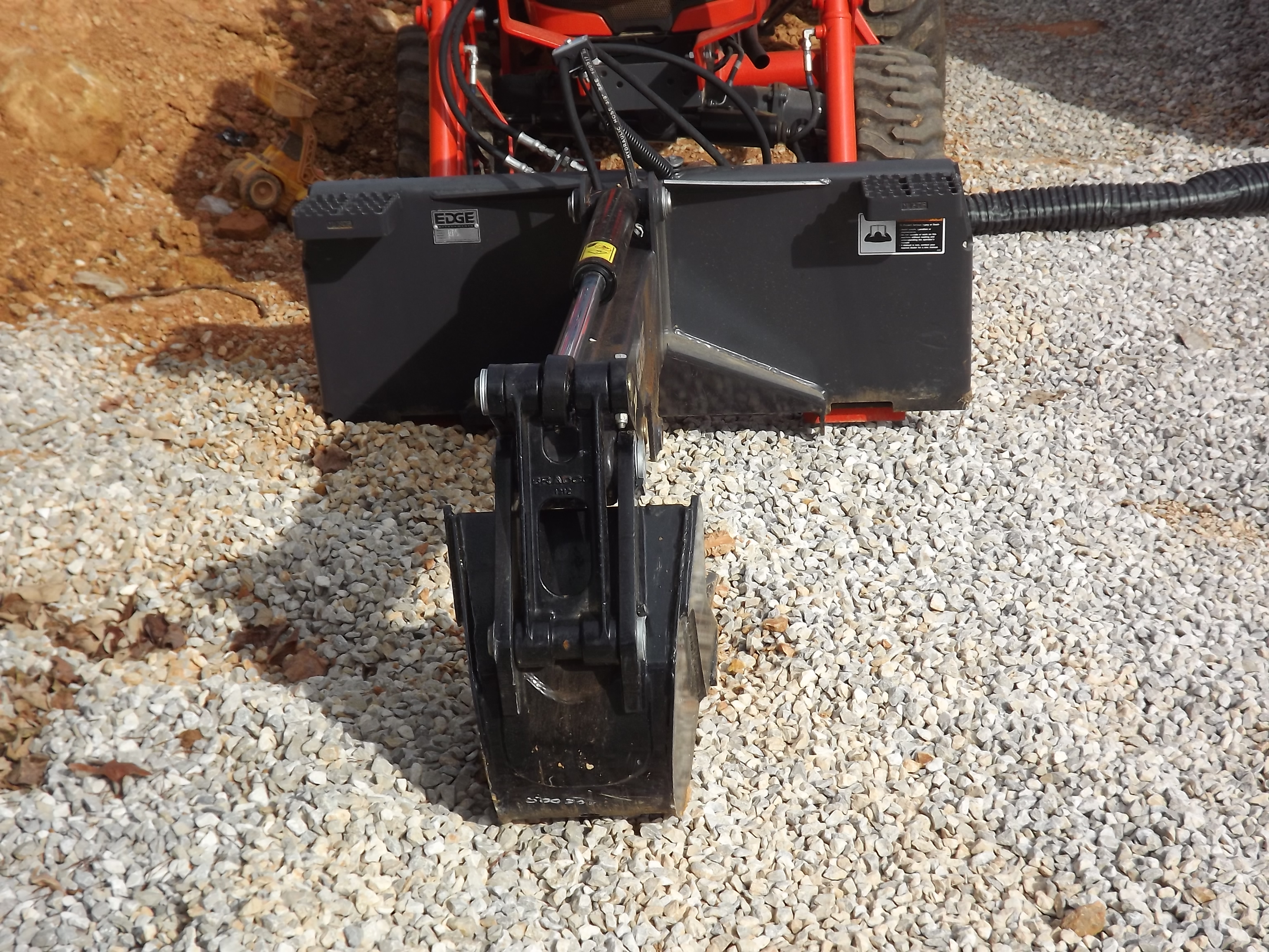

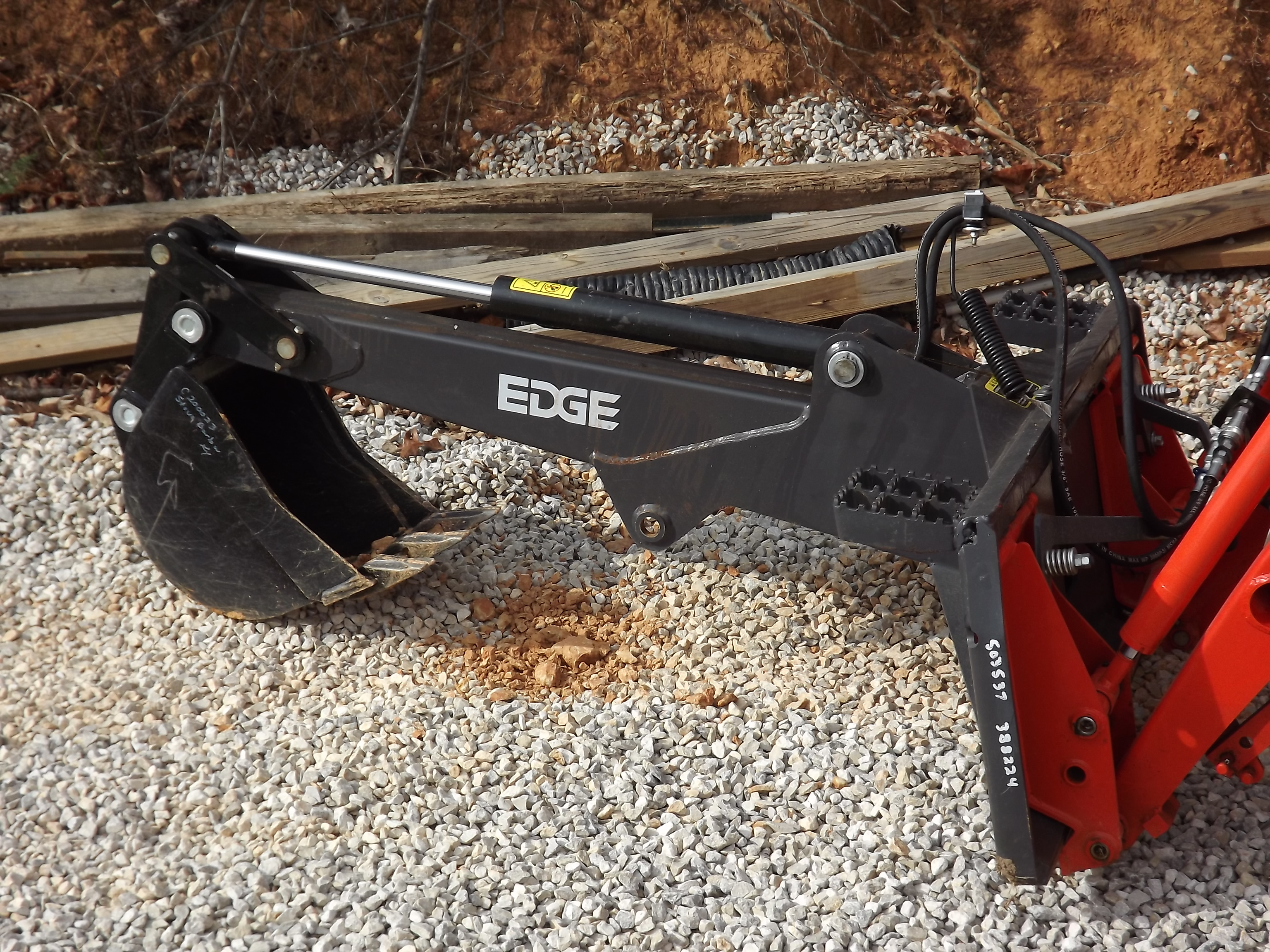

Looks like info from people that have never used sonething only dreamed about them or researched thme online. I do a lot of that myself but I also buy a lot of "stuff" and try it and post my actual experience with the "item". I bought the front "hoe" for my SS after watching one being used on a SS video. I sold my SS and replaced it with a Kubota B2650, my 20th or so Kubota. I had hydraulics installed on the tractor so I could use the "hoe". Yes, there are two types, one pivots for much more dollars and mine did not pivot for much less dollars. I actually used the non pivot one on my B2650 and dug some holes and a 150' ditch. The non pivot aspect wasn't much of an issue since one digs, slight movement, dump, slight movement back and dig more and repeat. Easier than it sounds but really not an issue with SS or tractor. I'll post pics if TBN is now taking pictures.
I did sell the "hoe" the day after I decided to keep it but man showed up with 15 one hundred bills. Another man I know had came by to visit me, saw the "hoe" and called me later wanting it but told him he was to late. He has owned track hoes, tractors, SSs and other construction equipment.
The thing appeared to be indestructible piece of heavy steel with a solid heavy duty piston for bucket digging. Doubt any one could tear it up or break it on any reasonable size machine.
   / Back Dragging with a FEL Bucket #33
Couple of comments: The rig pictured above is a great tool if you can live with straight line work and do not need to pivot sideways to dump or dig. I'd say it is a beneficial tool only if there is no need to dump to the side (I'd think everyone really wants to dump to the side??) and if it is a supplemental occasional use tool. Most smaller Kubotas do not have the hydraulic remotes to drive this and adding them is expensive. If it gets used a lot I'd do something different. Second comment: No tractor manufacturer has (or is willing to divulge) torque data on what their front end loaders will stand in the "twist" mode. A really useful FEL mounted tool is going to involve twist on the FEL and 10X more if it dumps to the side. Even large tractor FELs can fairly easily get bent or distorted if you apply a lot of twist to them. Many SSLA interface mfrs caution AGAINST using them on tractor FELs.

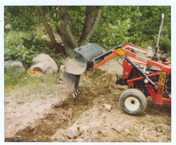

Here's a front bucket mod that is even more primitive. It's one I put together somewhat more than 30 years ago. The crazy thing about it is that it not only worked, it did useful work for at least a decade. I think you can see that the FEL is lightly built by anyone's standards. Nonetheless, this rig worked in rocky ground and sure beat working with a shovel. It did useful trenching work without damage to the tractor.
rScotty
   / Back Dragging with a FEL Bucket #35
rScotty -- now that deserves an award of some kind. Not universal. Not fancy. Won't do many things. But what it DOES do is save some back-breaking labor with very, very little cost. What I like is the attitude of "making do with what we have." I can remember growing up when we converted from horses to a Massey Harris Pacer. Anything that you could kludge together and make it work was good. Anything else was way too expensive and not going to happen.

This is the other style that John mentioned in post #32, the swing arm backhoe attachment, it costs more, but it pivots:
   / Back Dragging with a FEL Bucket #38
An option for occasional use with a skid steer, as a skid steer easily skid steers to the side to dump, plus the loader on a skid steer can take the twisting and loading better than a tractor's FEL
