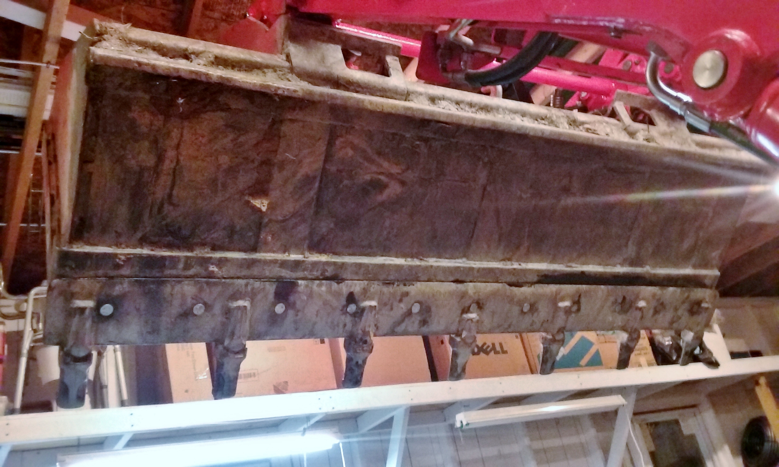

Re: Back Dragging with a FEL Bucket, I change my Plow bots on Cutting edge,
The old plow bolt heads were so worn out one pulled through.
The Local dealer sold by stepson 1/4" too short grade 2 junk steel carriage bolts to replace them. They were returned, and I ordered some Grade 8 Blow bolts from Global. Plow Bolts - GlobalIndustrial.com
Note the 2 x 2 x 1/2 L angle at rear of bucket for back dragging.
I love the ESCO teeth, much better than CAT teeth.

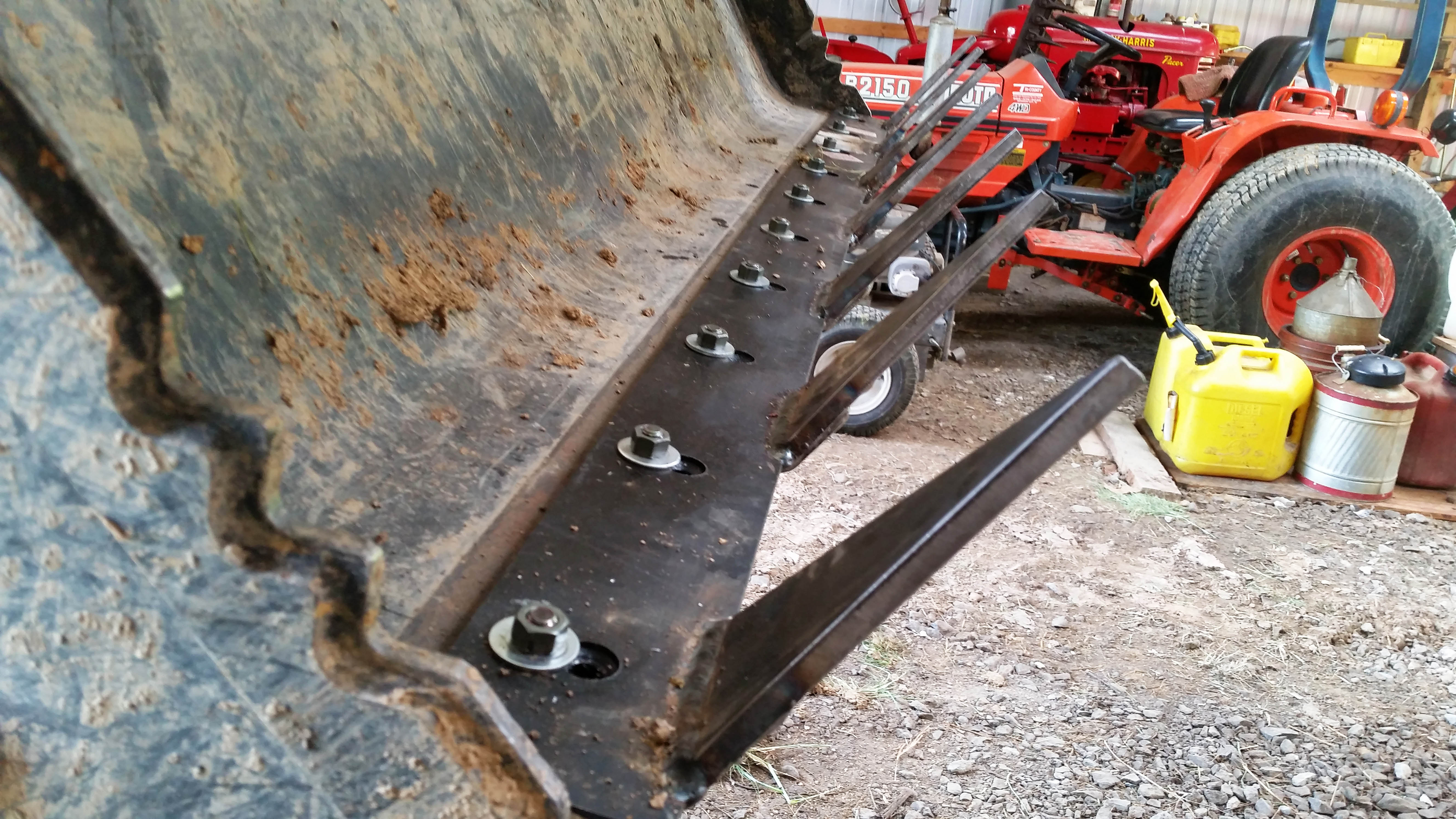

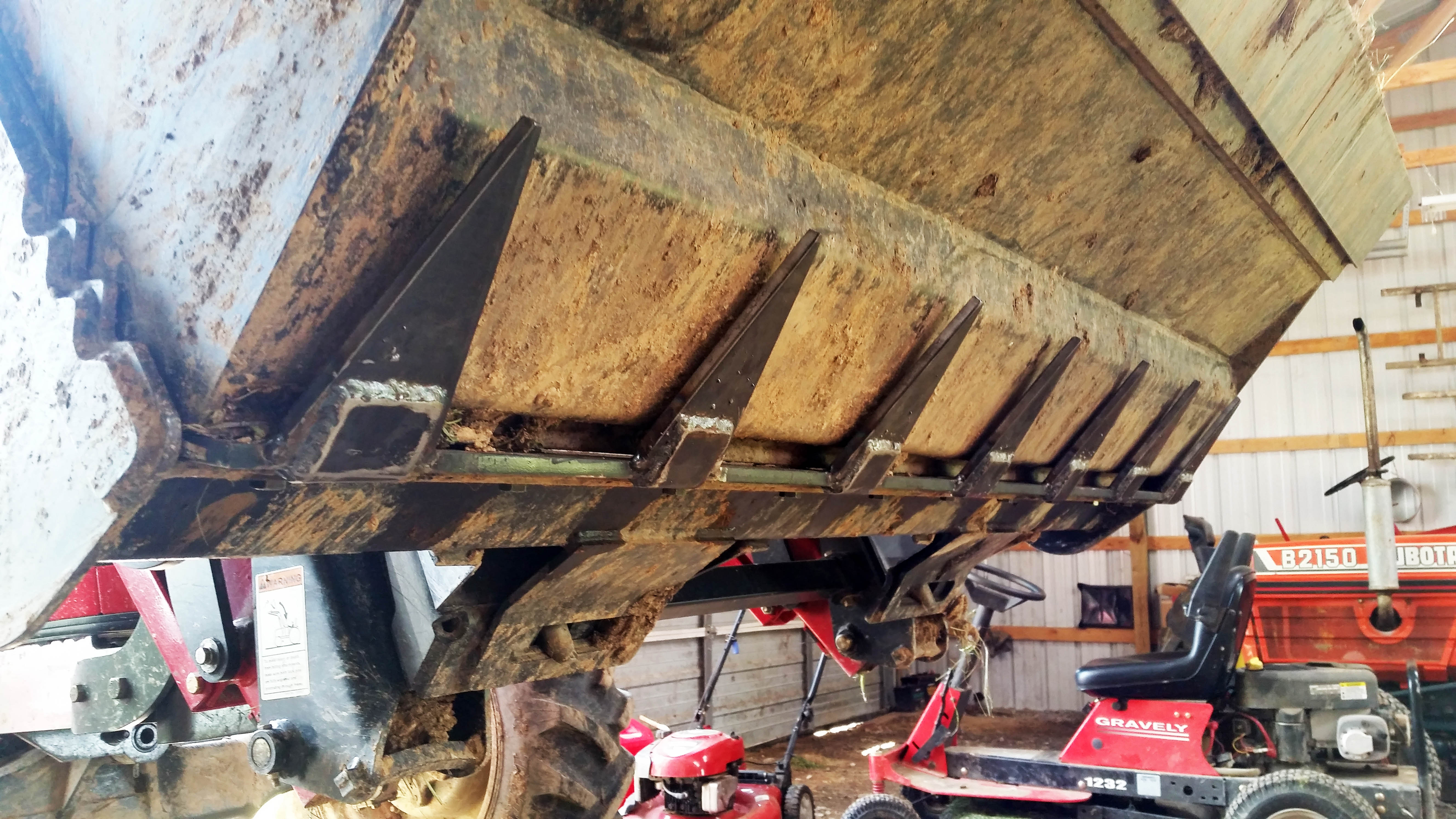

Mike 69440 -- My application is very different, kind of the inverse of the toothed bar that you show in the picture. Mine was intended for improving the "grapple bucket" nature of my 4-in-1 bucket. Keeps me from slipping losing, or dropping logs, small trees, limbs, etc. I had teeth welded on a bar that bolts onto the 4-in-1 bucket -- very, very similar to yours, your's just lacks the clamshell to comedown over top of it. All that makes me realize -- I can use my "teeth on 4-in-1 bucket" to back drag as well. Here are a couple of pictures.20160526_161407small.jpg 20160526_161445small.jpg

Mike 69440 -- My application is very different, kind of the inverse of the toothed bar that you show in the picture. Mine was intended for improving the "grapple bucket" nature of my 4-in-1 bucket. Keeps me from slipping losing, or dropping logs, small trees, limbs, etc. I had teeth welded on a bar that bolts onto the 4-in-1 bucket -- very, very similar to yours, your's just lacks the clamshell to comedown over top of it. All that makes me realize -- I can use my "teeth on 4-in-1 bucket" to back drag as well. Here are a couple of pictures.View attachment 490581 View attachment 490582
That is so cool, makes me want to sell my grapple and get a 4 in 1. You should have patented the idea. Too late now.
