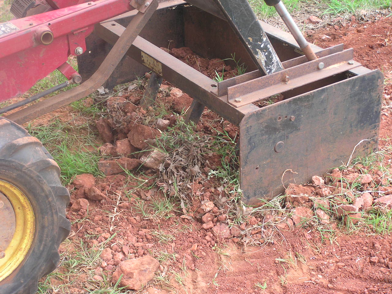

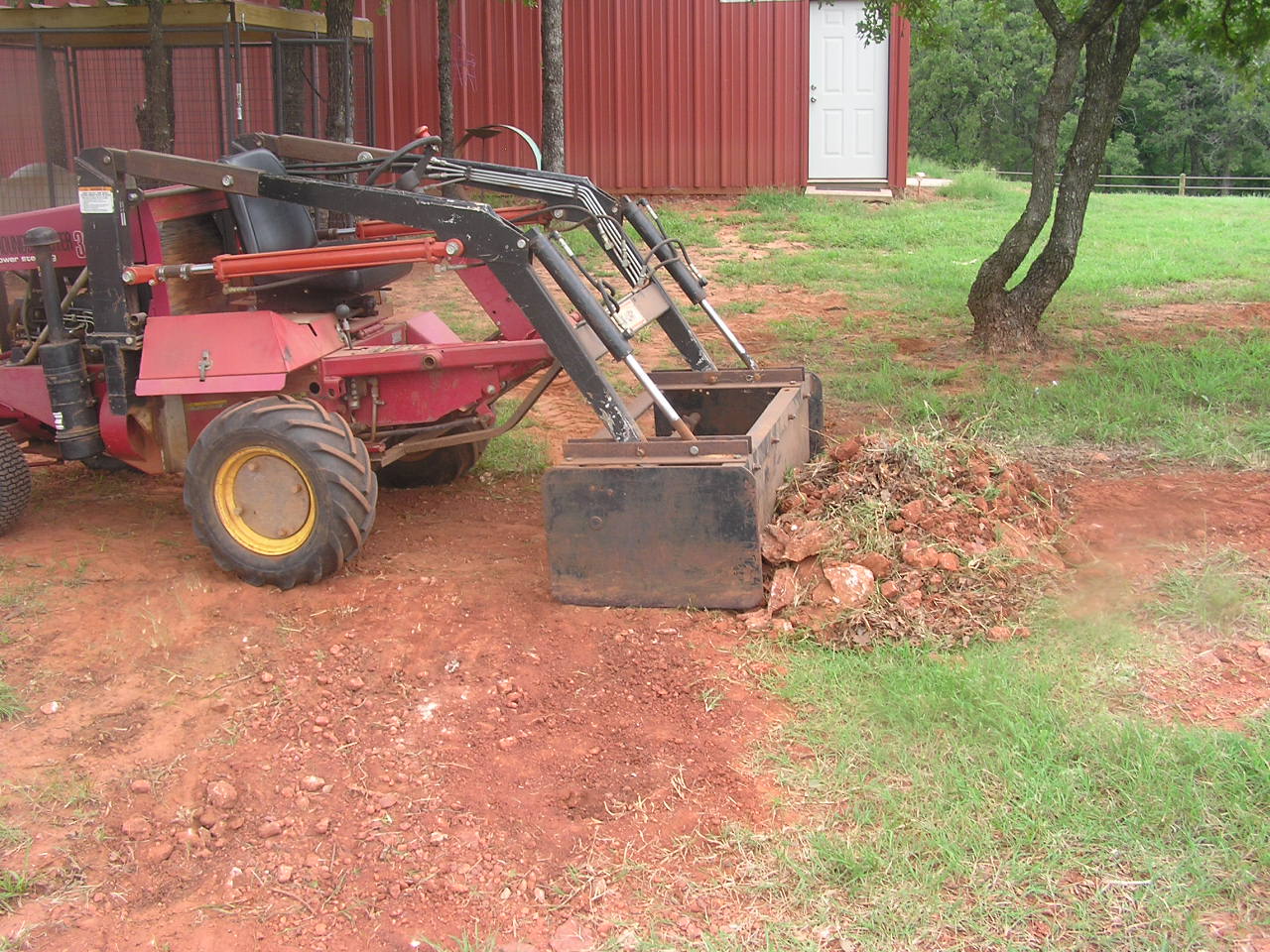

It is possible to backdrag without hurting the tractor, and it's a handy technique. Over the last 40 years we've done nearly as as much work backdragging as using the bucket going forwards. And no problems doing it so far.
Our land is mostly an old meandering stream bed, so it's actually got more rock than sand or dirt. That's no exaggeration; digging a hole always produces a larger pile of rocks than dirt. We end up stacking a lot of rocks and cherish the little bit of dirt. Rocks are mostly granite ranging from small to landscape size with something the size of a basketball or briefcase being the most common.
Anyway, we end up doing a lot of back dragging with the FEL bucket to smooth things out....it's just part of what we've always done. It's just about impossible to push a bucket forwards anyway when there are lots of rocks, so back-dragging is the main trick we have to use any time we want to get a bucket full of material.. Depending on the shape of the bucket and the angle the lip makes with the ground, back dragging can be used to bury the small stuff or to expose and loosen the "soil". Back dragging can even be used to roll the larger rocks up out of the ground. With all the back dragging we do, we've never had a problem with beating up the loader. The trick is to keep the angle of the bucket as shallow as the work will allow and go slow allowing the weight of the front of the tractor to do the work. Sometimes for final smoothing we backdrag with a loaded bucket. The shape of the back edge and bottom of the bucket makes a difference too.

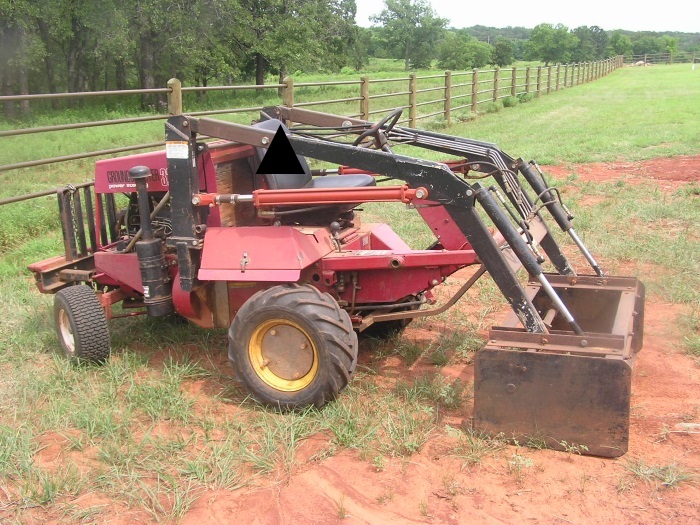

Xfaxman
I've been impressed by that red what ever it is, since I've seen your posts.
Larger tires up front and having the front axle not on a pivot lend stability.
I bet that little thing can outwork most shiny expensive tractors of similar size.

Xfaxman

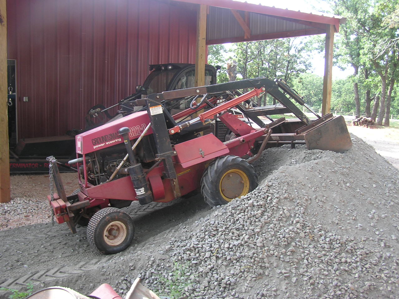

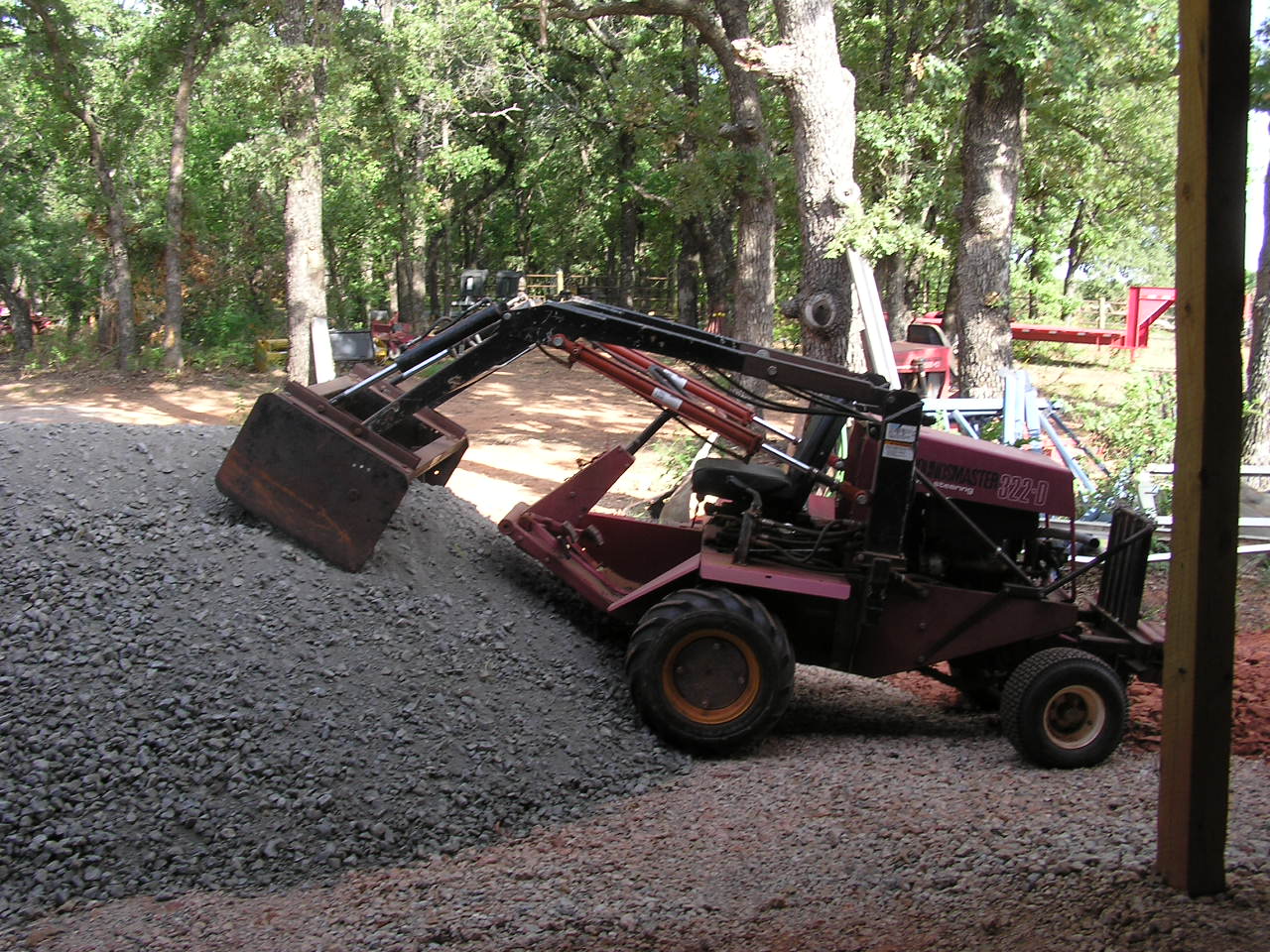

Yep, it will lift 800 pounds, click the link in my signature for the Put Together details.
I assume if you really wanted a regular tractor you could afford one, as that Toolcat in the background was not free.
I have owned more tractors than I can remember, but I sold my MF240D soon after I bought the first compact telehandler. My wife bought the Toolcat to do the brush hogging right after we moved here.

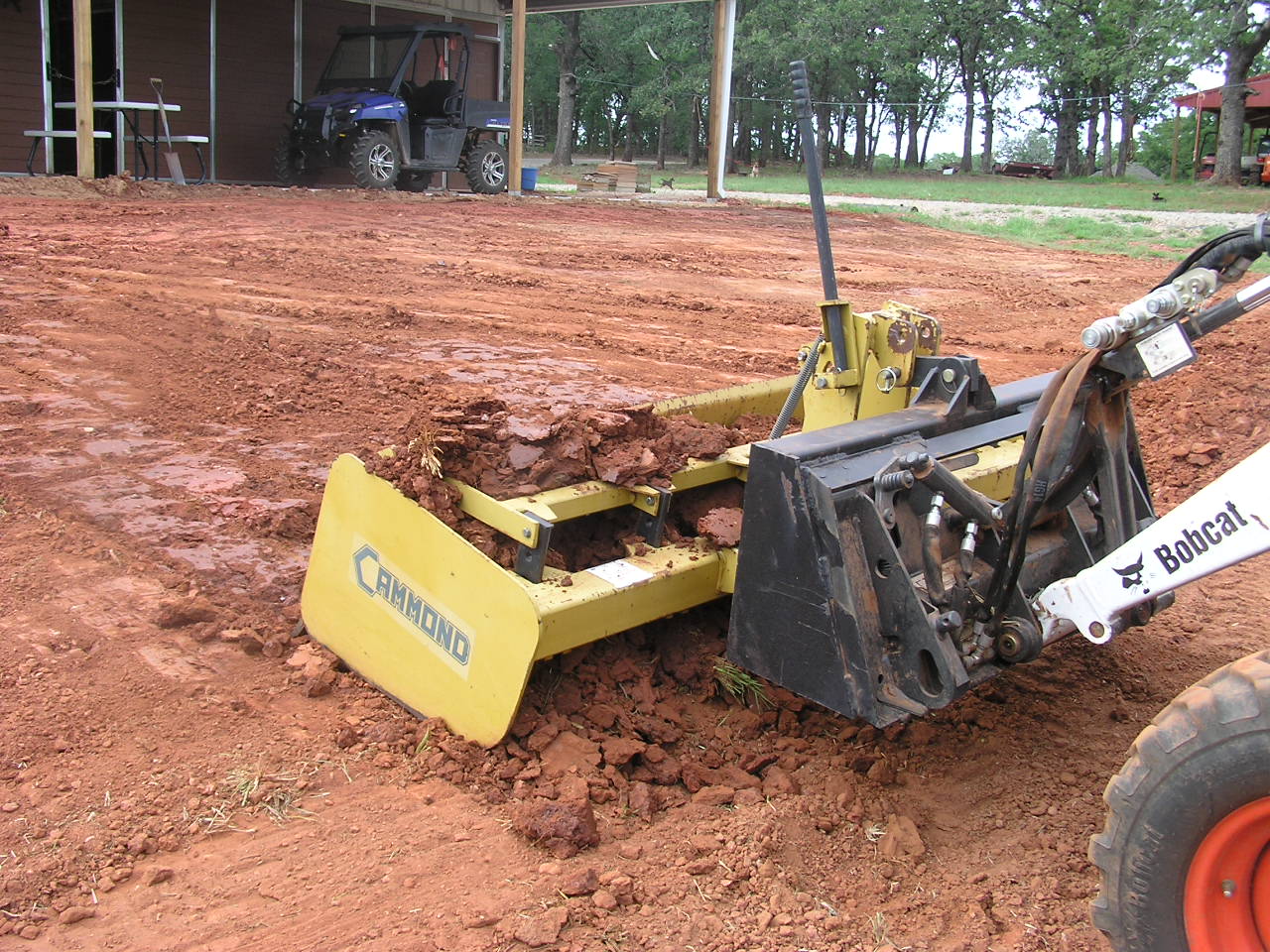

I'm surprised at how well my little ballasted Mahindra Max 28 handles the 6' Landpride box blade I originally got for my L39. A 5' ft blade would be better, but the Little Max pulls a load of stone down driveways to spread just fine.

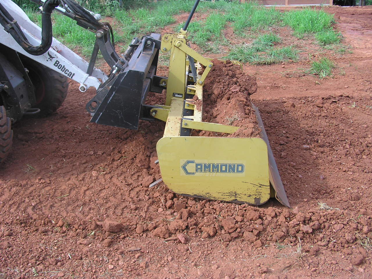

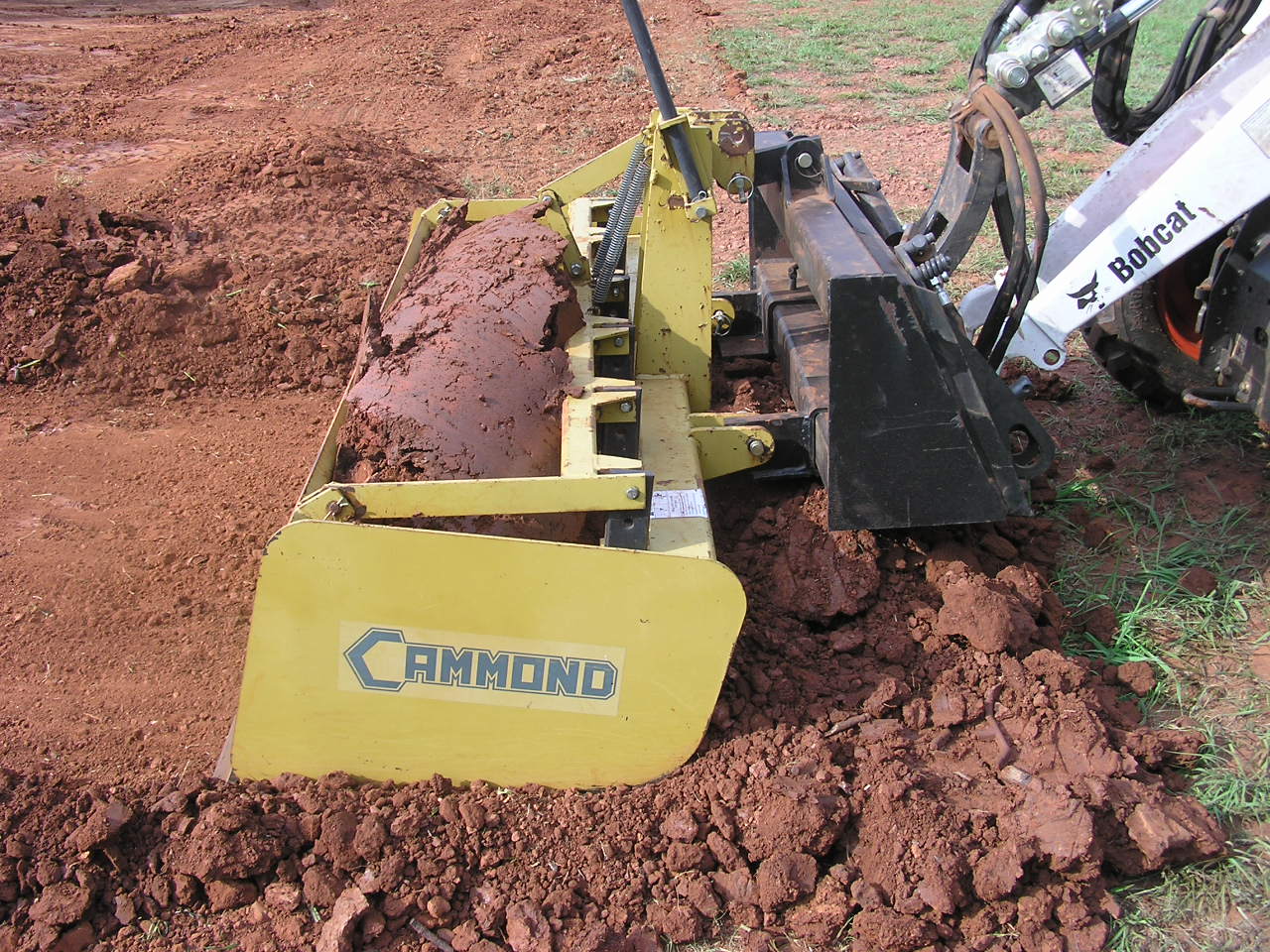

The Toolcat with a 6' box blade on a SSQA to 3 point adapter, in dry red clay:
Dozer mode :thumbsup:

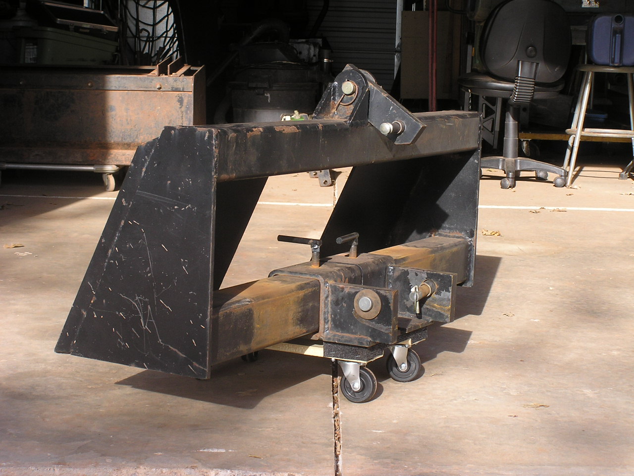

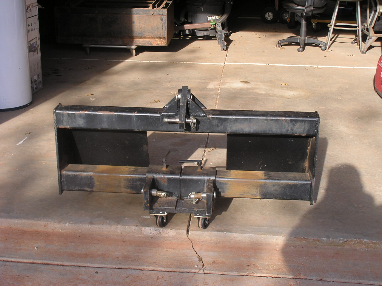

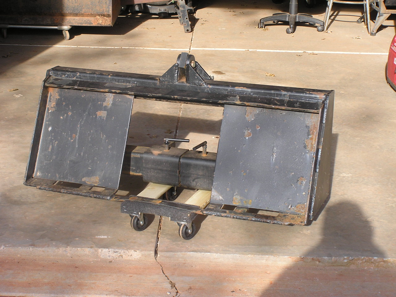

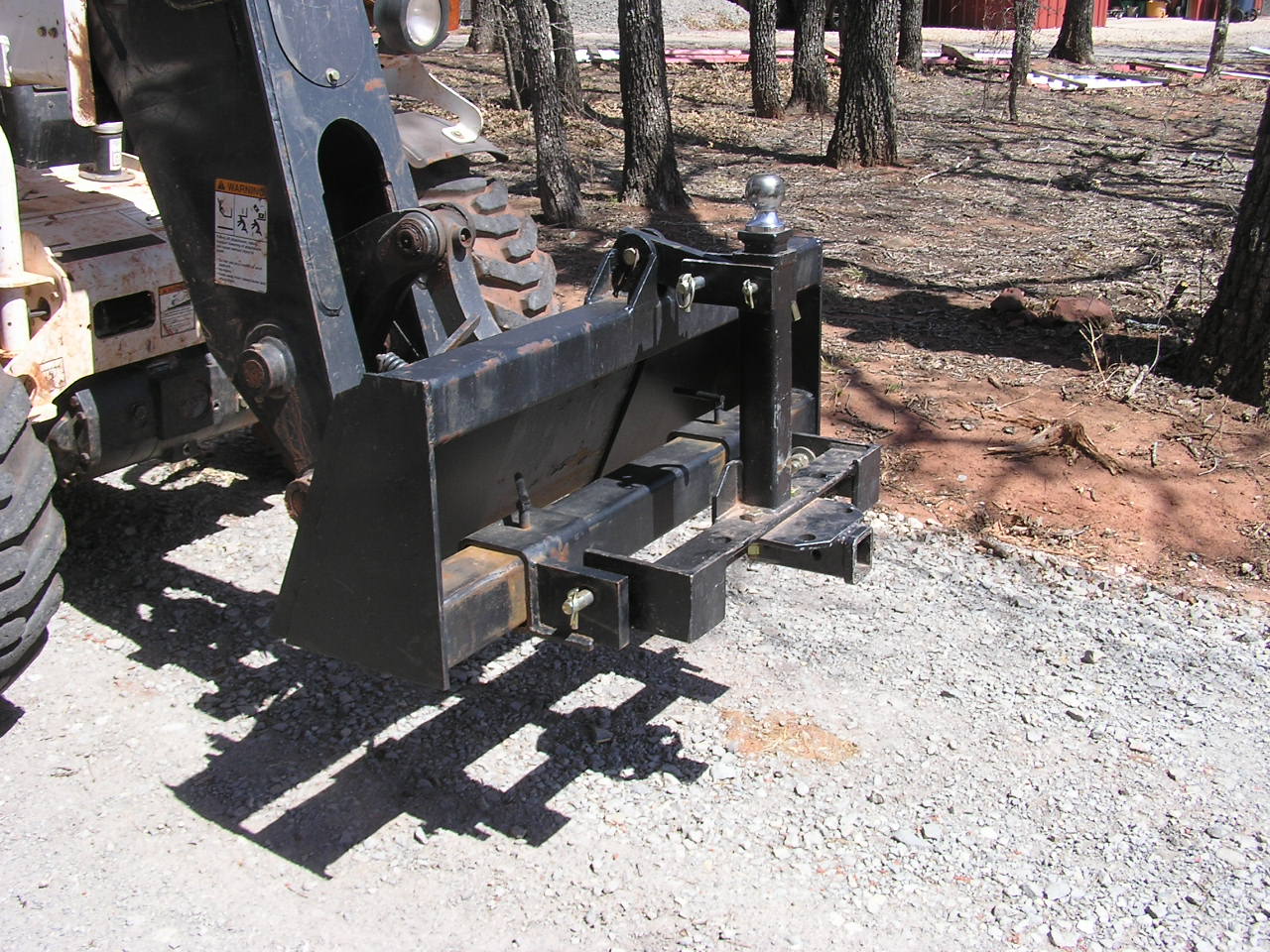

Ok, I decided my next neat thing is to be able to hang all my 3PT stuff off the loader, just like my Fisher Plow.
I could do this myself but I am lazy, smart and time limited, so who can post 3D CAD models of a sweet QA Plate to 3 Pt Hitch adapter with material list, so I don't have to design it myself or can have a starting point to work with if i want to tweak it some?
I haven't searched the Sites like 3D Cad Central etc. yet. I work Solidworks so native vs .step is even better.
After the time I put into my QA 3pt hitch mods, I.m looking for the "Easy button". I love the way it turned out, but too much work and $$.

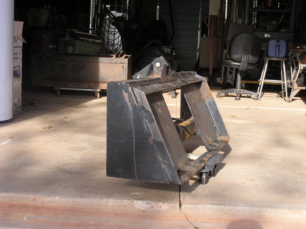

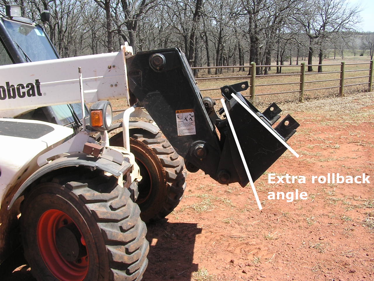

Can't help with the 3D CAD stuff, but be sure to add extra rollback to the adapter.
For build ideas here is my Cat2, from: Skid steer Bobcat 3 point implement hitch adapter Heavy Duty

Is this what you are looking for?
Titan 5/16 Quick Attach Attachment Mount Plate Skid steer bobcat kubota 516MP | eBay
That's the part you buy, the you start adding metal, time and a lot more dollars.
Amazon.com: Skid Steer Loader Quick Attach Mount Plate to Category 1 3 Point Adapter Attachment: Patio, Lawn & Garden
On second thought. Harbor Freight
3-Point Quick Hitch for Tractors - 27-3/16" Clearance
and some cut plate to add extra roll back angle should not be to bad to Fab up.

Several TBN folk have welded a Titan plate to the back of a HF quick hitch.
/ Back Dragging with a FEL Bucket #20
And later, some of them said that they should have put more rollback into it.
