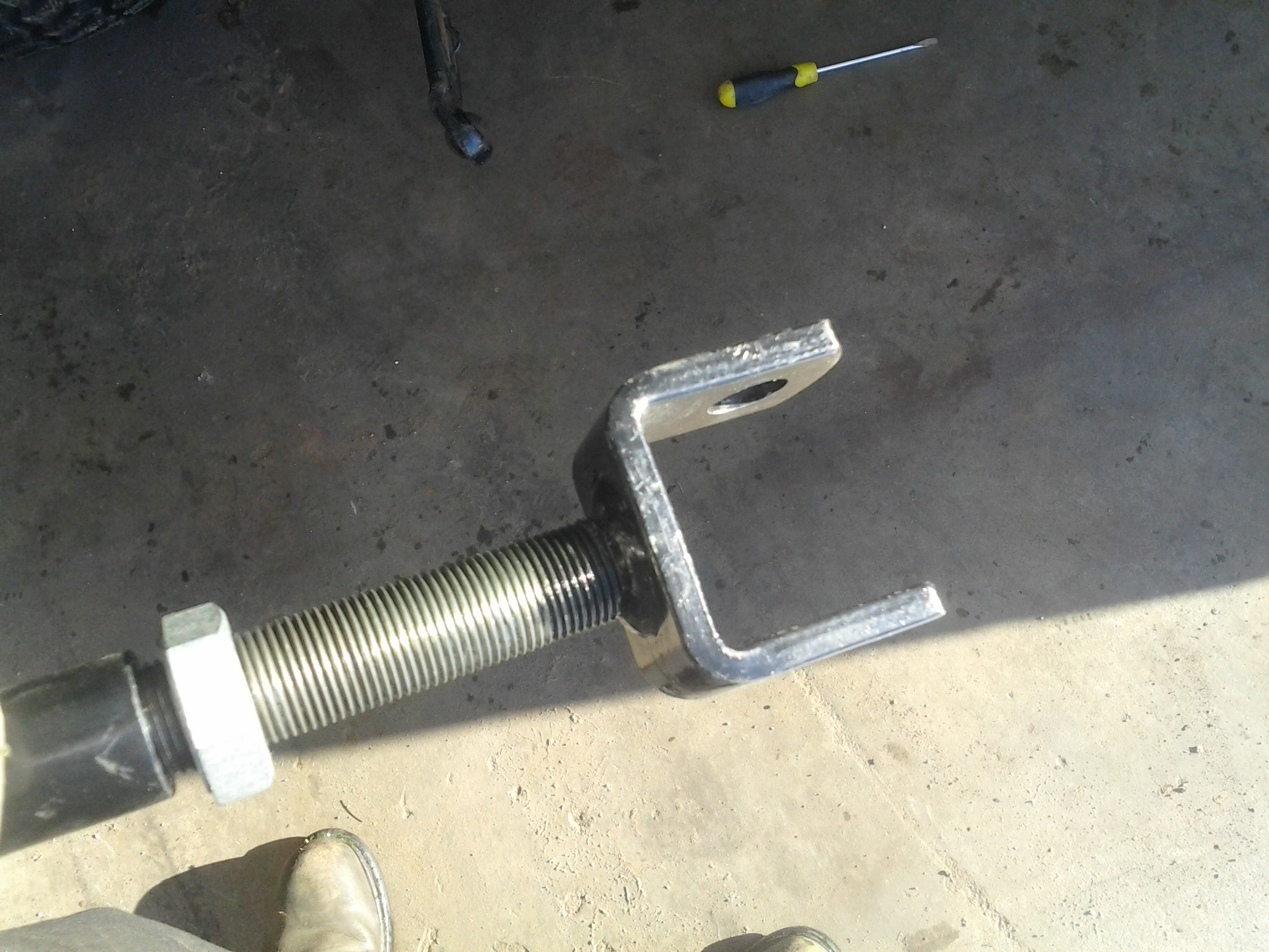

For the most part the 4000 series hitches are interchangeable with the 110tlb. When building up a 3 ph from scratch I would suggest you buy the telescopic lower link arms. That makes hooking up to a clevis hitch implement much easier. If you have the aux hydraulics with the three rear remotes I would definitely recommend you go with a top and tilt hitch to start with.
I would have to look next time I take the backhoe off but as I recall the only difference may be the connection of the sway bar stabilizers and that is simple to fix. I ordered an extra pair of telescopic link arms with my 4520 purchase years ago and put them on the 110. Prior to that it was a pita to hookup my box blade, everything else I have is IMatch compatible which is the way to go.
There are solutions available so don't feel this is hopeless.

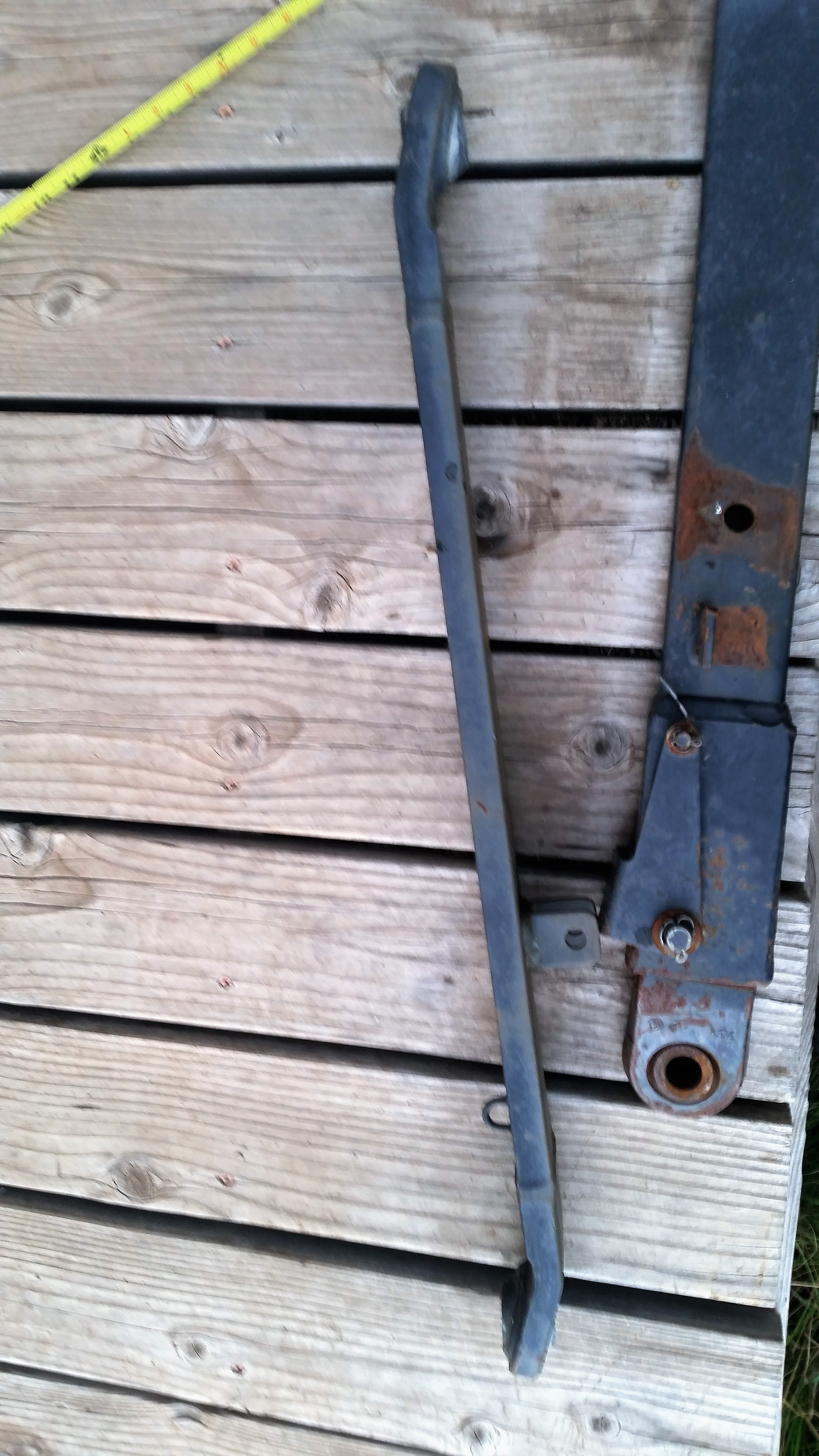

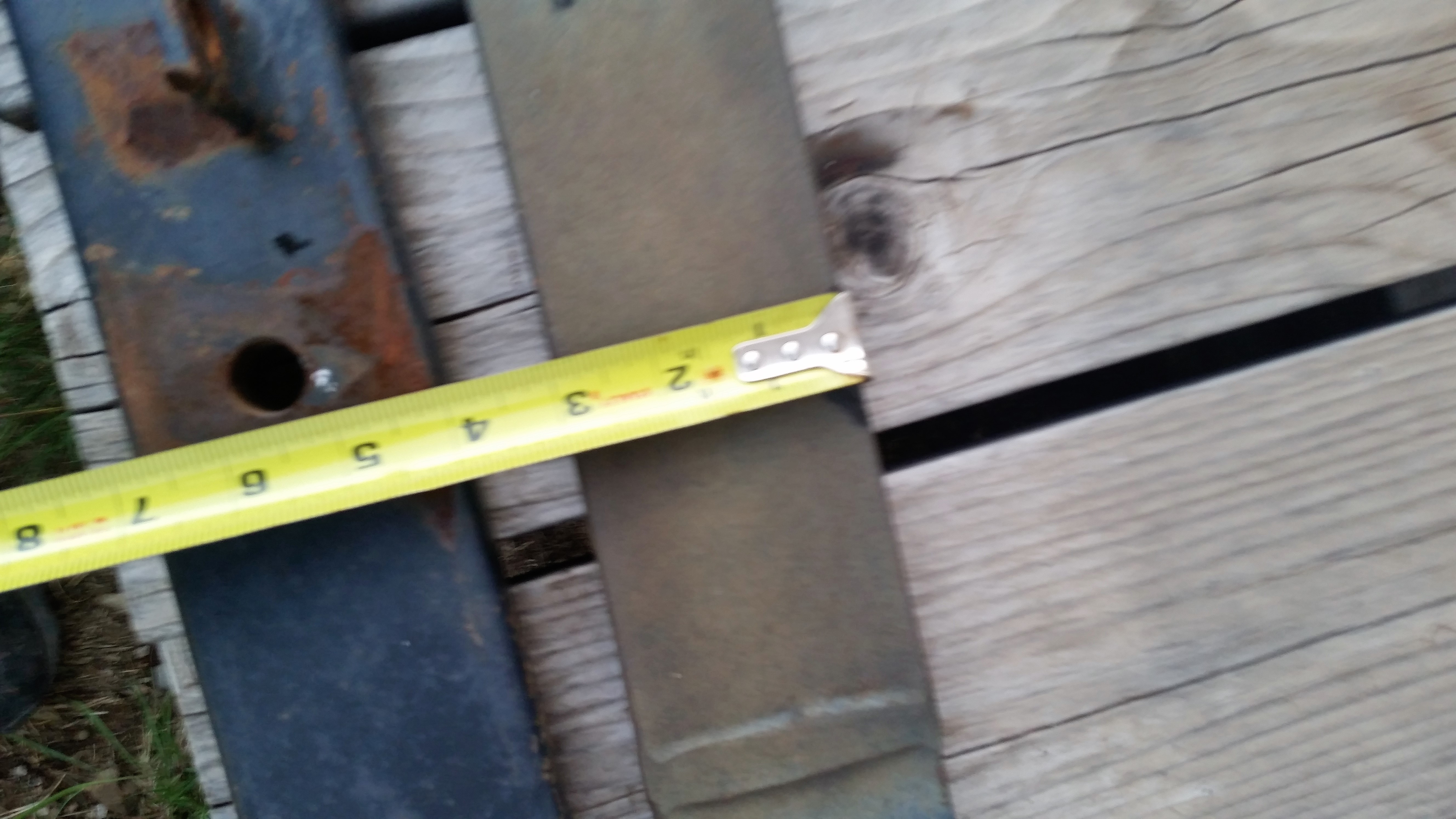

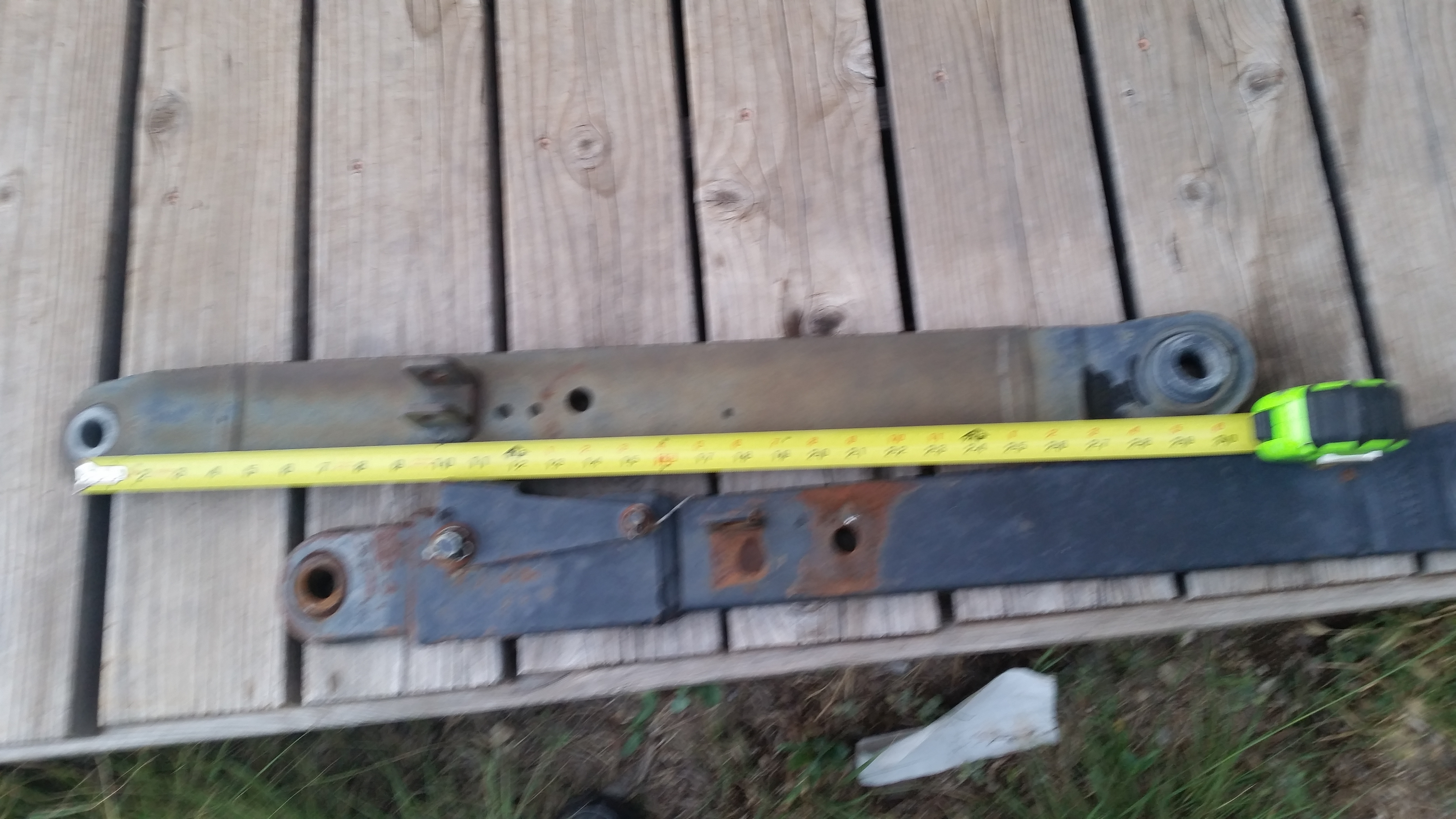

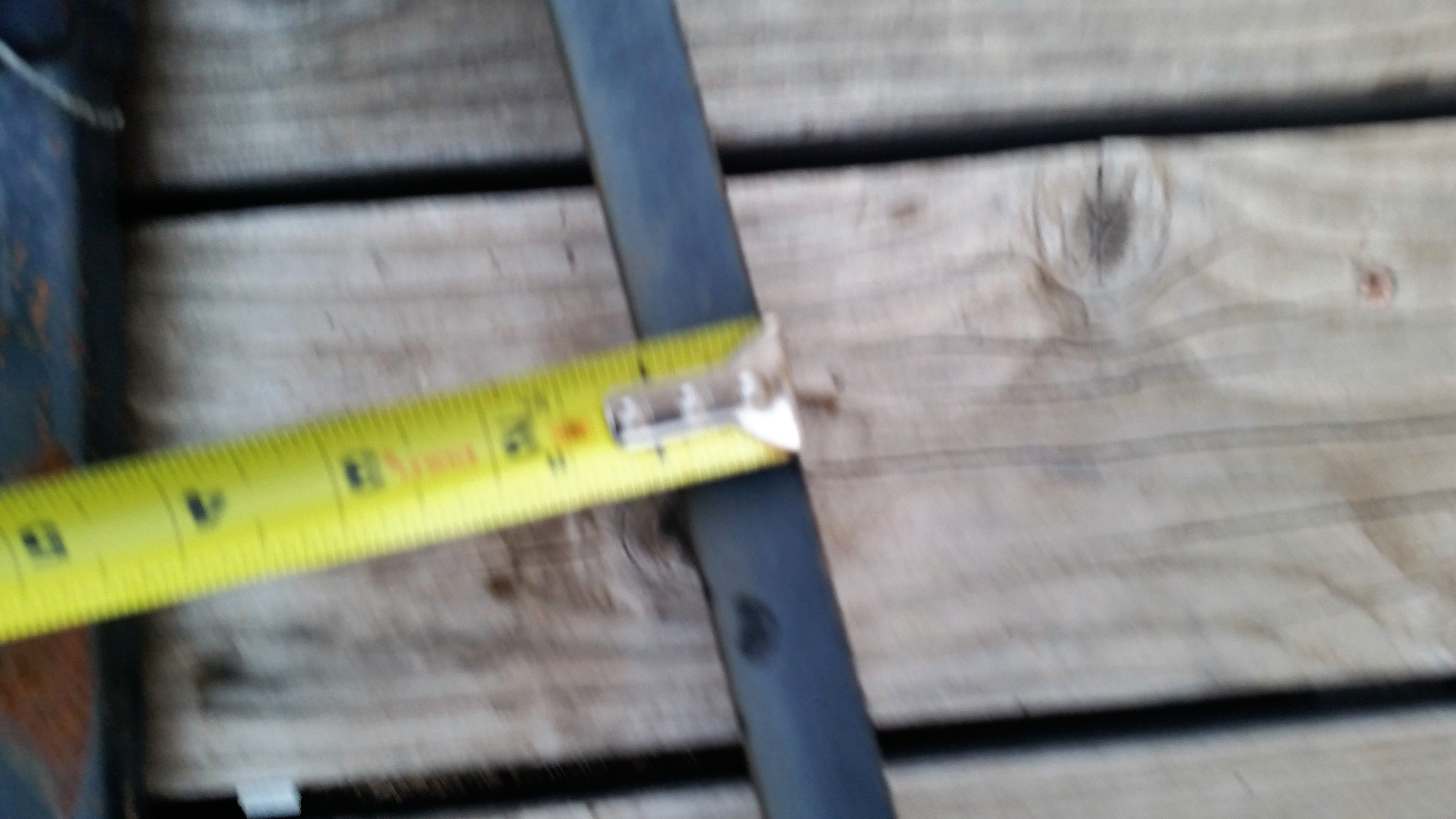

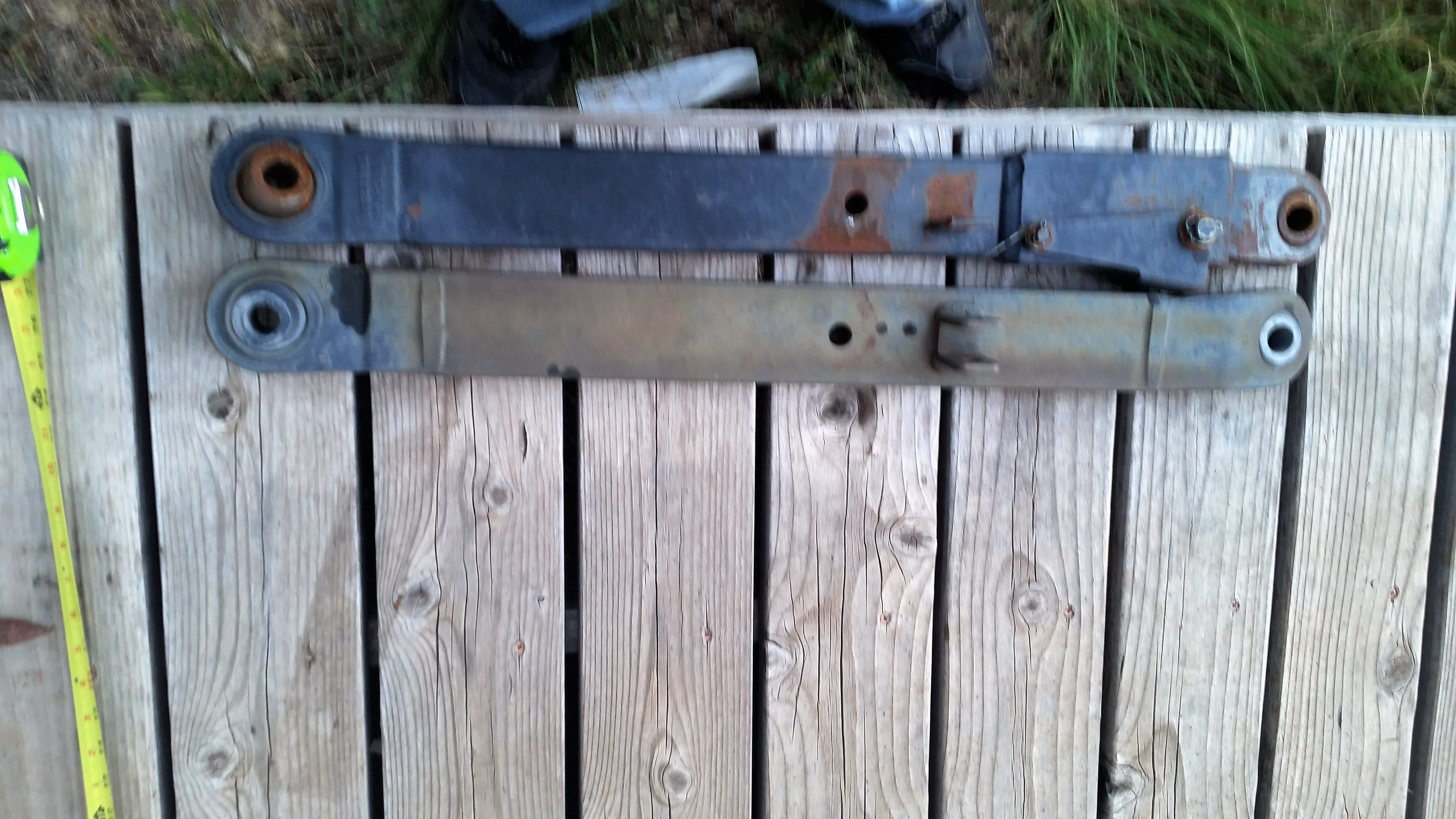

The pin holes are 29.5" on centers, thought the tape would be easier to read. One is a 4xxx telescopic link and one is a standard for the 110.

They are available for a high price imo. I just looked them up and a set of telescopic draft links through the parts department are $1,082. and the standard draft links are $709.
When I ordered my 4520 in 2009 I ordered two sets of the telescopic draft links, one for the 110 and one for the 4520. At that time the cost was about $330 per set. That leaves me with a set of the standard draft links for each tractor. I guess I need to lock them up.
All of the parts are available on the Deere parts site with drawings.

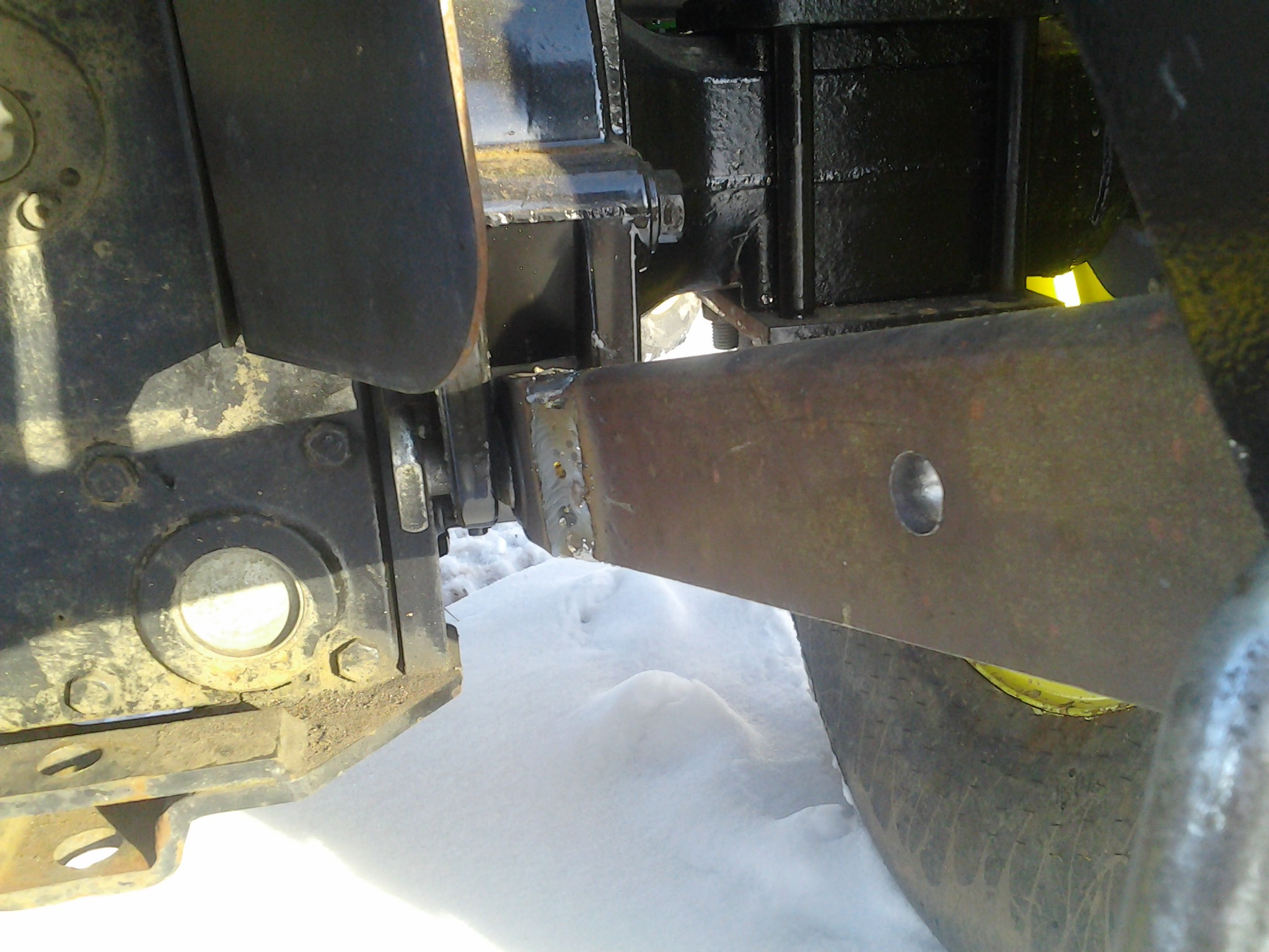

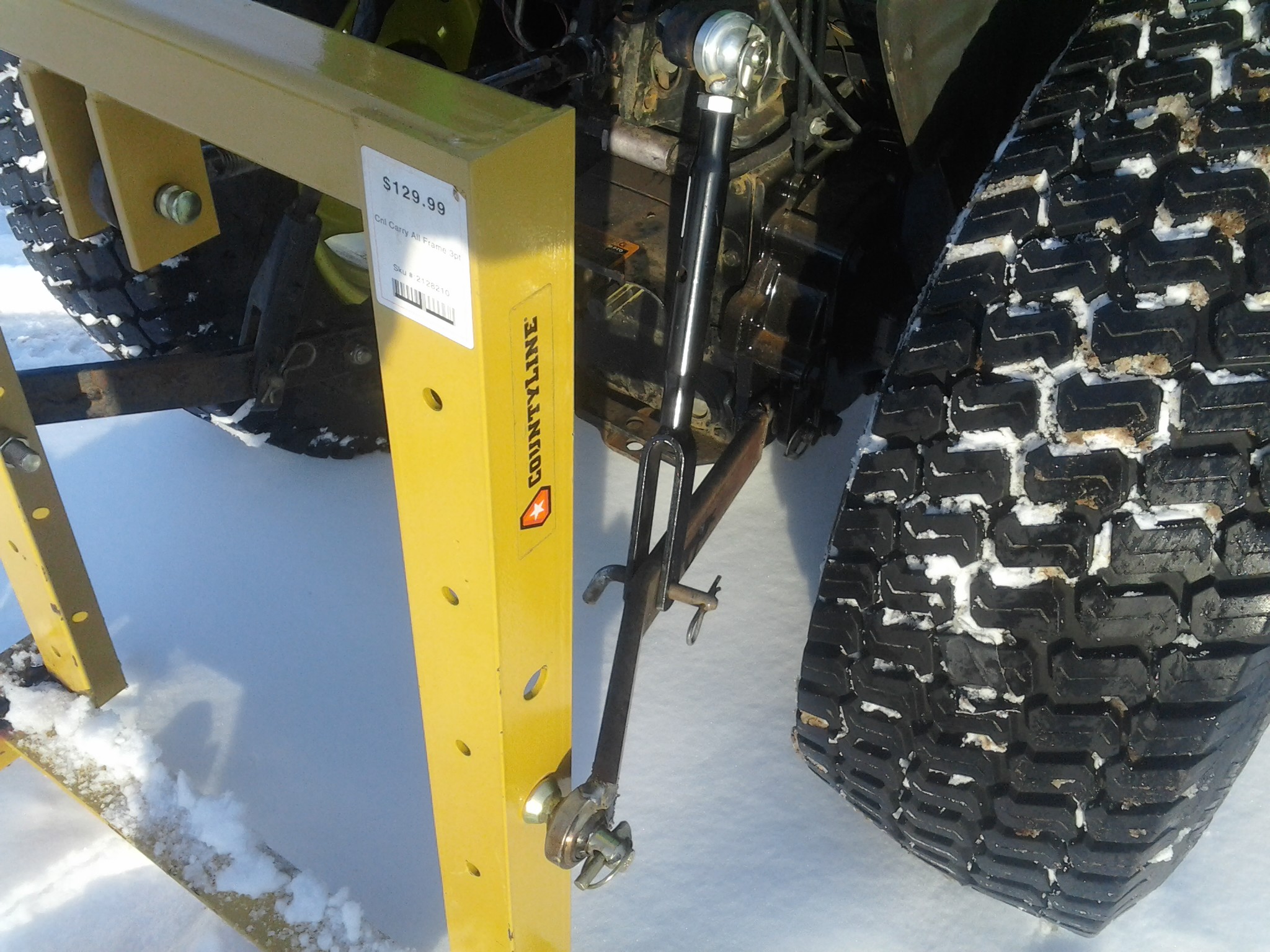

View attachment 463913View attachment 463912View attachment 463914View attachment 463915
http://www.tractorbynet.com/forums/...new-4300-project-post4423274.html#post4423274

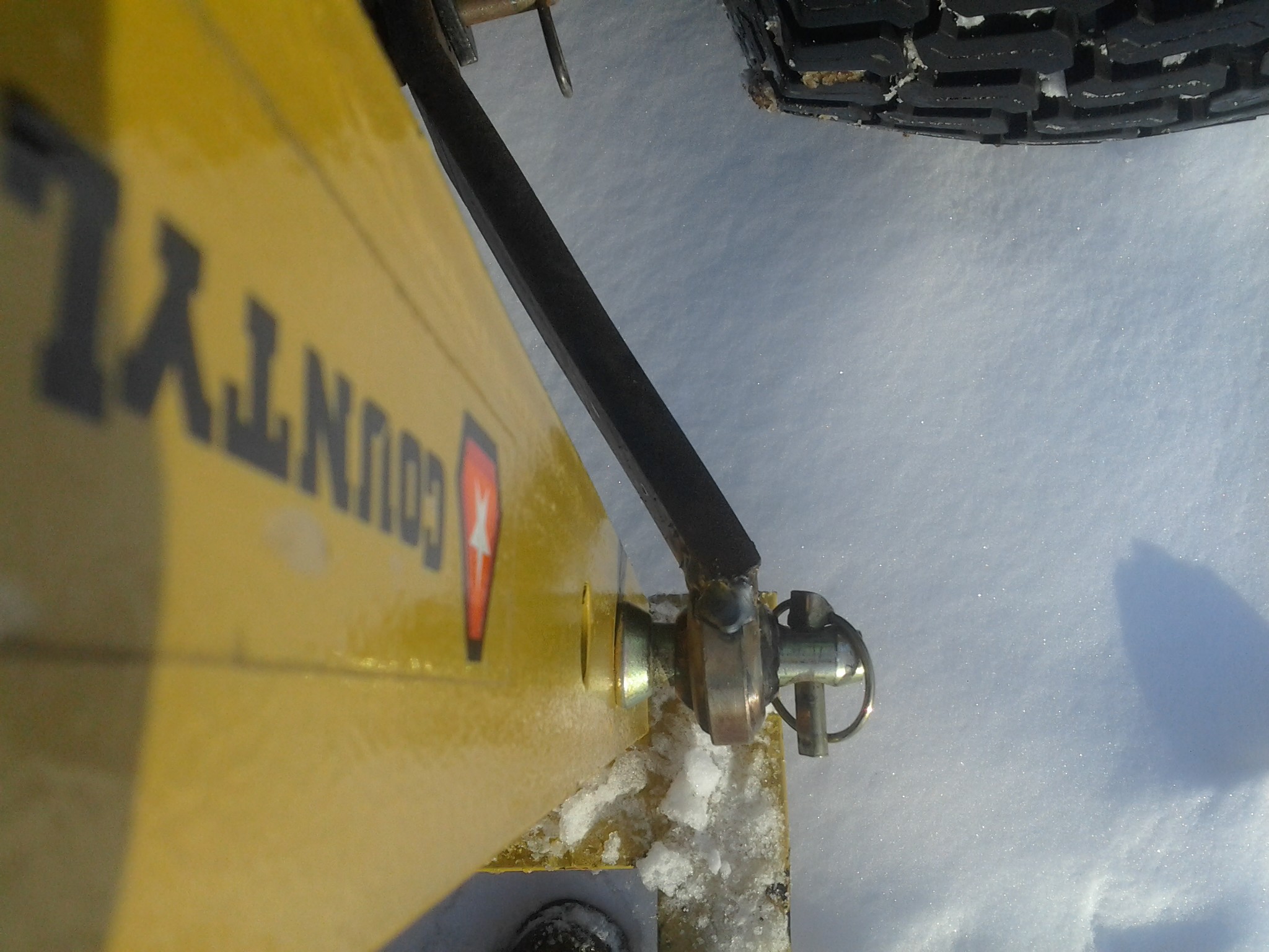

I built one for my 4300 out of 2.5"x3/4" bar stock and some weld on ends from agrisupply. I drilled the holes where they needed to be, bent the link in the middle so it matched the stock arm, and welded the ends onto it. I had MAYBE an hour into making it and about $20 in parts/material. Now that it's painted it looks factory and it's been working fine every since. I also welded on extra hitch pin holders compared to OEM so I am never searching.

Good job that saved some money.:thumbsup:
